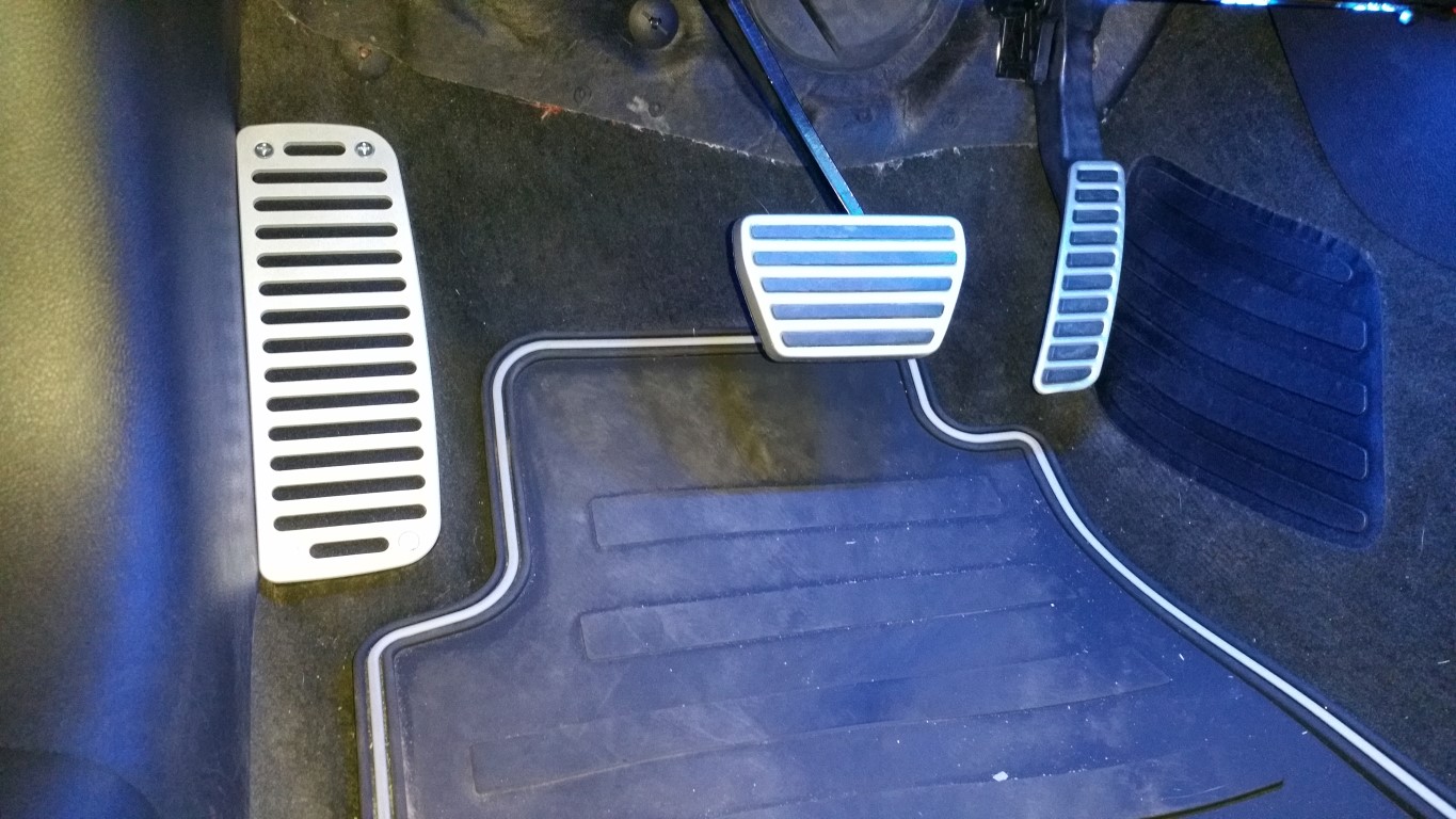

Well, finally found a dead pedal cover -- one of the members on the forum turned me onto this (from ultimatepedals.com -- had to ask for this kind specifically -- G8-Camaro).

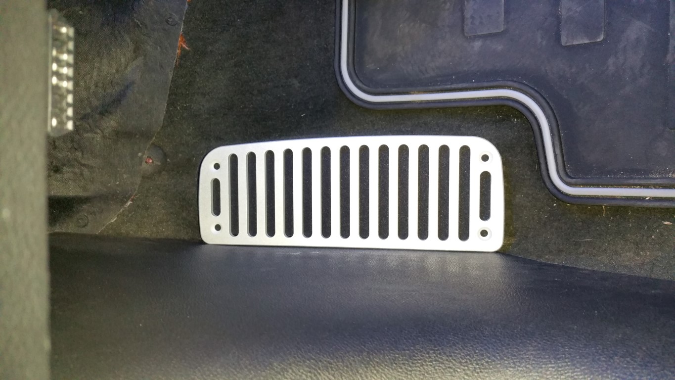

A little use of an old mouse pad, some super glue, Velcro and here I go:
Looks like a set!
I cut a cheap mouse pad to shape so it would cover the horizontal openings (and screw holes).
I superglued that to the back of the pedal (the part the mouse glided on was 'upright' and the backing faced the carpet dead pedal).
Once that was superglued, I then put velcro on the mouse pad backing -- supergluing that also to the backing.
I then place the 'other' side of the velcro on and then just 'pressed it' to the carpet dead pedal. Pushed it down, and applied pressure with my foot to make sure it was 'set'.

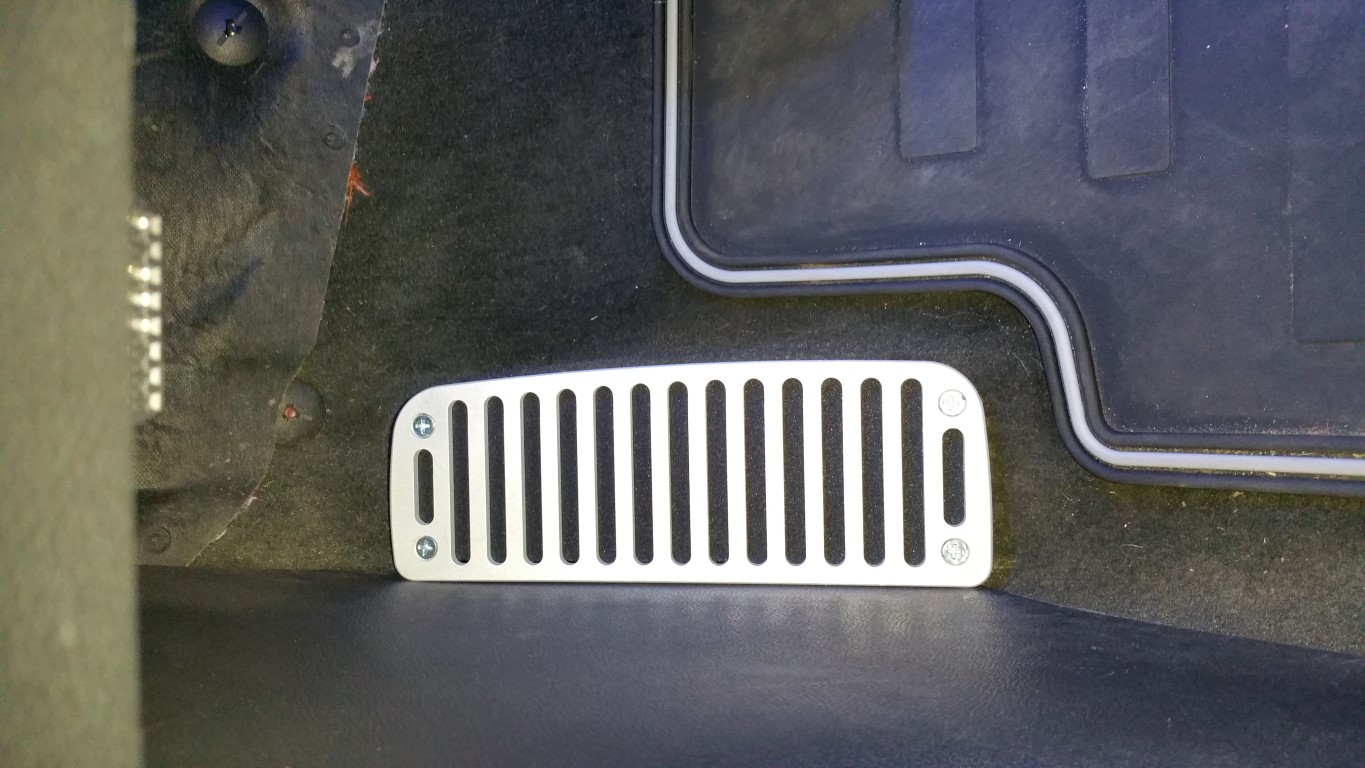

With the bolt (heads) in the pedal (did NOT drill for them, just used smaller bolts (length) and super-glued them in):
For those who thought it would look better with screws...

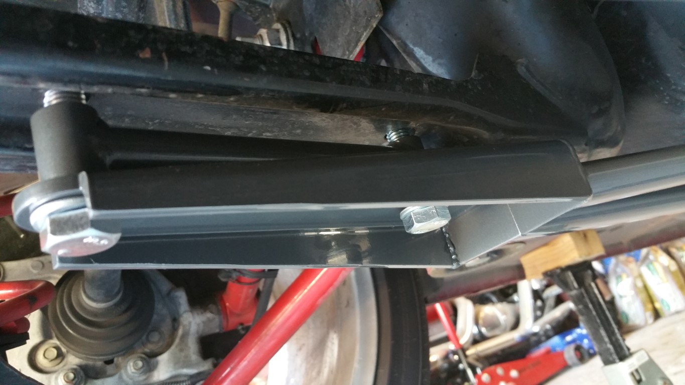

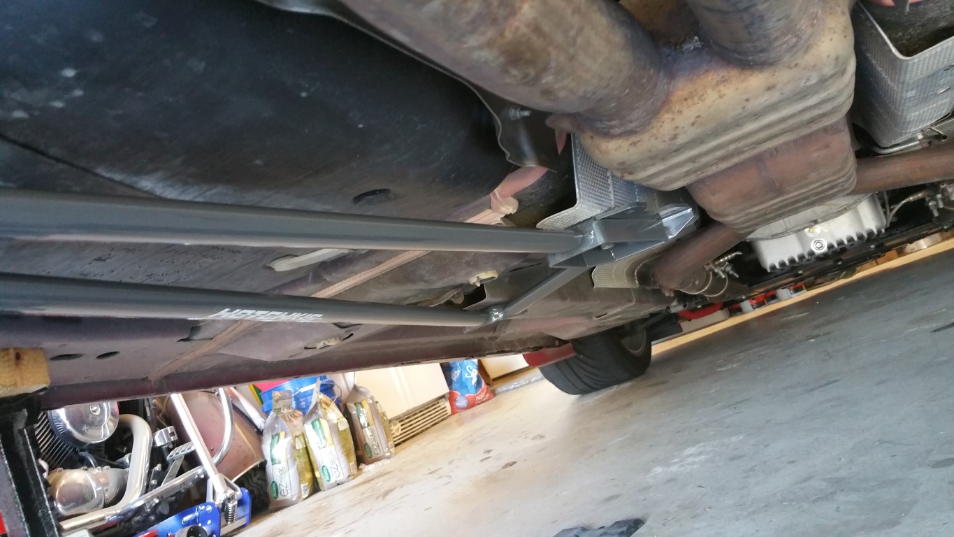

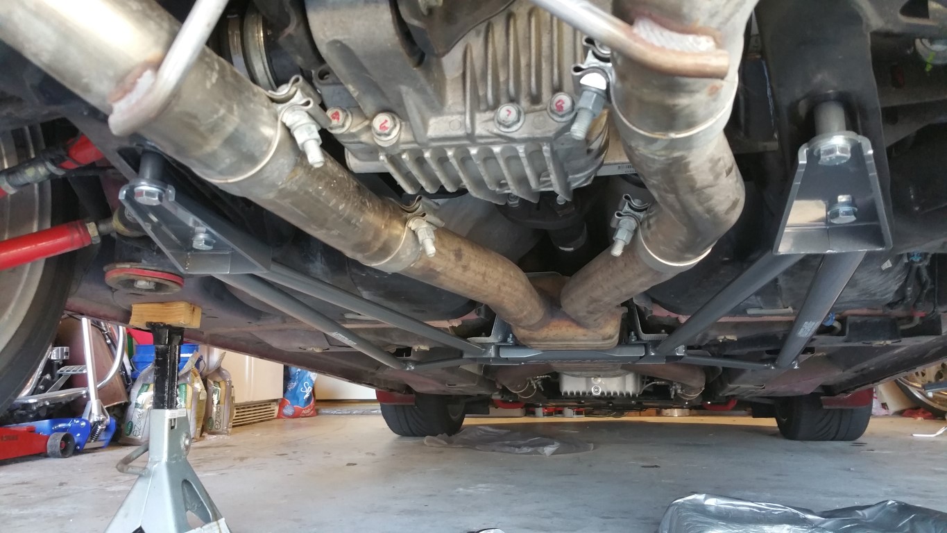

OK, got the Hotchkis Max Chassis Brace from dynosteve @ RDP -- Super Fast service and great price!
Here is what I got in the kit -- nicely packed:

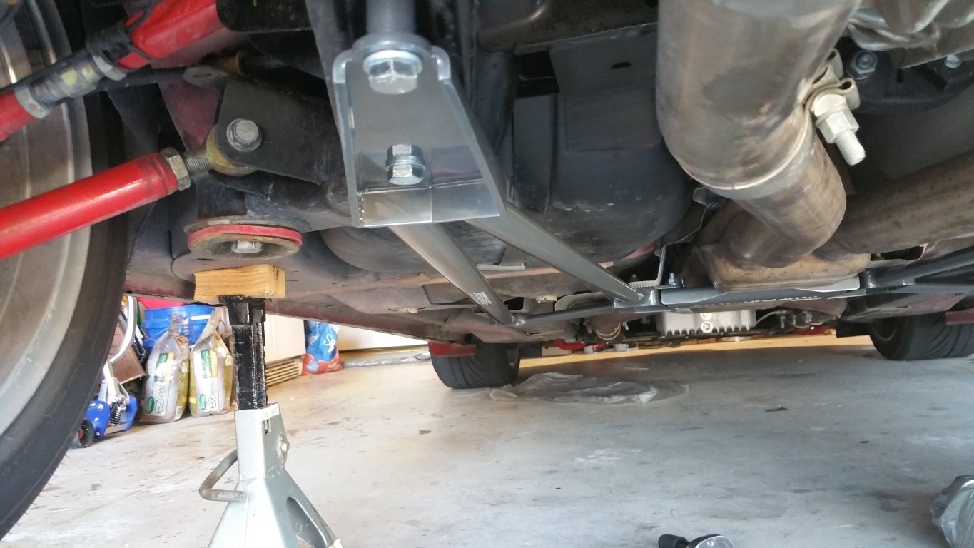

Jacked up the rear of the car, and, following the easy directions, began to install (link to instructions:
http://files.hotchkis.net/instructions/20104.pdf

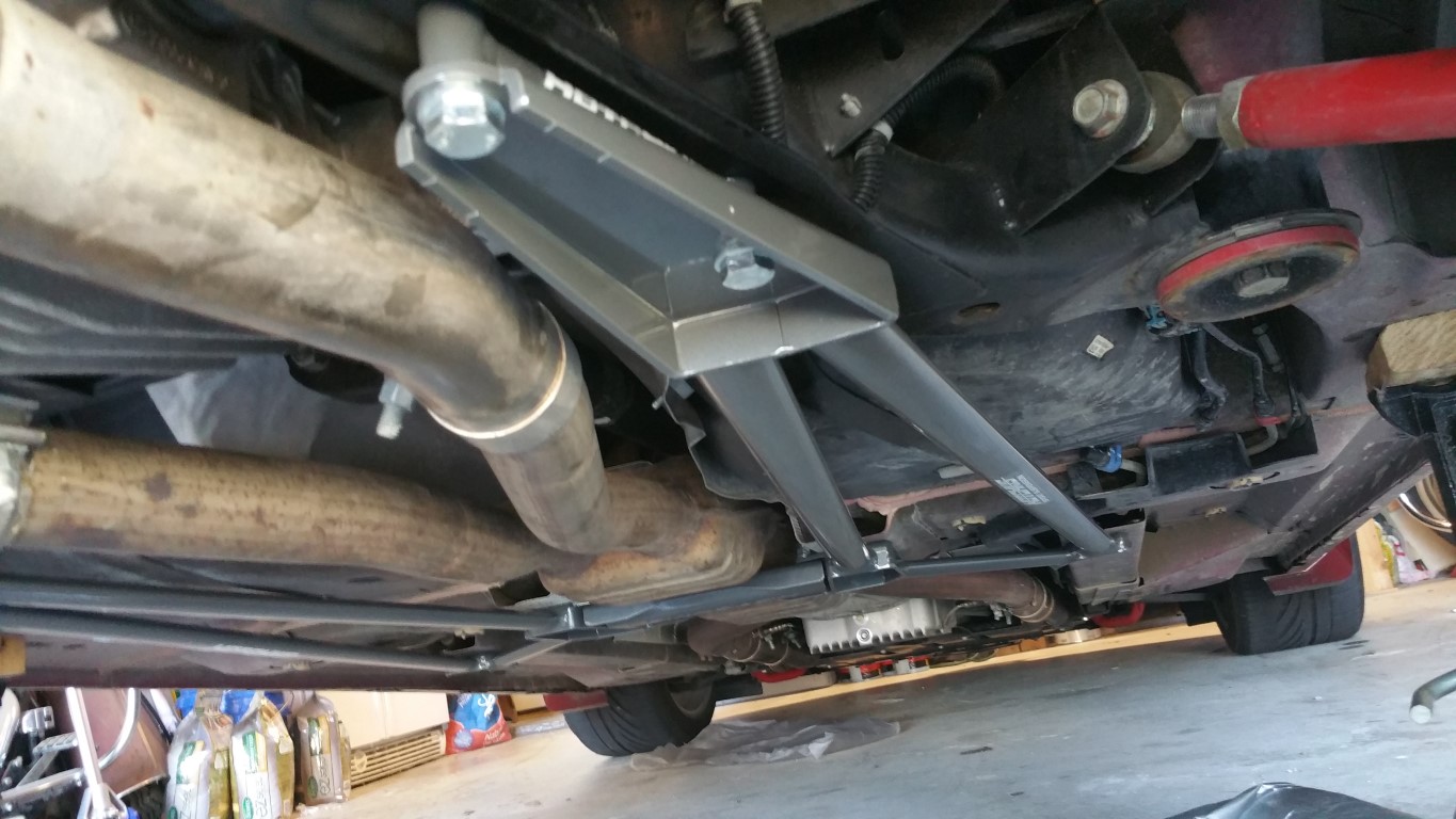

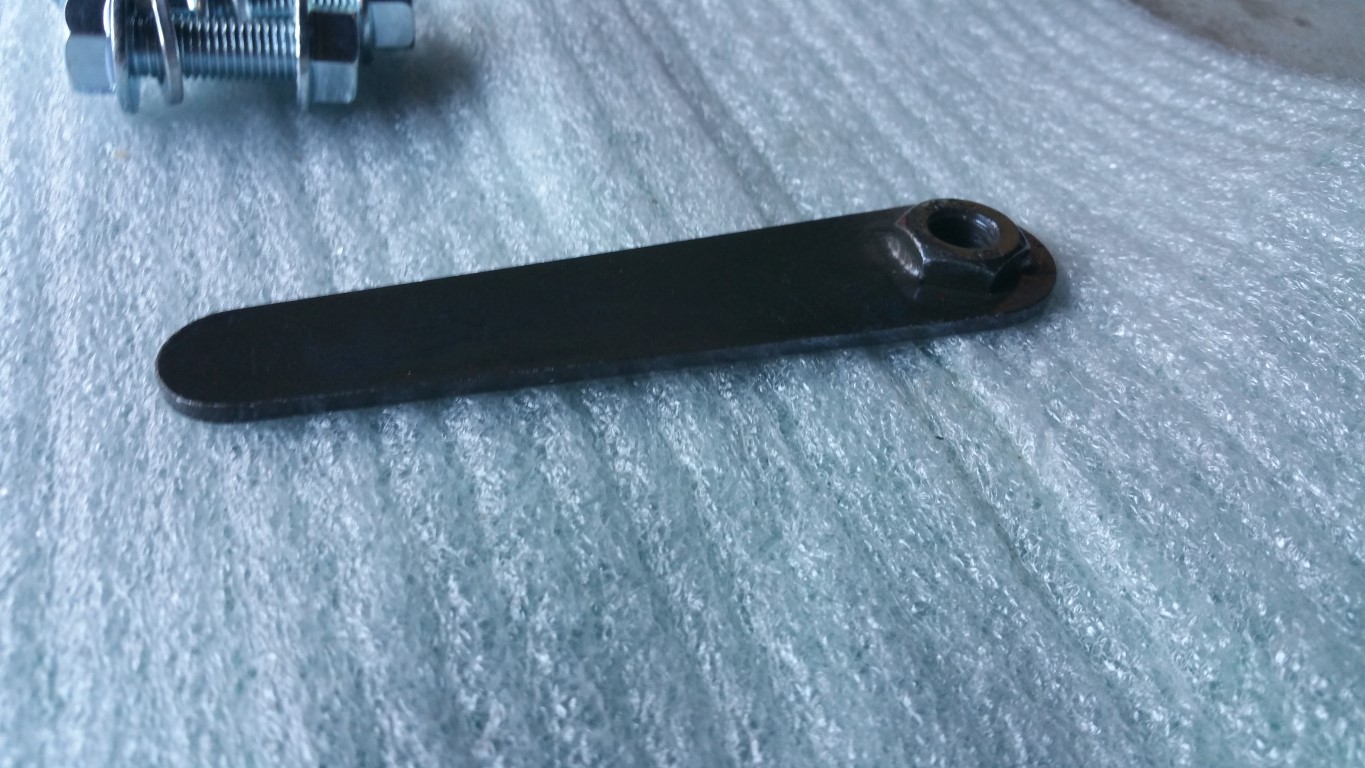

Since the '11 does not have the pre-tapped holes, need to use this on the front outer bolt on each side -- goes in the 'channel':
Middle brace in and everything torqued to spec!:
Now, this is a bit thicker than the stock brace near the exhaust. I did notice its close and rattles a bit, so I'll get the exhaust raised 1/2 inch and that will clear it no problem!
Very nice kit and Steve from RDP really got it to me fast -- 2 days from order date to in my hands...
-Don
747 RWHP 794 RWTQ

B&B muffler took care of the rattle so it was ready for a test! So far, real solid feel on takeoff and turns...

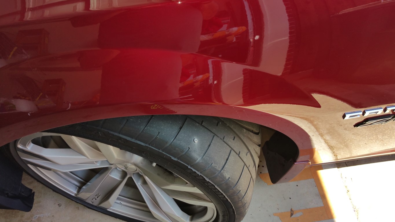

and then found this during the prep (ugh):
Got it fixed -- but was scared I needed 'new' tires -- and these puppies would need to be ordered!

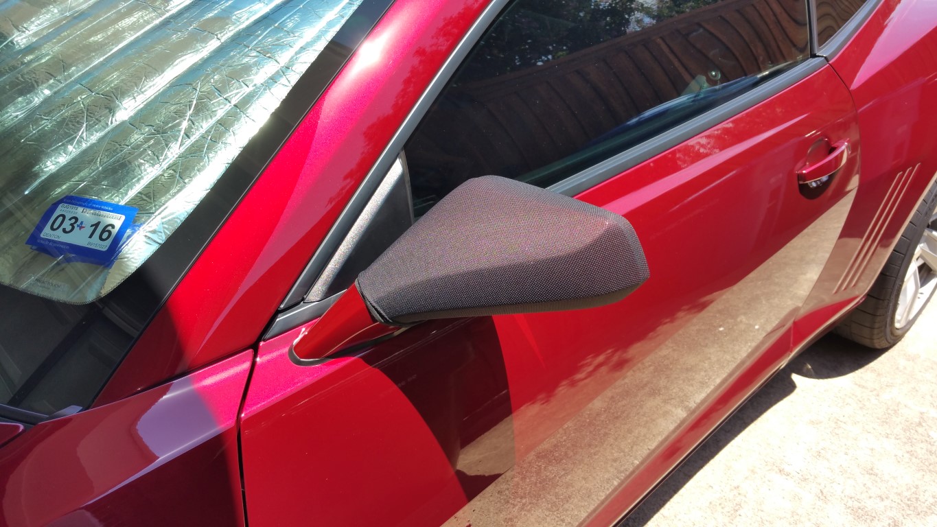

Found out the NoviStretch was scratching up the paint -- several others who used it experienced the same thing.
Andrew from NoviStretch contacted us so we'll see if they can find what caused it. I'll need to see if I can get clear pics -- did it on the mirrors also...
Yuck...
