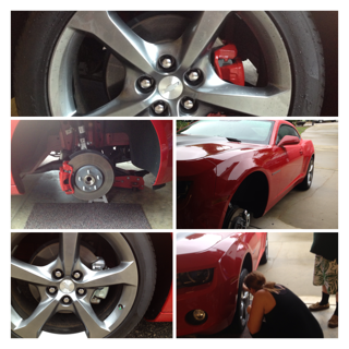

I just painted my calipers RED, yours are red too, painted? bought name brand? Just curious.....
Attachment 551389
I painted mine with high temp caliper paint. They've held up pretty well, hard to keep them clean with my rims lol

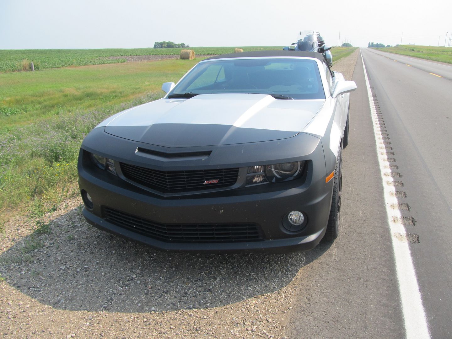

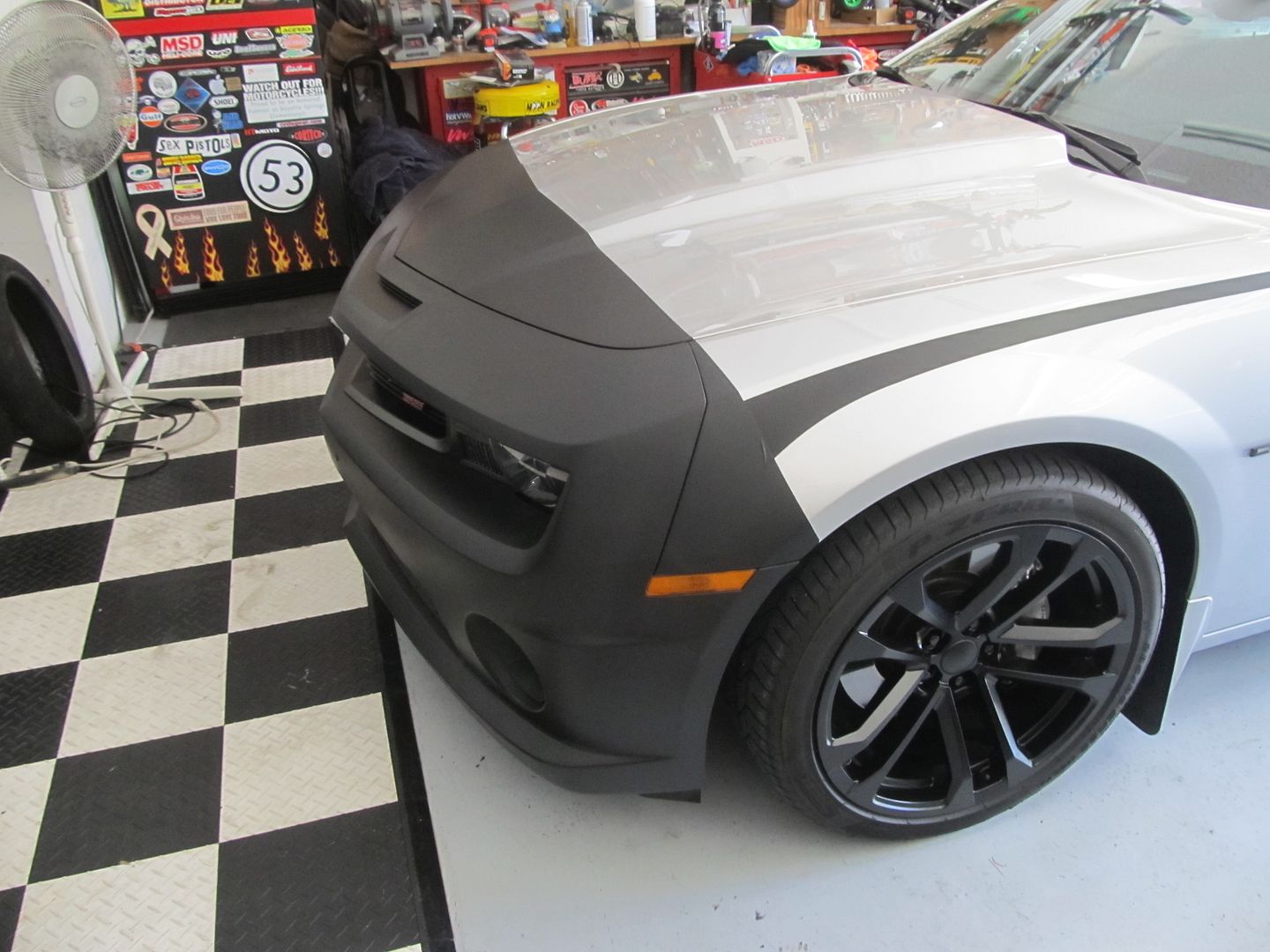

After getting every bug know to man attaching itself to my front fascia on my trip across the USA, I opted to plasti-dip the front end............ vs using the tape........ works great!
And after SEMA, I'm going to dip the whole ZL1 black, pic above ,shows when it was drying (4 coats)

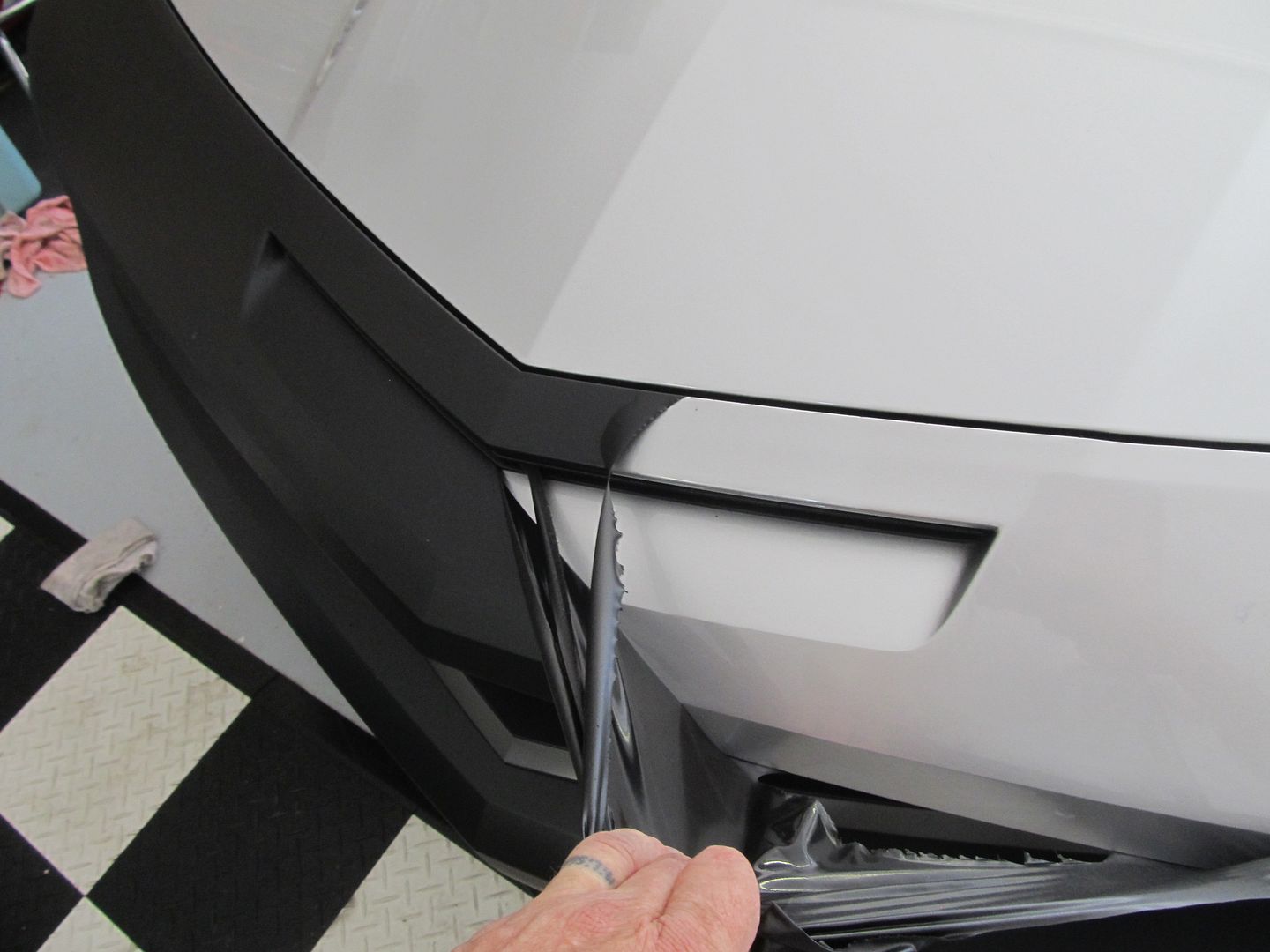

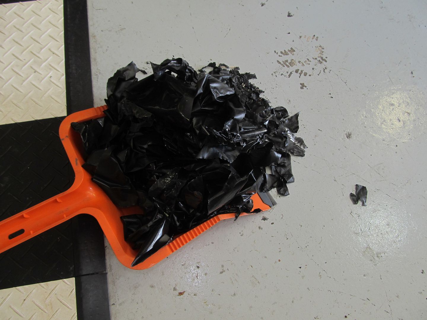

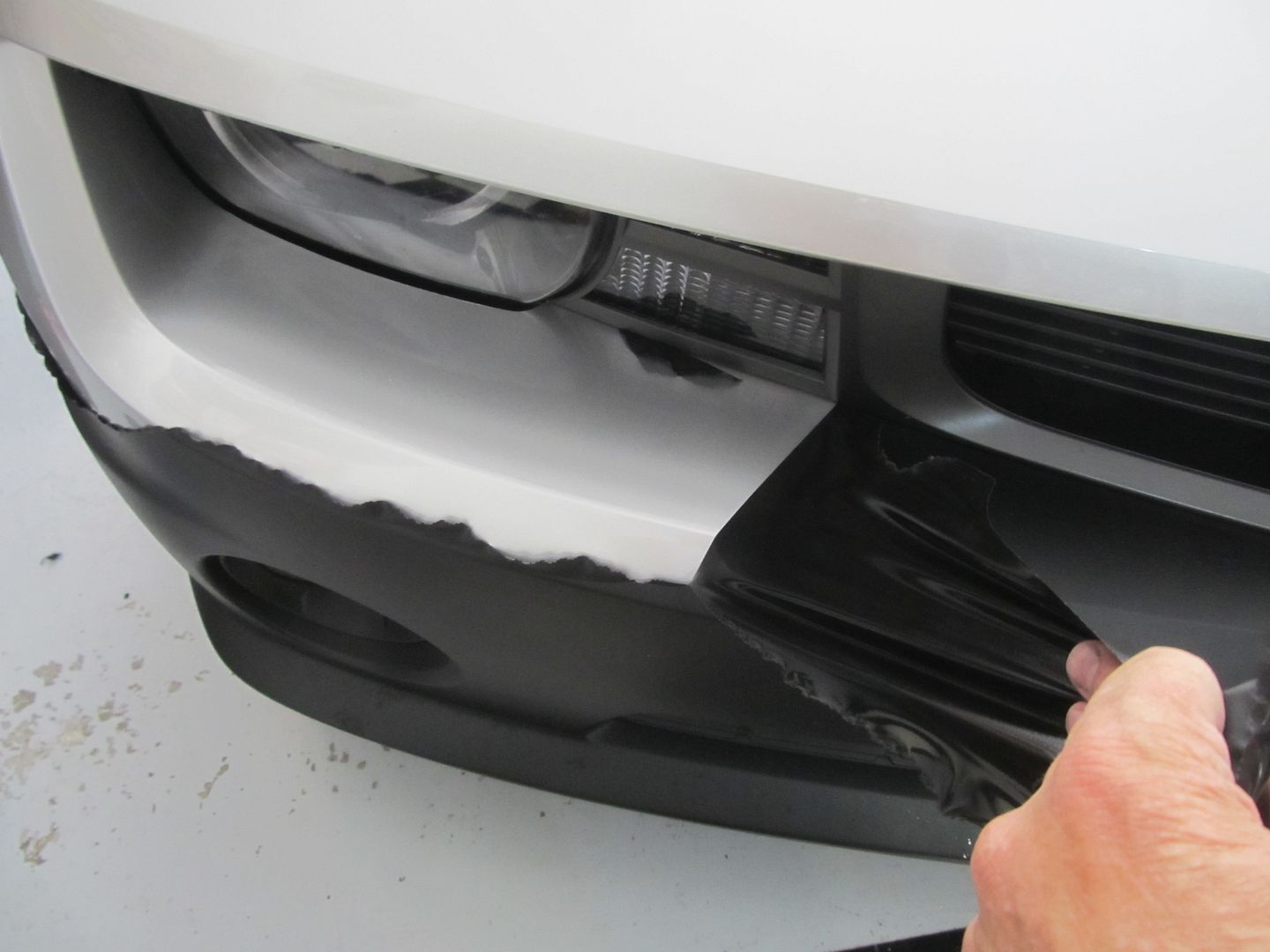

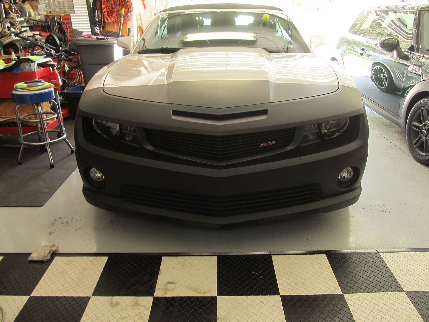

Old 09-11-2013, 08:12 AM   #474
Bugnut
Bugnut's Avatar
Drives: Camaro
Join Date: Nov 2012
Posts: 44

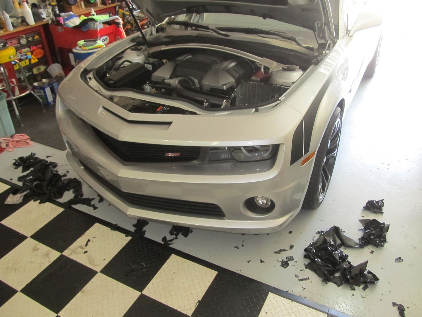

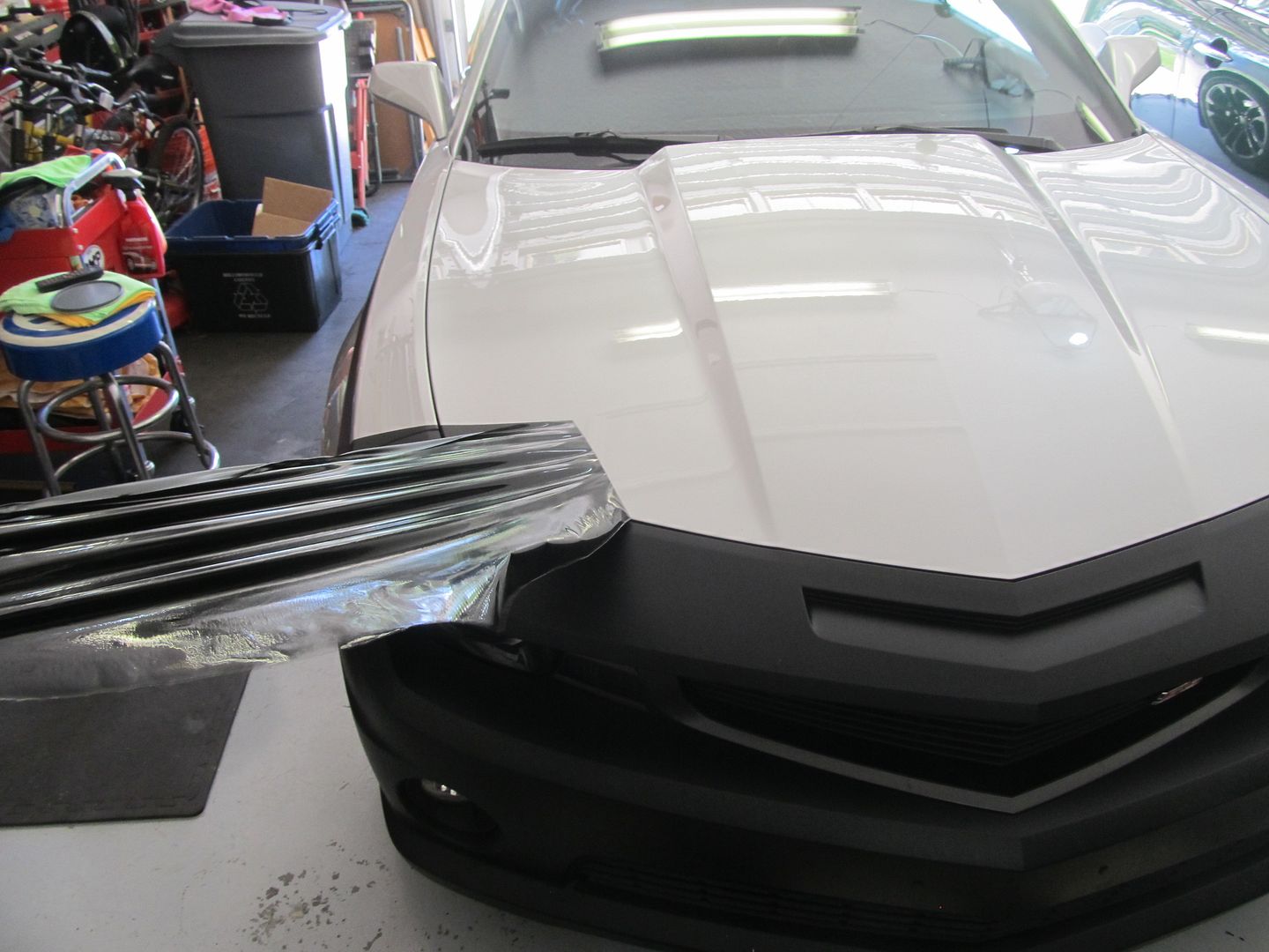

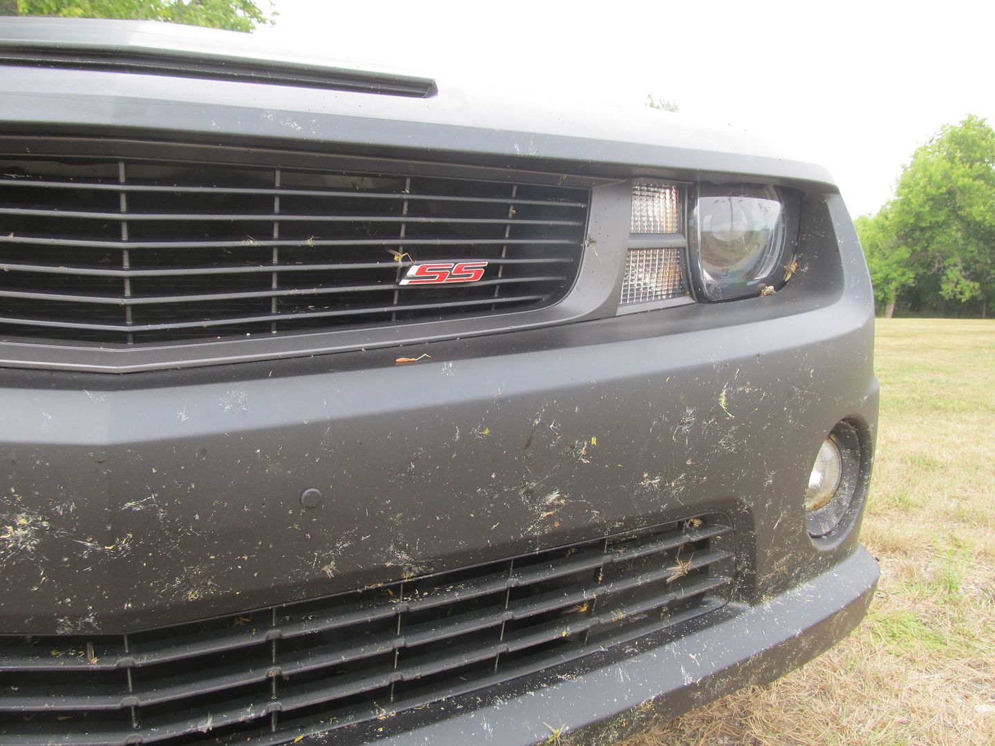

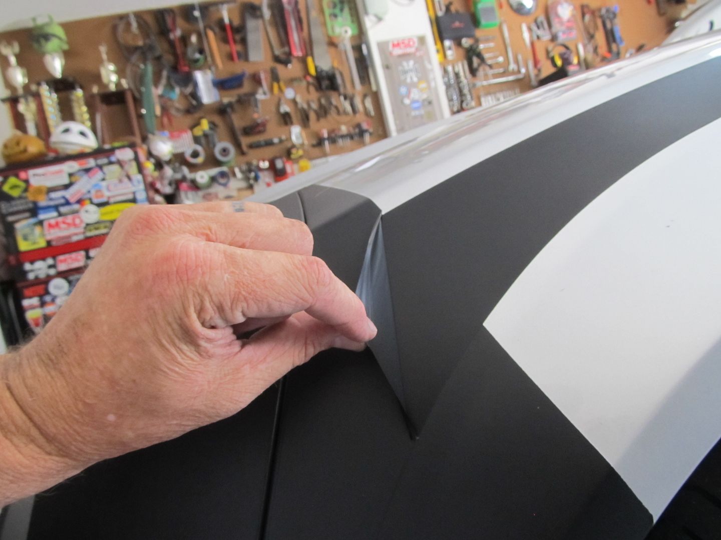

Here's just after getting home, had pressure washed the car 3 or 4 times during the trip. Could blast off the really nasty bug splats off the PD but the pressure washer COULD peel off the PD if hitting the right angles. Still extremely durable, had no problems with rain or anything else Mother Nature threw at it.
Cleaned and detailed, ready to strip off PD.
First pull, convenient spot where the stripe and PD overlapped.
And away we go....
And in the trash it goes. If I take any trip more that a few hundred miles, I'd go this route. So easy to pull the nose of the car and spray either with cans or gallon can method with a sprayer.
Note, there was a SLIGHT haze seen in certain light where the edge of the dip was compared to the un-dipped paint. Quick wipe with detailer and wax and no trace of the haze could be seen. I know people worry about clouding and clear coat issues, but none in my experience other than described and completely gone with a good detail.
Love PD.
Mike
