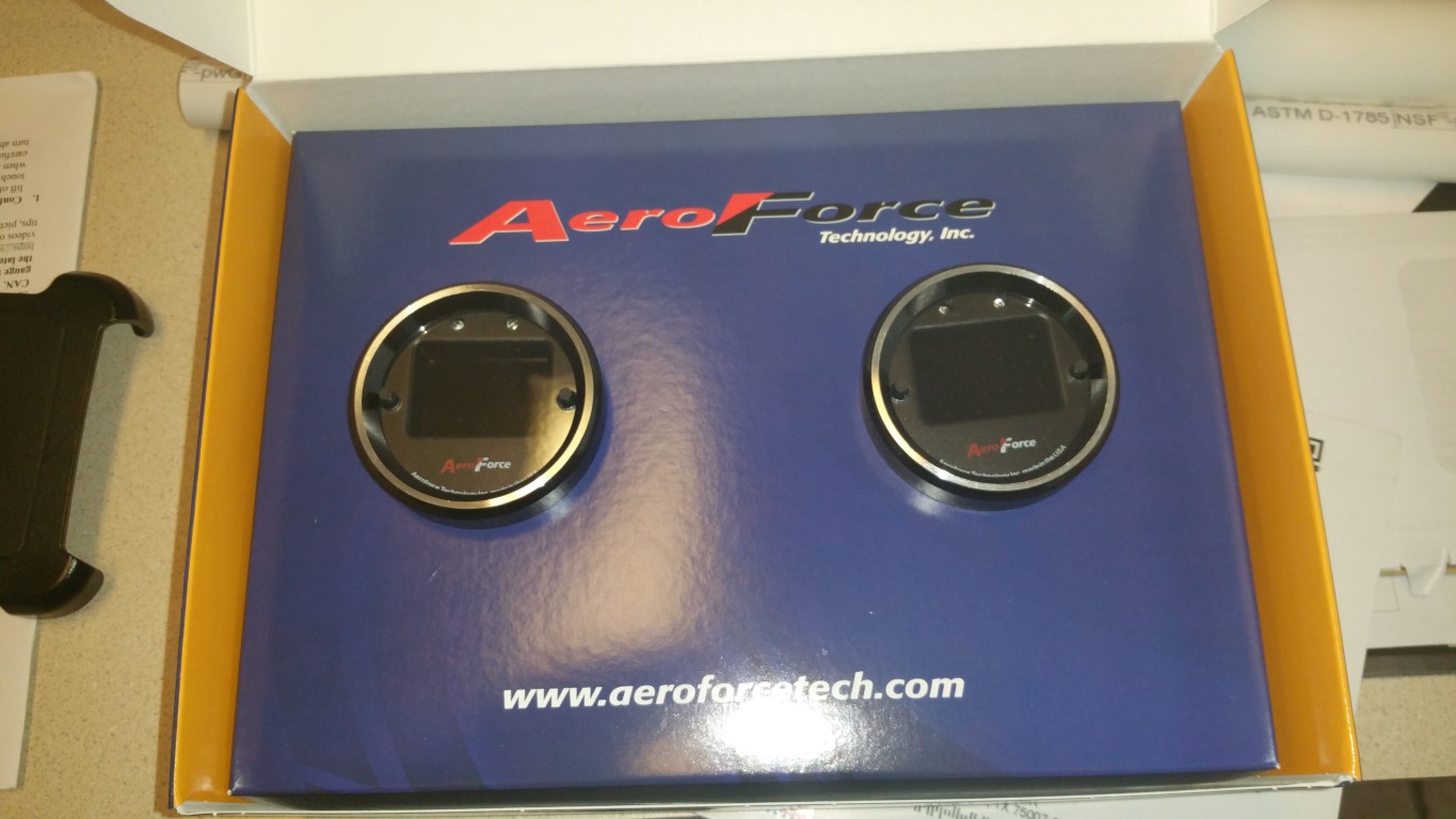

Woot! Dual Aeroforce gauges came in! Time to get on those!

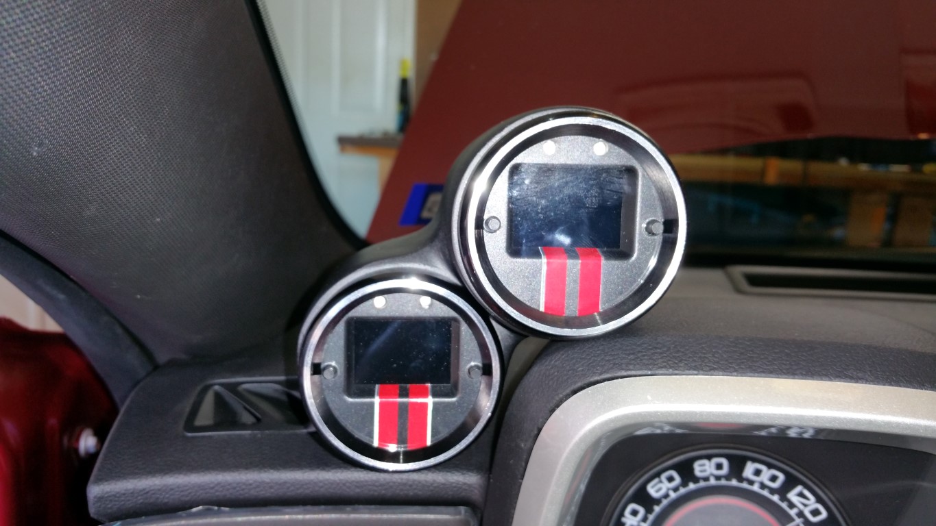

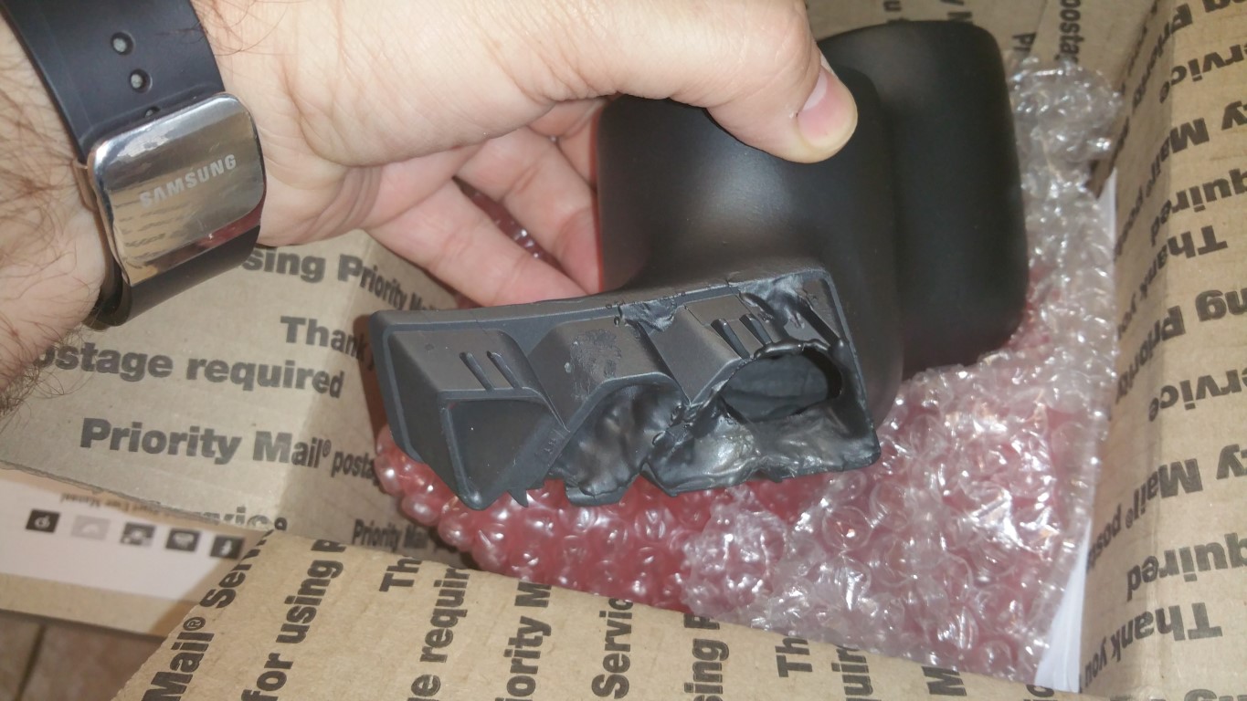

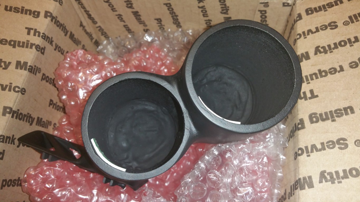

OK, here is the vent Pod I purchases from AeroForce:
Fit and finish is good -- not perfect, but its hardly noticeable.

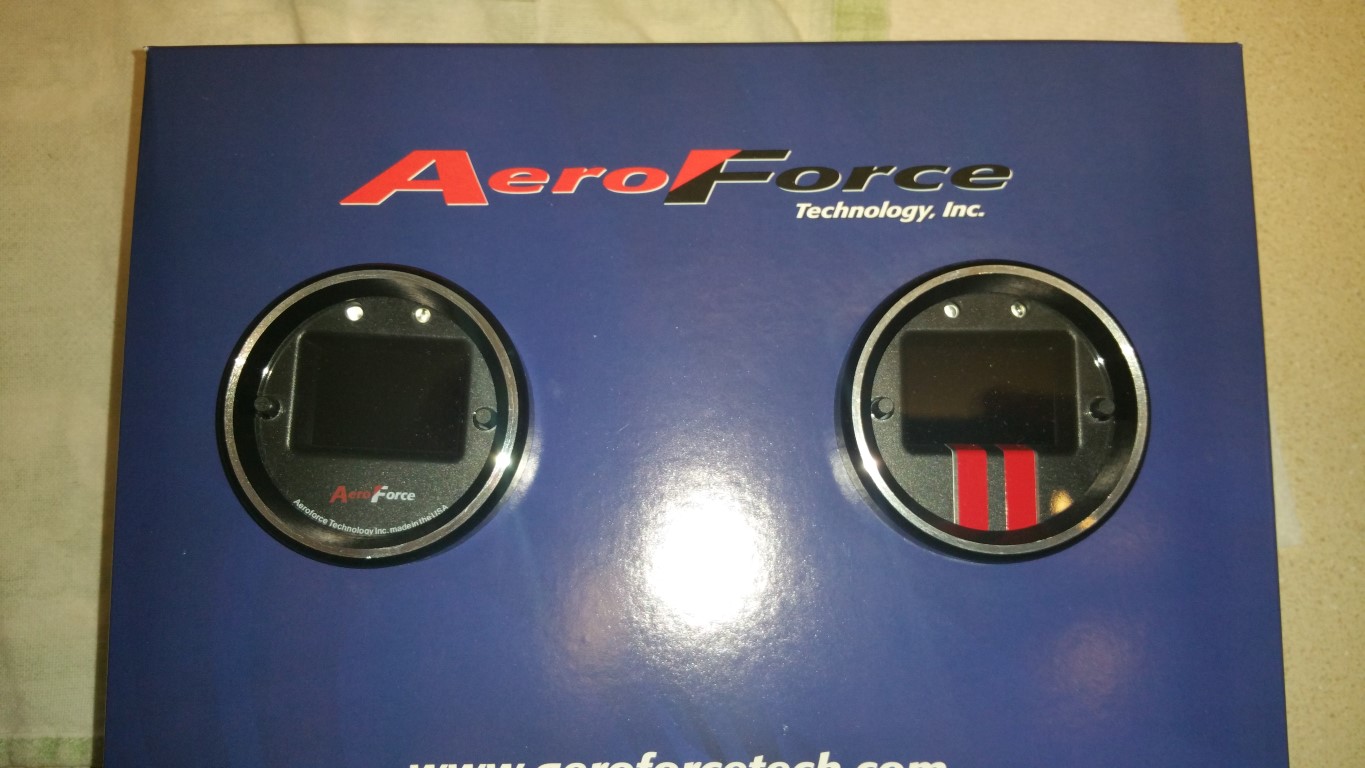

I changed the face of the gauges -- I ordered the 'stripped' version and like it best (purchased from DynoSteve RDP):
Before:
After (just one):

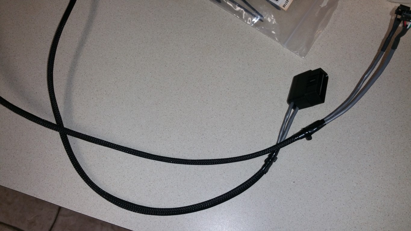

I used the Master Carr wire cover to give the wiring a nice look:

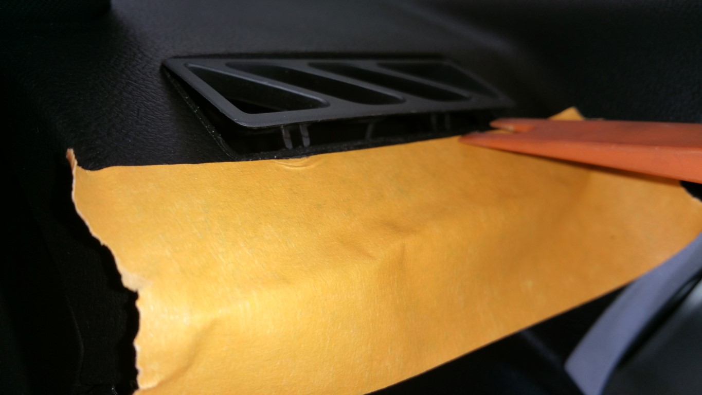

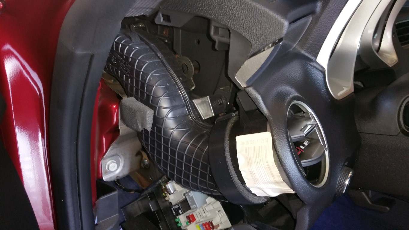

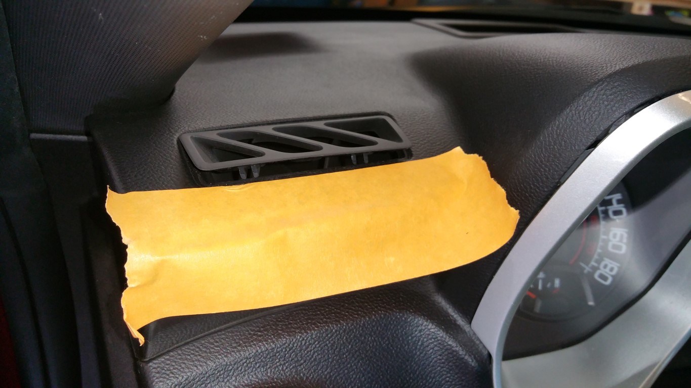

Next, I removed the stock vent:
Prepped:
Released:
Now, I test fitted the pod:
Next, I removed the trim on the left panel:

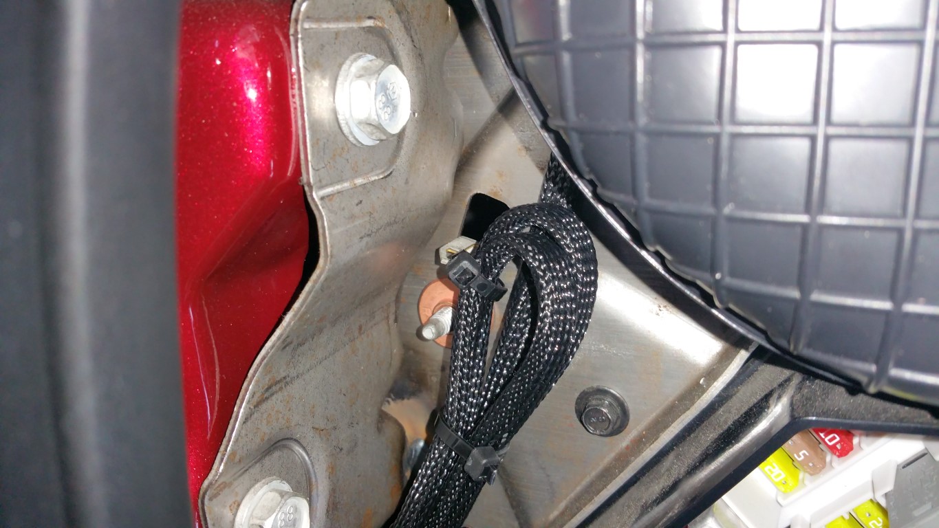

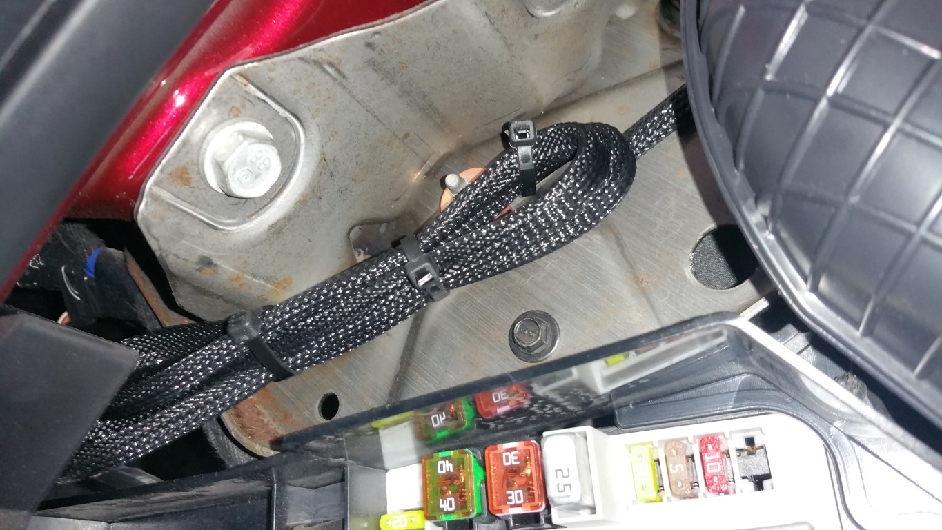

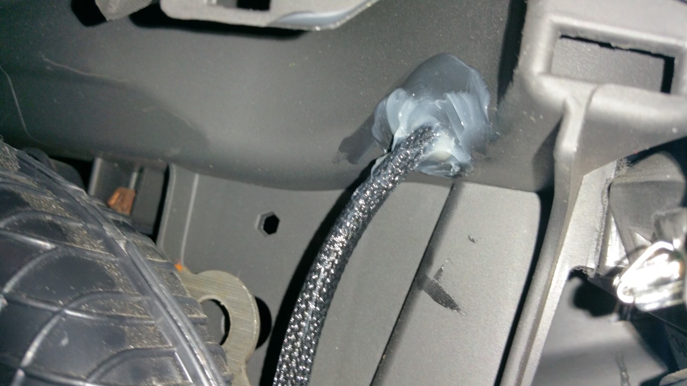

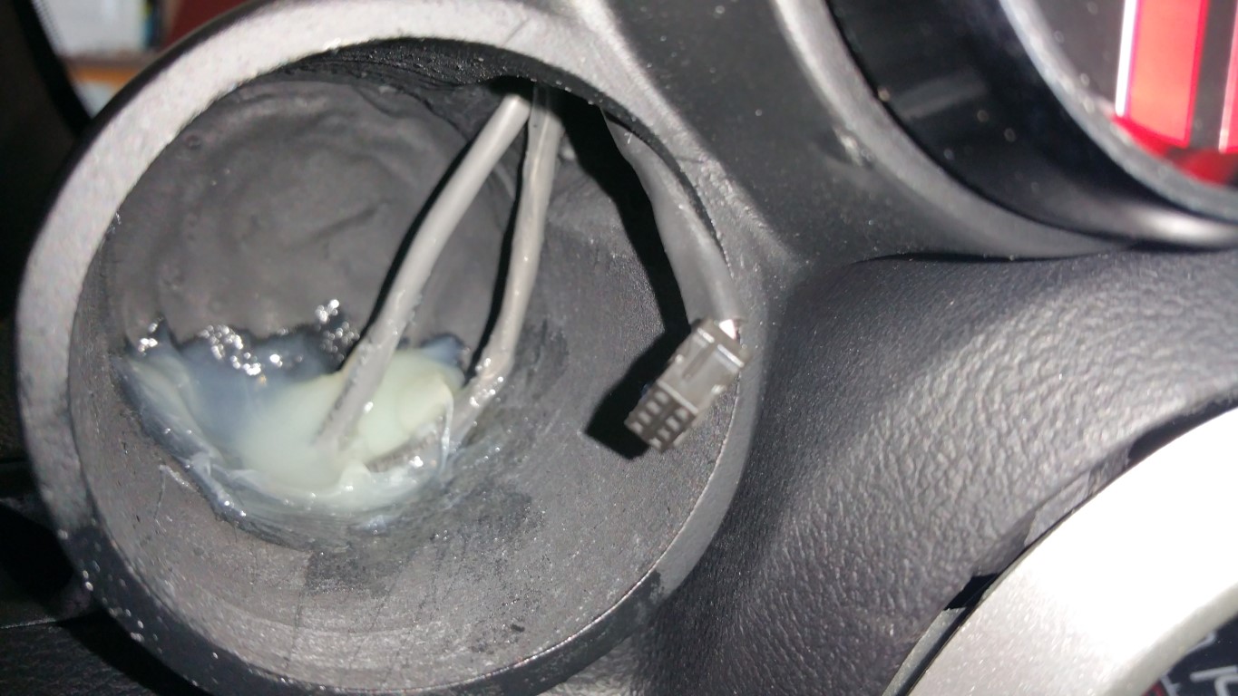

With the panel removed, I drilled a 13/32 hole so I could 'just' get the wire/connectors through:
Next, I routed the wire though the opening into the pod (I had to remove the pod to do this):
Wire routed in the pod and the opening filled in so NO heat/air gets in:

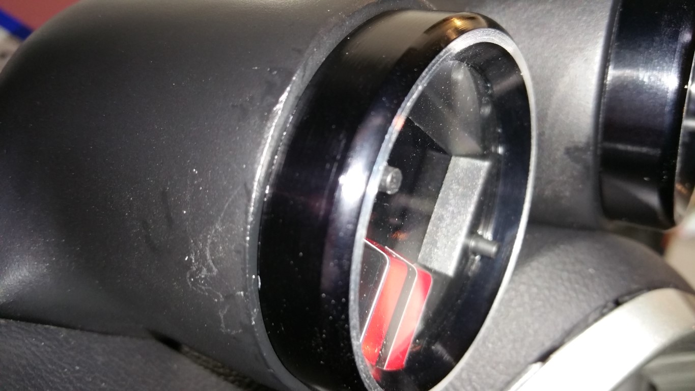

Installed the top gauge. I had to remove the 'tape' inside. I then wrapped electrical tap around the gauge so the gauge would fit 'tight' in the opening -- make sure to plug the connector in first!:
I filled in the 'drilled' opening where the wire goes in. I'll let it sit overnight (it takes 3 hours for this to cure):

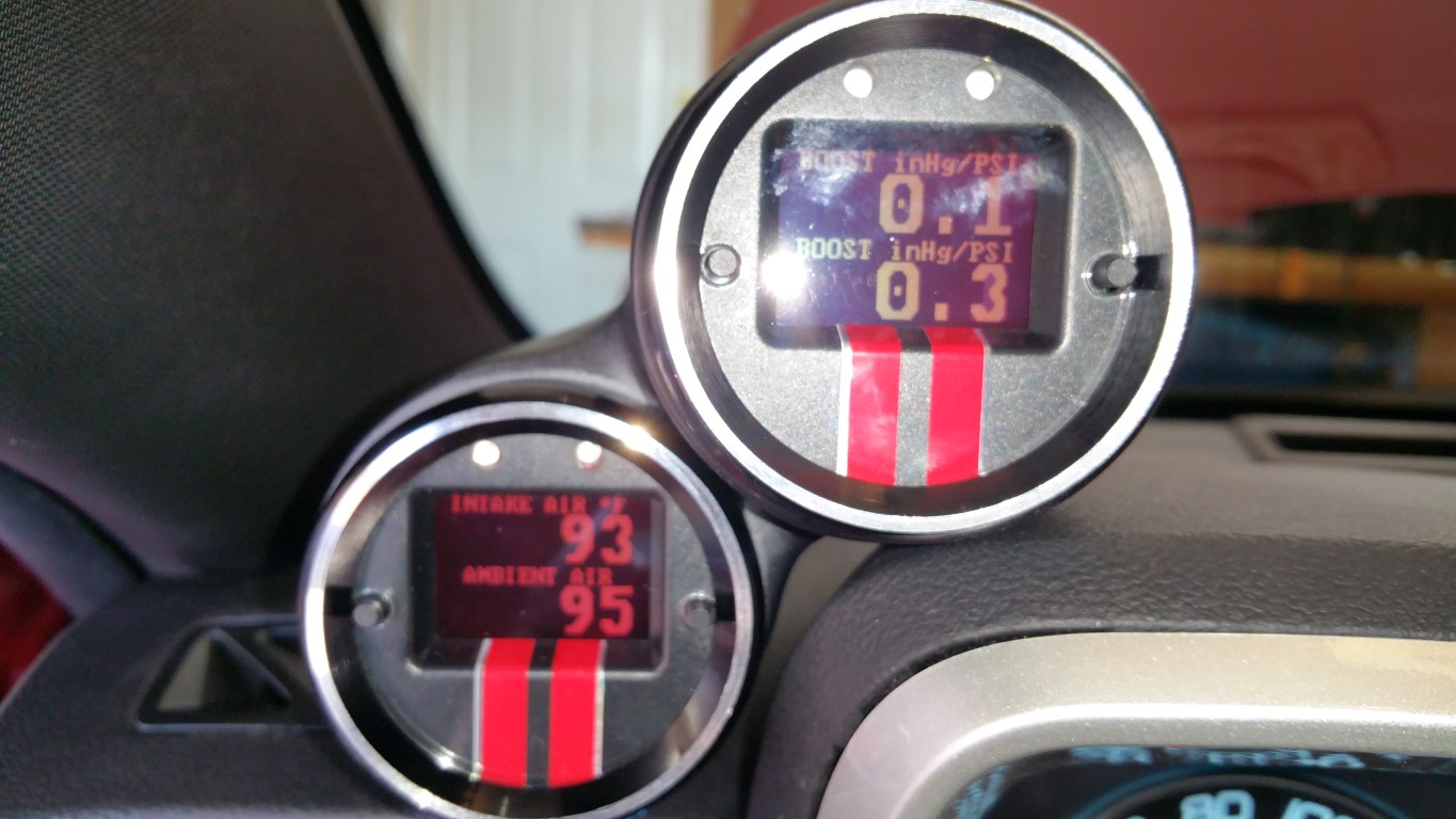

Well, I let the gauge sit overnight with electrical tape and -- that is a no-go. I went and bought friction tape (for the old schoolers - tape we used on our wooden bats for grip). hockey stick tape will work also, (About 3 to 4 wraps -- the pod is not 'perfect' circumference:

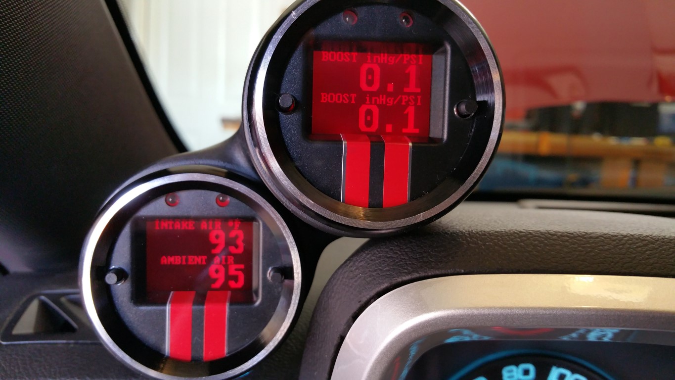

After that, I plugged in the connectors, followed the directions for choosing the items to display and tested!
Buttoned up and ready to go!
Now, I'll set the upper and lower parameters I want to monitor!
http://aeroforcetech.com/manuals.html
Here is the manual (3.8 is this version). It starts up showing CTSV -- wonder if they have camaro?
4 screens per gauge (2 entries per screen) so 8 screens with 16 entries (top/bottom) -- lots to review...

Well, to change the Startup Image, you goto setup and Logos
The Camaro is Camaro ZL1 and the SS are the only options -- none and CTSV are it...
SO, mine shows Camaro ZL1 (what the heck ;o)...

Gauges are AWESOME @ night -- really love the cycle display -- in the SUN, I'll invert the colors -- wanted and ordered blue, but the RED turned out perfect... GREAT @ night...
