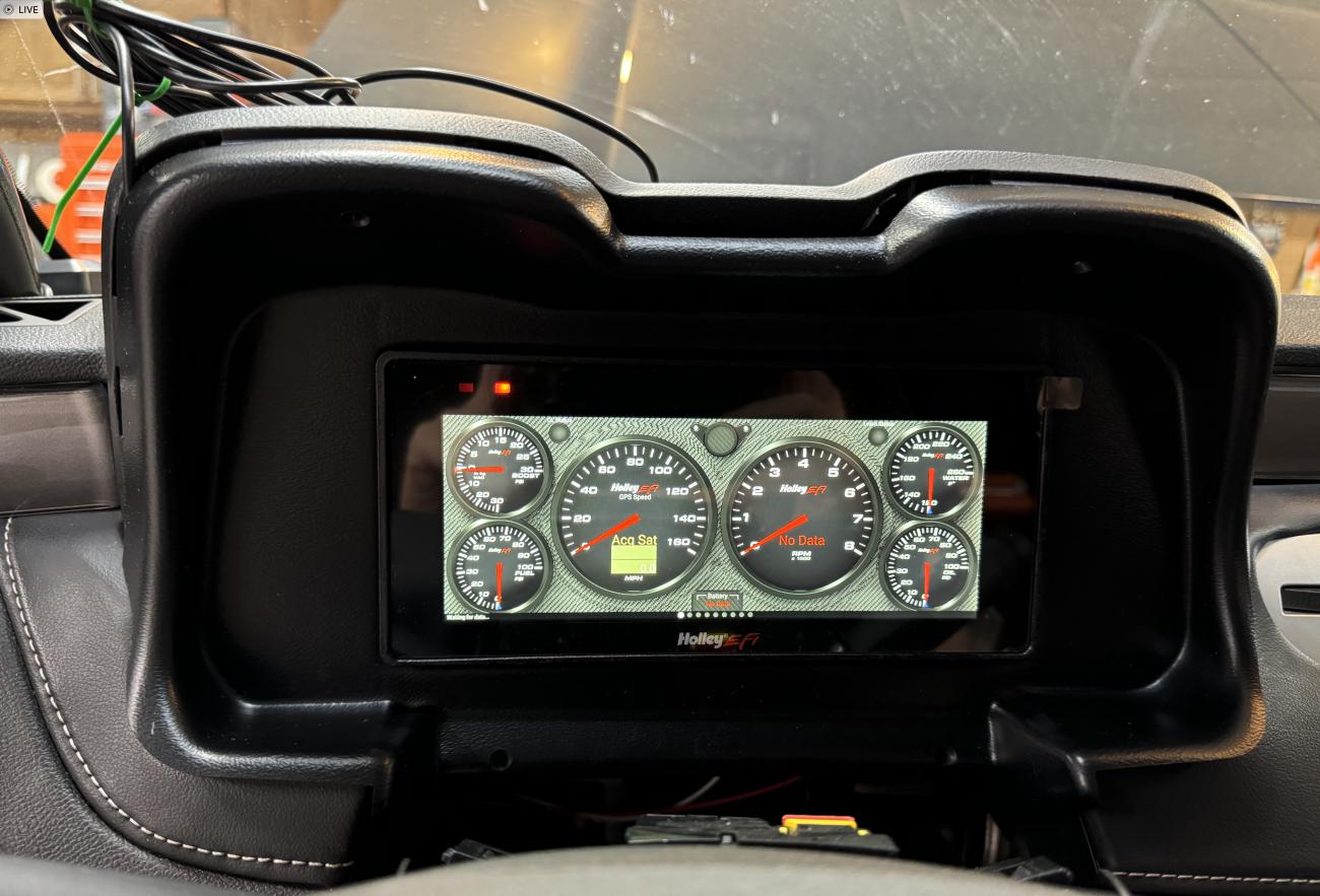

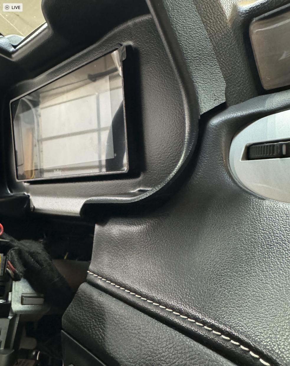

Been pretty busy with life and other stuff the last couple of weeks. Anyways. last weekend I got the Holley Pro Dash installed.
I drove it last night for the first time since putting it in and am digging it! I kinda thought I would loose the HUD when the factory cluster being removed but it still works. Whats odd is that the speedo doesnt work in the HUD but the tach and turn signal indicators still work. Thankfully the Holley has a GPS speedometer so it's using that. Now I just need to figure out the scaling for the fuel gauge in the Holley ecm. The Holley is showing a full tank but I was able to put in 17 gallons of e85 last night.. lol..
Name:  Screenshot 2024-06-30 at 5.24.51 AM.jpg
Pic of the first power up. bezel is still loose here.
Name:  Screenshot 2024-06-30 at 5.27.21 AM.jpg
The dash bezel is from Classic Dash and specifically for the 5th gens using the Holley 6.86 Pro Dash. Um, yeah its not a good piece but will have to work for now... Fit is crap, the screen angles down towards the floor a bit and is bit lower on the left side than the right side. ugh.. The instructions say some trimming might be needed to get it to fit flush.. I dont think there is enough material to trim it enough.. Not that I expected perfection with this piece, its certainly not what I expected for $250. Holley has thier version but I am almost certain it comes from the same place and cost is about $100 more.

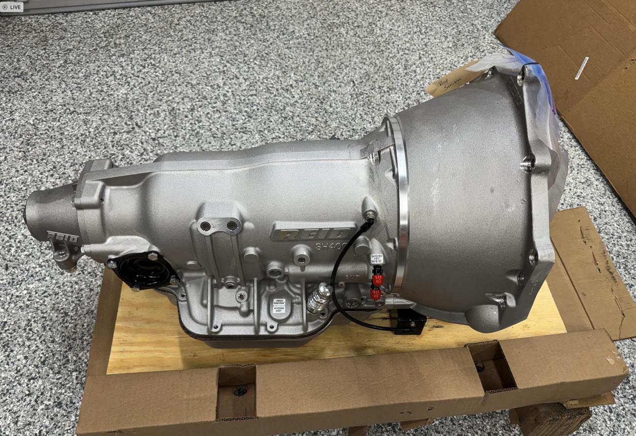

A few weeks back I called several transmission places and and talked through some options for my needs. I ended up going with Rossler Transmissions. Ordered a turbo 400 Terminator 4 with Reid SFI case, bell housing & roller bearing tail shaft housing. It has the Rossler billet aluminum internal trans brake, Rossler overflow tank and deep cast aluminum pan. They said it might take 4-6 weeks with a GM transmission case but with the Reid it would probably be sooner. Got it ordered and it arrived in just 2 weeks!!
Name:  Screenshot 2024-06-30 at 5.59.28 AM.jpg
Name:  Screenshot 2024-06-30 at 5.59.37 AM.jpg
Name:  Screenshot 2024-06-30 at 5.59.44 AM.jpg
Name:  Screenshot 2024-06-30 at 5.59.51 AM.jpg
Name:  Screenshot 2024-06-30 at 6.00.05 AM.jpg
Circle D converter has been ordered from GPI and still about 2 weeks out based on ETA. I have all the other parts except for a driveshaft, so I'll probably start the swap while waiting so I can get the measurements for the driveshaft. There is a local driveshaft shop I am going to call and see if they can do something or will get with Gulf Coast and get one made.

That transmission is very nice! What are you going to do for a shifter?
The dash looks great with the big Holley screen, agreed the fit and finish of the bezel is not great.
Great work as always!

Thank you! I have the Motion Raceworks Operator shifter for reverse manual clean neutral VB. It has Co2 actuator for the track.
