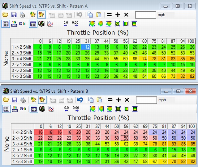

From what I understand, the MPH is more important. I'm also going to try changing the part-throttle shift tables since it's not even reaching WOT in 1st and 2nd. The part-throttle shifts ramp up slowly, but I'll basically be commanding them at a uniform speed, e.g. start the 1-2 shift at 24mph, when the throttle position is above 50%.
Attachment 352172
Padre
Gotcha, I haven`t really done much w/ it myself, my buddy was the one tuning it, I beleive he said he did something w/ the mph and the rpm from what I recall. Its been a while and my memory is not the best...lol.. Whatever he did it actually shifts now. I probably should put you guys together and see what you can noodle out.
