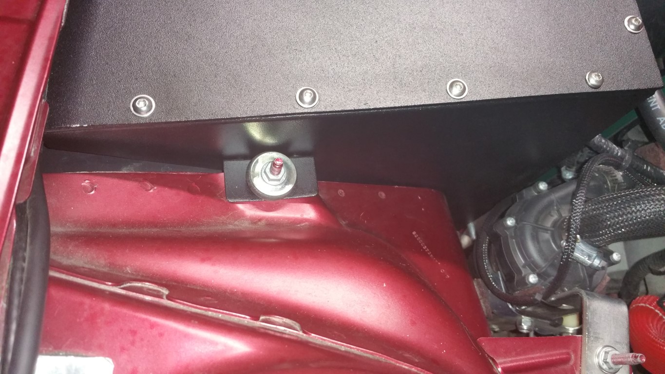

In the front, it fits against the bracing near the radiator. It's curved to fit against that area. The lower section is set against the frame. Once I bolted the two sections together and confirm they are both setup, I then tighten everything and bolt it down. I did reuse the stock rubber washer to ensure it was tight.

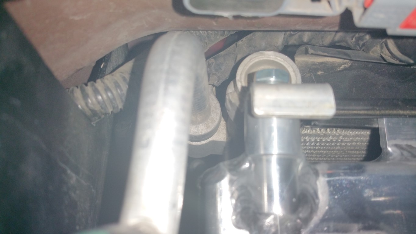

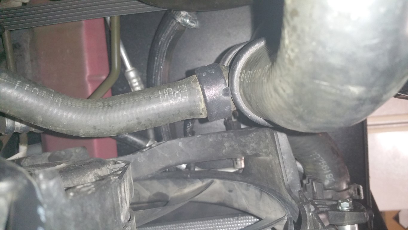

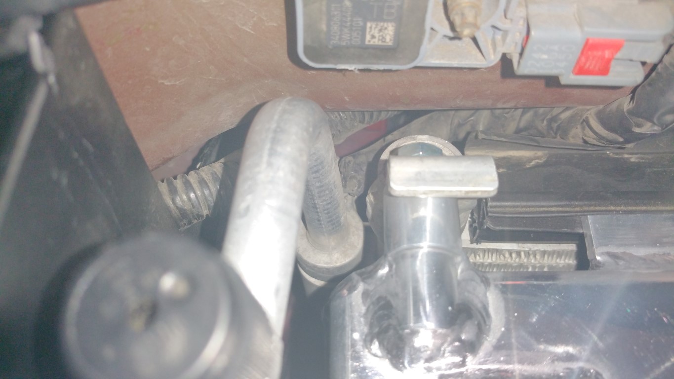

Old 09-27-2015, 04:25 PM   #512
Hard Parker
Hard Parker's Avatar
Drives: ZL1
Join Date: Sep 2011
Location: Phoenix
Posts: 1,524
2017 Camaro 1LE Nightfall Gray Metallic RIP ☠️☠️☠️
2017 Camaro ZL1 Black Exposed CF|Sunroof|6 Speed
Click HERE to follow my build!!
Click HERE to follow me on Instagram
#savethemanuals
Hard Parker is offline   Reply With Quote
Old 09-27-2015, 04:26 PM   #513
Hard Parker
Drives: ZL1
Join Date: Sep 2011
Location: Phoenix
Posts: 1,524
#savethemanuals
Old 09-27-2015, 04:27 PM   #514
Hard Parker
Drives: ZL1
Join Date: Sep 2011
Location: Phoenix

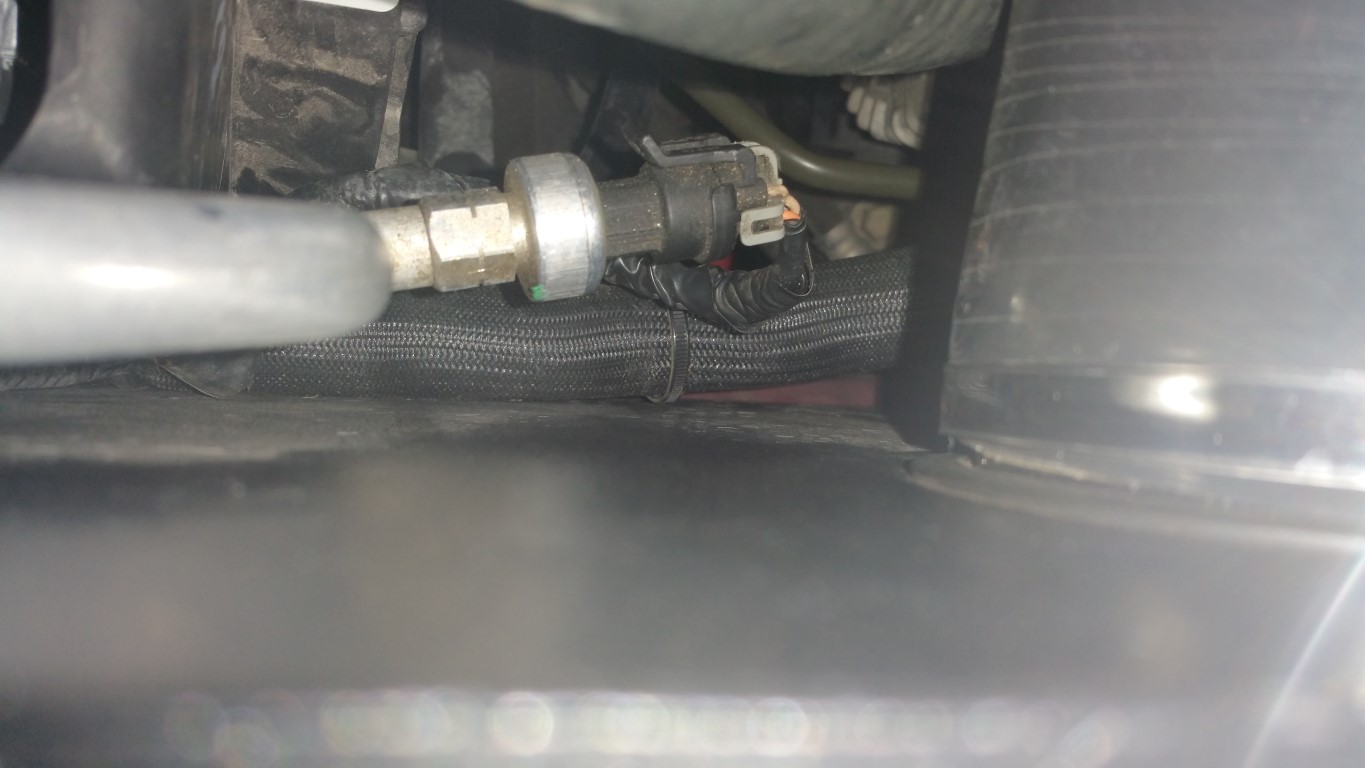

Posts: 1,524
#savethemanuals
Old 09-27-2015, 04:28 PM   #515
hammdo
'It's an experiment'
hammdo's Avatar
Location: Dallas TX
Posts: 8,709
Here are some pics.
Do note how the hold down is oriented -- you don't see the bolts that you assembled:
Note how it rests on the front:
Along the rail:
Make sure to remove the rubber grommet that is on the rail along with re-positioning the ac line as needed (the plastic hold-down on the rail may need to be moved also)
-Don
747 RWHP 794 RWTQ
