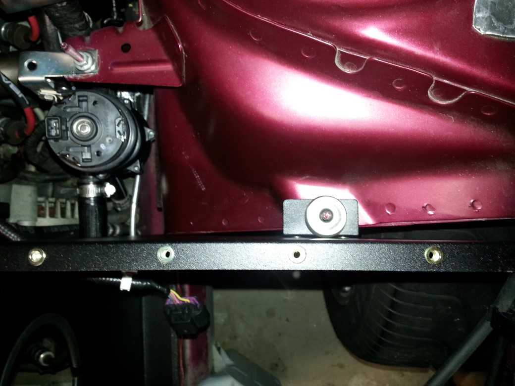

Here is mine lined up:
On this pic -- note the rubber grommet and the plastic clip holding down the ac line -- if the CAI clears that clip, you can leave it, otherwise that needs to be removed along with the rubber grommet. The pic above, I had to remove the plastic clip:

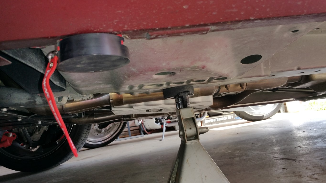

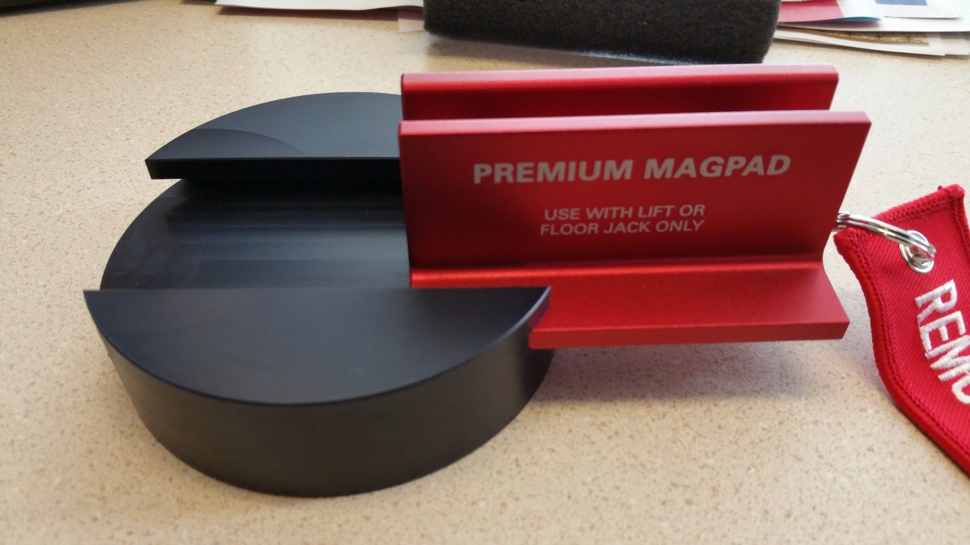

Well, my ZL1 Add ons pinch weld lift assist, Roto-Fab big gulp/washer bottle reloc came in!
ZL1- Addons:
I picked up my Race lid from ADM and left front splash shield from Huffines, so -- all go!
First, jacked up the car using the new pinch weld assist and hockey puck:
Worked great. Removed the wheel (of course loosened first before jacking up) and removed the splash shield. Once that was off, then came the washer bottle and left front brake duct.

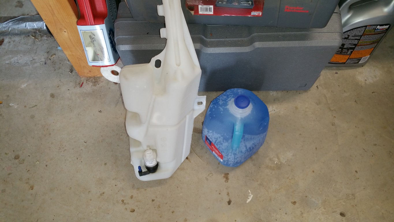

OEM washer bottle hold over 1 gallon!:

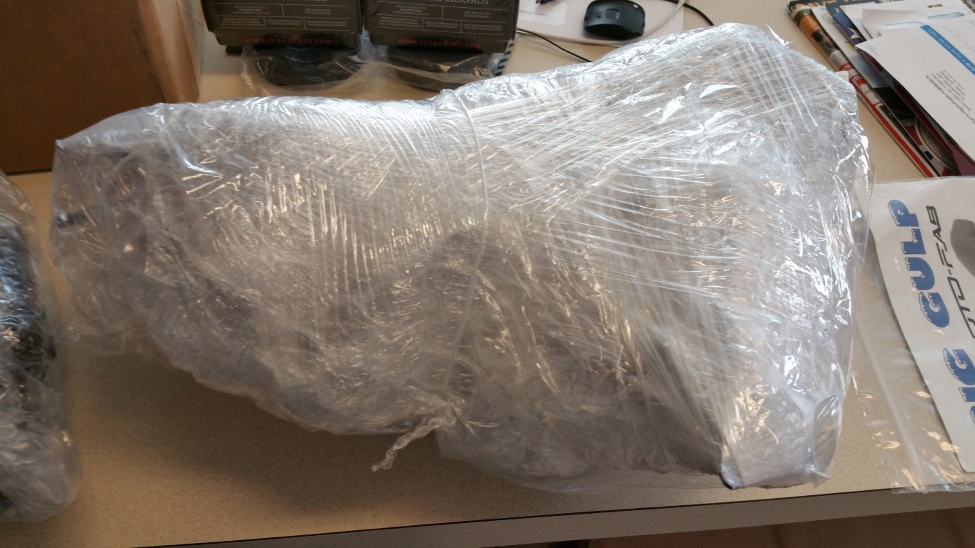

Packing from Roto-Fab was excellent (DynoSteve from RDP got these for me quickly):

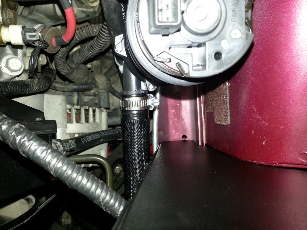

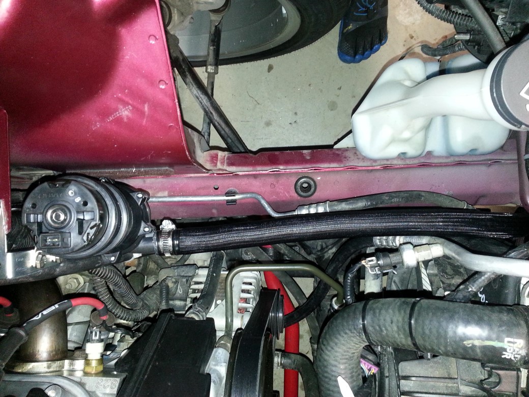

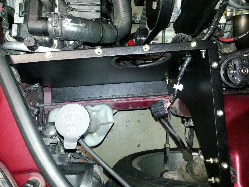

Fitment of the big gulp:
The Washer reloc took 5 minutes to slide it and bolt up! (yes I did hook up the hood release cable):
Washer motor relocation per instructions:
ADM Race lid:
Roto-Fab Big Gulp in splash shield (using Roto-Fab supplied bolts, perfect!):
Ah, as the splash shield should be:
The ground area just drove me nuts -- this gave me a reason to fix it!
Great products and service all around. I had to call Mike @ Roto-Fab to verify the big gulp on my ZL1 Conversion -- worked perfectly! Great products from ADM and Roto-Fab as well the service from DynoSteve from RDP!
