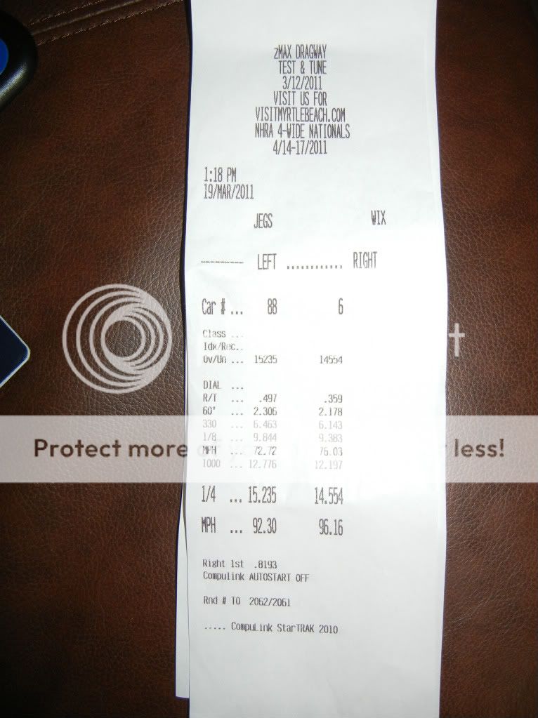

Ok here is another timeslip
Car #88 was another members car, who has the RS package as well thus the same wheels and tires. He ran a couple laps yesterday and last week, and he was getting 15.5 secs runs both weekends. The DA conditions were similar.
You guys can see in the slip that I am a .789 secs faster than him. On his next run we were side by side, but 1 car apart and same numbers popped up. So I am guessing that my car has had some serious improvements over a stock v6. But the conditions here at Zmax are kicking the Quarter mile times' ass.
