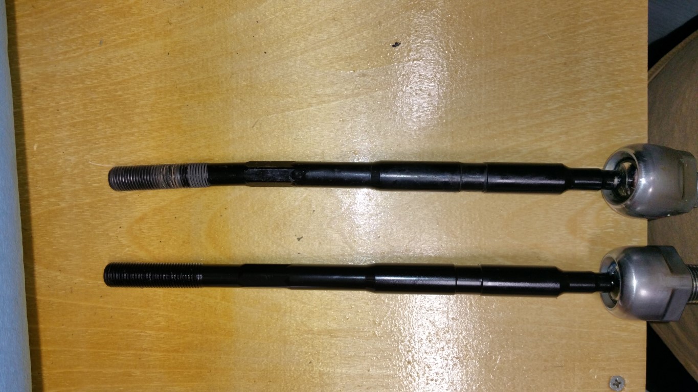

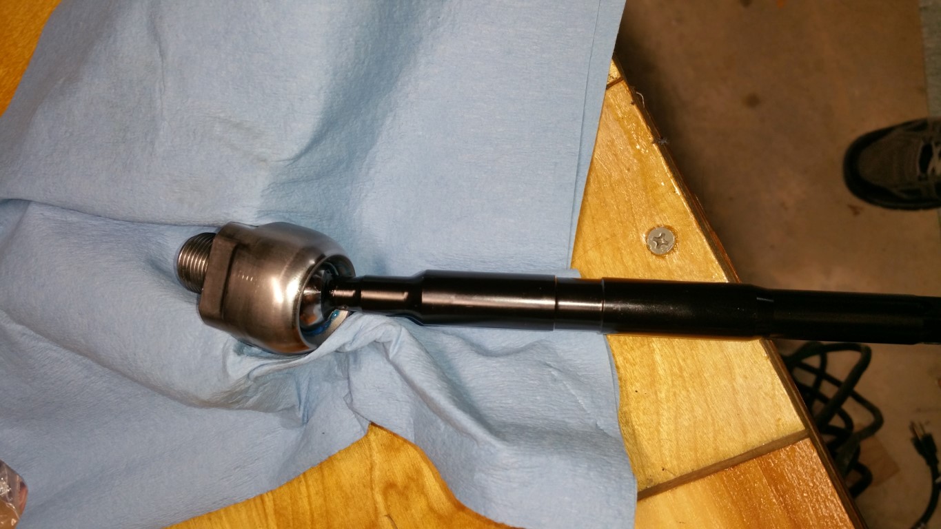

Well, I began installing these new outer toe rod ends, and, wouldn't you know it, I found the left inner toe rod is bent! I know I didn't bend in, so it must have been that way when I bought it. I've had this aligned twice, and no mention of it (since the toe was always 'correct' to begin with) ...
So, I'll need to replace it, but, since I'm in there, I'll replace both to ensure no 'loose' parts. Ugh, but I'm glad I found it...

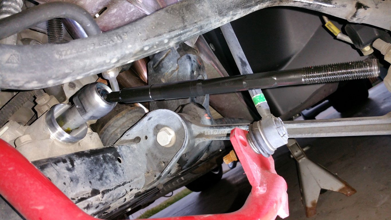

With that I proceeded to remove the inner tie rods.
Here is a video on YouTube that is very good:
Here is the 'bent' inner toe/tie rod vs the new one:
No wonder my alignment was going off.

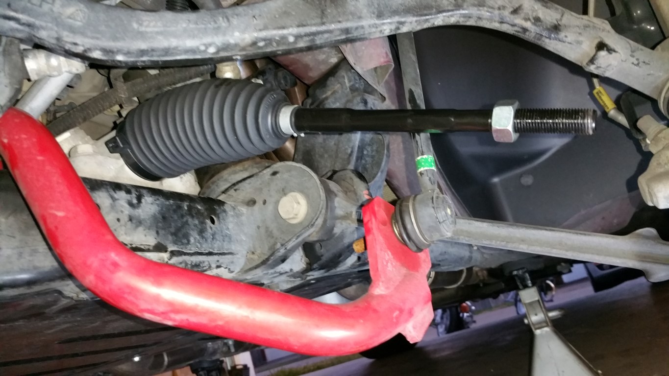

After installing the new inner rods (make sure to use RED loctite and clean the threads inside the rack and pinion) and boots:

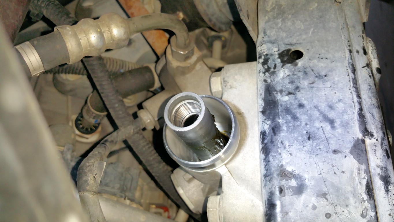

I did 'break loose' the inner tie rod:
Threads to clean:

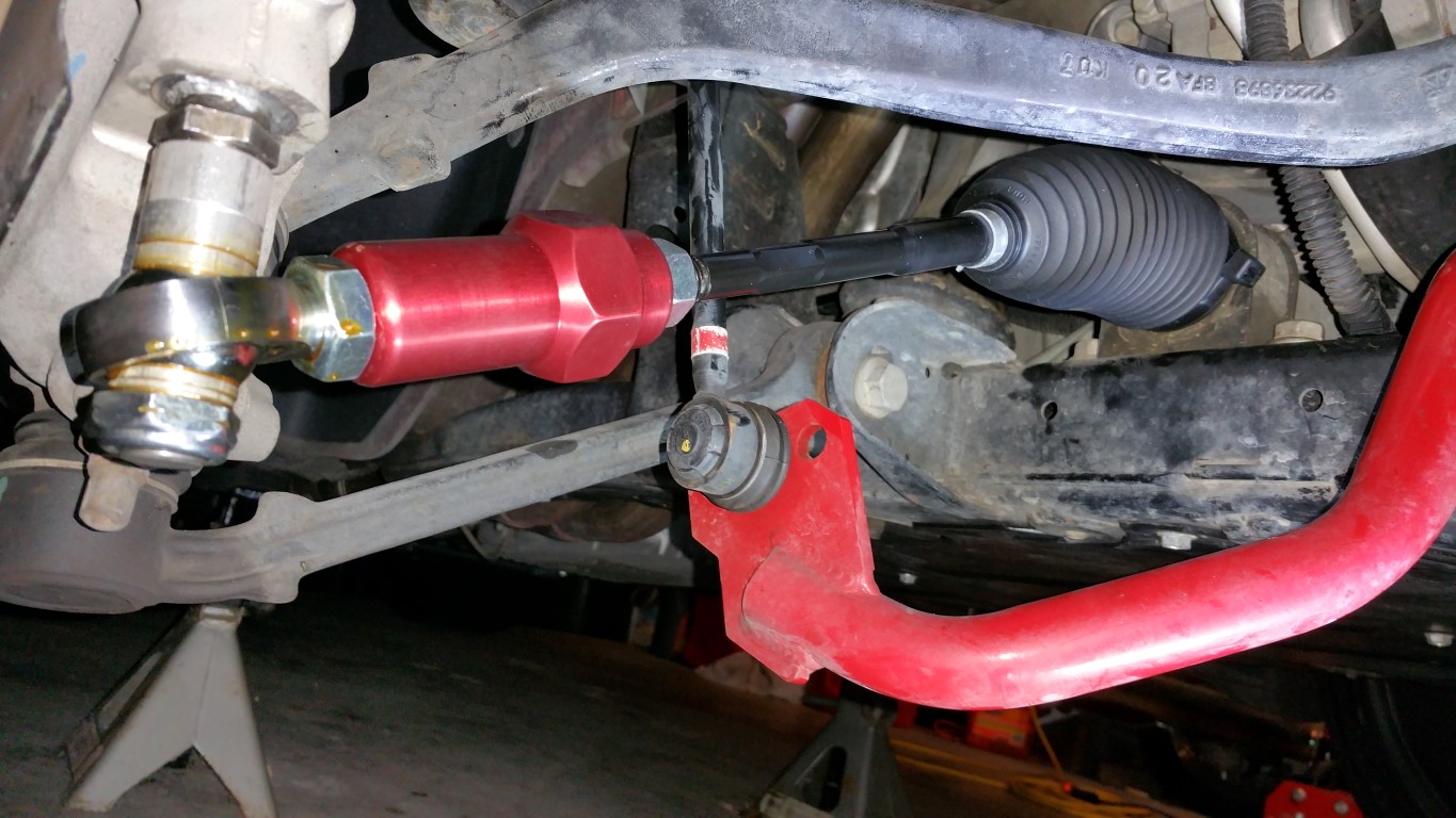

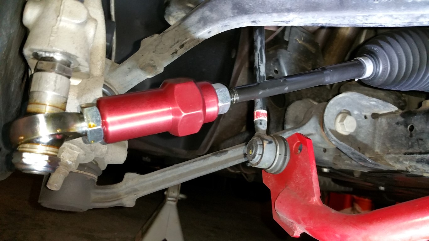

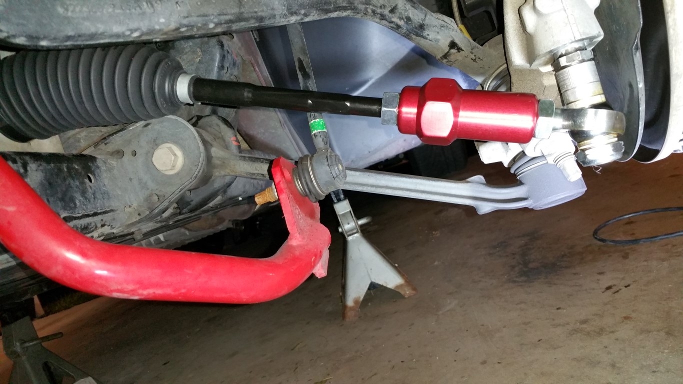

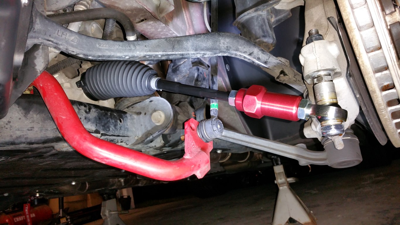

I then installed the Razor Bumpsteer kit:
Left side:
Right:

OK, finished the toe adjustment using my QuikTrick -- worked great! Dead Nuts 0 toe with steering wheel straight! Bump Steer kit is parallel with the Lower Control arm and adjusted -- noticed the difference on bumps and turns!
