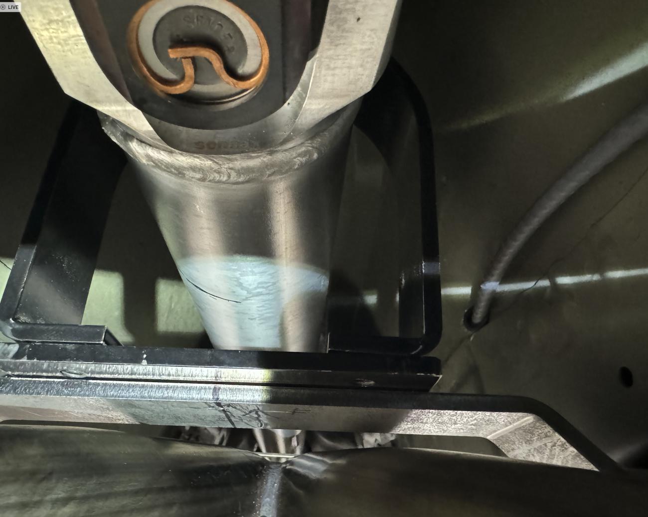

After getting the exhaust on the only thing left that I hadn't tackled is the driveshaft safety loop. The Metco loop for the 6L80 will not work since the T400 since it uses a different crossmember (or at least I used a different one). So I took a piece of 1.5" wide 1/4" thick steel and tried to bend it to make a crosss brace the loop could mount too. Bending that was not only a chore, but couldn't keep it straight at all. So I put the measurements into Sendcutsend.com and after $38 and 8 days I hade a properly bent piece of 2" wide steel. And I didnt get any pics of that before I started..
Anyways, I cut down the main part of the Metco loop and welded it to the top of the new brace.
It rides just above the exhaust and is right at 5.5" behind the center of the U-joint. Most tracks that require a driveshaft loop follow the NHRA rule of being within 6" behind the center of the U-joint.
Name:  Screenshot 2024-10-14 at 5.43.40 AM.jpg
Passenger side (looking forward)
Name:  Screenshot 2024-10-14 at 5.43.46 AM.jpg
Driver side (looking forward)
Name:  Screenshot 2024-10-14 at 5.43.52 AM.jpg
Name:  Screenshot 2024-10-14 at 5.43.59 AM.jpg
Since my wife has been out of the wheelchair for a week now I plan on heading to a track this coming weekend and test out the new trans and exhaust (unless I decide to pull it off lol).

While waiting on the oil to drain I took a couple of pics of the driveshaft loop without the exhaust in the way.
Name:  Screenshot 2024-10-26 at 6.48.38 AM.jpg
Name:  Screenshot 2024-10-26 at 6.48.26 AM.jpg
