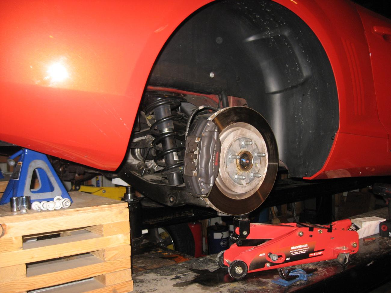

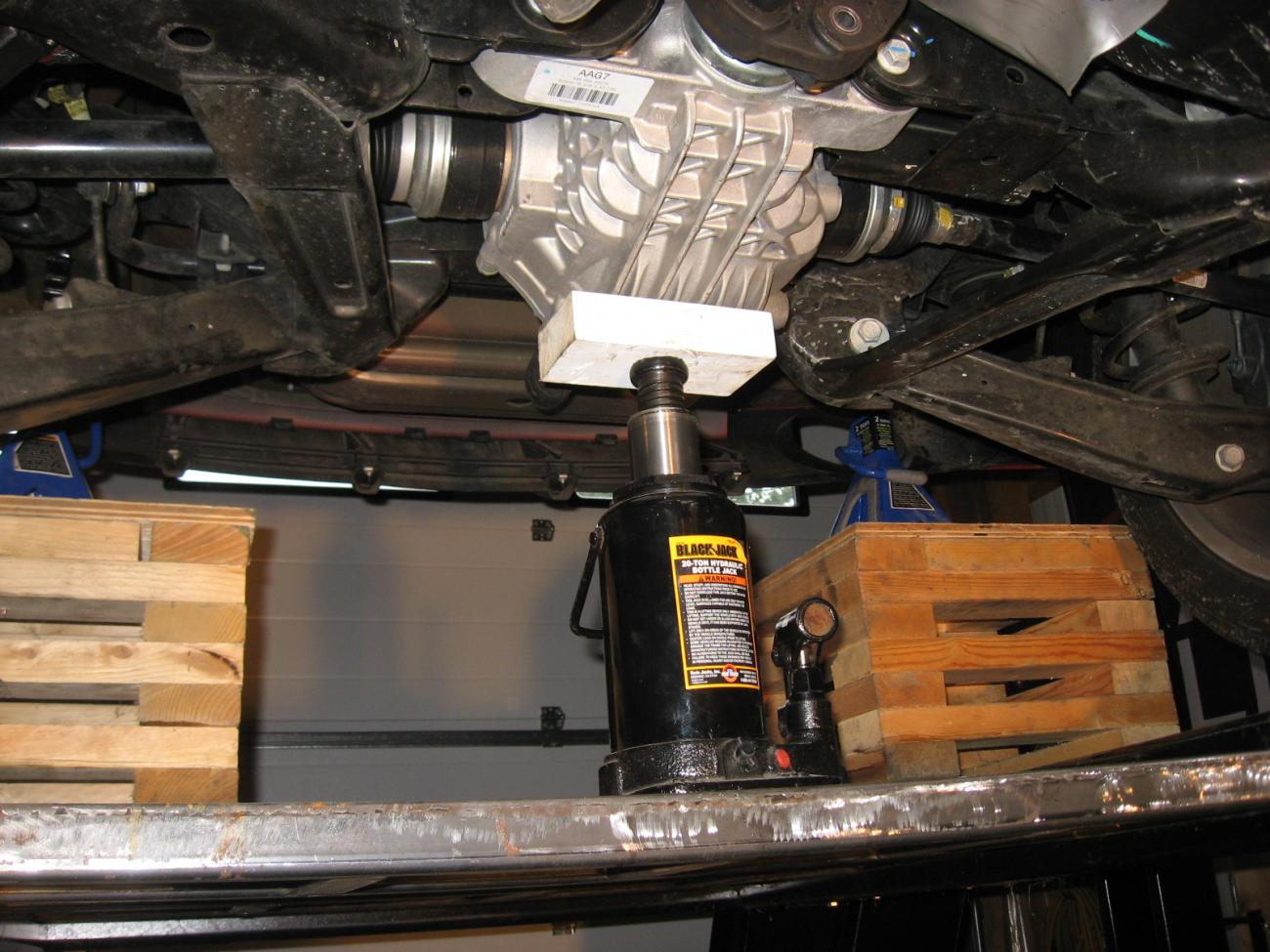

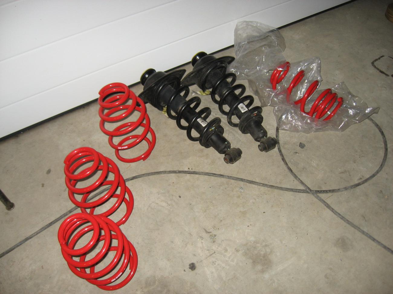

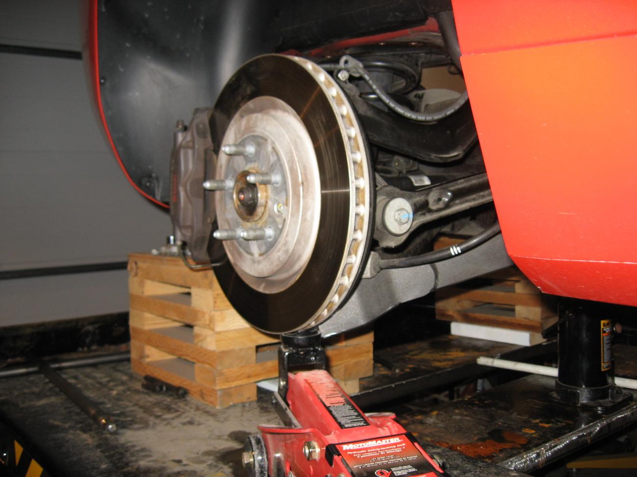

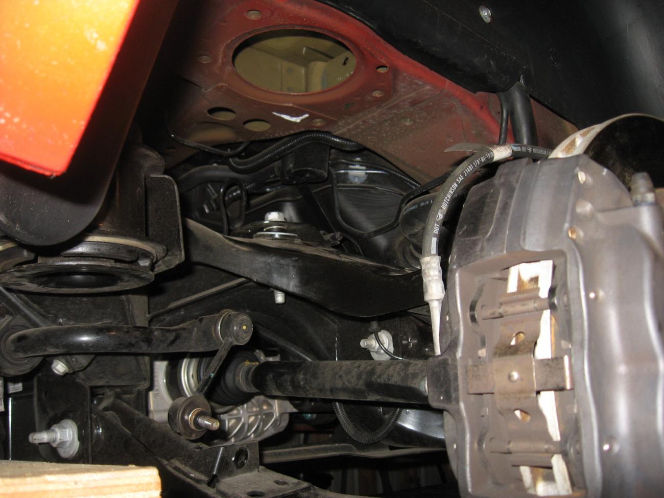

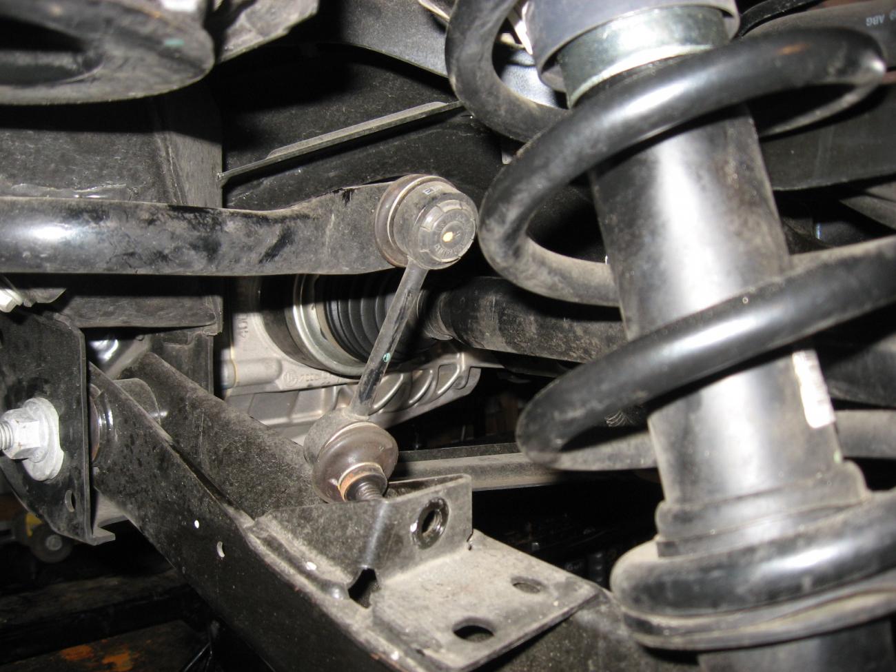

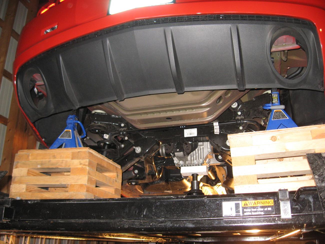

Suspension Day #1
With help from my buddy Bill we got Pumpkin into a million pieces. Got the bushings to press out of the rear upper control and change springs on the rear coilovers. Then were ready to put Pumpkin back together.
