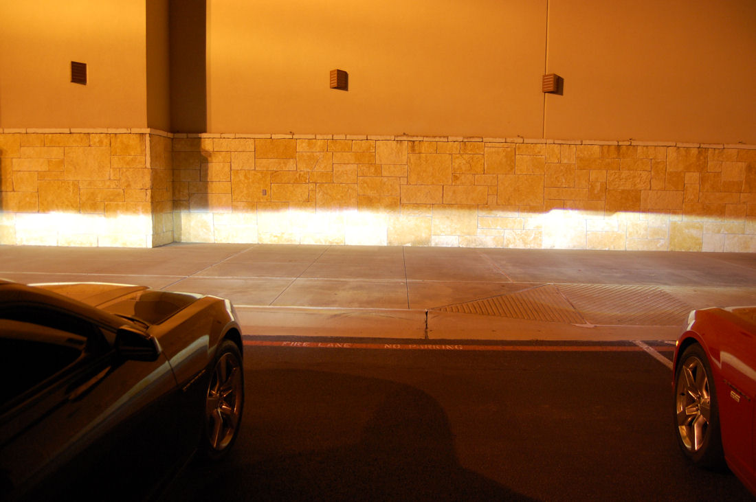

We had a small Camaro5 meet up last night. I had a couple of RS cars line up against a wall with me so I could compare the Morimoto to the OEM HID.
The cut-off line on the Morimoto is definately more crisp. I never noticed the drop down in the OEM HID until we lined up. Then we were able to see it. The drop down on the Morimotos is obvious.
Did I mention how much I love these retrofits.....
