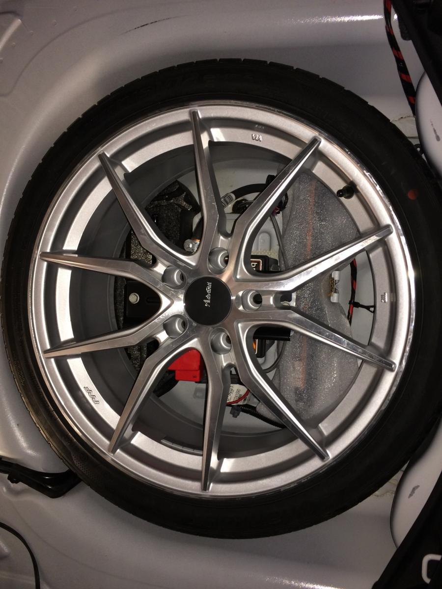

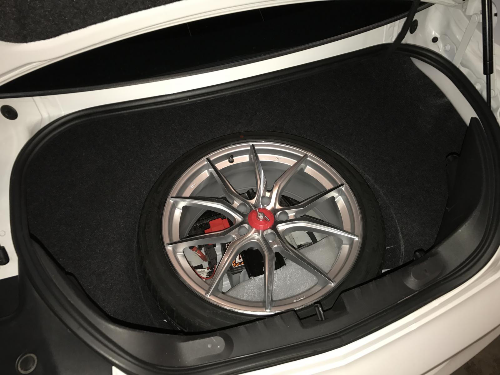

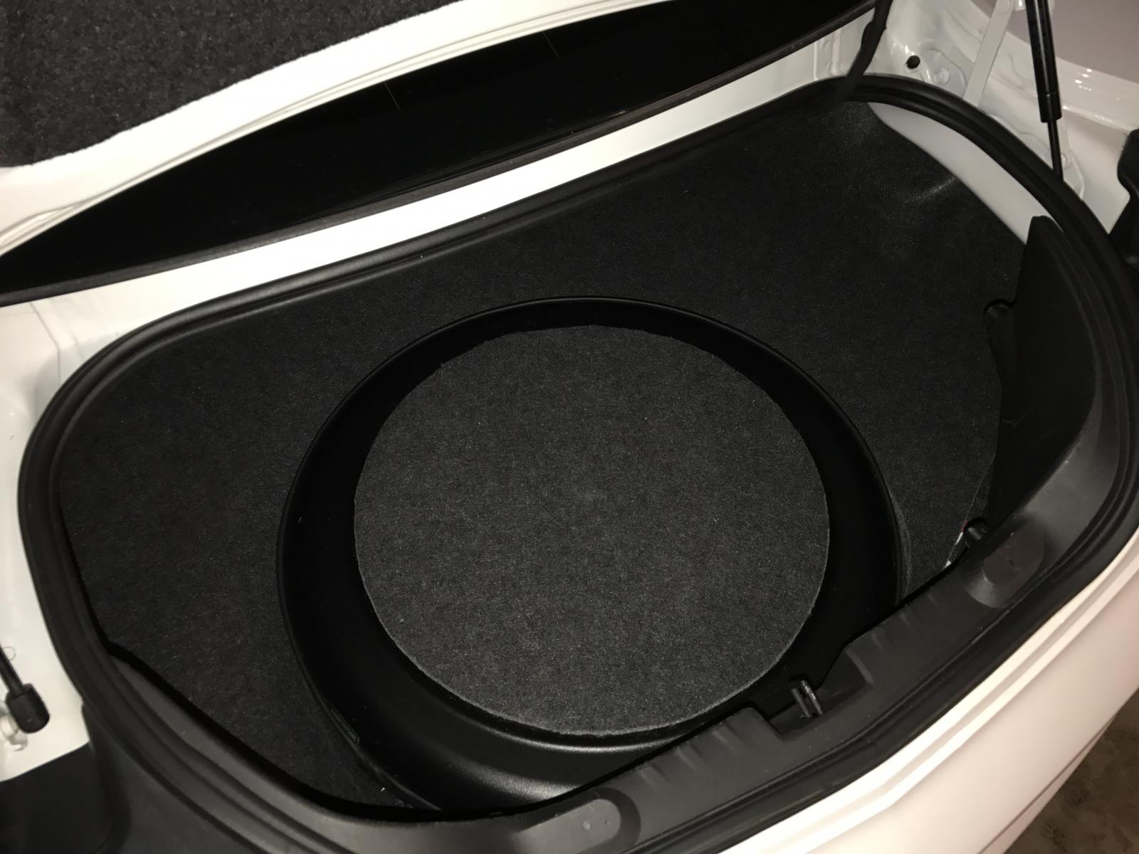

Good spare tire solution for 5 gen Camaro owners with 19" wheels
Here is what I recently completed in my 2010 Camaro SS. I have the following tires on my car Michelin PSS 305/30ZR 19 (102Y) rears and 275/35ZR 19 (96Y) fronts, so a 19" spare is great. Reasonable cost for total peace of mind to drive fast and not be towed and keep trunk space. Sticks up 2" from trunk floor level. Looks good!
Spare System:
1. Matched spare wheel diameter 26.1" vs 26.2/26.6" to be within 0.5". Wheel:
Advanti Hybris 19" x 8.5" close look to my Forgeline wheels. Tires: Hankook Ventus V12 Evo2 225/40R 19 (93Y). Materials plus mount and balance and shipped from Tire Rack was $460.
Total spare wheel/tire weight 53.6lbs
Jack 23175599 $39
Jack handle 13503936 $24
Extension 25892542 $11
Foam container 92200810 $8
2. Add wheel cover (but doesn't look bad without cover but may drop stuff down wheel well). Toyota RAV4 (1995-2000) 27" rigid tire cover (plastic with vinyl stretch band) $95. But to anchor spare wheel and tire down:
Drill hole in base plate over battery, cut to length and secure 12" x 3/8" thread with locking washer and nut on both sides of plate. Use plastic drain plug and 3/8" wing nut from Home Depot. FYI The wheel cover does not contact the wing nut.
3. Optional: Cut out 20" circle from carpet and glue to plastic wheel cover. Every 2" around cut out, cut slit for 3.5" in length to match contour of wheel well.
