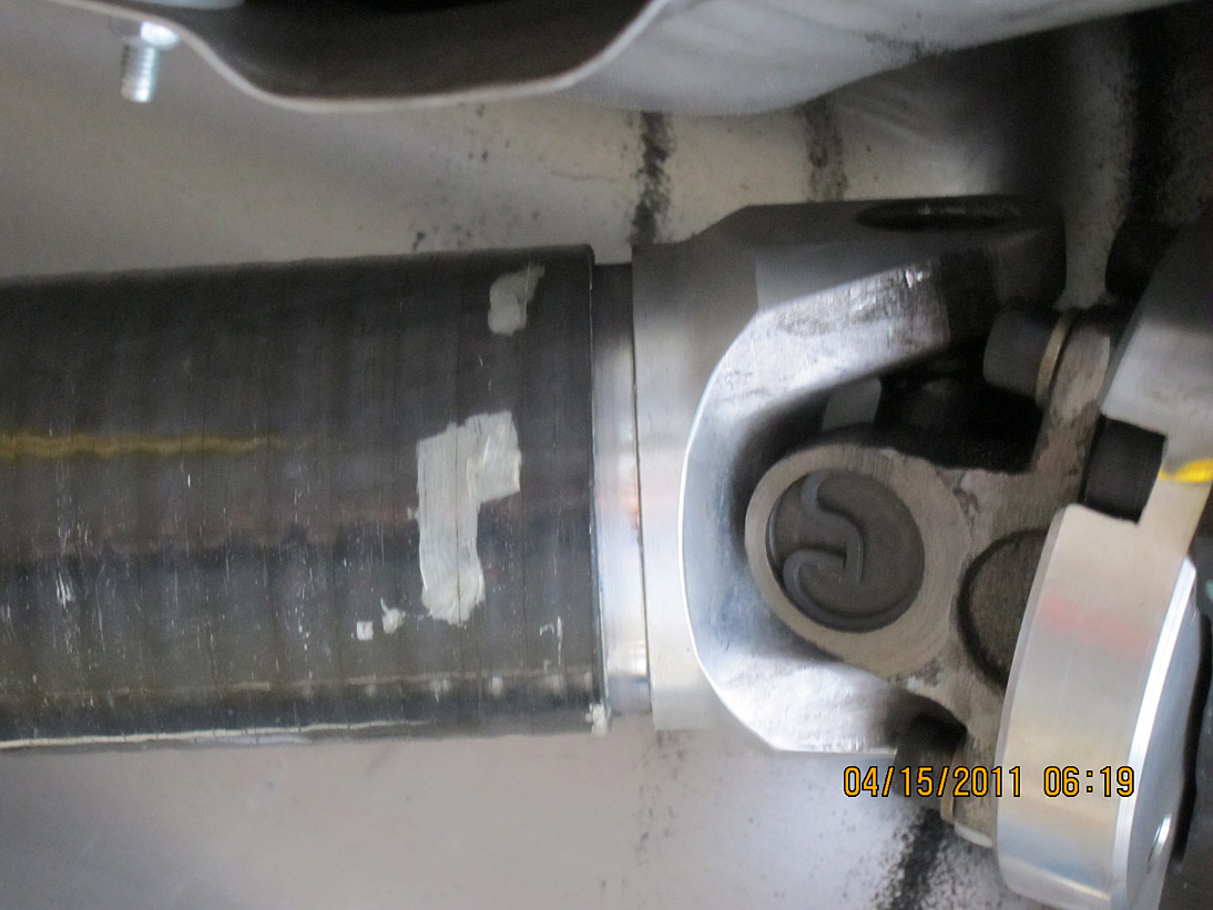

Well he said he's getting an oven that can cook these things at 400 degrees for 6 hours and that, according to 3M, will make these things solid. He thinks that when he was putting in the aluminum yoke on the trans end of the tube, it was causing the glue on the diff end to squeeze it's way out of the joint towards the inside of the tube. He's going to cut mine in half when he gets it back to see what happened to the glue. Apparently this particular glue takes a week to cure up if you just let it air dry.

So where was the failure point, trans or diff end?
And you are saying that it was installed and run before a weeks' time had passed to allow for this "curing" to take place? If not, this is an irrelevant point...
I'm def not warm and fuzzy about this now...
The failure on mine was on the diff end. No it wasn't installed and run, but during assembly as Frank explained it, the aluminum joint on the diff end is inserted first and then the assembly is turned over and the joint for the trans end is inserted into the tube and it takes several hammer blows to get it to seat all the way into the tube. He says he suspects that the movement/action of hammering the trans end is causing too much glue to squeeze out of the diff end. He's going to cut mine down the middle to see where glue went and how much stayed in the area of the joint.
He said he let mine sit for 2 weeks before shipping it so it would have been fully cured. This guy makes shafts for all kinds of racing, including Nascar teams, drift teams, drag teams, etc. I spent awhile talking with him last saturday and I'm sure he'll get this worked out.
Here you can see what mine looked like. Nothing was actually damaged, the tube was just spinning on the joint because the glue let go.

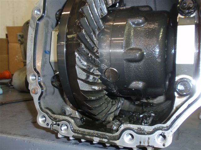

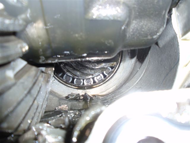

Here's some pics of my diff, got it out today. Good news is that the case wasn't damaged, just the junk Richmond 3.73 ring and pinion. I can't wait for the new Lingenfelter AAM 3.91 gears to get here. I shouldn't be able to break them....
