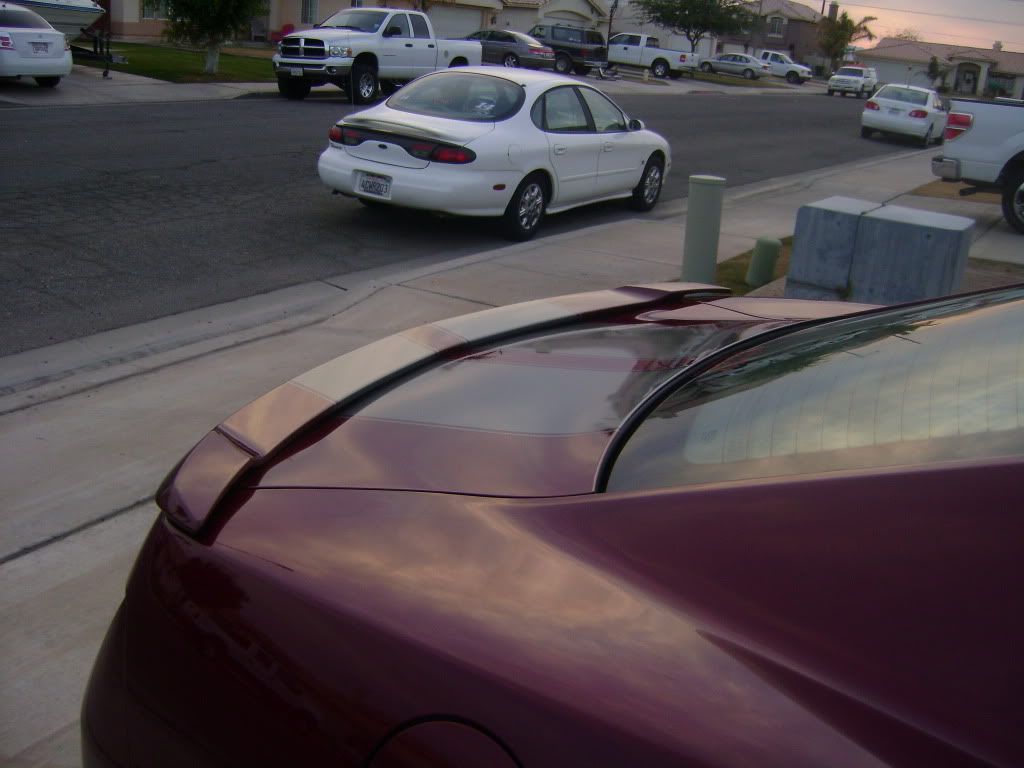

Originally Posted by VenomZ302 View Post
Hmmm... So is there a pretty similar spoiler that uses the stock '10-'11 spoiler holes? I love the spoiler, but I'd like to be able to revert to the stock spoiler, if I so choose.
I don't even need the extra brake light, as far as I'm concerned... Anyone seen a spoiler already on the market that's been designed fairly closely to the ZL1 spoiler?
On my car I swapped out the original spoiler for the one off of the convertable. As far as I am concerned this looks a hell of a lot BETTER.

The convertable spoiler is Wider, Thicker, and TALLER then the stock coupe spoiler.

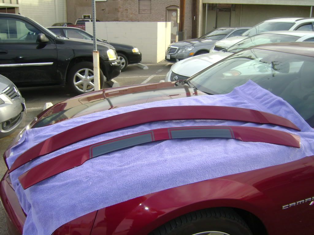

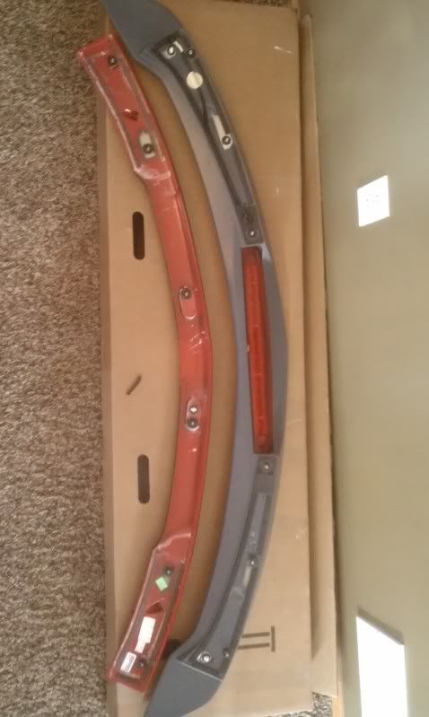

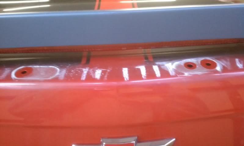

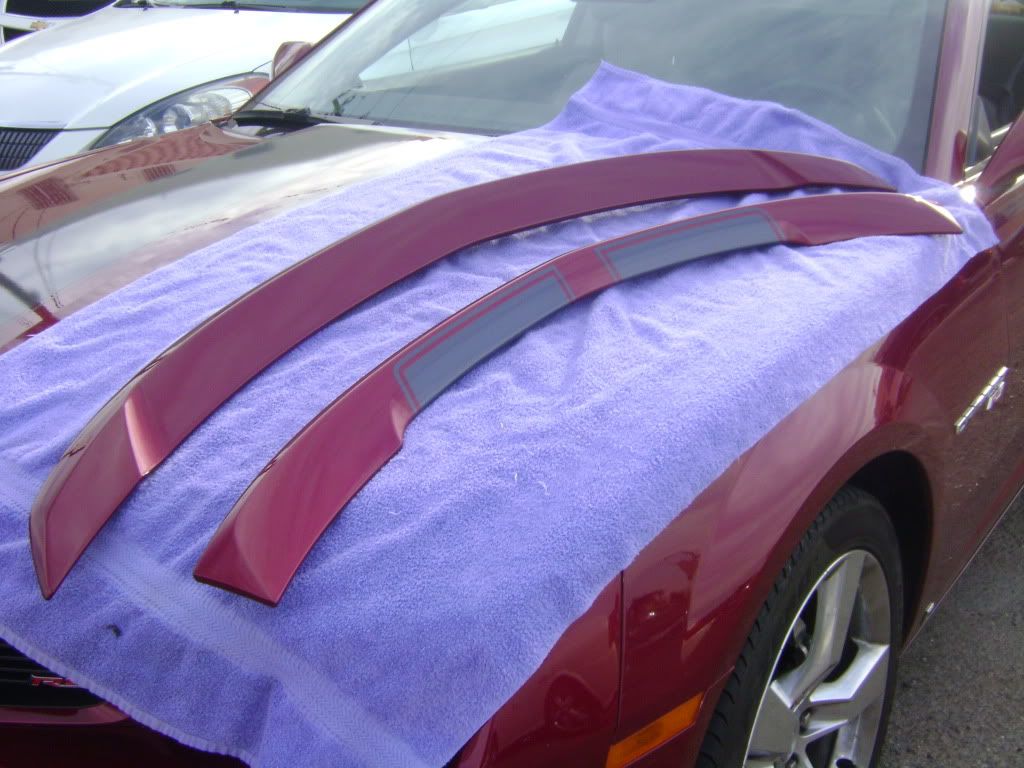

Originally Posted by Ray@RDS View Post
Not all of them are in the right place for the ZL1 Spoiler.
Looks like this is a Win Win for the non spoiler Camaro's
For the SS crowd NEW holes need to be added, and some need to be Filled in.
here are some pic's:
side by side pic
pic showing holes NOT covered.
and one with ZL1 Spoiler set in place.
So. I had to add 5 holes and will be removing 3.(filling in)
Wiring will also need to be addressed for the 3rd brake light.

No, the ZL1 spoiler does not come with the connector and it also has a male connector on the light end. A new harness needs to be made for it or bought through GM. I had my rear deck lid off last night to just tap in and lengthen he wires but no joy

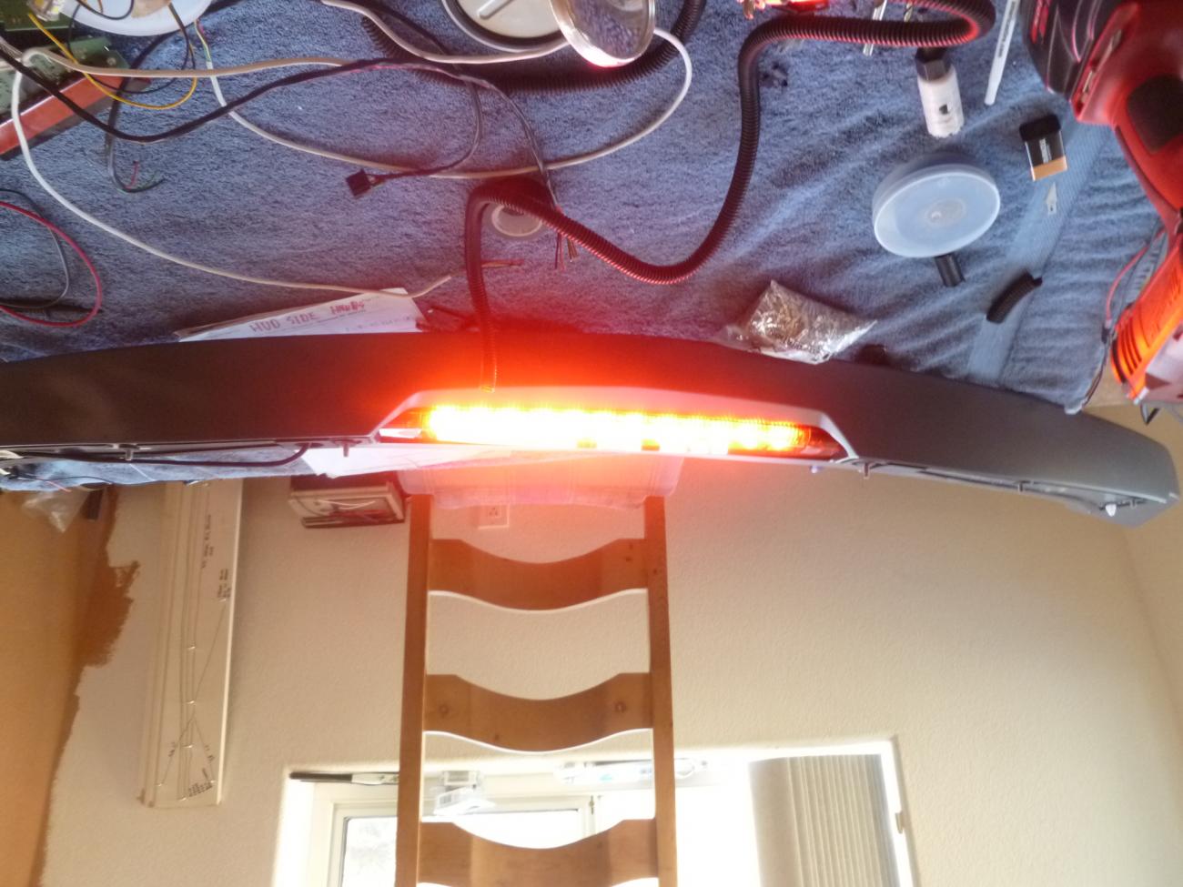

So i got the rear ZL1 spoiler, working on a harness now.
Old 01-16-2012, 06:21 PM   #52
2SSRS@Gen5diy
2SSRS@Gen5diy's Avatar
Location: By the lake in AZ
Posts: 15,728
Got the brake light to work, now to see how long the wires need to be and there done.
Old 01-16-2012, 06:38 PM   #53
2SSRS@Gen5diy
Posts: 15,728
Any one have there top tray apart and want to tell me how long the wires need to Be, Now for the funny part, The connectors are used in a lot of the mods we have.

So i looked and its 8 Ft for the harness, Price went Up. LOL
