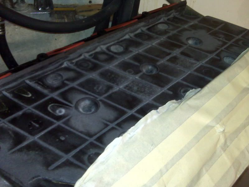

Then here is something I was really excited to get out of the way. I went ahead and undercoated just the transmission tunnel, all the way back to about 6" behind where the shifter will be. I also undercoated up into the engine bay just a little bit. I wanted to get the tunnel done so I can get the motor and trans in next weekend. I'll undercoat the rest of the car once it is running and I can take it up to my friend's work and use their lift, because doing it all on your back with the car 2' off the ground kind of sucks.
More of the undercoating. I made a fine line between blue and black on the trans tunnel, I think I like it this way with it coming into the frame rail in the engine bay. What do you guys think?
