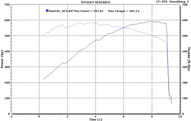

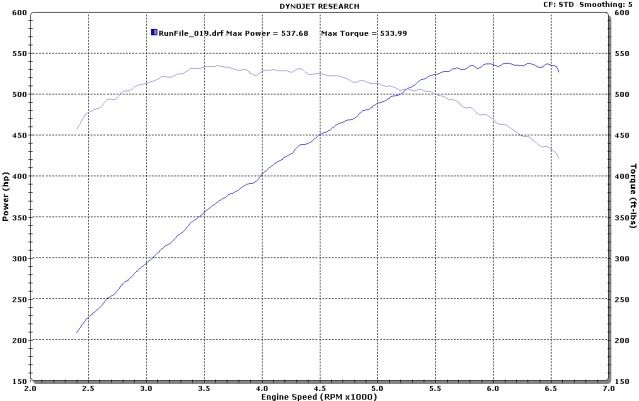

Update!
Sorry to keep everyone waiting. The dyno run was completed this morning but this is the first chance I've had to post the results.
The addition of the American Racing Headers to our TVS system exceeded our expectations! With a makeshift air filter set-up and AR headers at 7.5lbs of boost we witnessed a 77hp jump at the rear wheels resulting in 569rwhp. This translates to a bhp jump from 576 to 667 and brings torque to 641ft/lbs! For future reference, we then decided to make a power pull with 10lbs of boost. As you can see from the dynograph below, horsepower jumped to 591 at the rear wheels (695 at the crank)!
MTI Racing TVS system with American Racing 1 7/8" headers @ 7.5lbs of boost.
MTI Racing TVS system with American Racing 1 7/8" headers @ 10lbs of boost.
We can't wait to see the power gains of additional complimentary components such as a Cold Air Intake, cat-back system, camshaft, themostat, etc.
MTI Racing is offline   Reply With Quote
