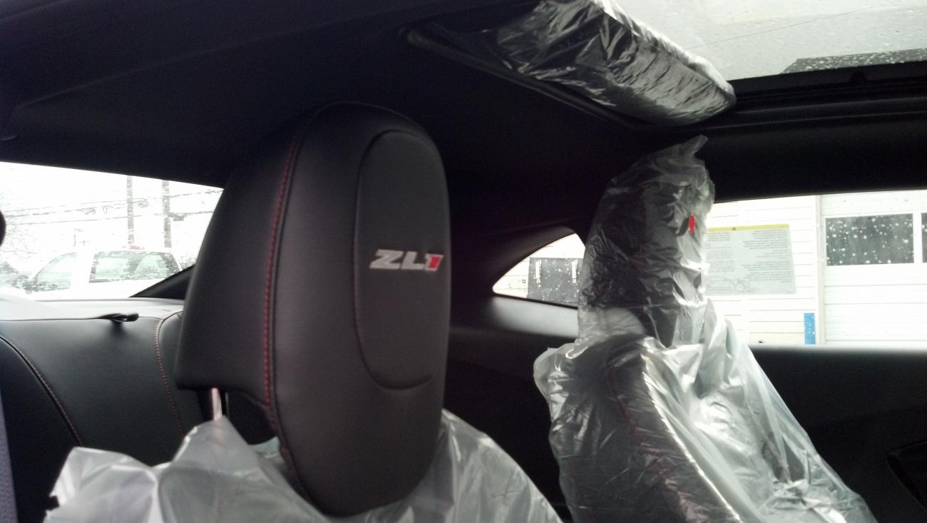

Fuse Pull..
Just did it went way easy 10min tops. Will be driving more today got a long ways to go :( picked it up yesterday and only have 135 mi. on it. Well gota go going for a drive

NICE!
