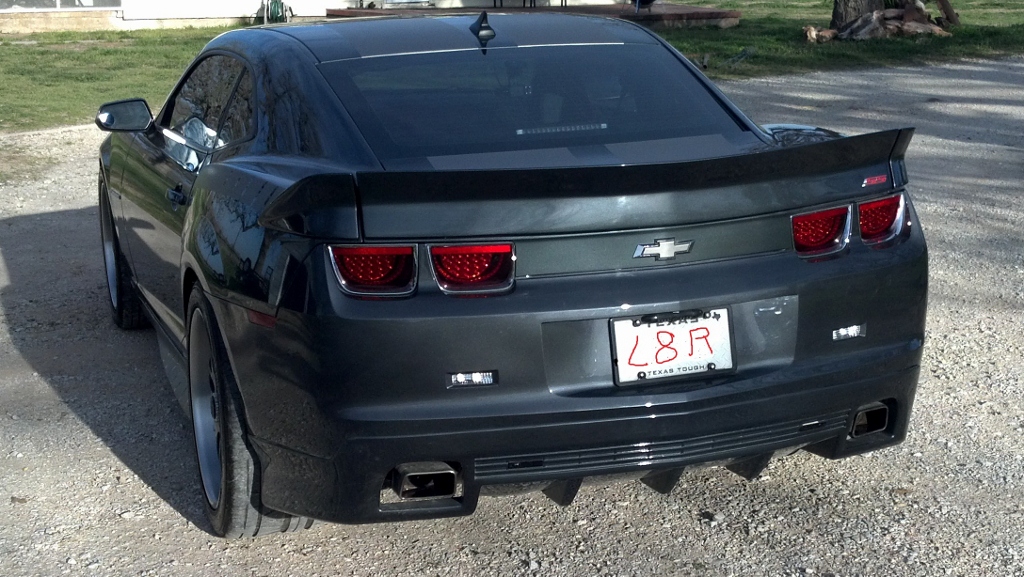

Technostalgia lights
I have the technostalgia afterburners and just had this same exact problem. Show mode was going on when I walked in my garage today and was getting dimmer and dimmer. Key ended up stuck in the lock and nothing worked on the car electrically or to get the key out. Its obviously meant to do that when the power dies. I will try the pink wire trick SOON and thanks for all the info! Here's a shot of my Maggie-blown 2010 2SS/RS.

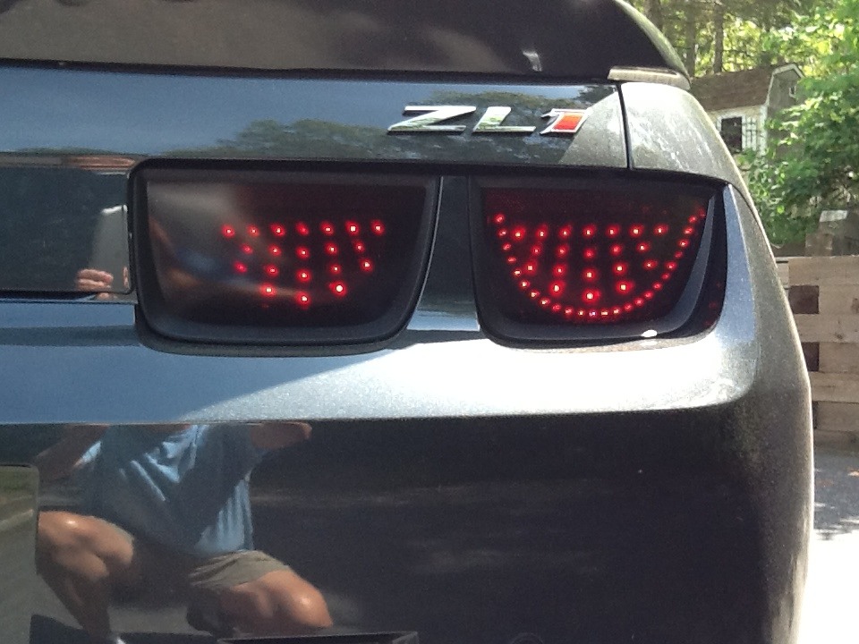

Nice ride Libertyracer. Pic doesn't show the taillights? My problem is if I unplugged/disconnected the power, I'd probably forget to reconnect before taking off. So I'd end up driving with no taillights at all. That's why I'll use the battery tender if I leave it parked any extended period of time. I do love the look of these lights and its an annoying consequence, but I can deal with it!

Afterburners
Here's a couple of shots of the Afterburner lights that will kill your battery after awhile. I've had tons of problems with them; mostly with them doing random displays and flickering sometimes while I'm driving around. I've paid to have new wiring harnesses put in 3 times AFTER the initial installation and they are still doing random flickering. I like the effect of them but I wish I could find a better version that's more reliable.

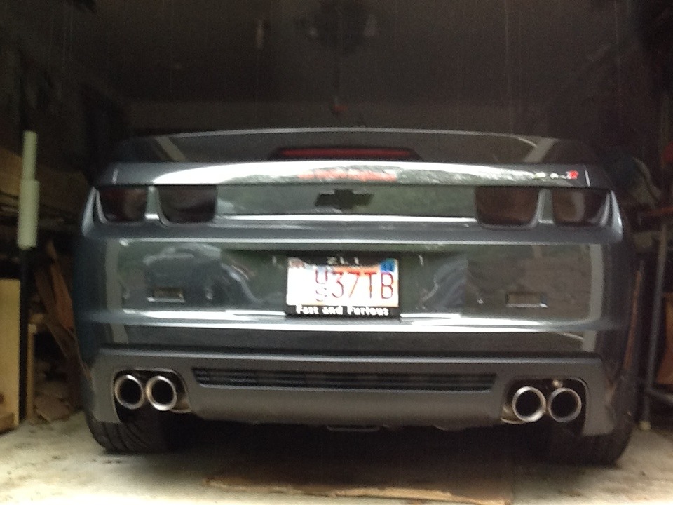

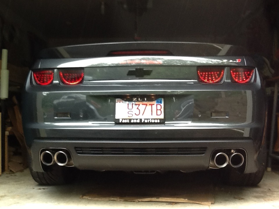

Mine have been in for less than two weeks and the other day I was checking them out to find the passenger side inner lite bottom half circle out. Worked fine when I did install and not sure when it when out, but not even two weeks, come on. Now if I have to ship it back I'll have one stock taillight as a temp? Ridiculous. Here's a pic of after install, when all was fine, and a pic I took the other day.
How long will I be without a taillight? One stock as a temp, how crazy will that look? If they send a new one I'll have to retint/clear/reinstall. Not very happy.
