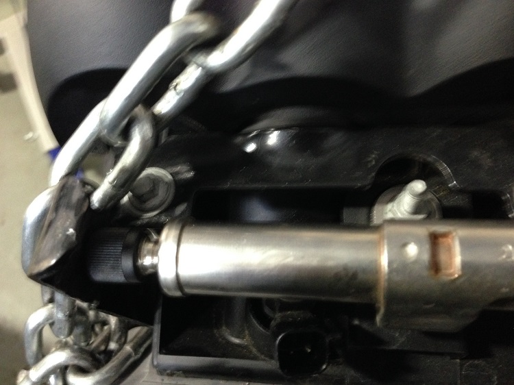

i made three minor adjustments during the manifold swap
1. i bent the steel bracket at the rear of the passenger side fuel rail so that i could retain it for the obvious safety gains (last pic) it is designed to protect the fuel rail from impact with the firewall in the event of a crash. i thought i wanted to keep that feature even though i do not plan for the engine to come into contact with my firewall
2. the fuel rail is in contact with the manifold "insulator" when the rail is turned 180 deg. i was concerned about developing a crack and a leak over time. the solution, i cut a small window in the plastic cover so it had clearance. pretty simple. there are quite a few conversations, some rather heated, about the value of the manifold insulation cover.........i'm of the belief, that as long as air from outside of the engine compartment is flowing through the manifold, it is cooler with the insulation on. i do agree that when sitting in the staging lanes, the cover will hold heat in......i dont drag race so i don't see it as an issue for me.
3. the flexible fuel line is too short and i had to unclamp the hard fuel line from the body and pull it up and in towards the engine. it turns out that the 10-12 and 13-14 models have different lengths. i'm working with the vendor, they recognize the difference in the models and are working on a solution. so for this i'm patient.

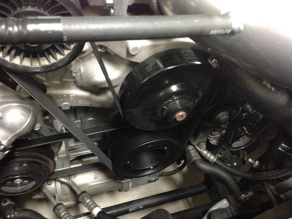

finally got around to installing the 25% UDP. pretty straight forward once I figured out how to get the 3 arm puller to grab. at first I was pulling on the inner of the outer ring at the spokes. this did not work. once I grabbed the OD of the inner hub, came right off. my puller set has 'centering points' on the threaded section, so I put a thick washer on the end of the crank to protect the threads.
this thread helped a lot
http://www.camaro5.com/forums/showthread.php?t=38661
the most important tip was to use the all-thread. I ended up using a stack of washers ~ 3in high as a spacer. good thing I had a pile of them in the garage.
my car has electric steering, so I had to try several different belt lengths until I got the right ones. (AC belt is the same regardless of the PS type)
http://www.camaro5.com/forums/showthread.php?t=364460
These are the belts that I ended up with
Main: 6PK2020 ~ 79.53", AC: 4PK0890, ~ 35.04"
oh, the AC belt walked right off using a body trim tool. I did not need to cut it off or buy the GM installation tool
overall the job was pretty easy, once I got the puller sorted. I had to use a cheater on an 18in breaker bar to get the torque to yield bolt the full 220deg (if I recall correctly). I did not have the flywheel lock, only used the driveline, chocks and brakes
I was surprised because there is a difference in the way the car pulls. it feels stronger on the butt dyno.
