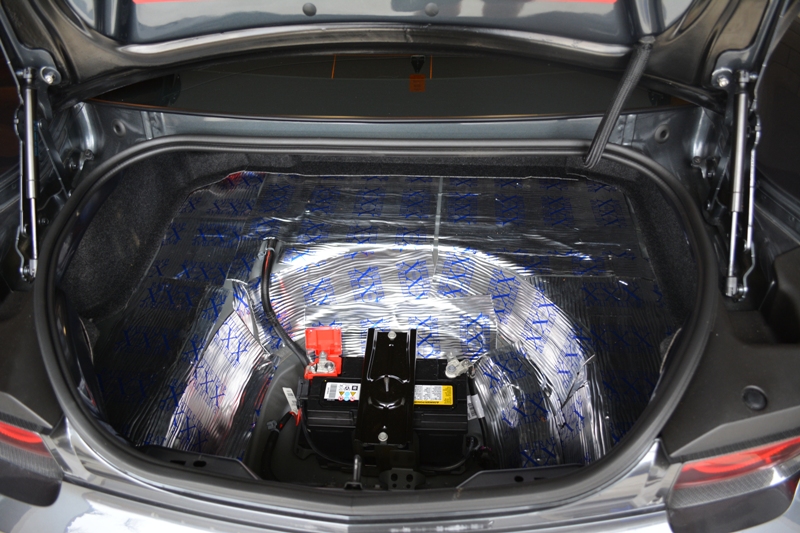

The goal of this setup was to still have full access to the battery compartment. I used Earthshaker's set up as an inspiration.
I had previously used rattletrap to help with road noise so this is my starting point.

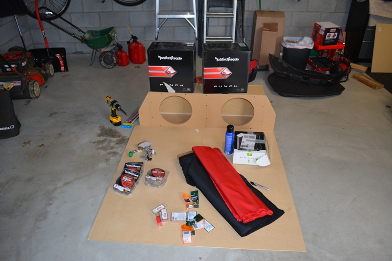

Here's a picture of most the supplies I had for this. UPS was a little delayed in getting me the second amp and amp wiring kits, which in retrosepect was fine because this took me several days to complete anyway. I found the maker of the subwoofer box online checking out custom sound systems. It is solidly made by "Customboxman" and he's local to me so I went and picked it up. It fits perfectly for a rear facing subwoofer set-up.

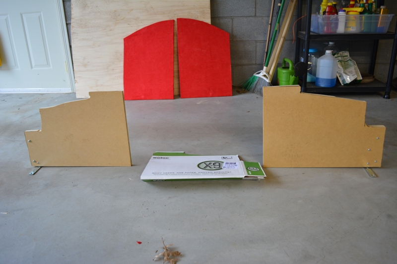

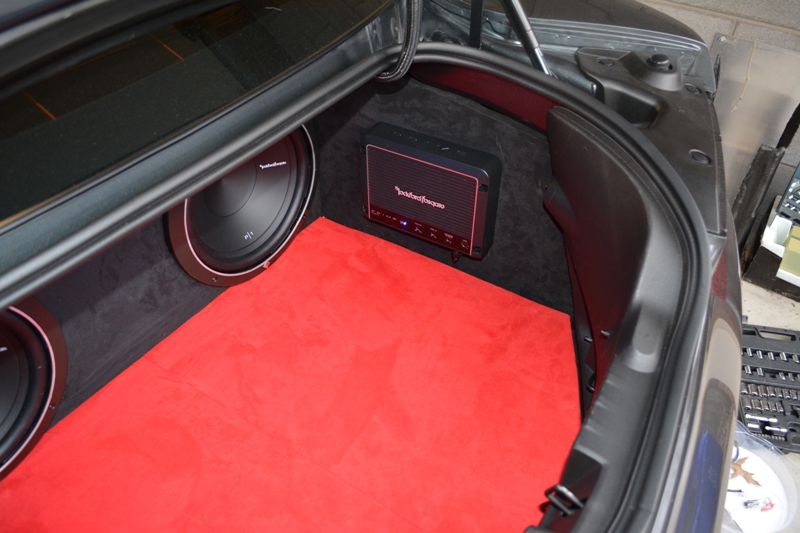

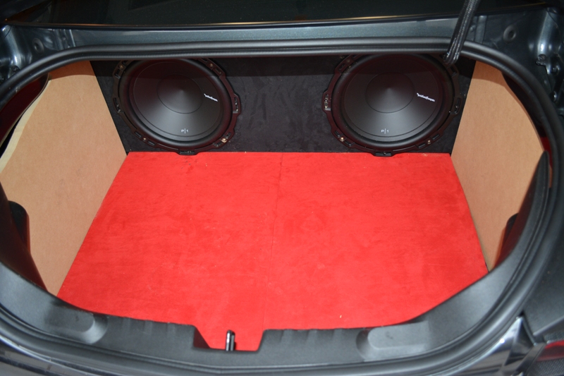

Here is a better picture of how it fits perfectly. I also covered the box in a black microsuede/Alcantara-like fabric from Joann's Fabric.

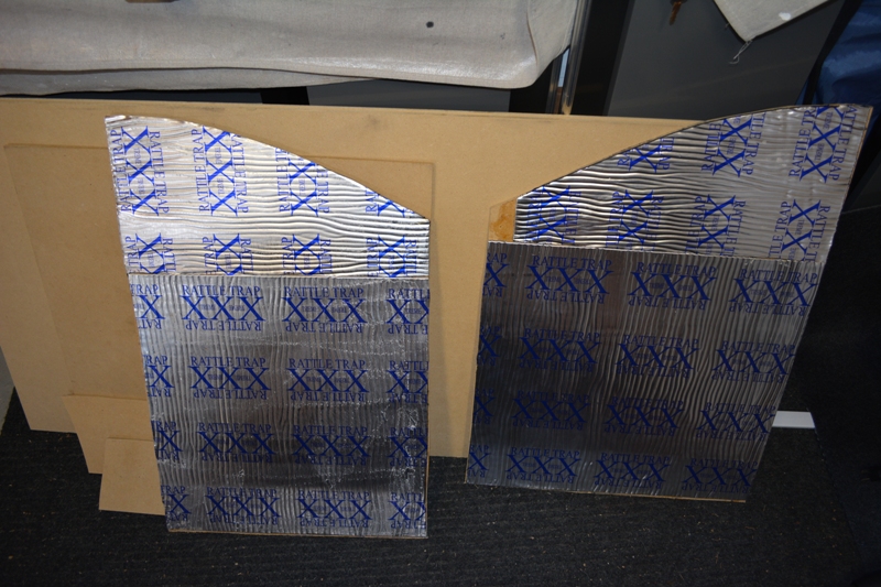

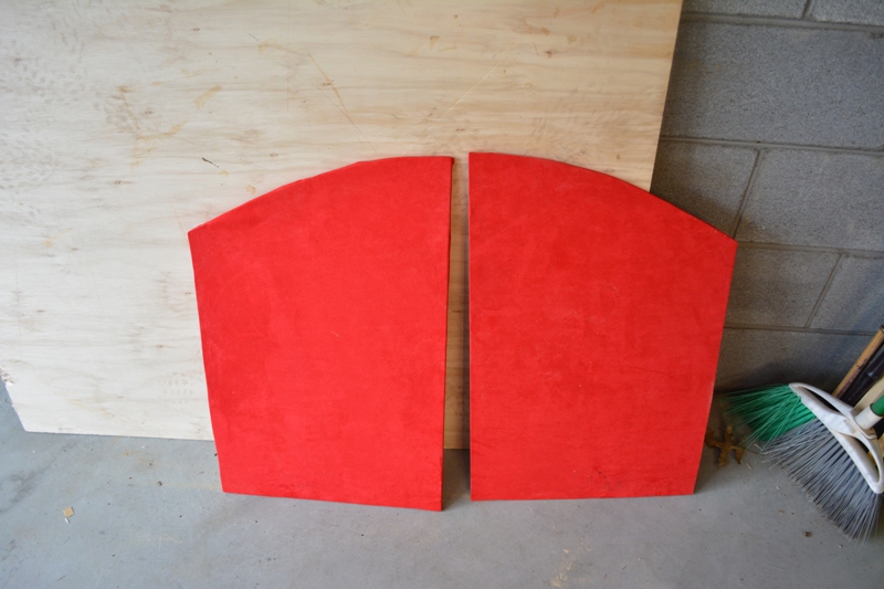

I then made the "trap door" pieces that would cover the stock wheel well cover. Sound deadened and covered in red microseude.

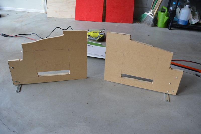

The tricky part was the amp mounts. I needed to have them free standing so they could to be removable. Here you can see my cardboard box template as well lol.
Test fitting the amp mounts in the trunk.
Fit was great, went ahead and cut a pass through so that the cords would be hidden.

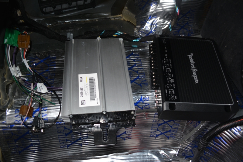

Here's a good side by side shot of the factory amp and the 4 channel amp with the FARK harness. By the way, if you're replacing the factory amp, get the FARK! It was by far the easiest part of the whole process. Just replacing the factory amp had humungous gains in the overall sound quality.

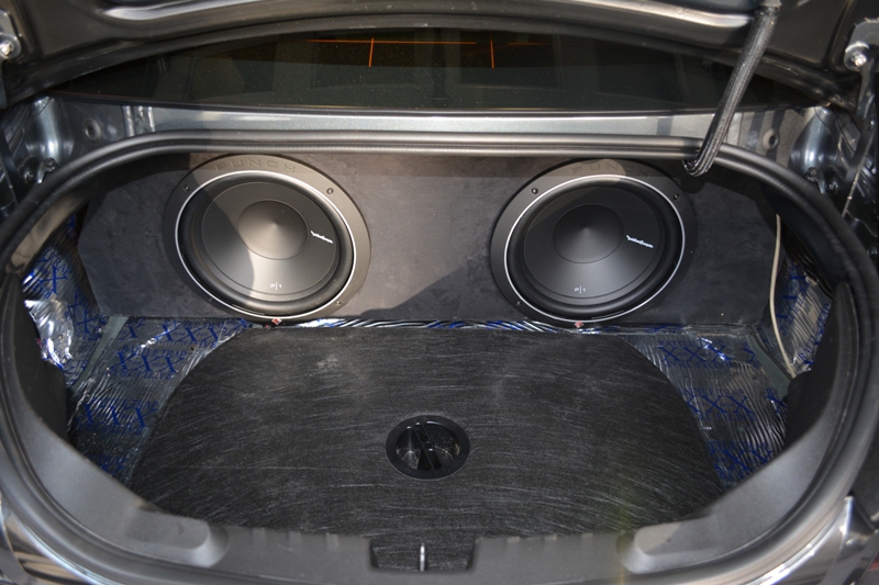

All buttoned up for now. I still want to try to cover the rear trunk trim in the black microseude and sound deaden the rear deck lid.
