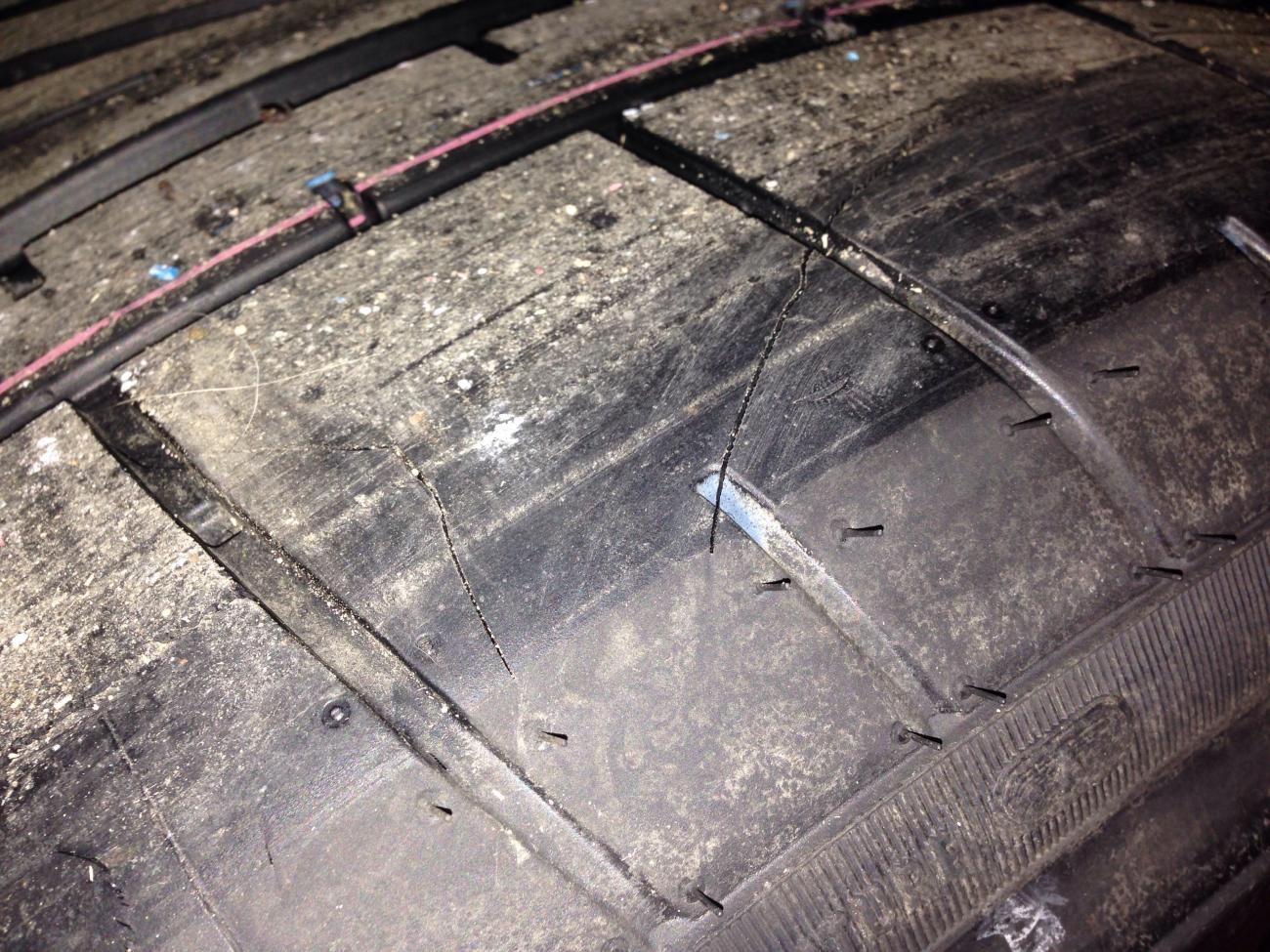

Here's a pic of one of my tires

Yikes....yeah their junk at this point. I wish you luck getting them all replaced. Keep us posted!

Yea I'm just hoping I can keep them for winter storage tires!

I just bought and put on good years from a good year shop for my LG replicas. I did even know these tiers crack like this. If they crack are they done four and shouldn't drive on them? I have to check them in the morning.

Was this just sitting or have you been driving. It's 7 degree here and mine in an open but covered parking garage.
I'm expecting the worst but hoping for the best. At 8k miles I don't have much left on them

Just trying to get more info about your tires. I am guessing all 4 are like this and it is like this in more than just one spot per tire correct? This is very good info on what to watch out for and location of failure of the tires the 1LE and the ZL1 has on them.
I believe from driving.... My Dealer left it outside 9-3 in -15 temp and I believe they cracked when they pulled it in the shop.. I backed my enclosed trailer Into their shop then into my shop so I've never driven it outside...
Correct you are! I will snap better pics today, I would say at least 12 cracks per tire all the way around! But they aren't easy to spot in person you would never know they are there until you get your hands on the tires looking for them! So anyone who is worried make sure you get a good look and hose them down if there is any dirt!
