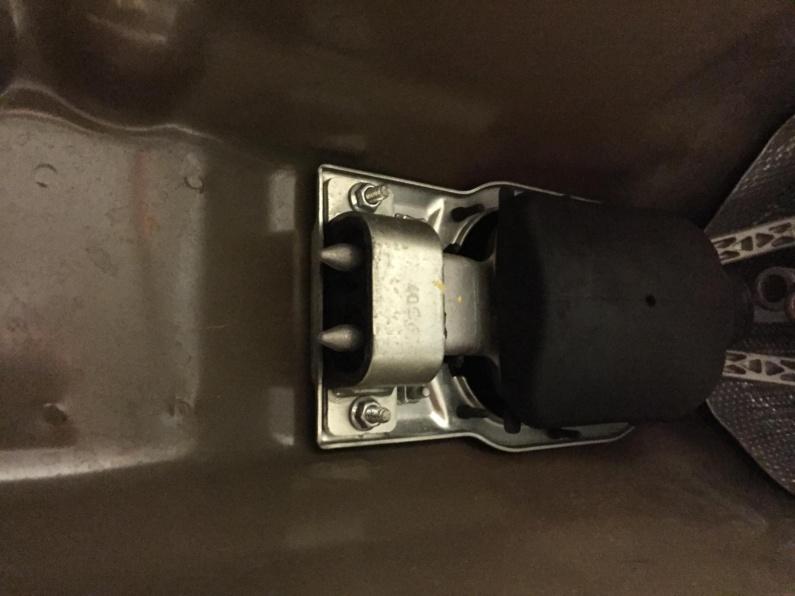

Old 01-13-2017, 08:12 PM   #47
olblue75
olblue75's Avatar
Drives: 2010 2SS/RS
Location: Clarksville Tennesse.
Posts: 6,148
Install Pics
Out with the old.
Orange Krush II
1LE Front sway bar, Splitter, shocks and struts, Z28 dual mode mufflers, Intake, UCA Bushings, and Toresen 3.91 Diff. 1 piece DSS Drive Shaft, ZL1/C7 Calipers, and 32mm JPSS Rear Bar. ASC race spec splitter and wicker. 6th Gen M017 Wheels. Stainless Works 1 7/8 LTs. DSE and PAFDT Suspension components.
olblue75 is offline   Reply With Quote
Old 01-13-2017, 08:14 PM   #48
olblue75
olblue75's Avatar
Drives: 2010 2SS/RS
Posts: 6,148
Install Pics
In with the new.
Orange Krush II

Old 01-13-2017, 09:23 PM   #49
camguynj
camguynj's Avatar
Drives: '13 SS/RS LS3 BRM Cammed NPP
Join Date: Jan 2013
Location: NJ
Posts: 3,850
Originally Posted by olblue75 View Post
In with the new.
Looks pretty sturdy. What was the install like? Assuming you have to drop the the shifter base to remove & replace the bushing mount?
camguynj is offline   Reply With Quote
Old 01-13-2017, 09:44 PM   #50
olblue75
olblue75's Avatar
Drives: 2010 2SS/RS
Posts: 6,148
I removed the exhaust and drive shaft for replacement parts, so the base was right there and it was 2 10mm nuts and it came right off, now the new one I put a little bit of grease and used a soft face mallet and tapped into place reinstalled the 2 10mm nuts easy peasy lemon squeezy!!! I hope to drive tomorrow afternoon Sunday morning and will report back then Monday at the latest.
Orange Krush II

Old 01-14-2017, 12:35 AM   #52
olblue75
olblue75's Avatar
Drives: 2010 2SS/RS
Posts: 6,148
Shifter
Originally Posted by camguynj View Post
Do you need to disconnect the shift lever from the shift linkage rod in order to drop the shifter base?
Shouldn't have to but also depends how you go after it. I was changing exhaust and DS and bam it was there.
Orange Krush II
