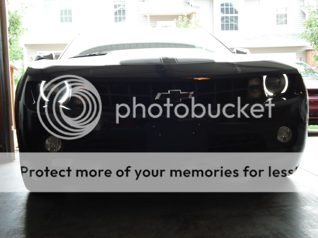

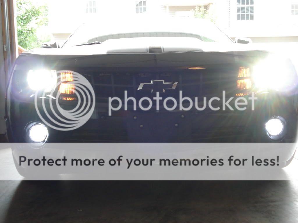

Conversion completed!
Before
After with AAC fog lights
amanc96 is offline   Reply With Quote

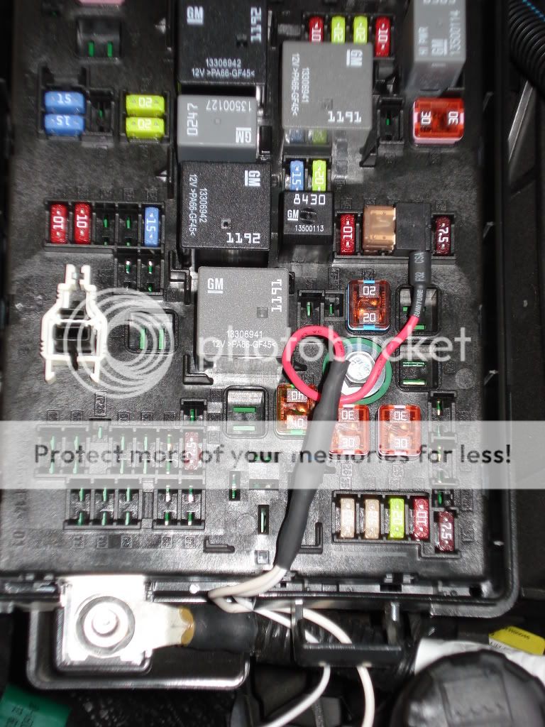

I got one today. Not the one pictured, one for the small form factor fuses. Any suggestions for which # to stick it in? You said #61, did that work out?
Also there were no directions on the box, but I assume the "lower" fuse socket is for the original item, and the "upper" fuse socket is for the accessory your adding, in this case halos? I want my halos to be on all the time when the car is on, and I'll have someone disable my DRL's with a tech2 at some point, and so i'll have halo DRLs and xenon lows and highs. So back to the numbers.... #61??
l008com is offline   Reply With Quote
#61 didn't work... The halo's would only work when the heated mirror switch was pushed. I ended up using number 15, the Ignition. Halos are on when the car is running.
You are correct on this.

Hah yeah I had the same problems and also ended up using #15. I used the spare 15 amp fuse for the halos. Someday I'll stop by autozone and see if I can find a 1 amp fuse for them. Even that is overkill but 15x less overkill at least. They sure do look sick though. The OTTO harness is nice. It's actually two harnesses. And no sketchy connectors like the AAC. The OTTO harness just plugs right in between each light and the factory connector. You just have to wire up the halo lights yourself. The only downside... they have no web site to speak of and suck at responding to emails, so it took me about two months to actually order the harness.

Originally Posted by christianmotox View Post
i used the #20, ECM/Ignition fuse. Nothing fancy, i just ran a cable up to the fuse.
Pics? I'm thinking about running it to one of these fuses instead of the parking lights

Nothing special. I picked up the add-a-circuit part from autozone. I like this route better so then I don't have to have the parking lights on. I used christianmotox's method on disabling the headlight DRLs and just use the Halos as my DRLs.
