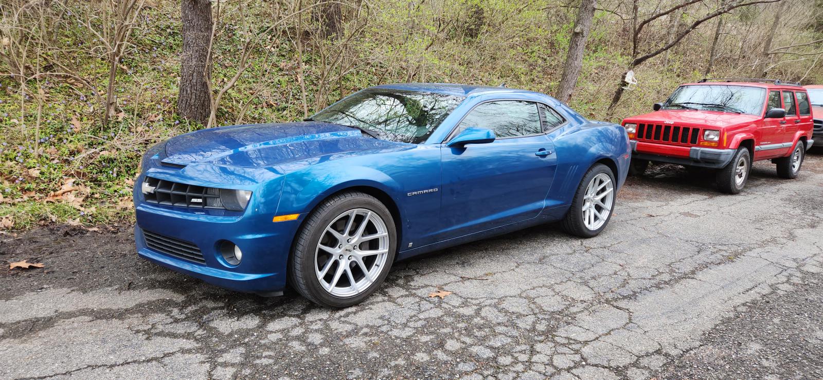

Done. Handles great! Feels twice as good as when it was new!!!

Nice Good Alignment specs help as well
I had them align it to the 2013 1LE Specs.
