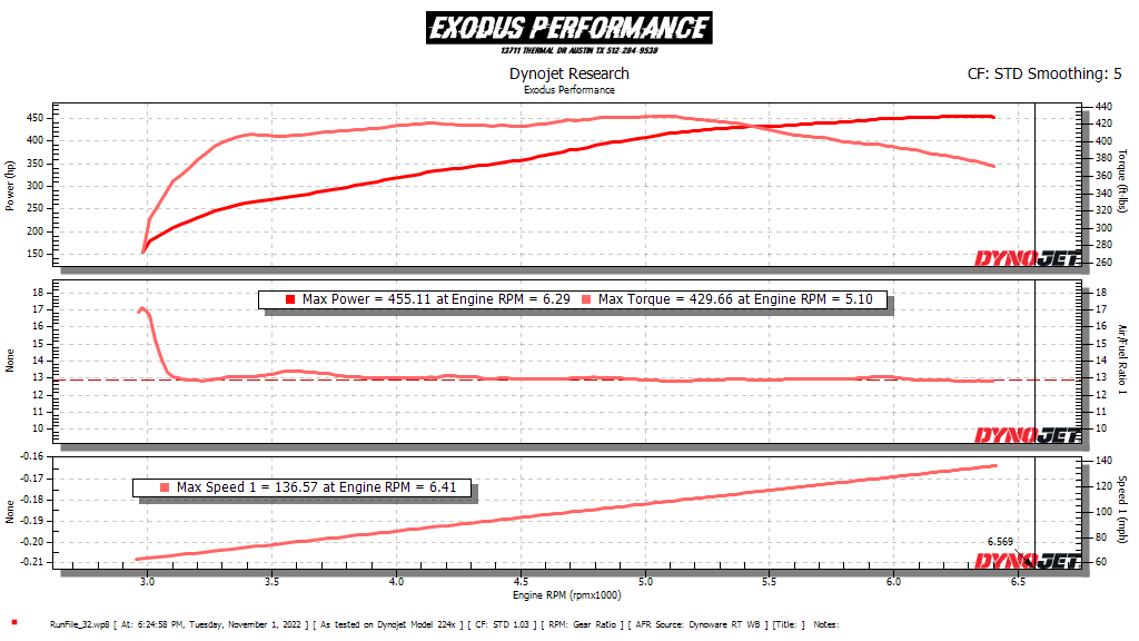

Here's the proof in the pudding or however they say it
Attachment 1113551
Awesome dyno sheet, beautiful flat torque curve!
Great job!
Thank you Vic.
