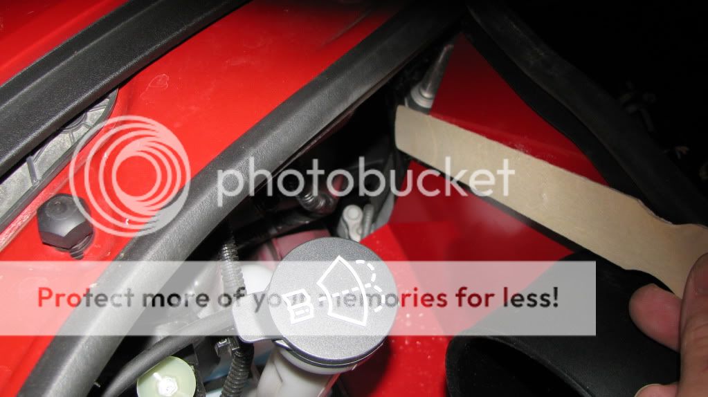

Any chance you could post a pic of the other side of the duct, where it enters the engine bay/your box?

The paint stick is in contact with the edge of the plastic duct in the picture below. If you remove your stock air box you can feel the duct with your hand in this area.
