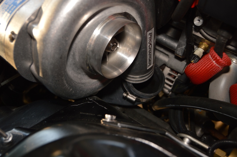

Well, I was all set today to have the dealer drop the tranny and ship it off to Circle D.
On the way to the dealership, I looked at my boost gauge: 0 psi. No vacuum, no boost, no nothing.
So I have come to realize the tranny is fine. Having no boost makes the car feel like the tranny is slipping, when in fact it's fine.
Supercharger looks fine, no belt broken or anything, no obvious loose or broken connections. Just a little strange whine, but nothing too out of the ordinary.
My first theory is a stuck spring or something, maybe in our Wastegate. Maybe in the blowoff.
Ideas?

I think the ATI kits have a bypass valve? If that's not stuck open, your weird sound could be the bearings in the blower are messed up, and the blower wheel is not spinning or is spinning with difficulty.
Yes, it has the bypass valve and wastegate. I just looked at it, all is connected, but it's hard to tell.
Doing some googling, looks like they do sell a race valve for higher HP applications, so it may be a known point of failure.

Bearings could be seized up though, that's not a rare occurrence.

Well, that explains it:
It's my first supercharger. I'm not used to what happens when you blow the outlet coupler.
I'm guessing all I have to do is reconnect it?
Better than spending $3k on a tranny rebuild.

So the trans is good to go?
You're a drag racing nut so I know you have a ton of passes on that thing in the heat but just as a point of reference I was able to get about 175 passes from stock rwhp to 650 rwhp. After that I got a little slipping on the 3/4 shift so Ted decided he wanted to build it up. So far this year it has been spot on!

Yep, good to go.
I fixed the outlet coupler and car drives fine.
Only remaining problem is it seemed to have blown out the sensor for the boost gauge, so I can't see that I'm getting boost, but everything is fine. I'm going to fix that, put in an electronic boost controller, a ZR1 MAP, and then I'll take it back to the track for some T&T.
I'll also be adding a tranny cooler. I read in another thread that you had heating problems AFTER the tranny cooler install?
