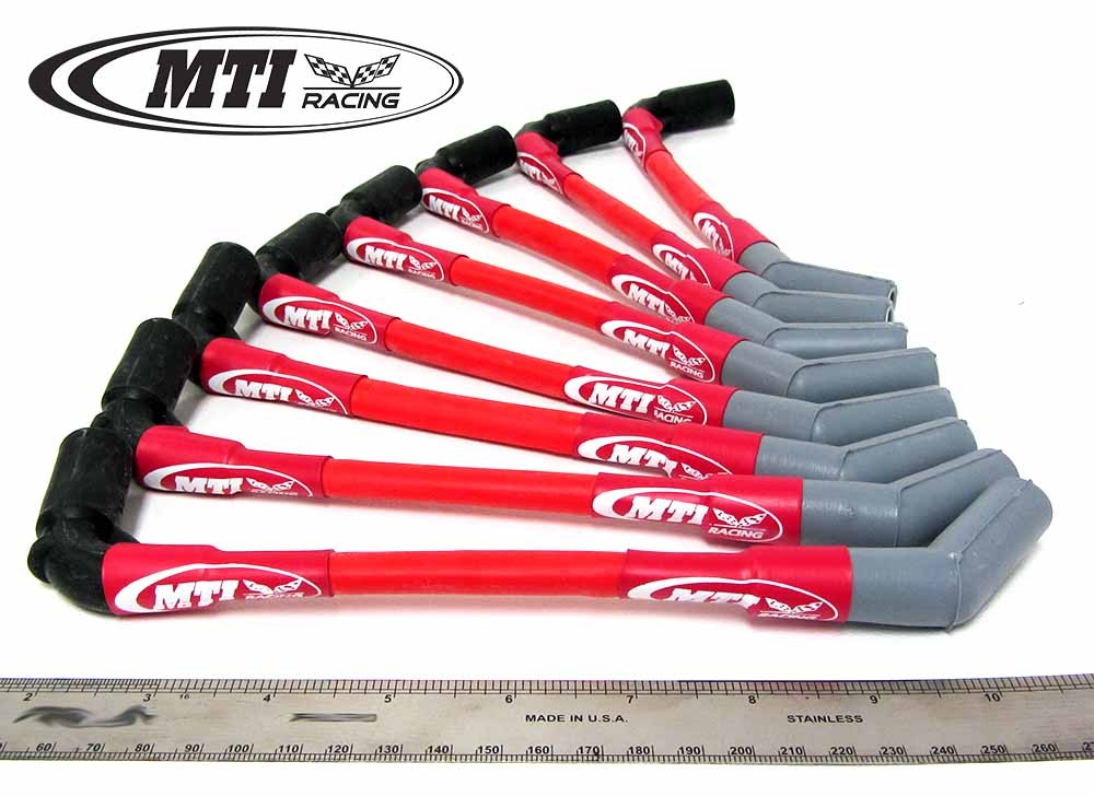

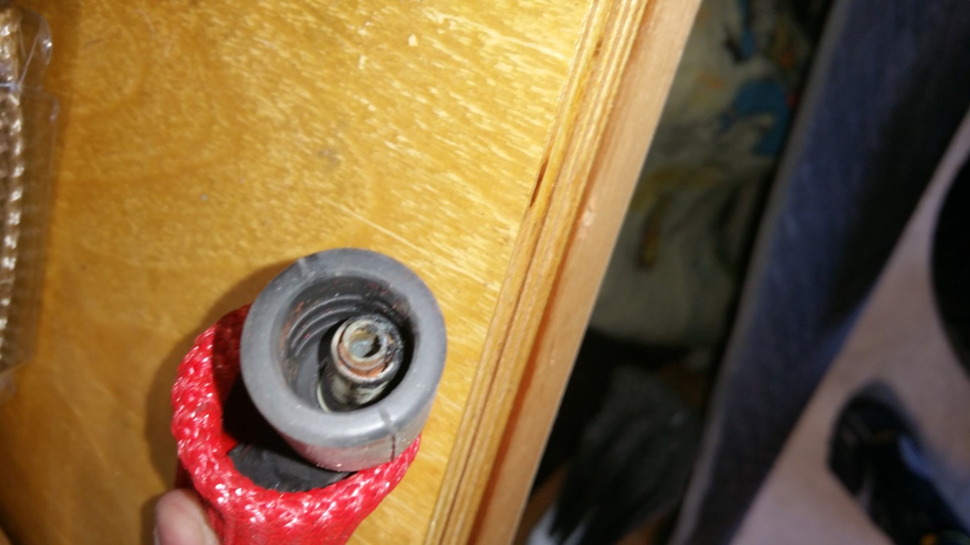

Well, found out my JBA sparkplug wires are not holding up. I had 2 start to pop off the coils, and after inspection, found the 'ends' are broken and 'charred'. Ordered the MTI Racing Hotspark wires:
Looks like the sultan of spark coils weaken those ends. Once I get the new wires, I'll show what has happened....
-Don

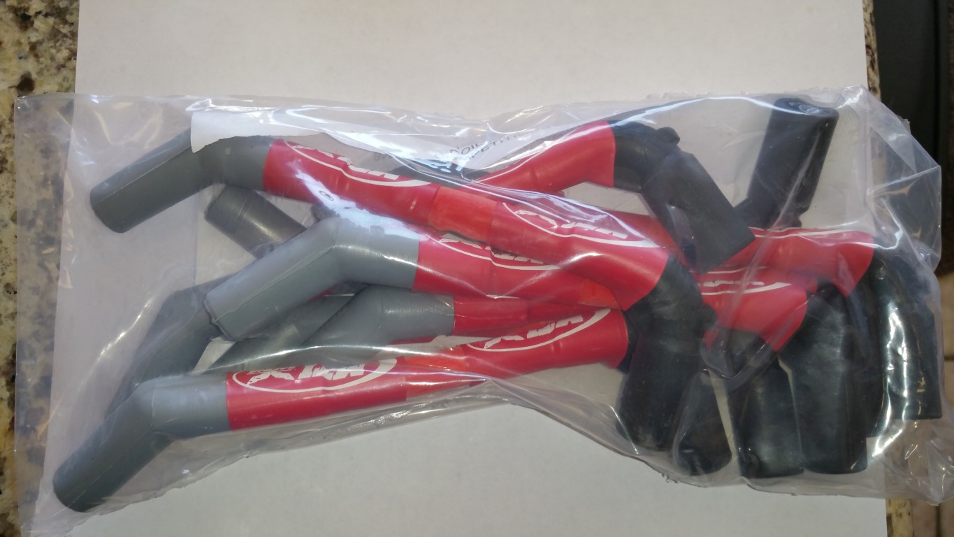

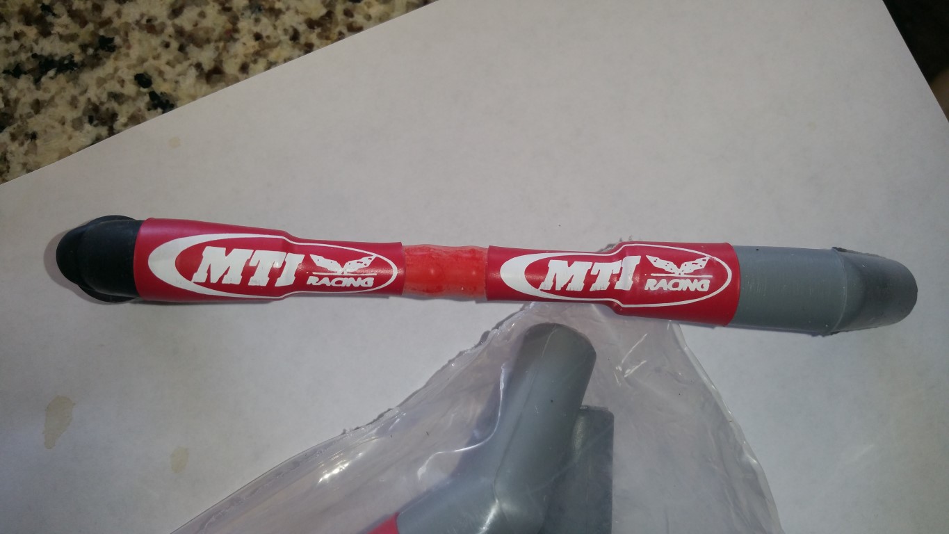

MTI Racing Hotspark Wires
OK, did the MTI wires today -- very straight forward, like the way they are setup:
Stainless ends (note the dielectric grease to allow smooth install/removal. KEEP IT OFF the connecting ends):
Here is why I'm replacing the JBAs:
As you can see, these are charred on the ends and the 'retainer' is broken off. I had 3 wires popping off the coils, so, this is why I replaced them.

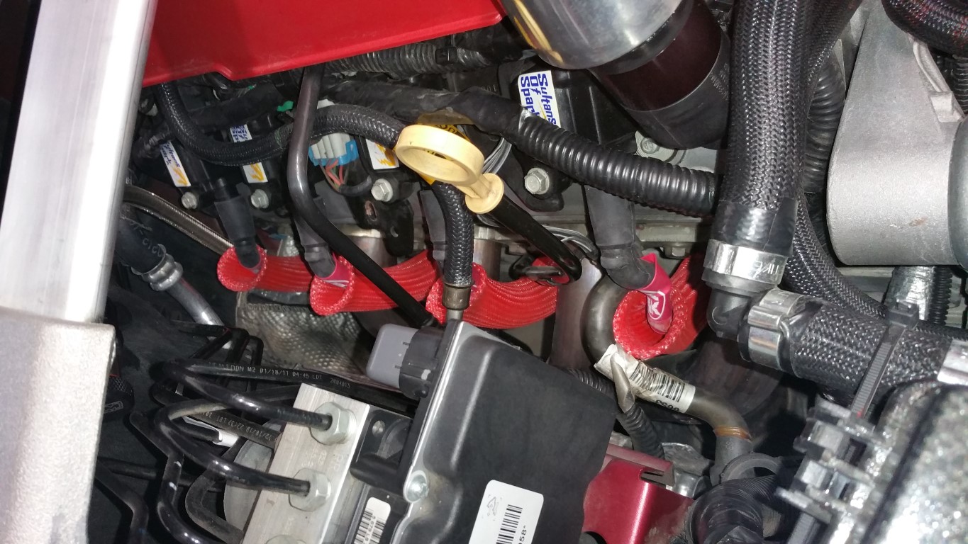

Here are the MTI's installed -- didn't take long @ all -- made sure everything was clicked on and started 'er up... will take it out later and make sure everything is smooth...
I put the 'socks' back on as while the boots cleared the headers, I wanted to be certain everything was protected...
