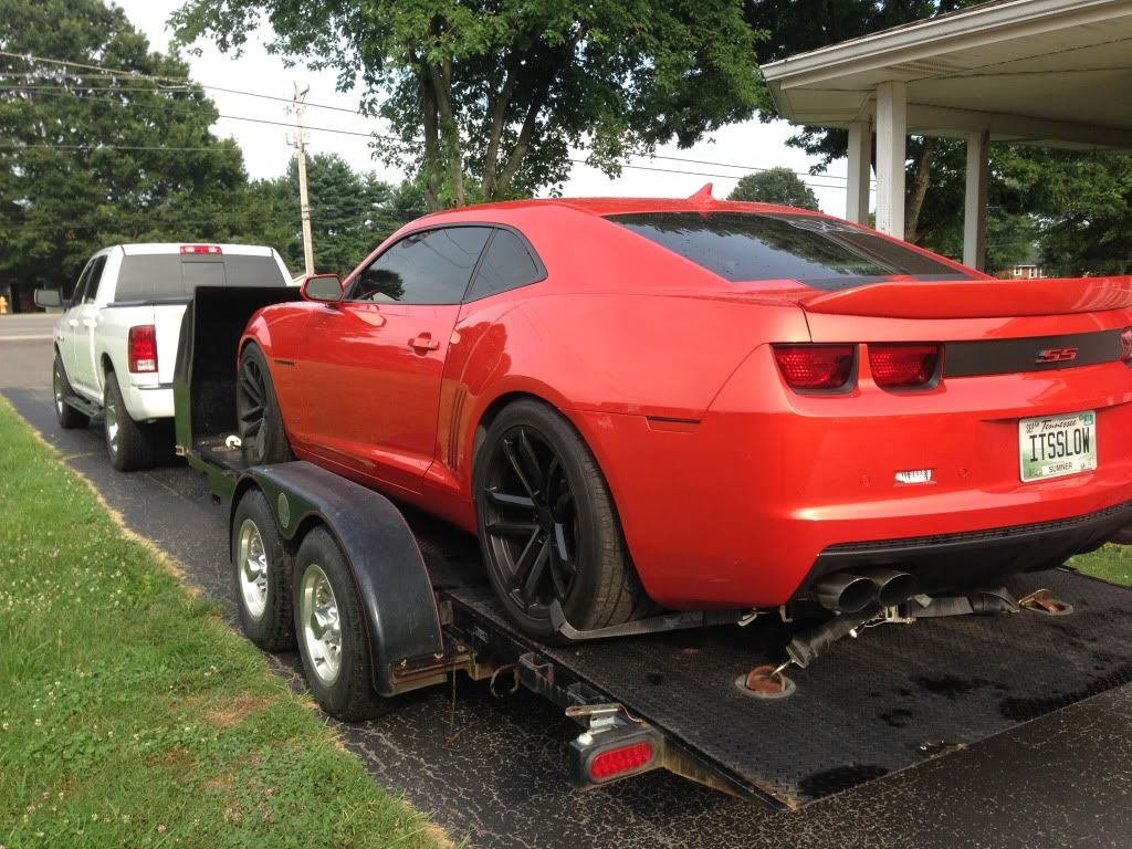

So as I was unbolting the driveshaft, I noticed it was spinning even with my emergency brake on. I looked more closely at the axles and noticed one of the CV boots had a twist in it. It never crossed my mind that one of my Gforce1320 axles would have broken, but it did.
I called Gforce and they were as shocked as I was. If anyone can get a defective part, it will be me. I sent my axles in to them for inspection. They replaced them with their newest design level 5. The first thing I noticed is the improved design on the bracket that holds the axle stubs in the rear housing. The black bracket is the old design.
I also went ahead with my plans to upgrade the trans. I ordered a Tick Performance level 3. I haven't beat on it yet, but so far it's much smoother than the stock trans.
The boot on my Dynotech driveshaft had melted some. I'm thinking it was probably from where the cat was stopped up and got so hot. I ordered a boot kit from them and replaced it myself.
While everything was apart, I sent the center section back to Strange for inspection since it was whining quite a bit on decel. They replaced a few parts, but it still makes some noise. Not near as bad as it was, but it's not perfect.

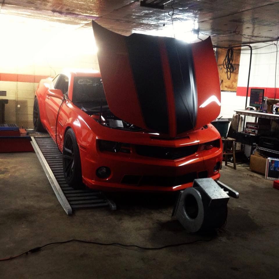

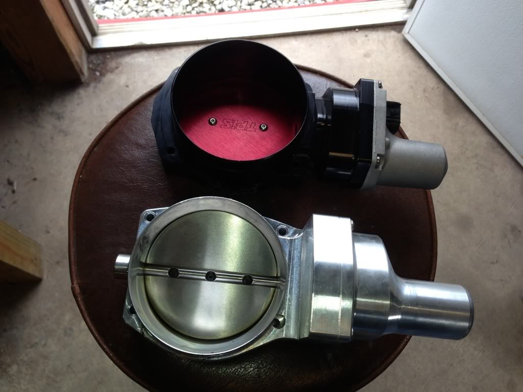

Swapped from the Nick Williams throttle body to a TPIS unit since the NW102 had an issue with slamming shut at the track.

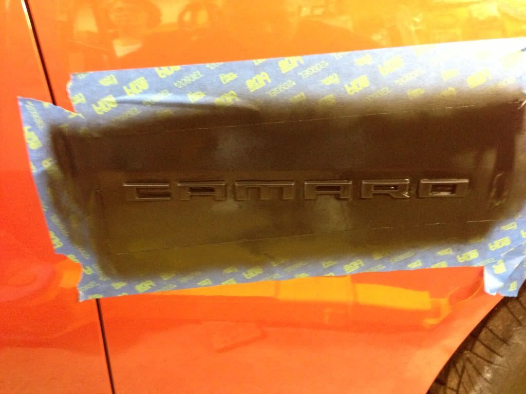

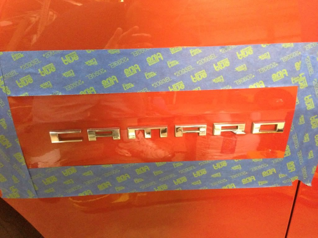

Also plastidipped the chrome Camaro letters on the fenders.

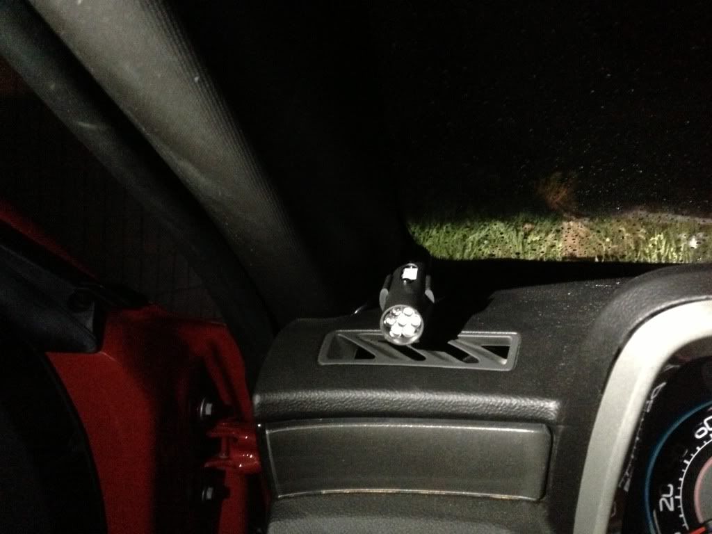

Originally mounted a Raptor shift light inside the AC vent, but I didn't like it there. Too hard to see, so I moved it up on the dash. It's a dual mode, so I can set a launch rpm and shift rpm.
After the throttle body and 3 bar map sensor swap, the car needed to be retuned, so I dropped it off at ShorTuning. His Dyno is very stingy and it dynoed about 100 rwhp down from my previous run on a Dynojet. He says that's normal for his. I hope he's right and there's not an issue with the engine.
I'm picking the car up Thursday on our way to CamaroFest in Indy. It needs to be cleaned up and a few things done before racing, but I guess I'll just have to do it there.

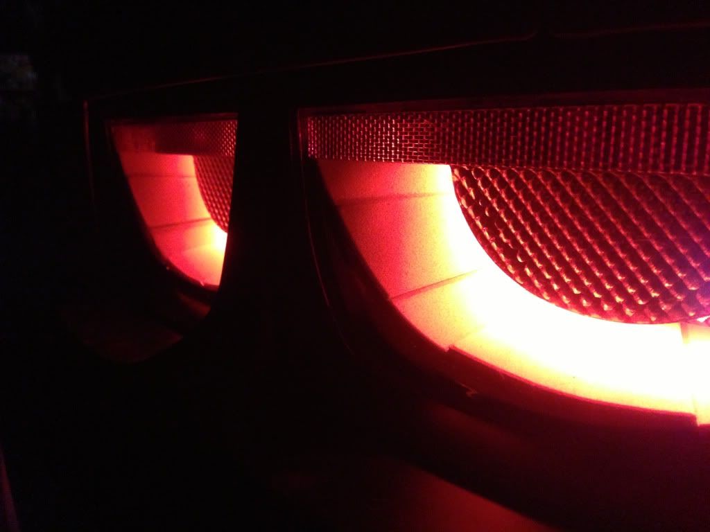

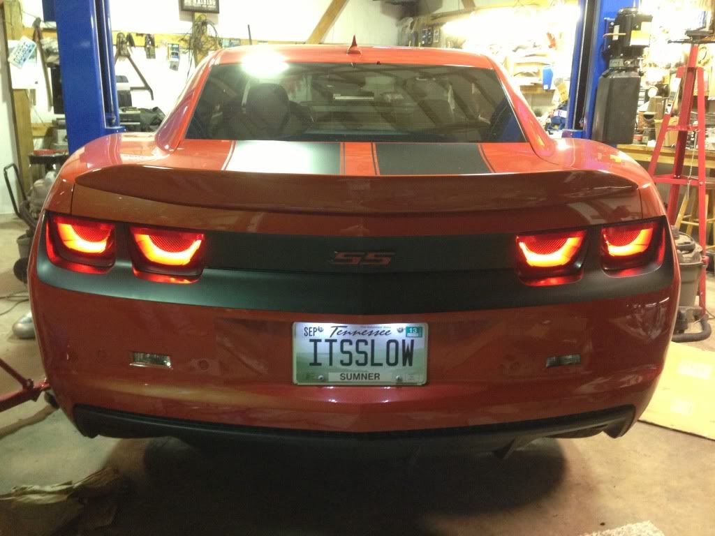

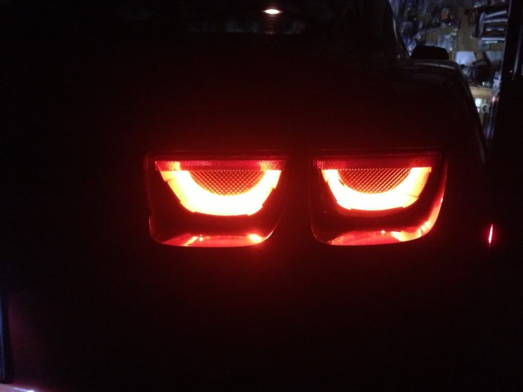

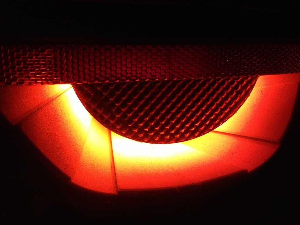

I installed Afterburner tail lights from SJM Auto Prod. It was a messy pain in the ass job, but I love them. The pics I have don't due them justice. It's the best I could do with my iPhone. I also did some Plasti Dip while the lights were out. Can't drive the car right now. I have the trans out and waiting for a replacement clutch.
Sequential option
