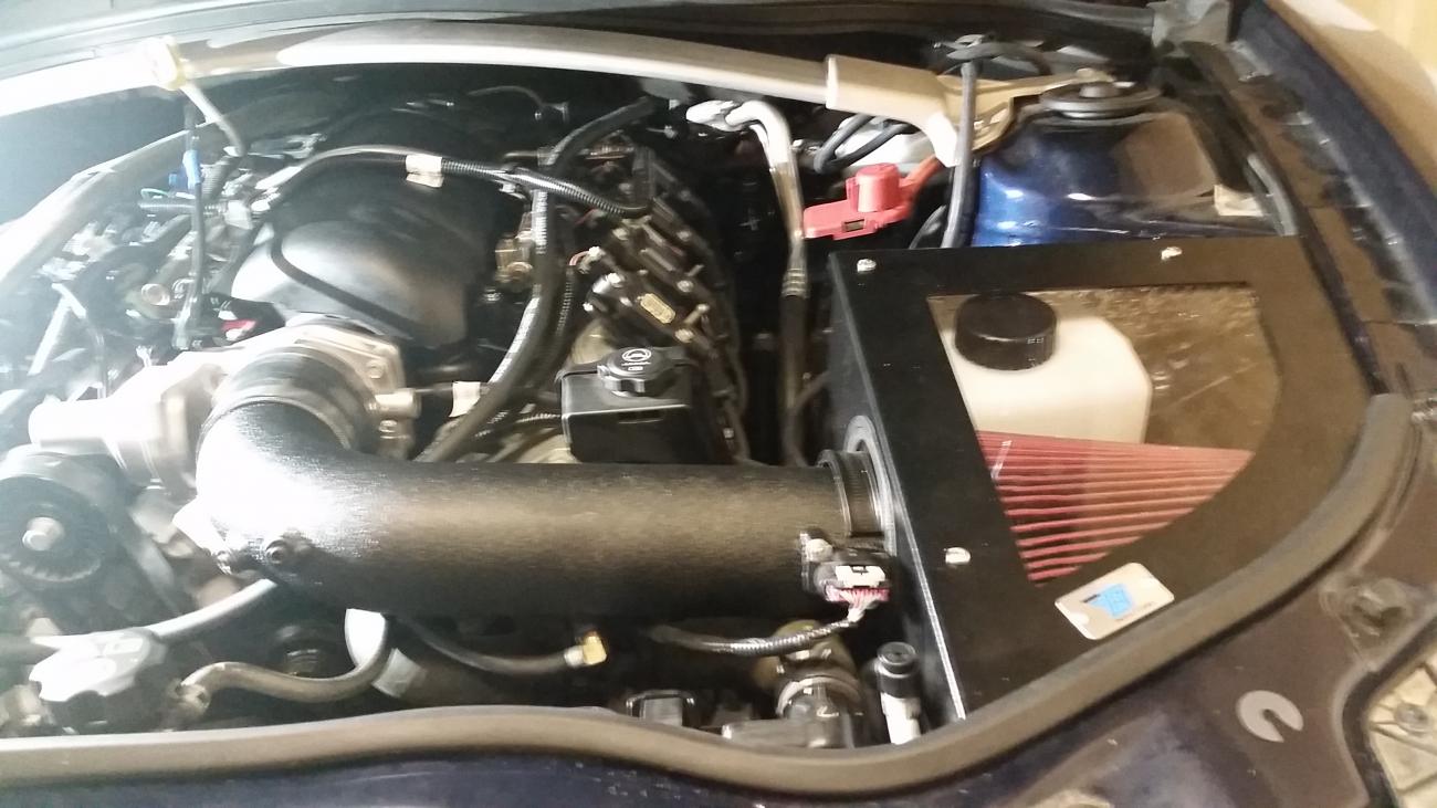

Made some prigress tonight I still need to fab the windshield washer bottle, and wire up the return oil pump, but then its the boosta pump and wide band o2 and tune

My mock up so far I will add one layer of tint to hide in perfections some then since I have a led light for this I will add a second layer of tint and have a design cut into the second layer, and as far as what's left to install other than body parts is still route my boost controler and install the boost a pump then finish off with the wideband 02s

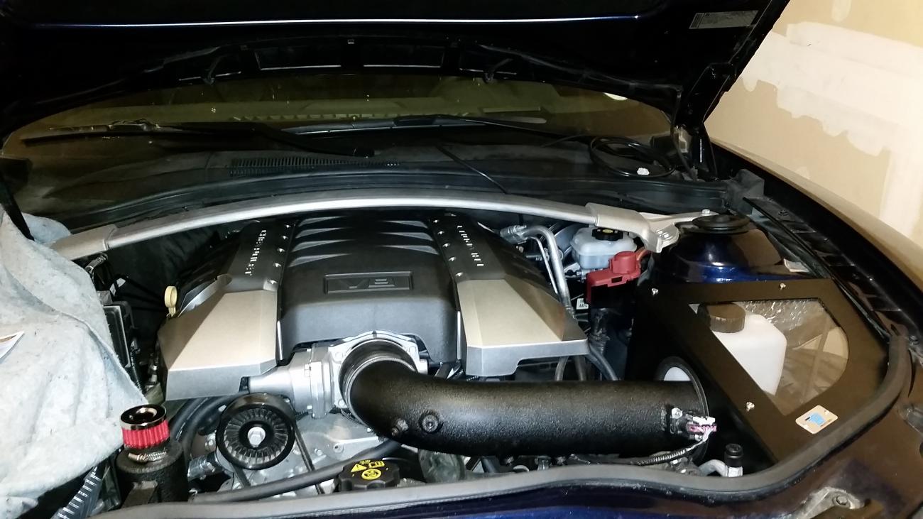

Engine compartment almost completed look, still need to add lighting to the air box and a lite layer of tint and maybe down the line I will modify one of the valve covers to eliminate the oil return from being so visible.

Well started the car up today and didn't go like I planned, the car was pumping alot of oil into the exhaust, so far the preliminary testing is pointing to something defective with the scavenger pump but when I find out for sure what it is I'll post it

Well did one test by wiring the pump to fuses in the fuse panel that are live with out the car running and the pump failed to start, so now I will bypass the wire assembly and wire the pump with direct current and ground to test if i have a faulty wiring harness or pump, the second test procedure is from Kevin at agp there customer service is top notch

Well found out the issue it was the ground all along, this is where I did have it grounded at first, and of course where it didn't work

That is a positive battery connection if you ever need one. Alky meth kits get their power from there.

That would explain everything then and my weird finding when even the negative line was showing postive
