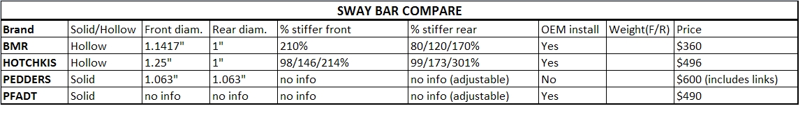

Originally Posted by Avalnch View Post
OK, now that I'm seriously about upgrading the suspension, I've expanded my search to the four major sway bar brands that represent themselves on this forum. Along with new struts/springs (aka coil overs which will need its own post), sway bars is equally important in improving the suspension performance of any vehicle. I've compile a side by side comparison of the different sway bars here. The info is directly off each vendors' websites, so there's no guess what's what.
Attachment 162560
The comparison is only of the "sport" sway bars. I won't be racing the car enough to warrant spending over a grand for a set of full out bars.
I tried to eye-ball the stock bars and they look to be about 7/8" front and 15/16" rear (using a tape measure). What the deal with that? The front OE bar is smaller than the rear?!?
I'm over the hollow vs solid debate. My friend's ZR1 has hollow bars and he swears by them for the weight savings. I'm OK either way since I have more HP than I know what to do with (which is a very good thing). ^_^
Can anyone fill in the missing info on the Pedders and Pfadt bars? They are not published on their websites. Also, what are the bar weights? I've left a column empty for that info even though I just said above that "it doesn't matter".
Right now, based on the info at hand, I'm leaning towards the Hotchkis bars because of their stated rear stiffness. I was looking forward to the Pedders bars because they included heavier adjustable endlinks, but the required drilling has made me reconsider.
One major question regarding the adjustable aftermarket sway bars is how well the OEM endlinks will hold up with the bars set at full stiffness? Some expert advice is needed here, please. I have no experience with the Camaro's new style endlinks.
I think I will finally end up with a mix of various components from everyone since no one vendor has everything that I'm after. I'm looking forward to all the wrenching this winter. Just wish I had the foresight to install a hoist in my garage. *sigh*
Oops!!! There must be a typo here!! The rates that are stated in the Hotchkis line are actually the BMR rates. The BMR sway bars are 3-hole adjustable. Front rates are 98/146/214% stiffer than stock SS sway bars. Rear rates are 99/173/301% stiffer.

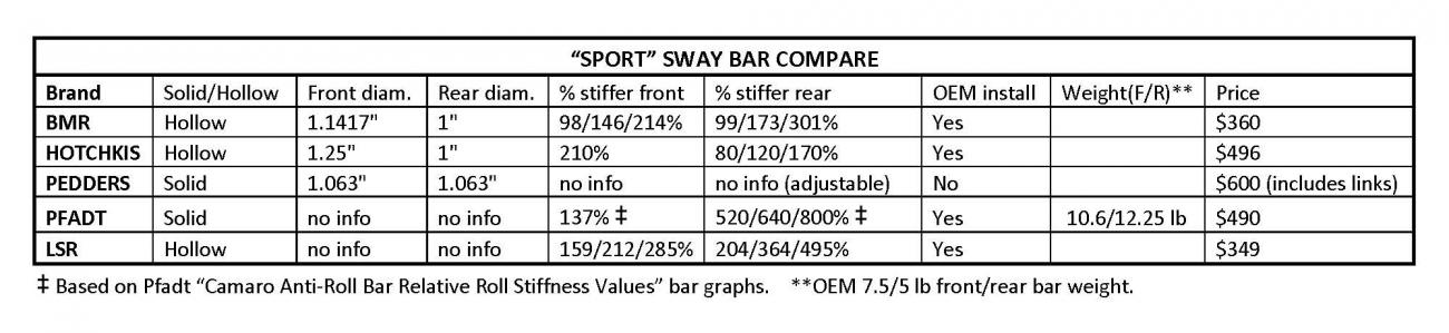

Oops indeed. Sorry BMR, I've fixed up the chart and added some info.
SWAY BAR COMPARE.doc
Name:  SWAY BAR COMPARE r1.jpg
I'm not sure if the Pfadt rool stiffness can be directly translated to "% stiffer" like the others. If it does, then, WOW, that rear bar is HUGE! From the weights quoted by Pfadt, the rear is hollow and the front is solid.
Attachment 167733
Attachment 167732

Avalnch, thanks for your business. You made the right choice considering how much success customers are having with this set up. Let us know how the install goes.
In regards to the values, you have to remember that all the data we posted is normalized for comparison to a known value (in this case the roll stiffness value of the OEM FE3 rear sway bar, which has a value of 1). This is a typical practice by vehicle engineers to present data comparisons in a relevant manner. Posting numbers with no units that are "best guesses" of a meaningless metric to the driving experience, is not what Pfadt considers relevant. We will always post data that informs the end user how this will affect the driving experience.
And also, when looking at normalized values, take into account that the front sway bar and rear sway bar have different motion ratios, so you can NEVER compare a front and rear bars relative effectiveness (or roll resistance) directly, as that comparison is meaningless, and arbitrary. You have to compare the balance ratio as we have done in our chart. As an illustration, the front OE FE3 sway bar is 5.9 times stiffer than the OE FE3 rear bar. So when you see varying numbers, front to rear, you have to take into account its affect on the suspension as an assembly, NOT just a single component.
Thanks again and I look forward to you posting your impressions! Also, yes, our Sport Sway Bar kit includes a solid front bar, and a hollow rear bar.
