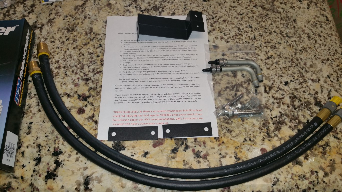

Well, since I'm gonna track NCM, I figured I'd go ahead and do the ADM trans cooler. Yes, I did get the CSF, but, knowing how things go, this will allow the radiator to do its job cooling the engine better.
Here is the setup from ADM: (I did get 'plugs' for the radiator just as a precaution so I didn't have to cut mine):
I have the instructions, but looking @ the setup, I don't think they are really needed -- just a note on tightening the hose to the cooler (1" wrench) to not overtighten it, and I think we're good!

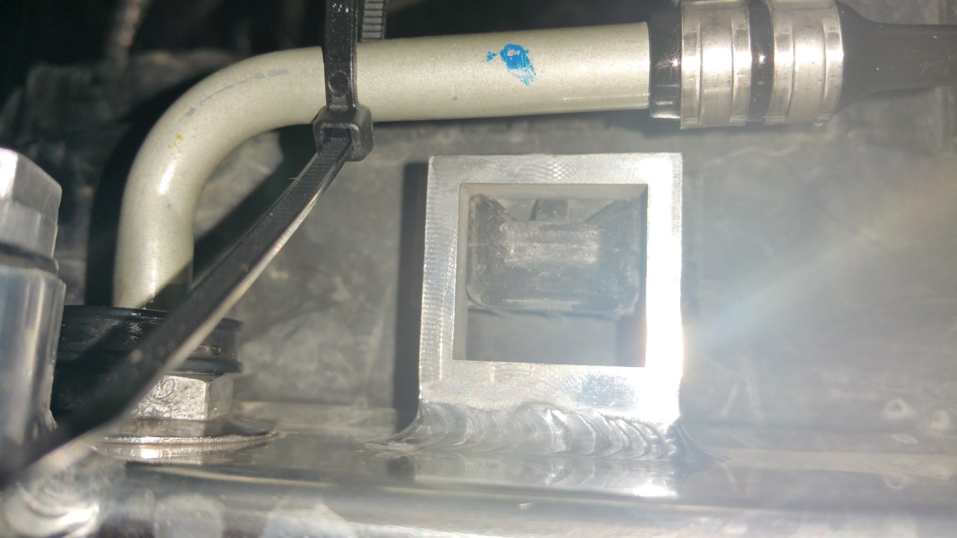

ADM Trans Cooler Install

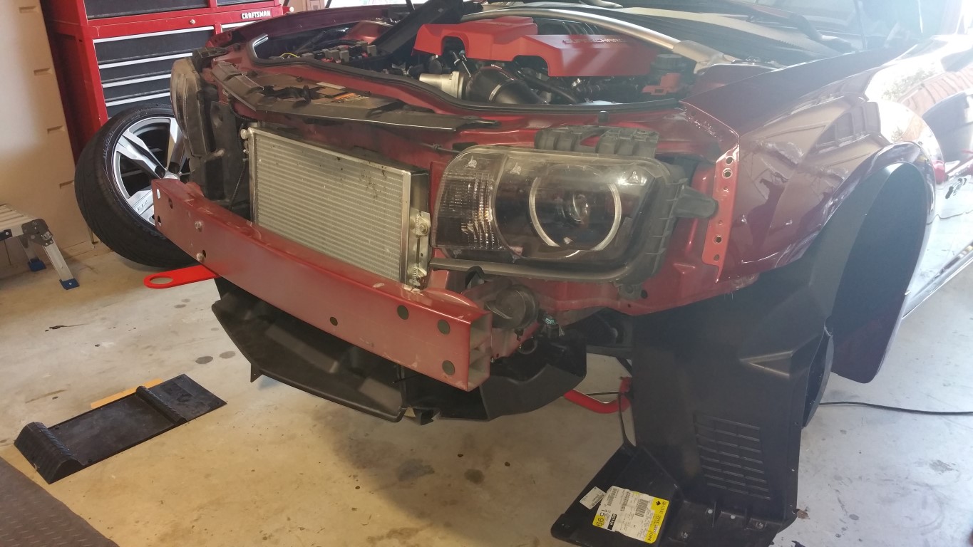

So, my install began with removing the front bumper (wheels, splash shields dropped down, and the belly pan):
Here are the steps I used (when I did the LSA supercharger):
http://www.camaro5.com/forums/showth...385577&page=16

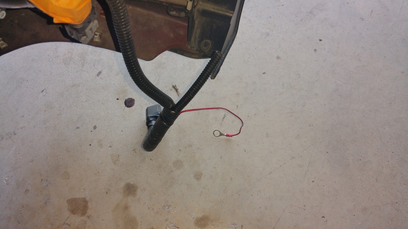

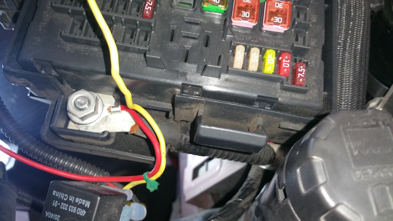

Next, if you have the Gen5Diy harness kit (like I do), you need to remove the power line as well as disconnect the connectors:

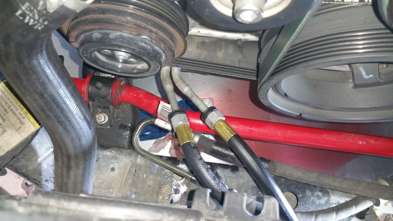

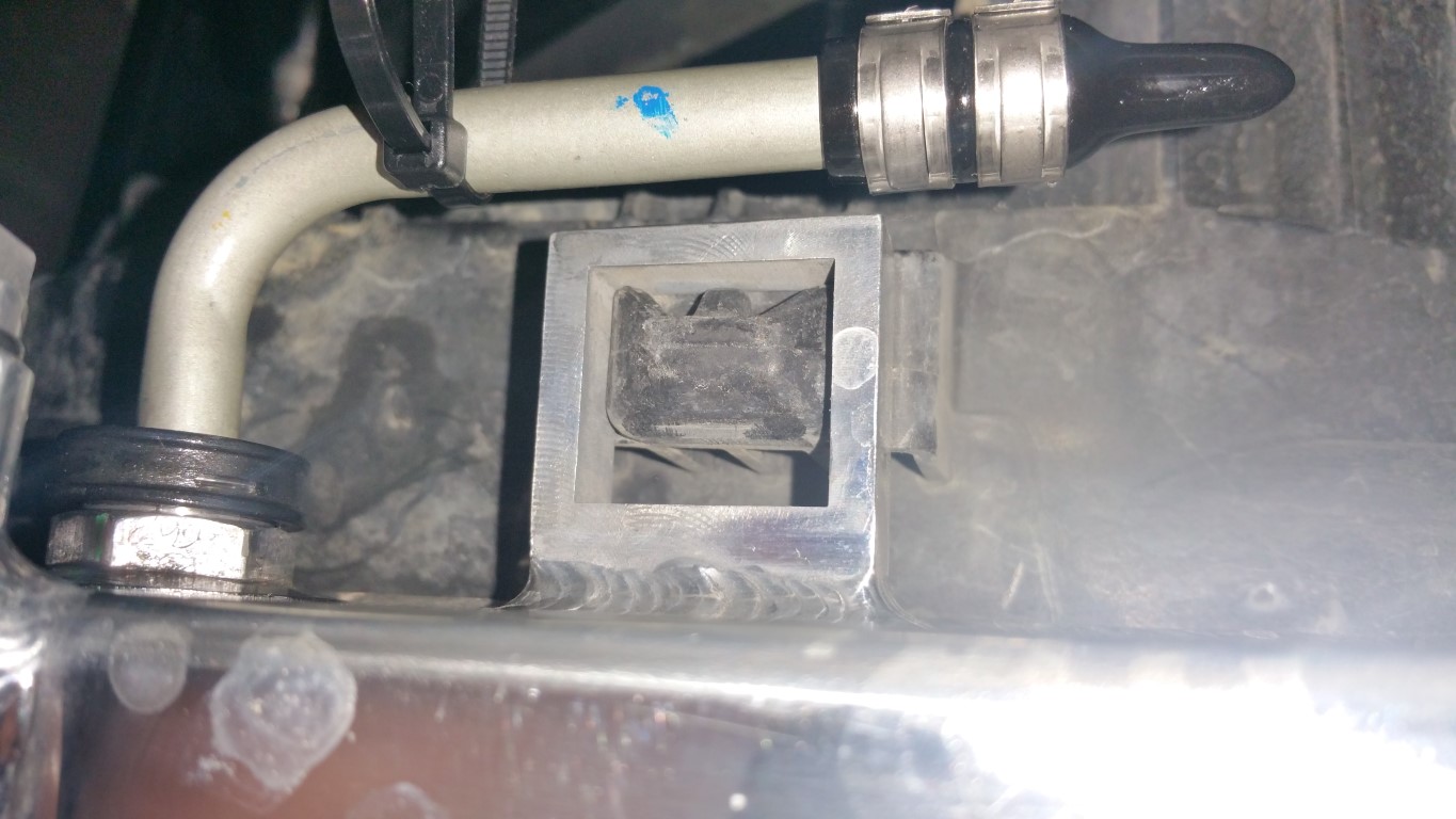

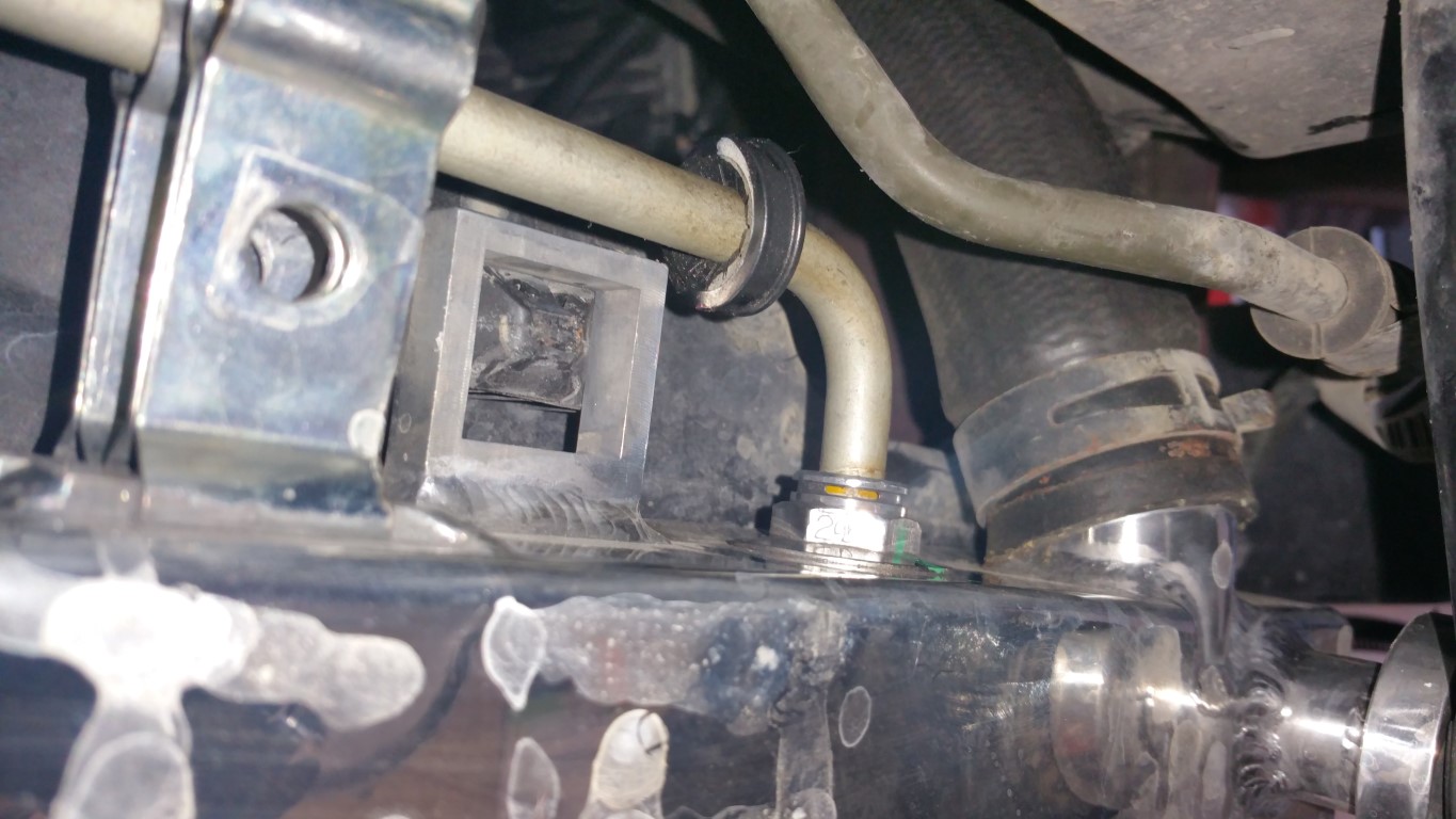

Now that everything is out of the way, un-hook the trans lines (make sure you have a drain pan) and remove the clips in the line (don't loose those! The new lines have them, but those clips are like gold!):

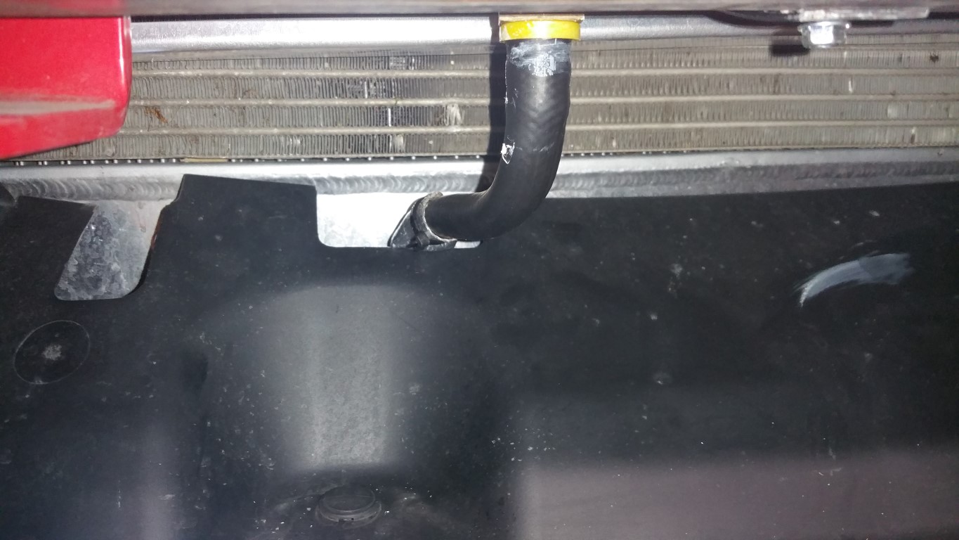

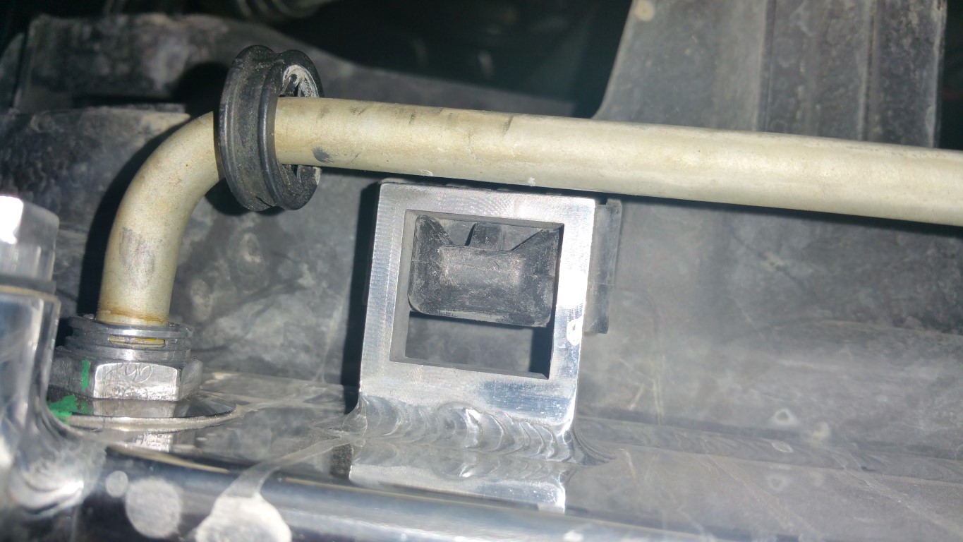

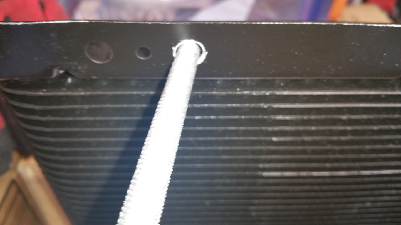

These are the 'plugs' used for the radiator when you remove the lines (removing the lines, you'll want to 'cap' the ends of the original lines to prevent a lot of trans fluid from leaking):
Now, remove the old lines, cap them and then install the new 'plugs':
Note that I used a ti-wrap to keep those inline and not 'rotate' while driving...

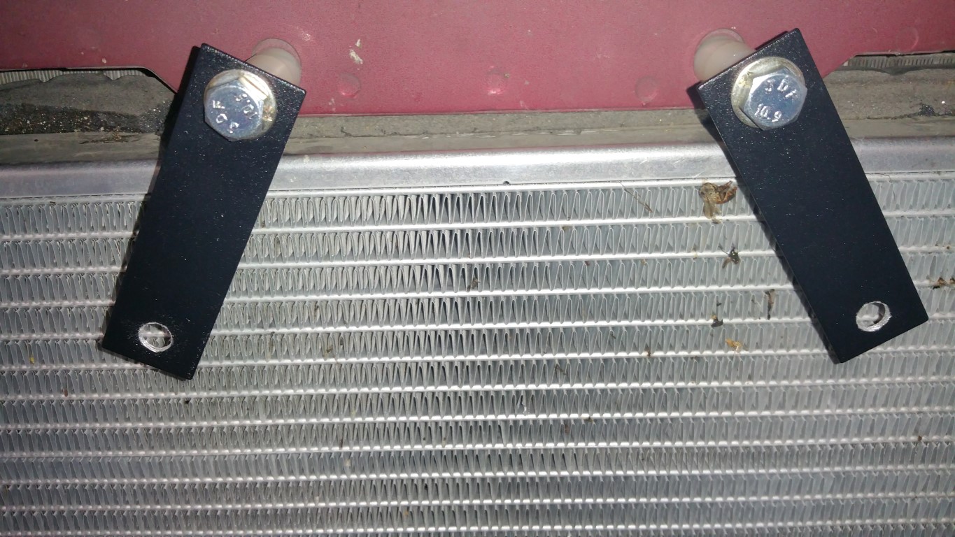

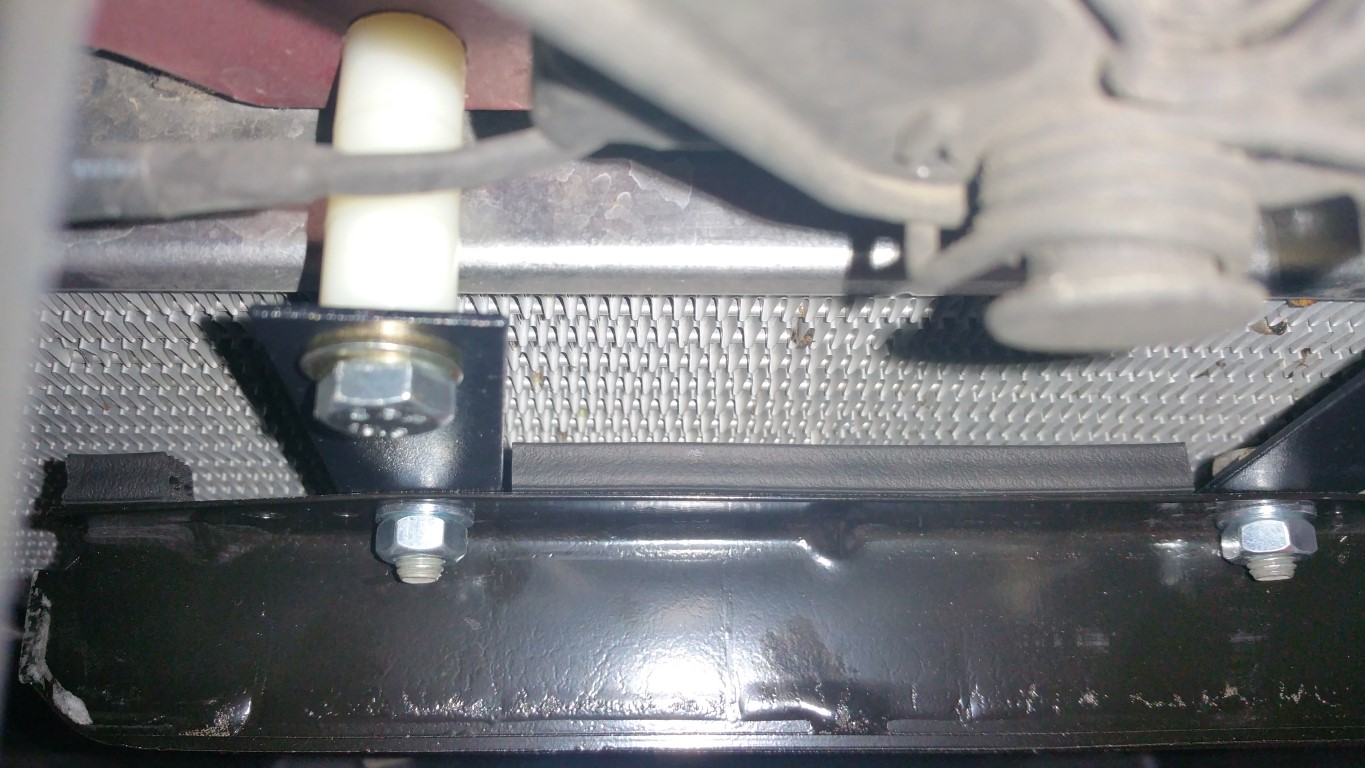

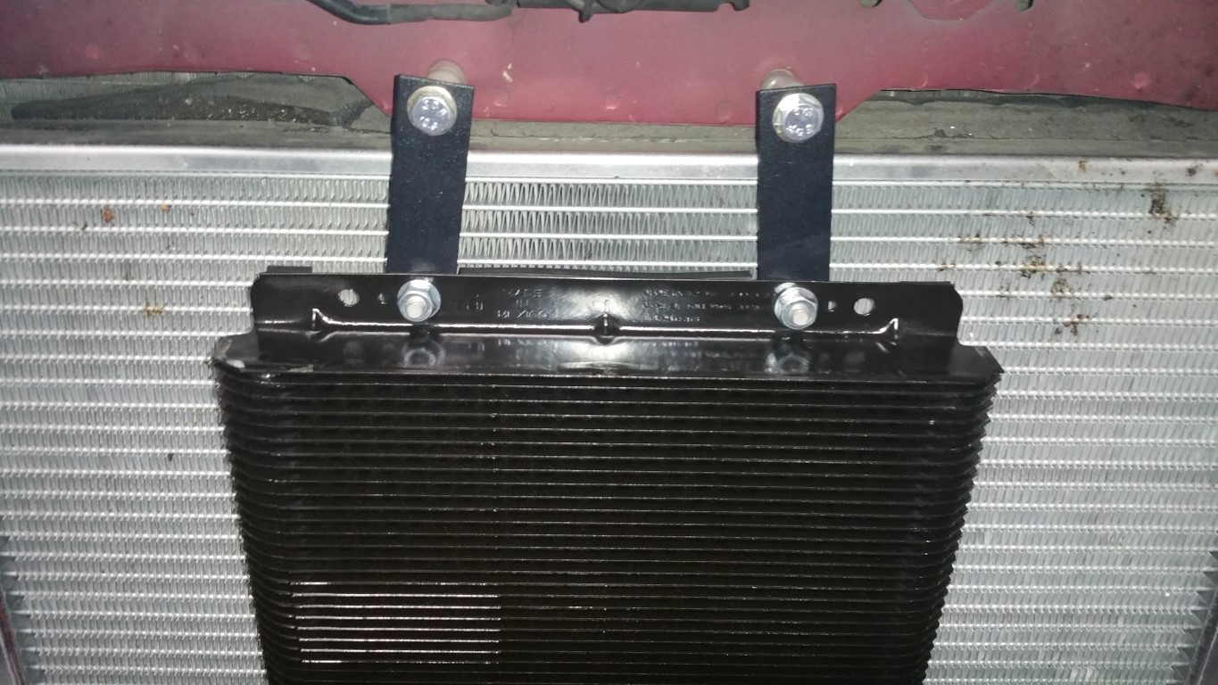

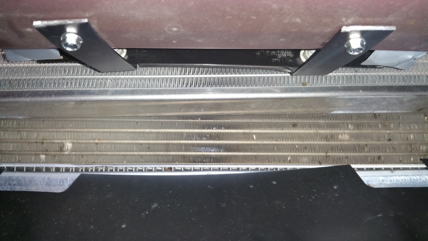

Now setup the cooler. I used nylon spacers as I have the Ron Davis HX. I also had to 'open' the holes on the cooler and brackets so the bolts would fit -- I also had to get longer bolts due to the HX:
Resizing:
Top brackets in place (I did use blue loctite):

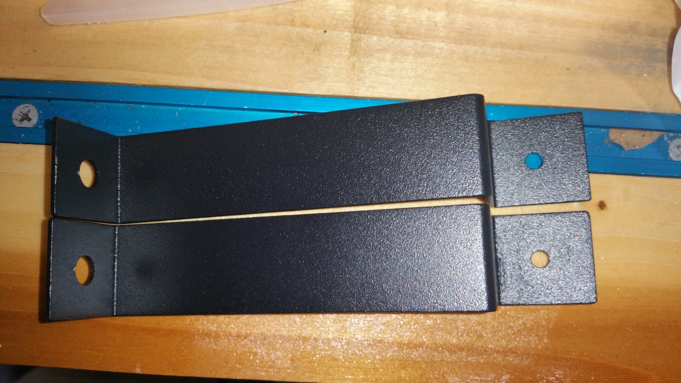

Next, the lower brackets, I cut off the 'ends' so I could just bolt it on the bumper. I do have the cooler 'higher' as I wanted to have the HX get more air:
The cooler in place and ready for the lower brackets:

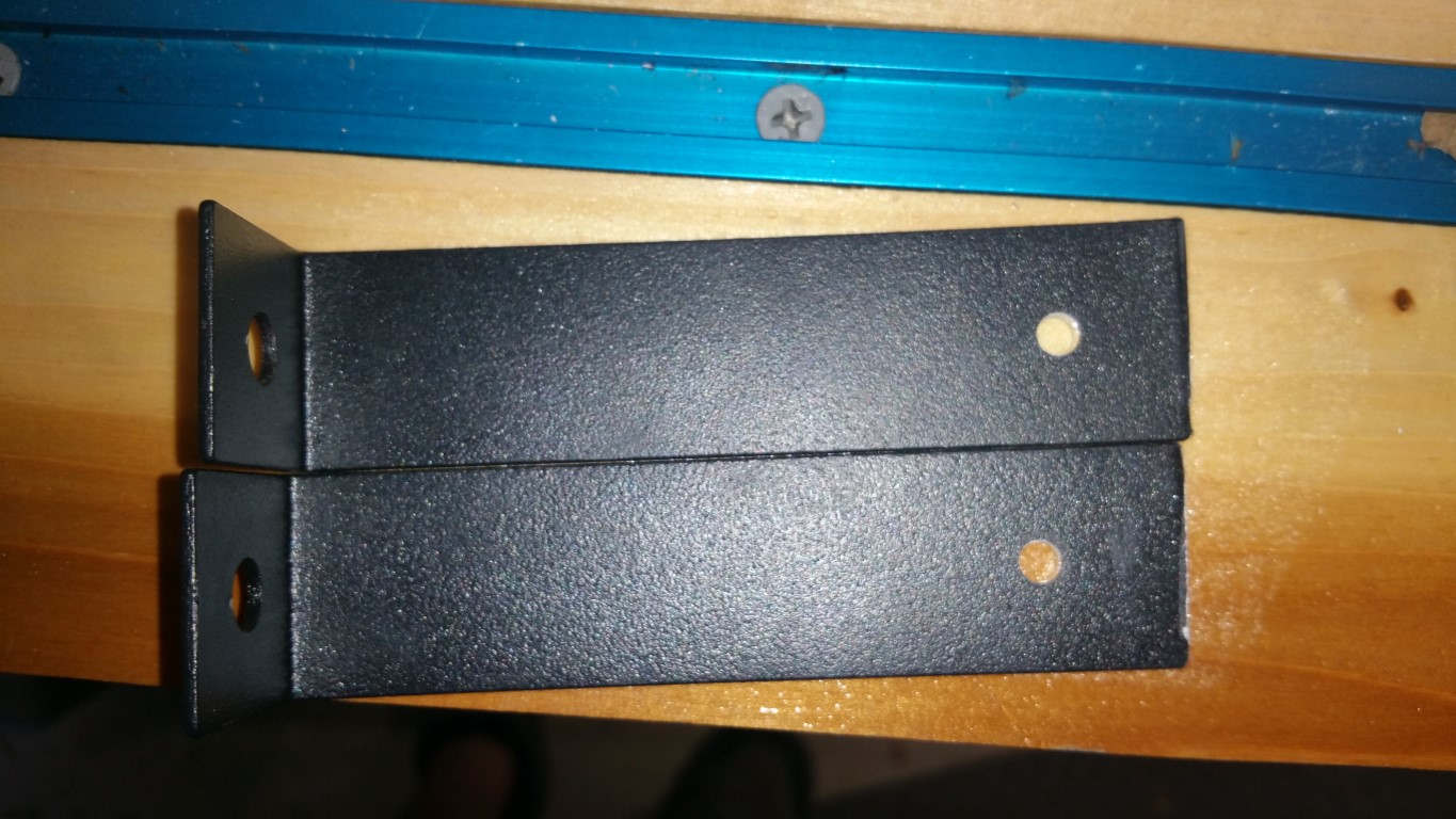

Lower brackets (before and after):
I drilled new holes in the brackets, and then installed them on the cooler. After that, lined the holes up, drilled pilot holes in the bumper, then installed the self tapping screws:

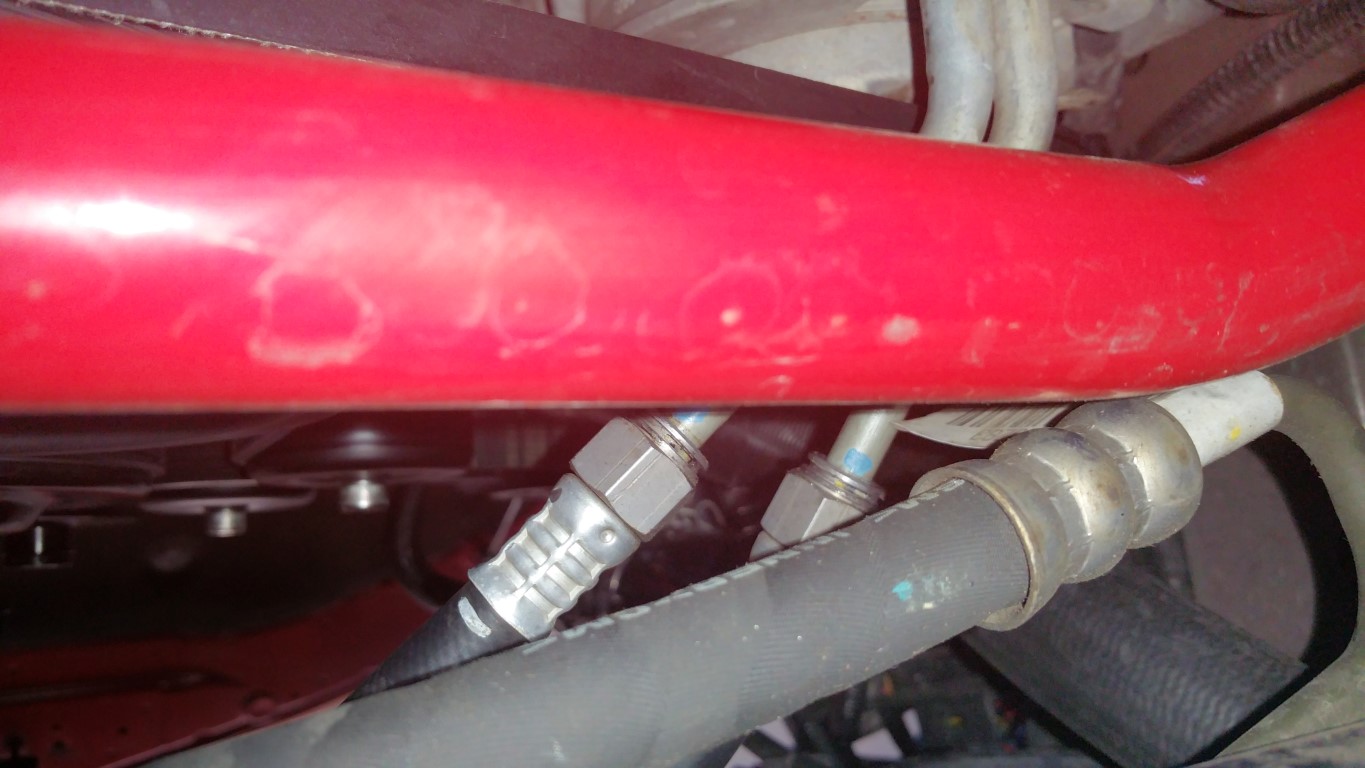

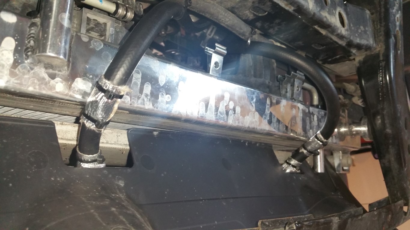

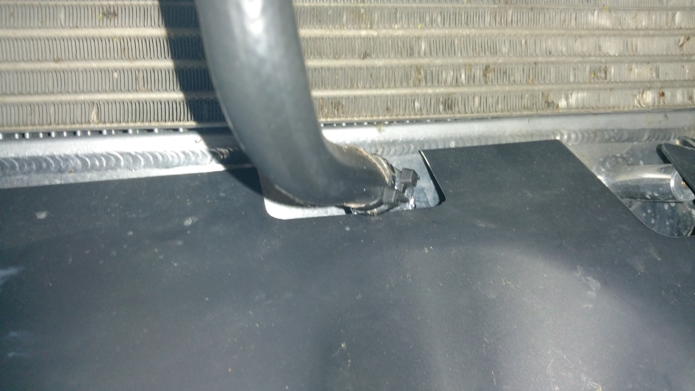

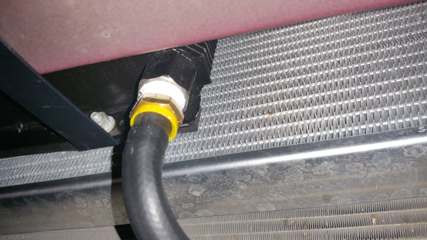

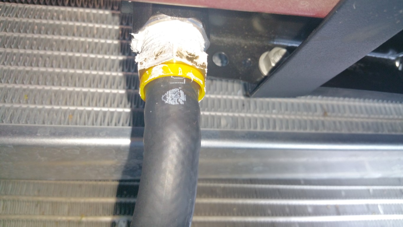

Next, using teflon paste, installed the lines (be careful to not overtighen them, just 'snug' will do):
Next route the lines so they can be hooked up. I did put heat wrap around the hoses to protected them from 'rubbing' and heat from the radiator too:
Lines hooked up and ready for start! (Note how I ti-wrapped them and then we'll check for leaks):
After checking for leaks, then I reversed the steps to re-install, started the car, and then
topped off the oil (trans temps need to be between 84* and 122* when checking the oil. It was hot today so it was already over 100*).

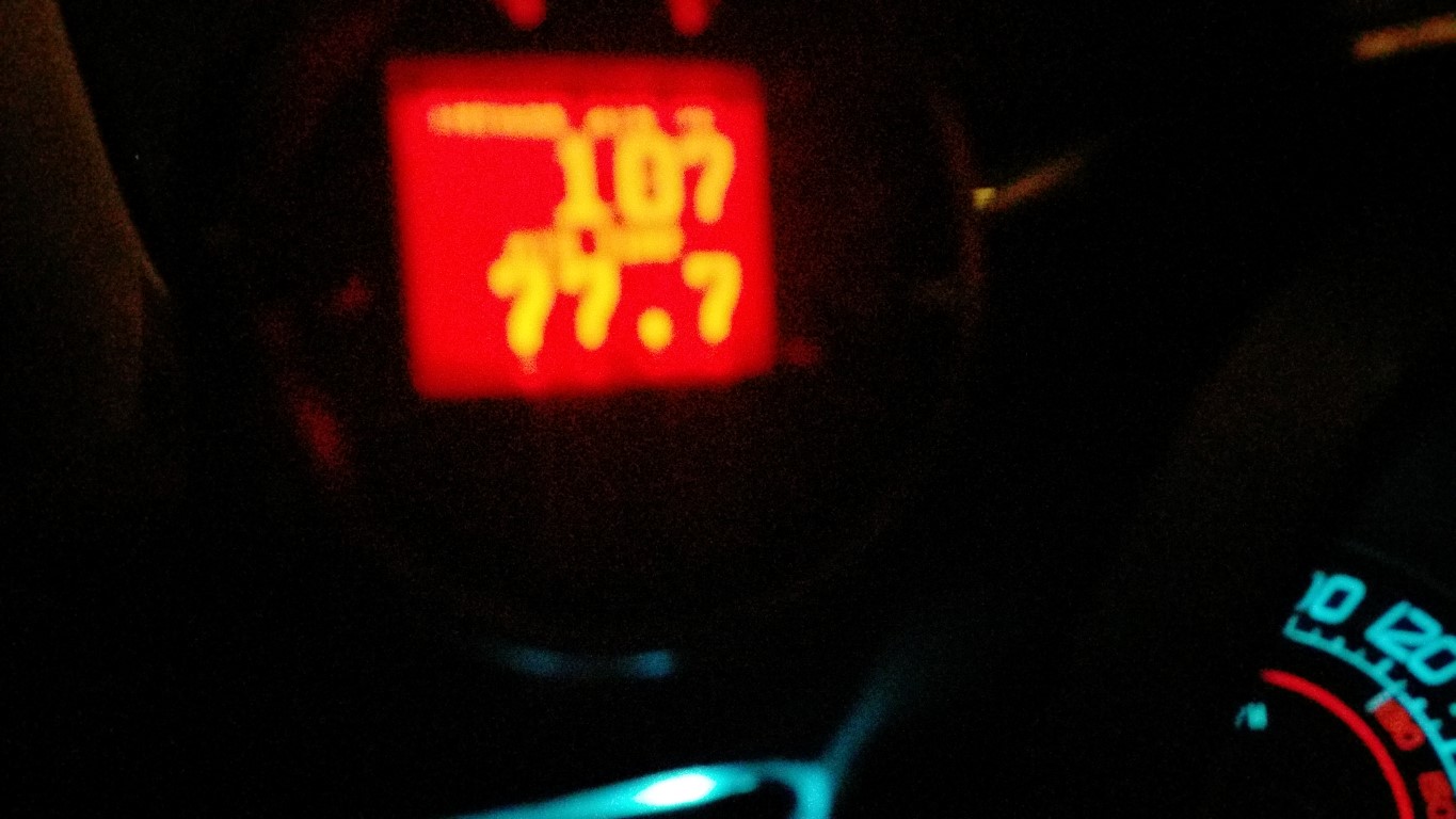

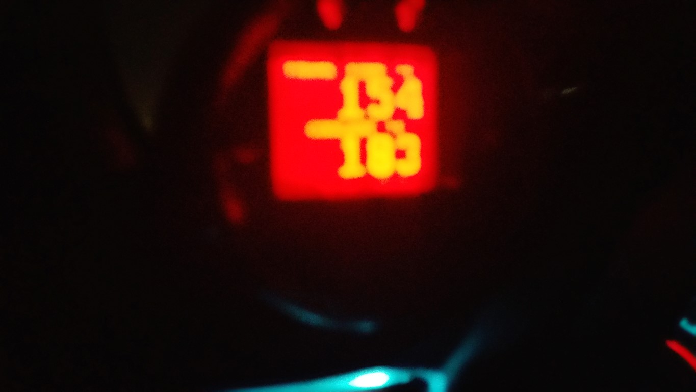

Here are some (rough) pics of the temps while driving (it was 106* today!). You'll need to 'cycle' the transmission (Reverse, neutral, drive, S and then back again for about 2 to 3 second in each gear while checking the oil before driving):
(Trans temp is the top number (154*), bottom number is the Radiator/coolant temps (183*)):
IAT Temps (top is IAT2, bottom is the CAI temp -- that is the aeroforce temp sender in the CAI -- it reads cooler for sure. Ambient was in the 90's at the time):
IAT2 temps are up about 3*, so I'll adjust the intercooler coolant mix to see if 80/20 will help it out.
Very happy with the trans temps! A 20 to 25* drop is awesome in this Texas heat!
