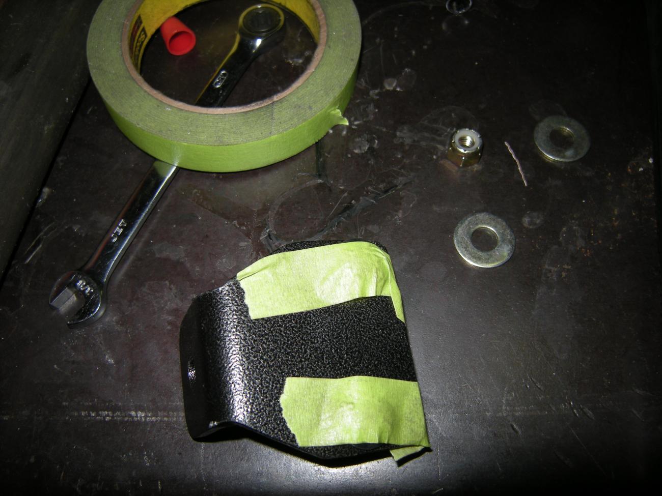

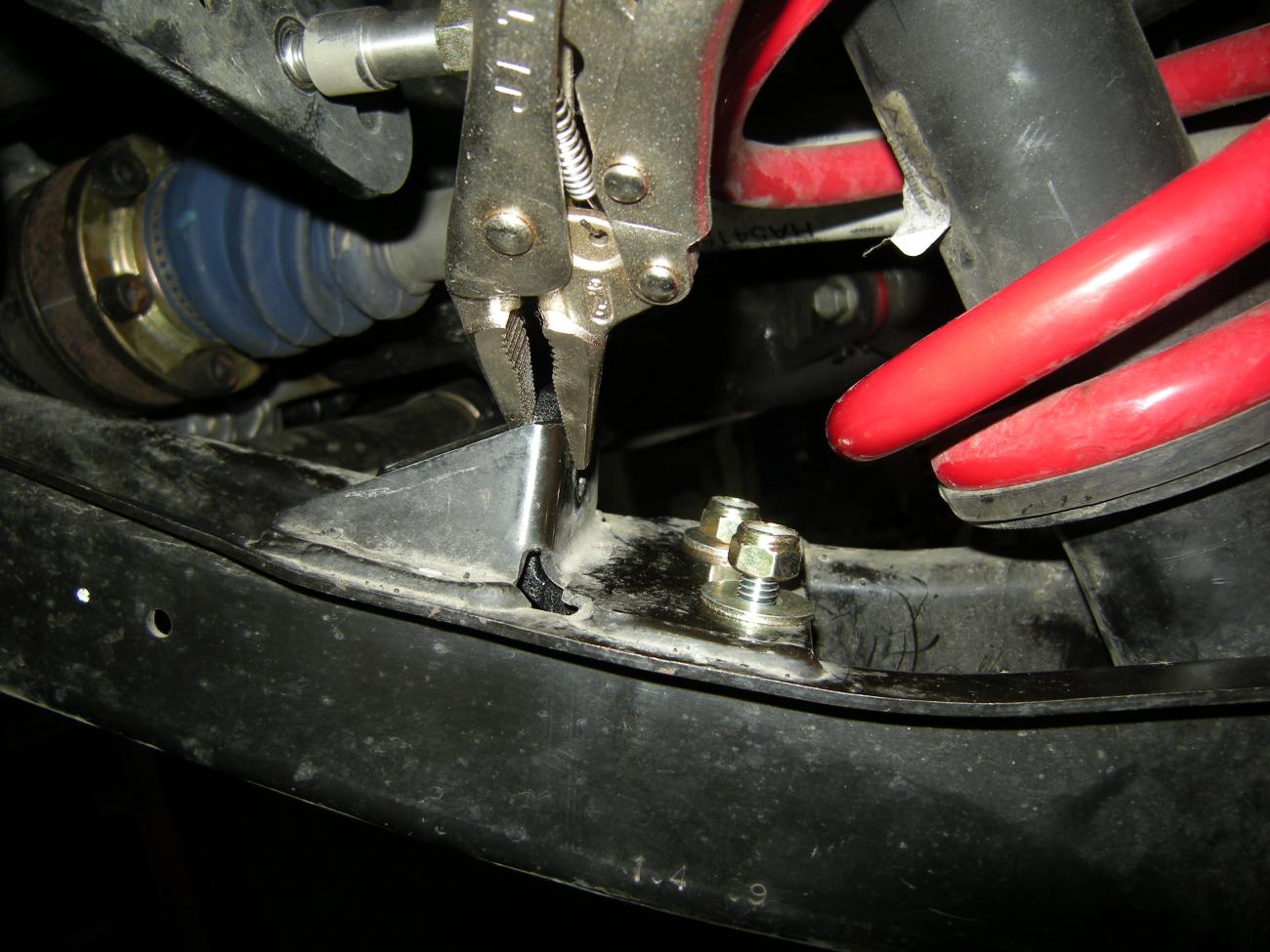

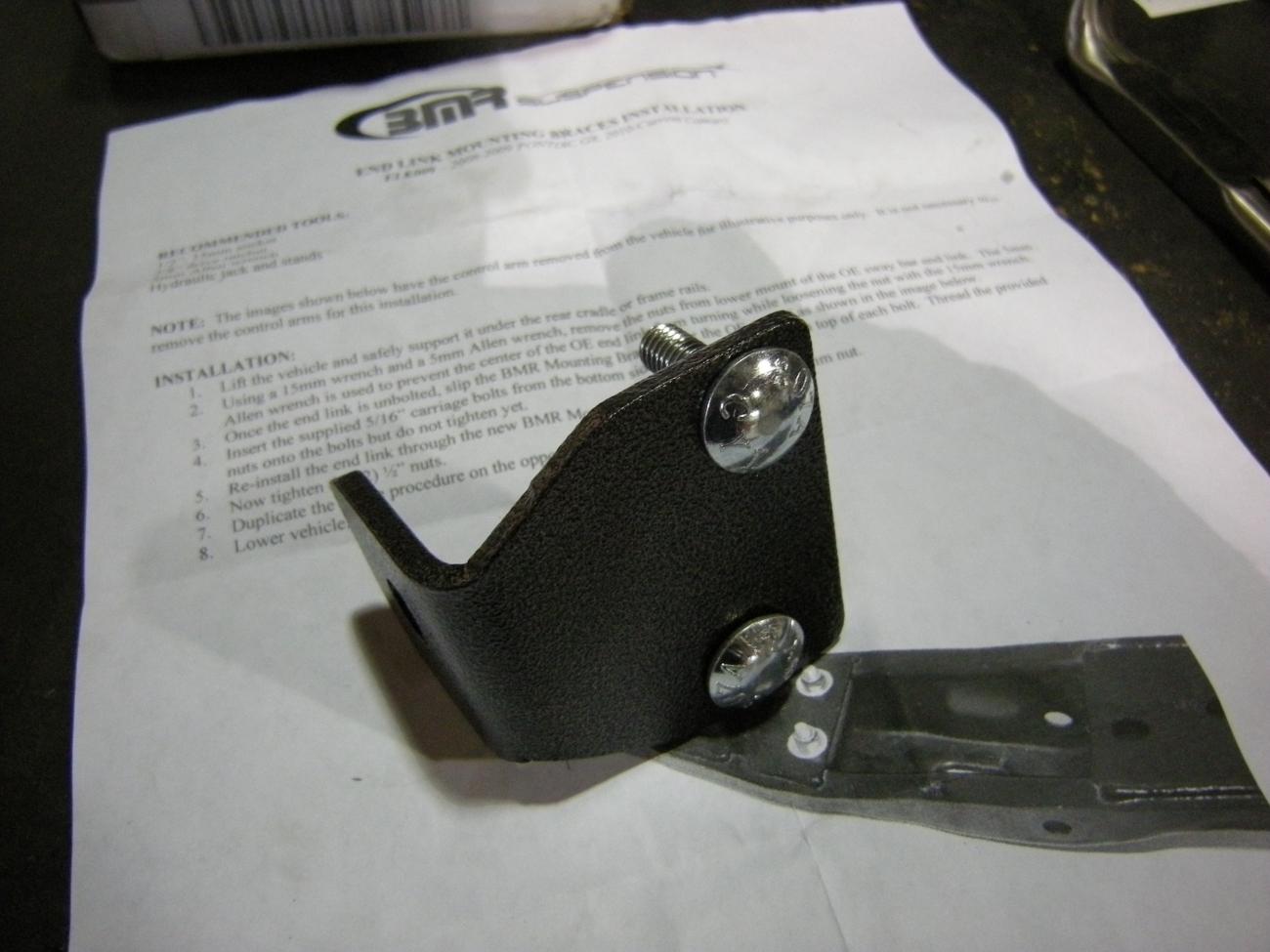

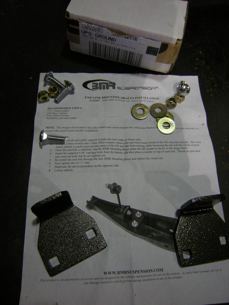

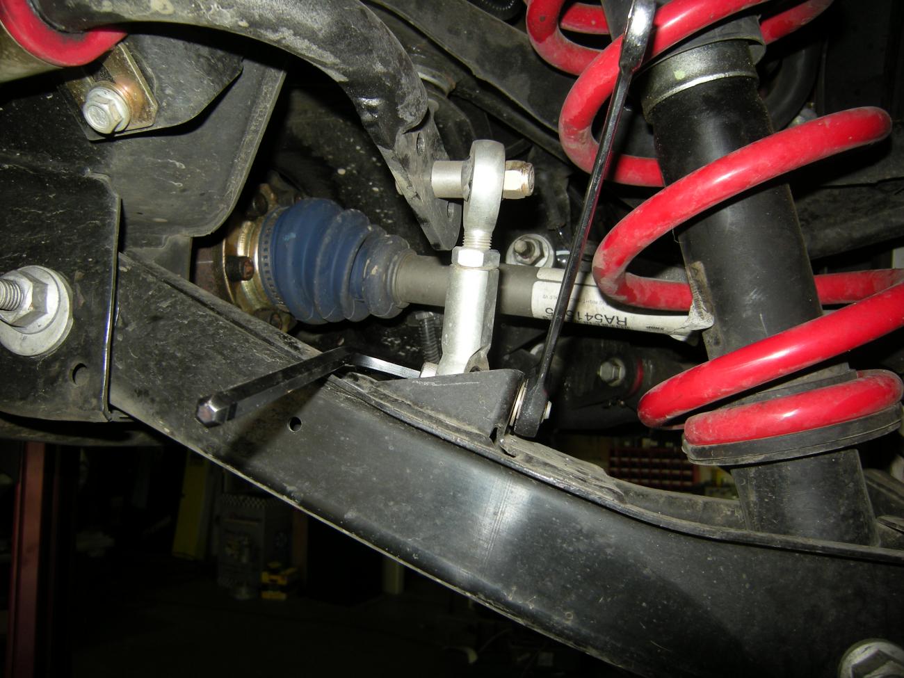

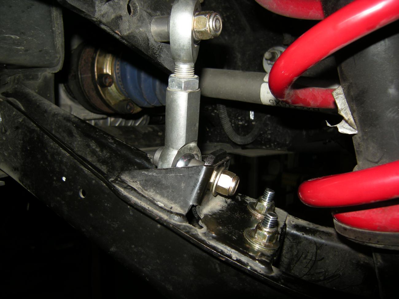

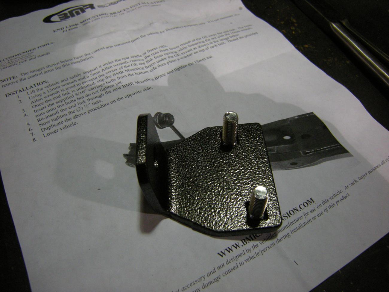

Finally got around to installing the BMR LCA brackets. Not a big deal, but you have to kinda hold your tounge right to wiggle the bracket in with the bolts in and get the nuts started. If you tape the bolts to the bracket it helps.

Hey Merc,
did it change the angle of the end link much???
I need to get mine installed this weekend....
Old 06-02-2011, 01:04 PM   #727
Merc
In The Circle
Merc's Avatar
Posts: 11,310
Hey Merc,
No. Not really.

Just a footnote to the BMR LCA brace. Once you have secured the the carriage bolts to the bracket with tape, you have to wiggle it in from the inboard end of the LCA.
