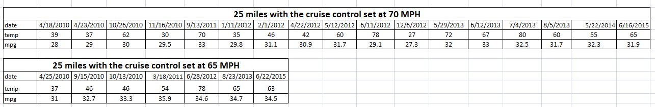

I use 93 octane so as not to have timing pulled which robs the precious few HP I have available in my Camaro. Being only the baby V6, I need every pony I can get.......
Also, I don't need to drive 60 mph to get over 30 MPG. I get over 30 MPG when setting the cruise at 70 MPH. Every morning on the way to work. No reason to go faster for the 25 minutes I am on the highway at 4 am. Need to see the police before they see me doing any faster than the speed limit.
Everyone has a reason for using what they use. All good in my book. Strickly expressing what I do and why.

Originally Posted by Wizzer View Post
I am looking at your build list in your sig and I can not figure out how you get 30 at 70mph. That only happens to me going downhill for a brief sec.
I set the cruise at 70 mph for a 25 mile commute to work setting the DIC each time. Here are those results as I have recorded those results multiple times.
