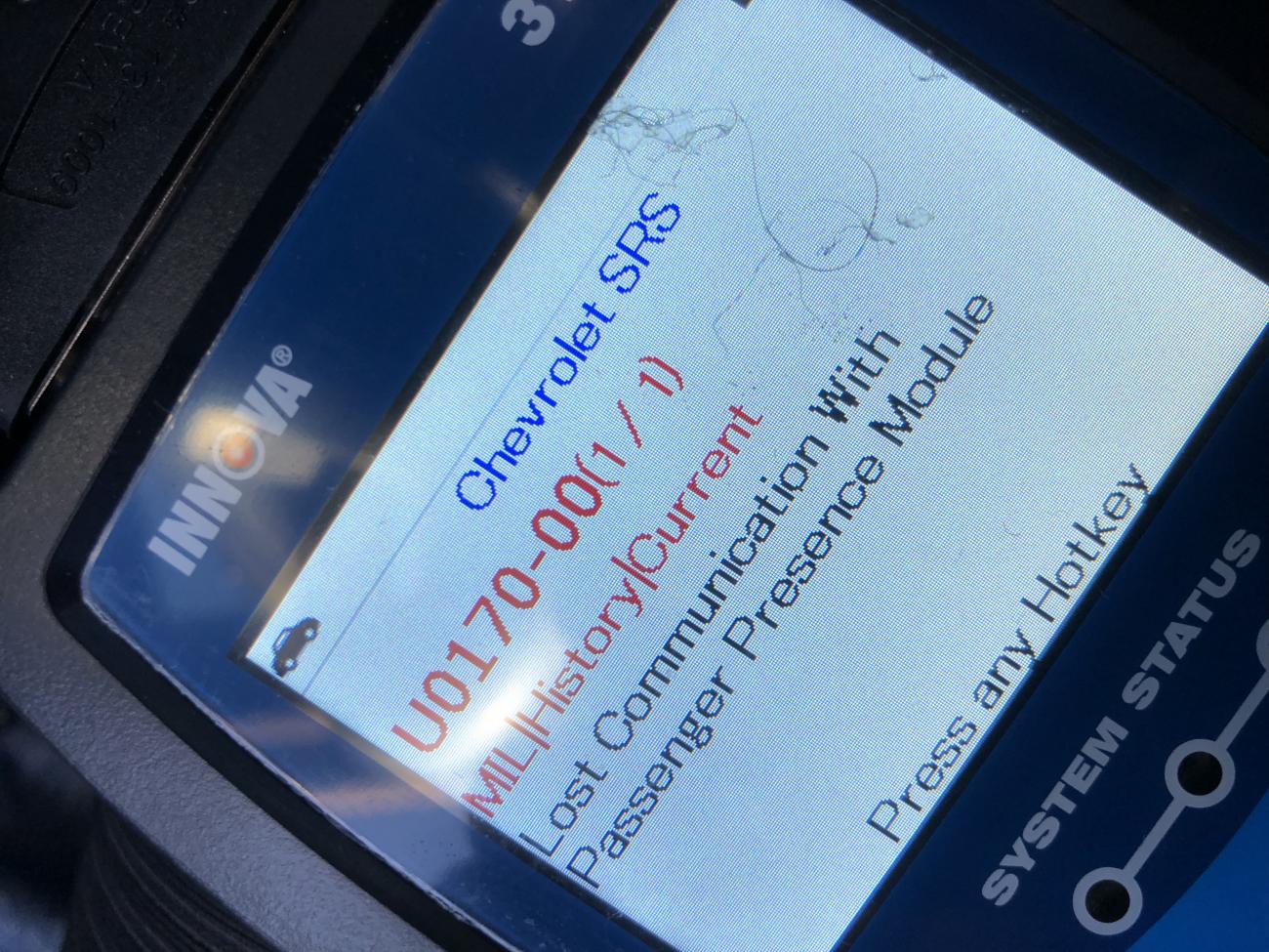

Angry Airbag connection issues, passenger seat
For the longest time I’ve been dealing with a certain ABS airbag light that just doesn’t want to go away. I ran a diagnostic and from what I can determine the failure is coming from the passenger airbag sensor, so I did the logical thing and ordered a replacement.
Upon replacement, the light did not go away and the diagnostic code referred me to a connection issue as the sensor and the computer on my car were not communicating.
Then I though that perhaps a wire had come loose during replacement, as I had to remove the seat in order to get to the old sensor.
There are three different wires that connect to the airbag sensor from what I’ve been able to understand, one green, one black and the other red with a white stripe. The red wire isn’t connected to anything once I trace it back under the seat yet the green and black are. Simple fix right? Plug the red and white back into its socket and call it a day?
Except the white and red stripe doesn’t seem to have a pin on the end of the wire...
My question being... does that particular wire come unconnected by factory or did I somehow manage to remove it along with the pin? If so, can I recconect the circuit without blowing my airbags?
Archer1337 is offline   Reply With Quote

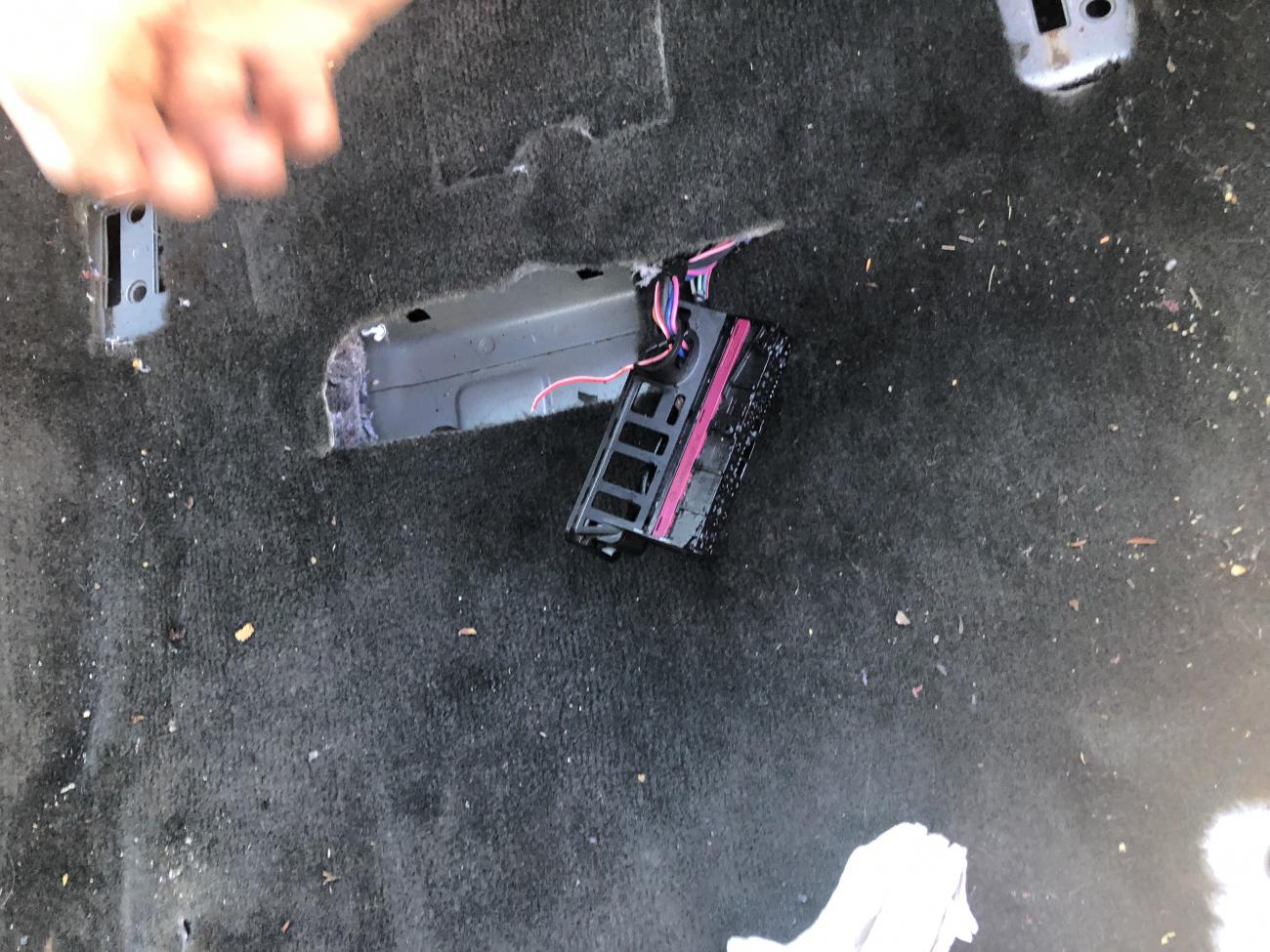

I neen the part in picture 1 with a couple inches of wires. anyone know where to find
Anyone know the part number or where i could get the part at with a couple inches of wires would be nice.
