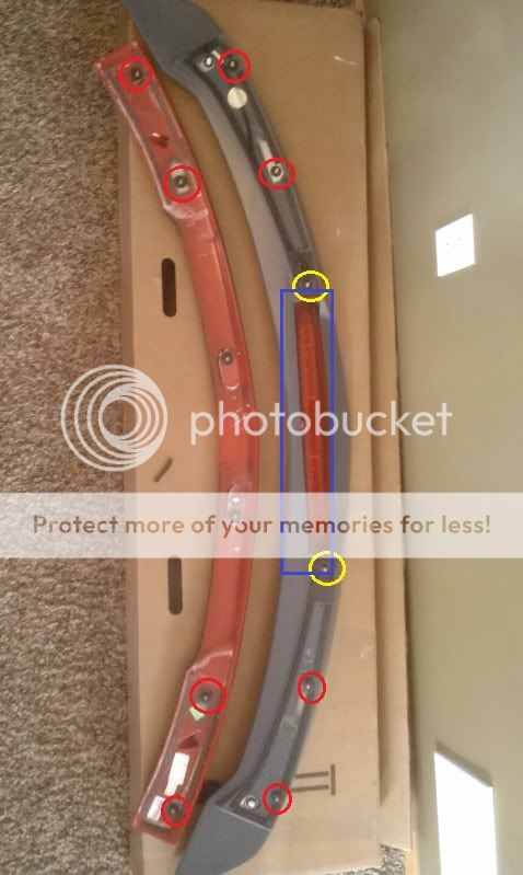

Ok, easy. Do the bolts circled in red match up? If so, couldnt you just remove the bolts circled in yellow and 3m the area marked in blue to prevent water intrusion? If the red bolts do not match, I see the problem.

Here is the problem it is not the 2 extra studs, you need to drill 2 holes for them on top (5/16") but on the inside you need to drill with a hole saw(1") you need 2 more holes in the front for the aligning plastic studs, and last you need to drill 1 (3/8") hole for the brake light wire, So that is all the holes you need to drill, now for the 3 holes that the spoiler does not cover, here is the big problem, the way the spoiler is made the brake light sits at a 45 degrees to the trunk lid , so its open under the brake light, that lives the 3 old holes open, the only way to fix this is by moving the brake light.

my original thought was if you take off all the studs but the 4 that look like they will line up and use 3m that should hold it BUT...I didn't know if the holes under the brake light could be seen...evidently they can be..

does it look like there is a way to make a filler piece to change the break light lens angle to cover the holes, use the existing holes for a place to route the wires and add a stud to anchor the center of the spoiler..?

I will truy to remove the light and see is we can move it.
