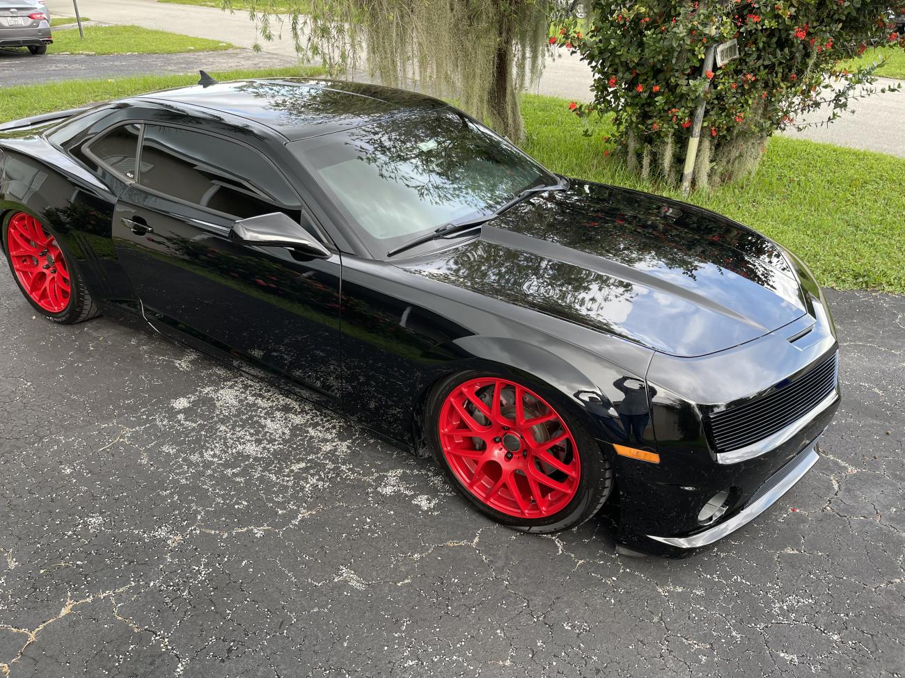

I am running 20 x8.5 front and 20x10 rear with factory offset. I just upgraded 3 weeks ago to dual 444 compressors. I couldn't take how long fill time was while wanting to press buttons.

okay I know its been about a year since I've updated this and my progress has been so far I've made about 12,000 miles on air lift in traveling with zero issues. after going to do compressors I've had a lot less feel time I can use it more often and it never gets oldI have not posted probably about 800 plus pictures on Instagram most of them are of course I did that Wynwood group area that I posted in the other forum I do have to say I have one peeve though and that is all the people who claim that they never saw my posts or my thread write up that helped them to install their kits if you did an install after the start of this you have lurked all I ask is you to admit I helped save you alot of time guessing where to put things. Just in my local area alone I know I am the reason that has attributed to several lexus, BMW, infinity , Nissan and several Volkswagens Camaro and even a few fords to installing air suspension. My instagram is @Camaro_ss_airlift don't be shy stop on by. As of now with 6k plus views anyone who has questions feel free to ask. The fastest I've gone with this kit installed is 163 on a back road by Tamiami airport not your regular freeway it has one entrance and it's the same exit. I drive at stock height it is impossible to drive this car fully dumped at any rate of speed faster then babysteps because the rear tires become inverted. You should always put dryers between your compressors and tank don't rely on the tank to hold water. Keep your manifold elevated to ensure it doesn't collect water. It's late and I am a picture whore.

Yes I drove back to Portland Maine last september that is the same light house as the first thread picture. That is also the original Ghostbusters house in NYC. I have driven maybe 25k Miles now and it still doesnt get old.

So after a couple more years I am finally sticking my head back in I am now up to 95,000 miles which is about 62,000 miles on the car since I did this I’ve also replaced the entire end CV shafts and all that but had nothing to do with airlift just my driving and I must say I am on my fourth set of air compressors who knows how many fuses but the management system in the bags are all just fine I am still playing with it and I probably have over 10,000+ cycles on it at this point if you have any further questions feel free to ask and I have not updated this in five or six years I also didn’t realize I haven’t even been on this form in two years I guess Time flies when you’re busy with work
