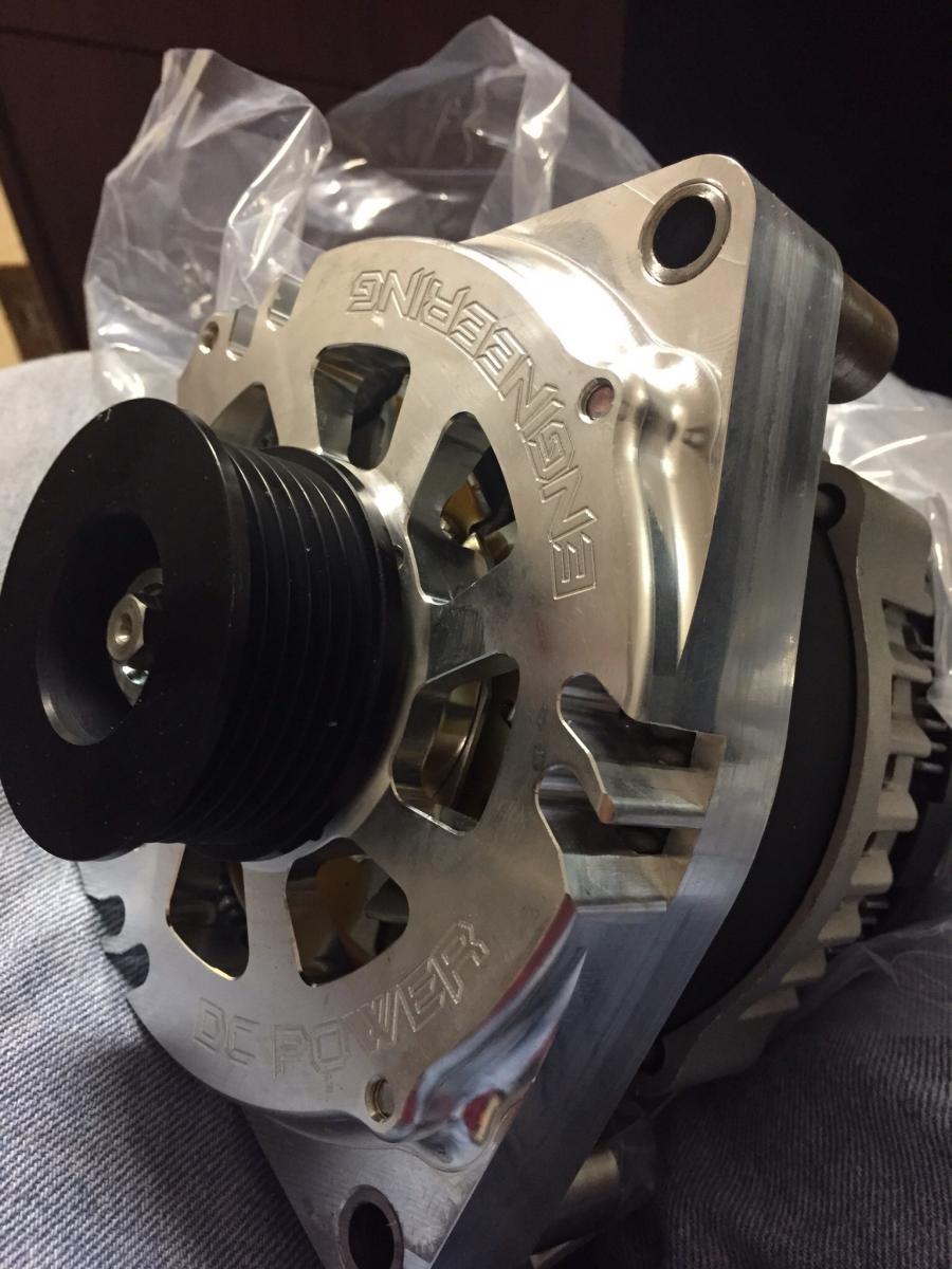

So with driving the two Lingenfelter fuel pumps in the tank, and the two big Weldon external fuel pumps, fans etc..., we decided some power was needed for the charging system... This is a DC Power Engineering 250 amp alternator... No lack of juice here... I had to do some light clearancing to fit it but that was no issue...

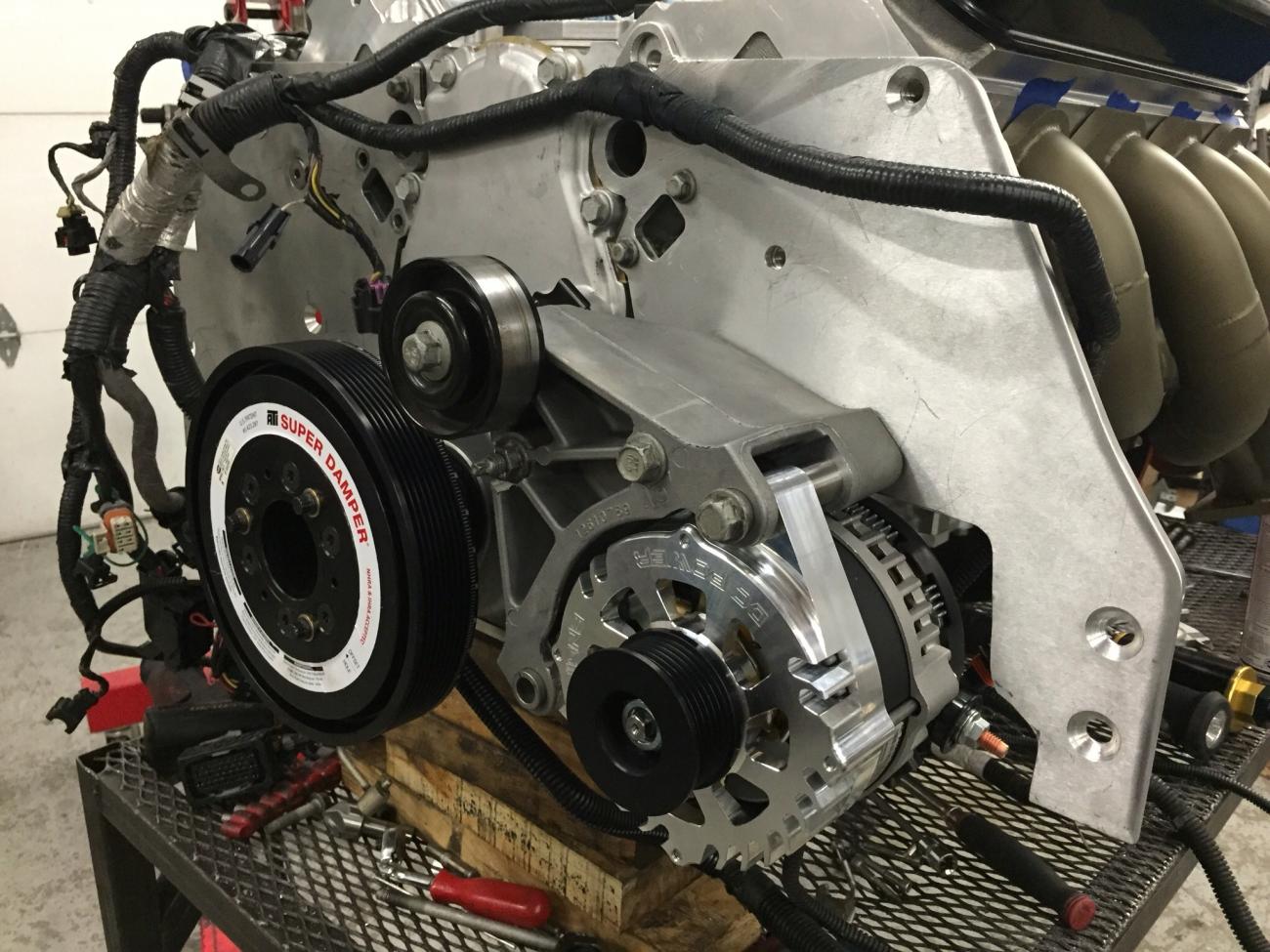

And here it is fit to the motor...

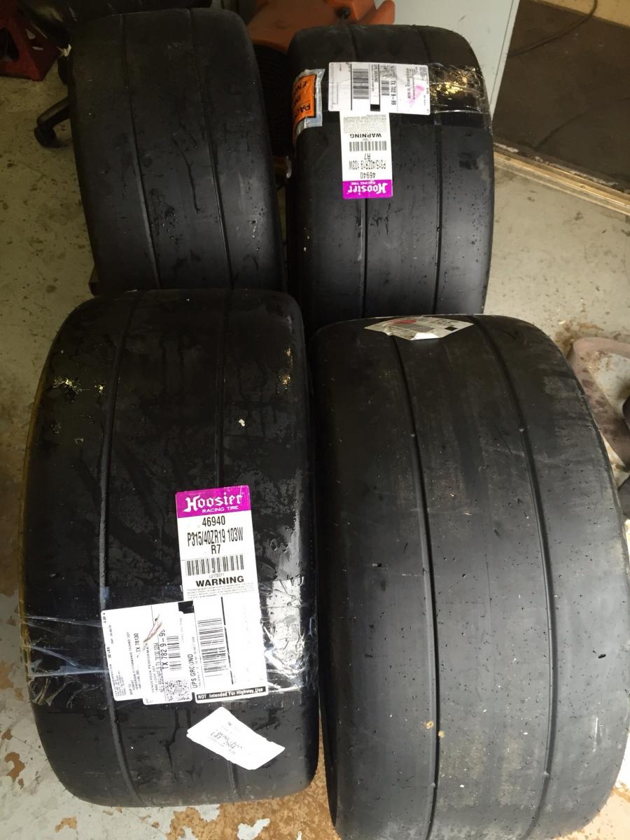

Some traction action arrived today... Been trying to get these for two years... Thanks to Micheal Burrell and friends for making it possible...

Are those tires mud & snow rated?

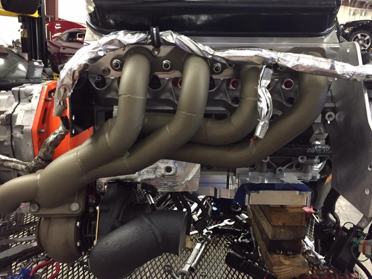

I did the final cleanup, fitting and installation of the turbo manifolds and turbos today... Everything is getting heat wrapped and insulated to the inth...

The driver side installed... The final clocking of the turbo will take place after the motor is in the car, which could be as soon as tomorrow...

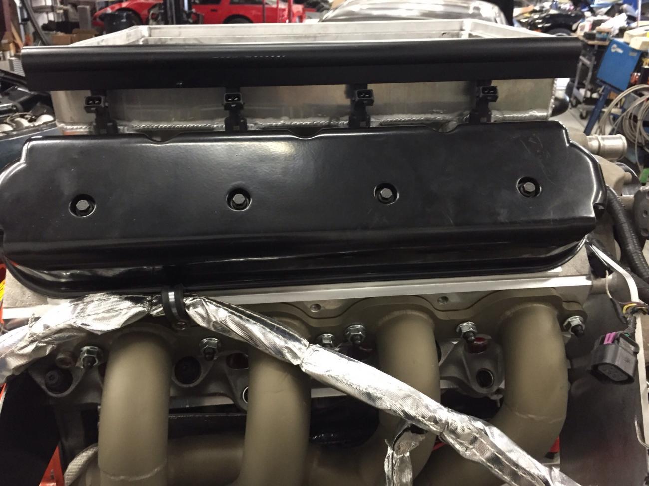

We made some more progress today... Corey got the second Weldon fuel pump installed and he built the new fuel rails. These are 3/4 ID rails with FIC 230 lb/hr low impedance Siemens DEKA race injectors...

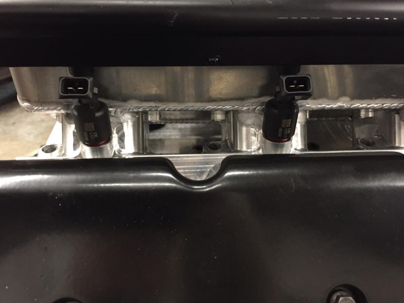

A closer view of the injectors.
