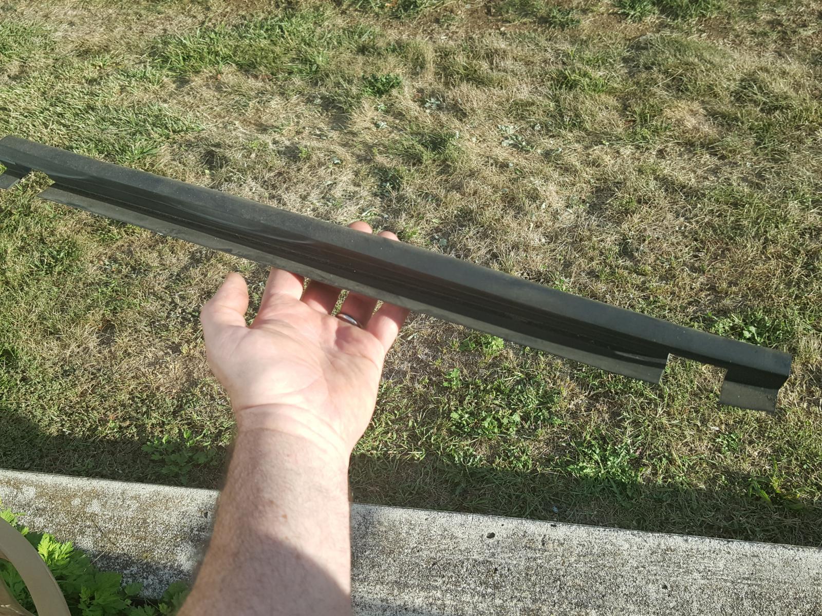

Hammdo,
I'm sure we've all finished at least one job with an extra bolt left over or part.......lmao...... any idea what this seal is I can't recall for the life of me....maybe something above or below the radiator ?

Posts: 8,709
Yep, that looks like it goes on the top of the radiator towards the front. I may need to see the other side to be sure, does it have a 'groove' in it? There is also one on the bottom I believe. That looks like its for the radiator deflector so air is directed to it.

Mrbowtie26
Mrbowtie26's Avatar
Drives: 2015 CRT 1SS 1LE
Location: West Haven CT
Posts: 593
My ZL1 upgrade changed a lot of that so, I don't have it anymore ;o)
-Don
Yes it has a groove in it on the other side.

hammdo
'It's an experiment'
hammdo's Avatar
Location: Dallas TX
Posts: 8,709
Should go here:
In the front of the radiator cap, top

Mrbowtie26
Mrbowtie26's Avatar
Posts: 593
Should go here:
-Don
Ahh alright thanks !!
