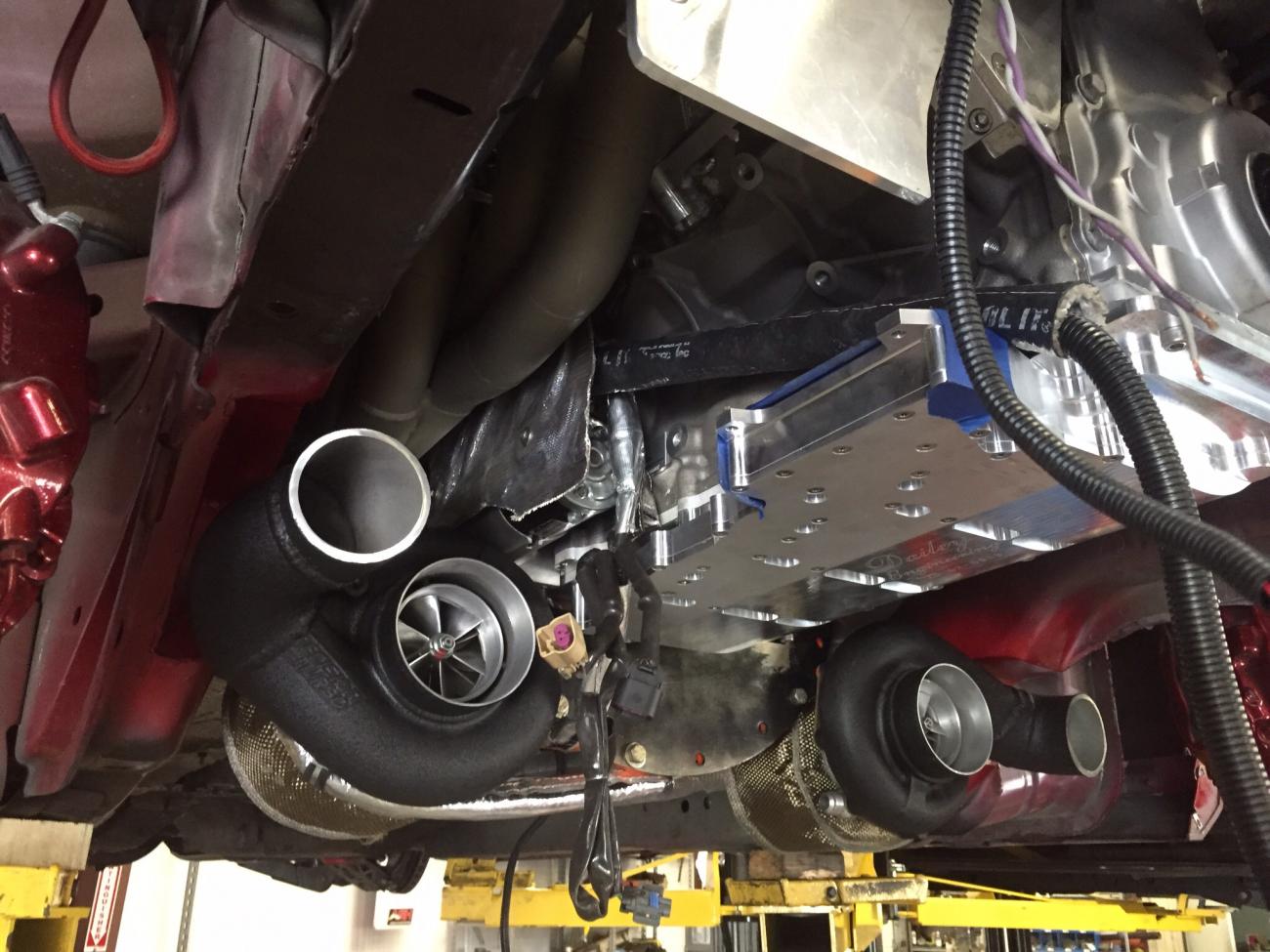

So a few more update pics... Again I'm sorry as my iPad will only allow one pic per post...
So, the motor is in the car...

This is the draw for the new additional Weldon fuel pump... It's a -12 bulkhead fitting with a dash twelve hose down into the tank...
The primary fuel pump is the lead Weldon, drawing from the sump tank. The Lingenfelter duals run wide open with no restriction to keep the sump full... The lead Weldon runs in slow speed til a given boost is reached, then it goes to high speed... At the next chosen boost level, the second Weldon kicks on in high speed only to supply the fuels rails via -12 fuel line, splitting to -10's right before the rails...
All of this is managed via the ProEFI 128 bit Engine management system...

3/4" fuel line?

3/4" fuel line?
Go Big or Go Home Texas style.

Yes that is 3/4 inch ID fuel line.. There is a short piece of -10 from each pump, going into the -12 which runs to the front of the car and splits back into the 2 -10 lines, one to each rail... With 225 lb/hr injectors, the fuel demands will be extensive... And Mikie, the mile is in the cards and I'm signed up...
