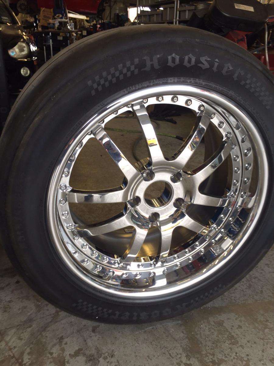

Those tires inspire confidence, good looking wheel too!
Thanks... They do inspire confidence...

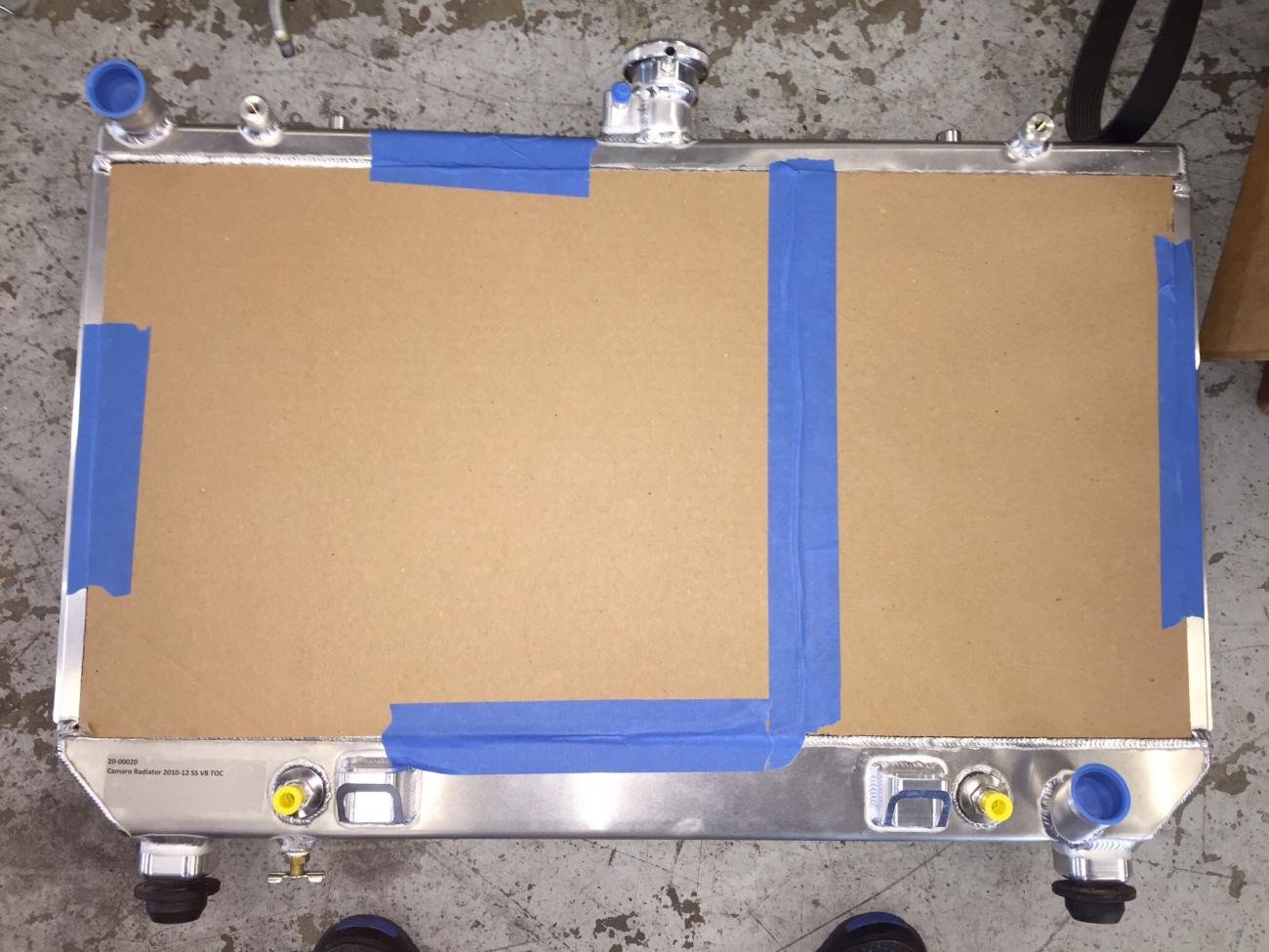

What happens to the stock radiator when you lift a head and blow the head gasket out of three cylinders... Well, some of that pressure goes into the cooling system... And the result is...

We got a replacement the day after that was discovered.. It was hidden behind the intecooler and so not found til the other day...
This is the replacement radiator from C&R... Nice piece...

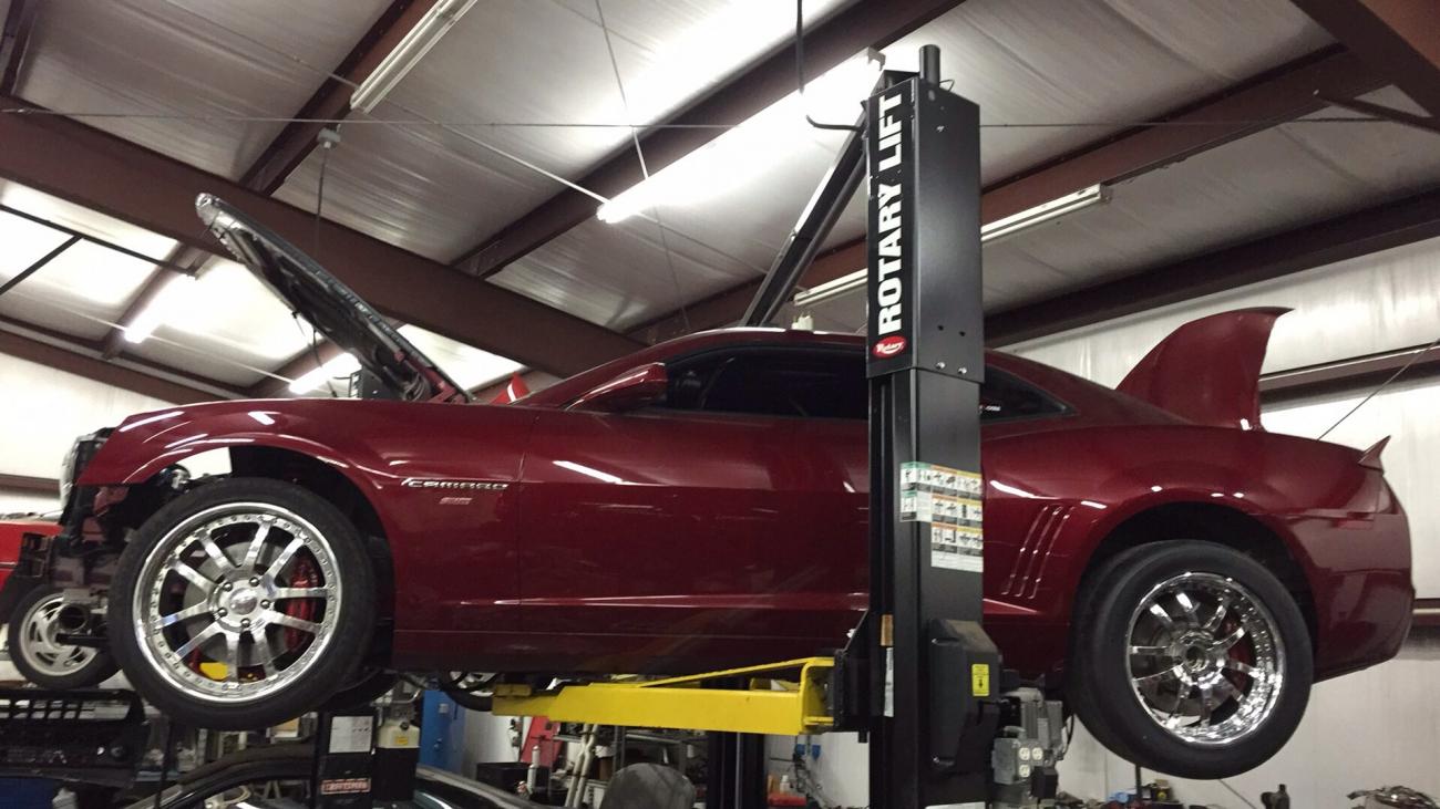

Posts: 15,799
Here is a pic with the new rear tires and wheels installed... The tires are really soft compared to the GY's.

Posts: 1,128
Even with a full alloy rad, it pressure gets too high it too will expand and possibly burst. Biggest difference is it will cost more to replace.
Monitor cooling system pressure and include some safeties based around it if need be.

We can add in the pressure sensor for the coolant system, but you are correct in that even with this radiator, it can happen.? The problem is it's so sudden it may shut the motor down but the damage will probably already be done...
The biggest advantage here is the additional cooling capacity since the block is half filled...
