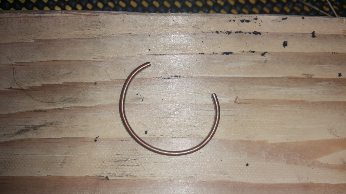

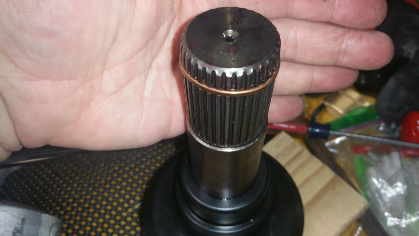

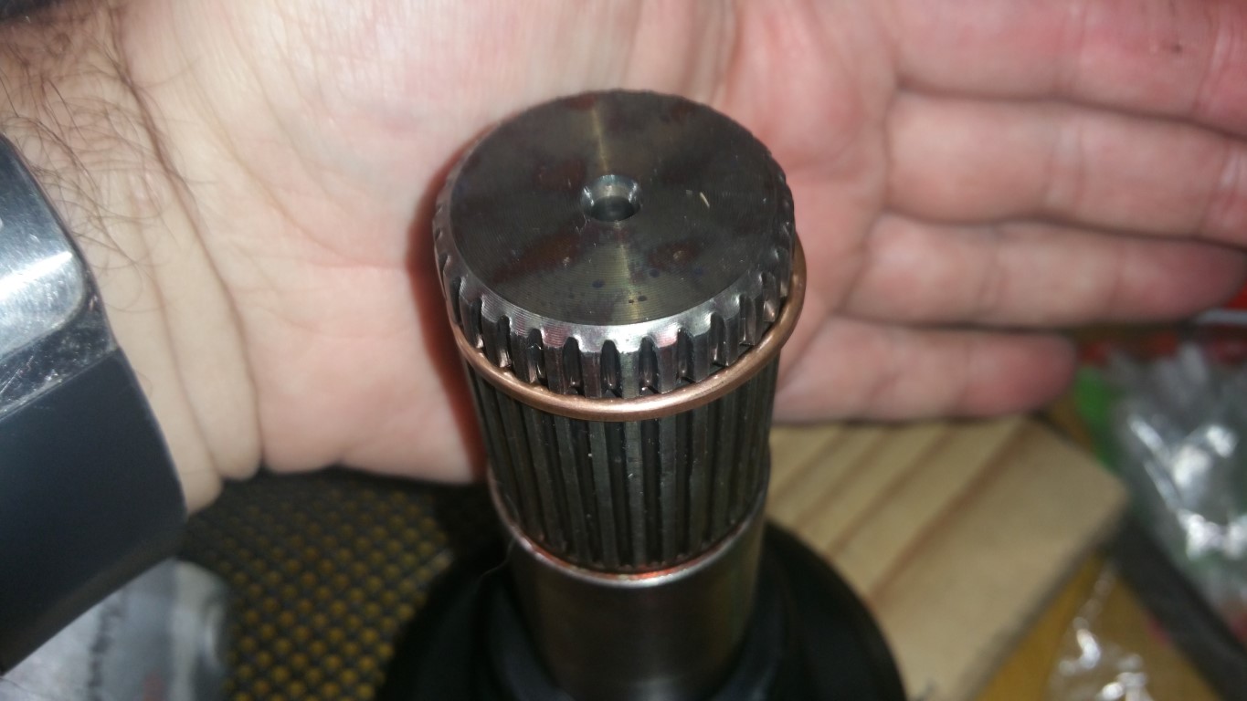

OK, adjusted the c-clips in the axle hubs. According to DSS, you just stretch them a bit so they have some overhang.
Here is the clip:
Here they are adjusted:
This should help keep the axles in better!
