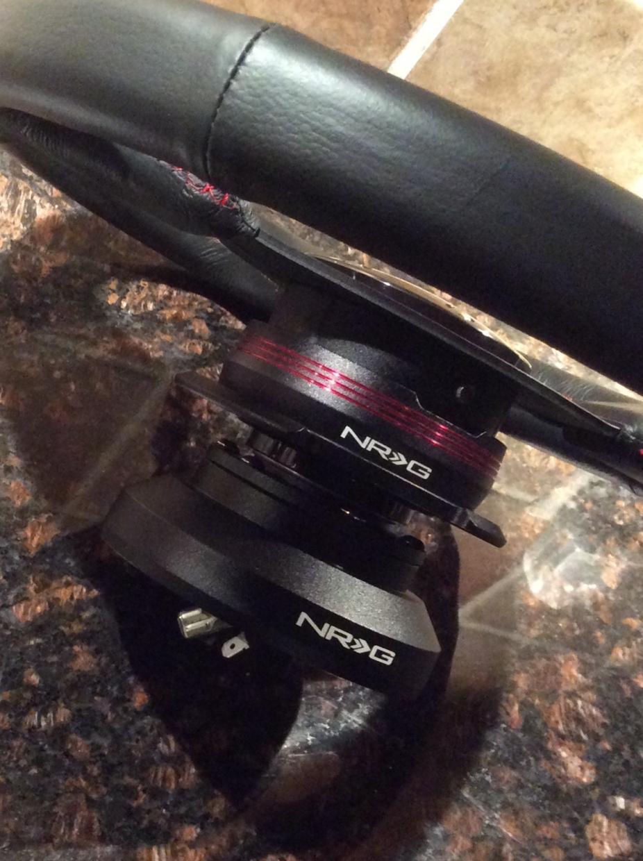

So I have all the pieces in hand.. This is a quick assembly and it will be taken to the shop for final installation and assembly.
They seem like very solid well built pieces.. The prices were pretty amazing for what I got and the overall quality feel and appearance...

I apologize, I'm on my iPad and can only upload one image at a time..

Last one...

I have the NRG quick release and wheel for my civic.
I found NRG to be very fair price for what you get, its not the very best.... but it gets the job done.
The only complaint that I had, was the wheel. Where the center ring is, the 6 bolts kept come loose. Had to tighten them once a week.

That's no good! Might be a good place to use the heavy loc-tite,
the bad: would probably never come loose again,
the good: would probably never come loose again.

Thanks for the info. I'll certainly be using something to prevent that, and still check them on a regular basis... Having a wheel come off at 200+ mph is bad form...

Yeah when the loctite either pulls the threads out or just refuses to let go it makes it tough to get things accomplished... I'll be trading off the specific hardware they sent for a better grade of bolts/screws...
