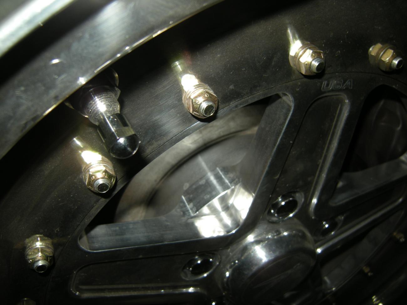

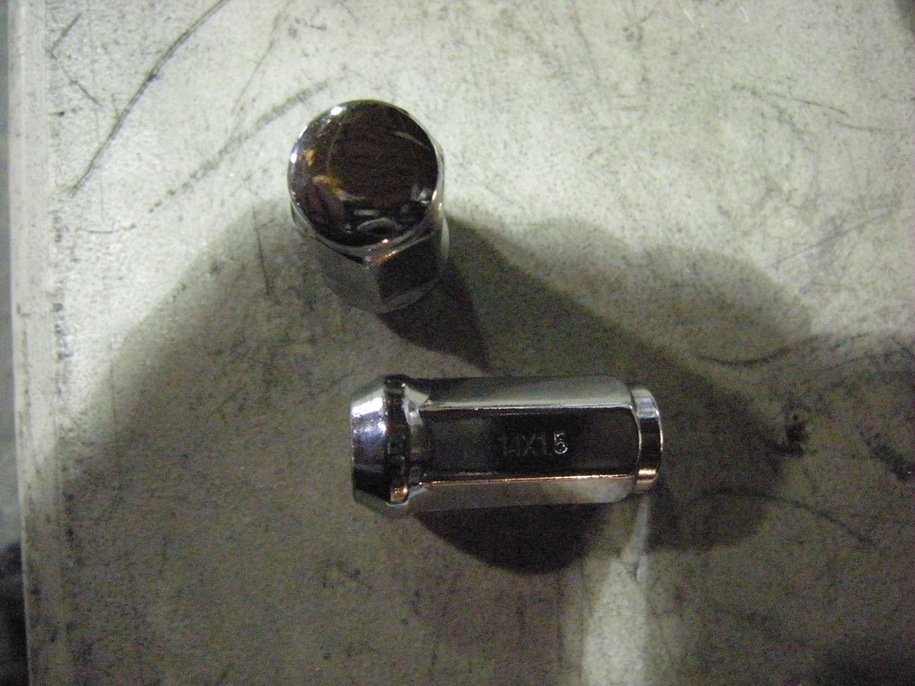

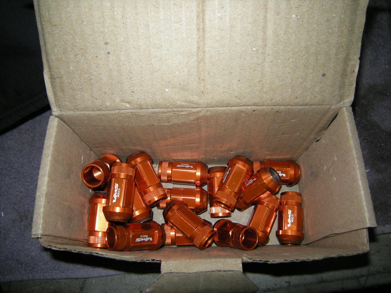

Decided not to run the aluminum lug nuts due to lack of thread engagement. The Bogarts are so thick that I could only get 3/8" thread engagement. That's not enough for an aluminum lug nut.

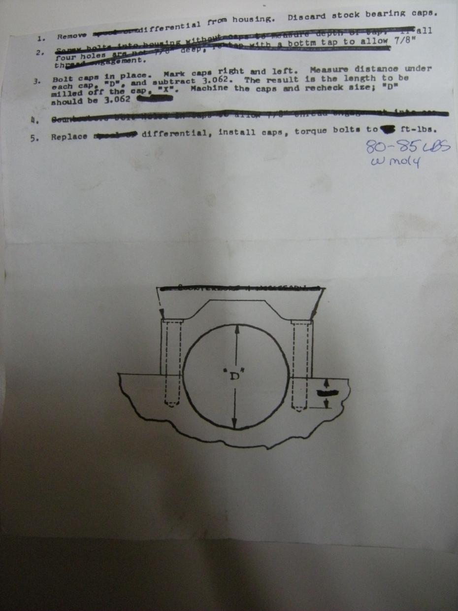

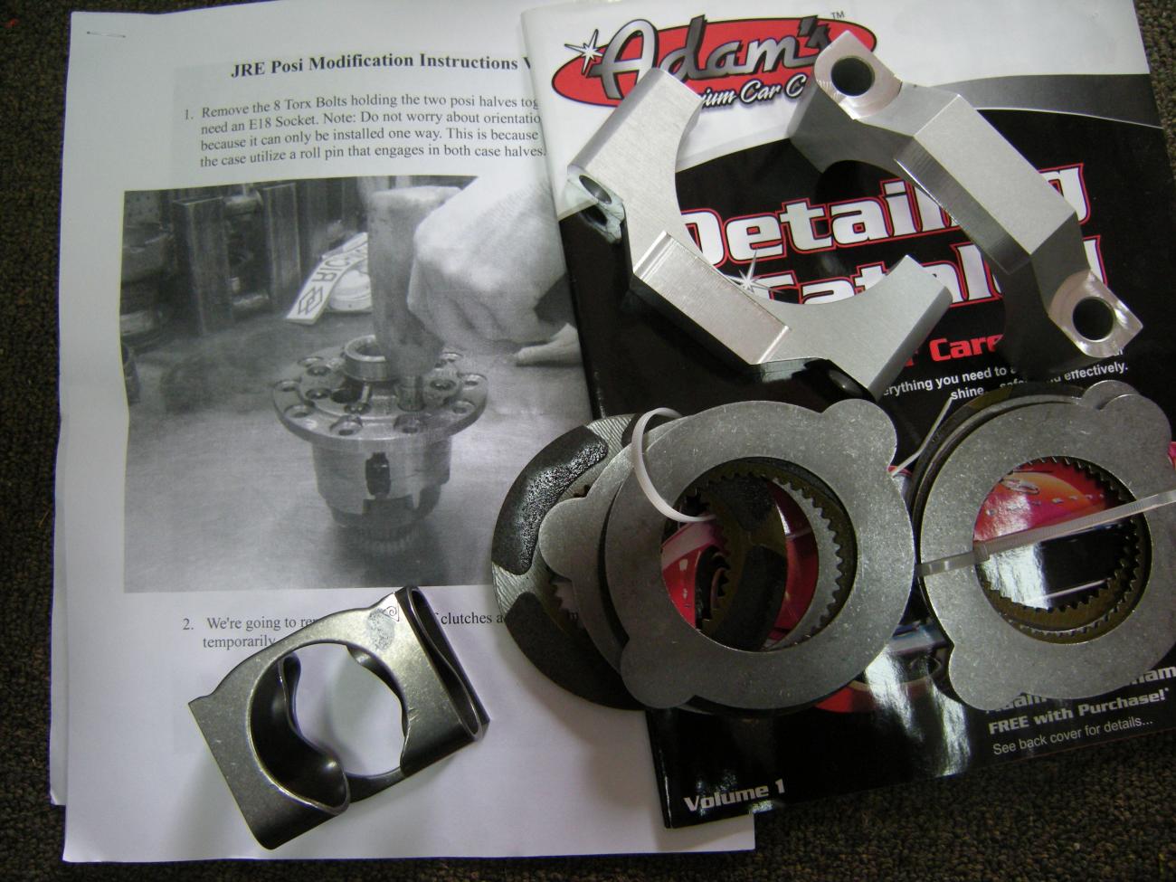

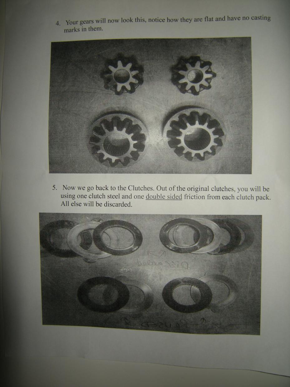

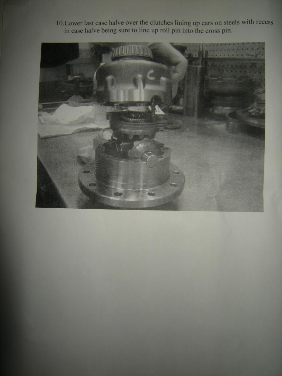

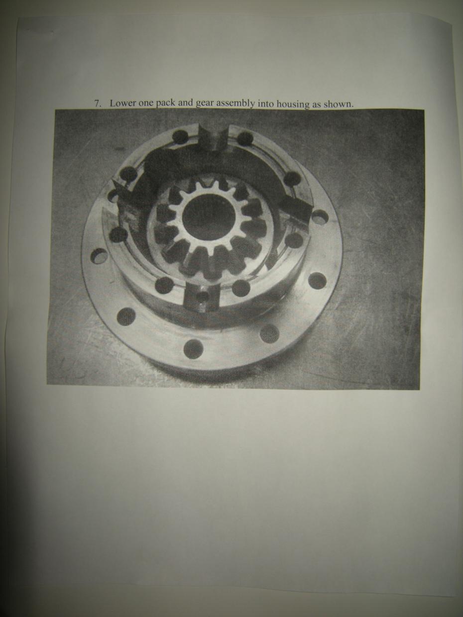

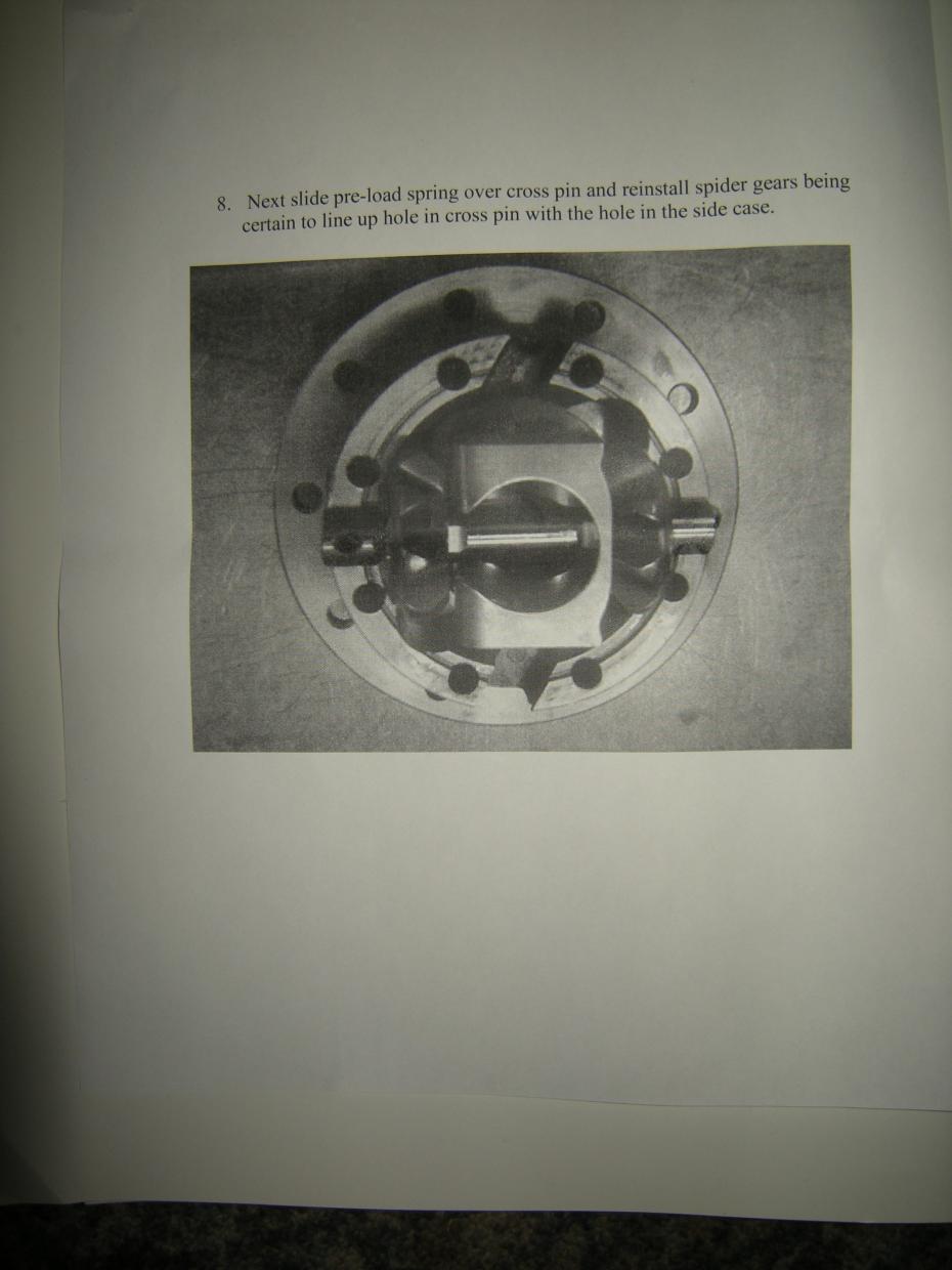

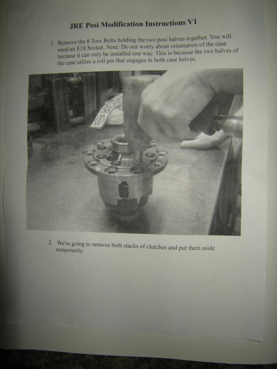

Since I will not be doing the JRE posi mod and billet cap installation, it will be left to the experts at Bob's Driveline Service. I have posted the instructions for the guy's who might want to try it on there own.

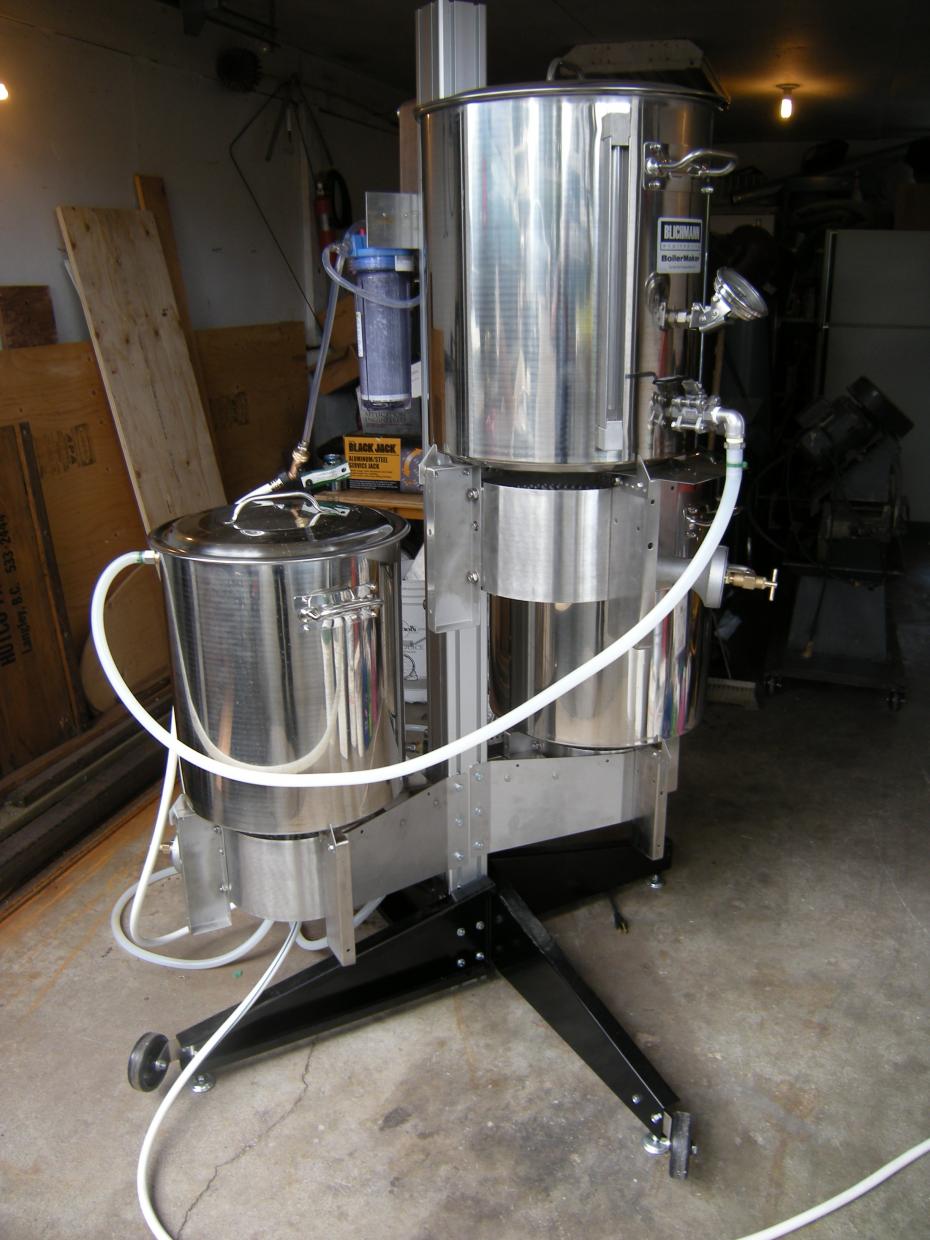

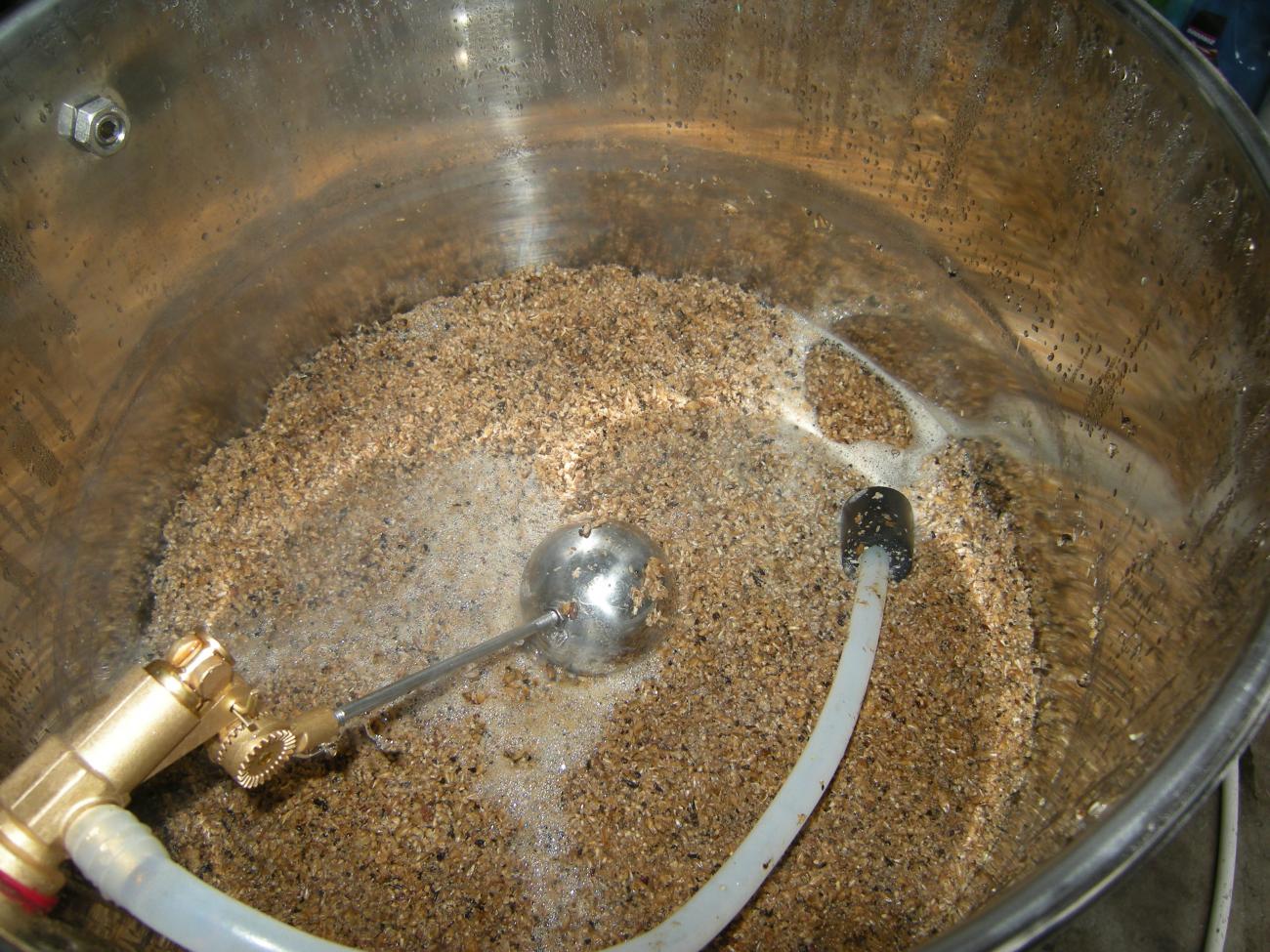

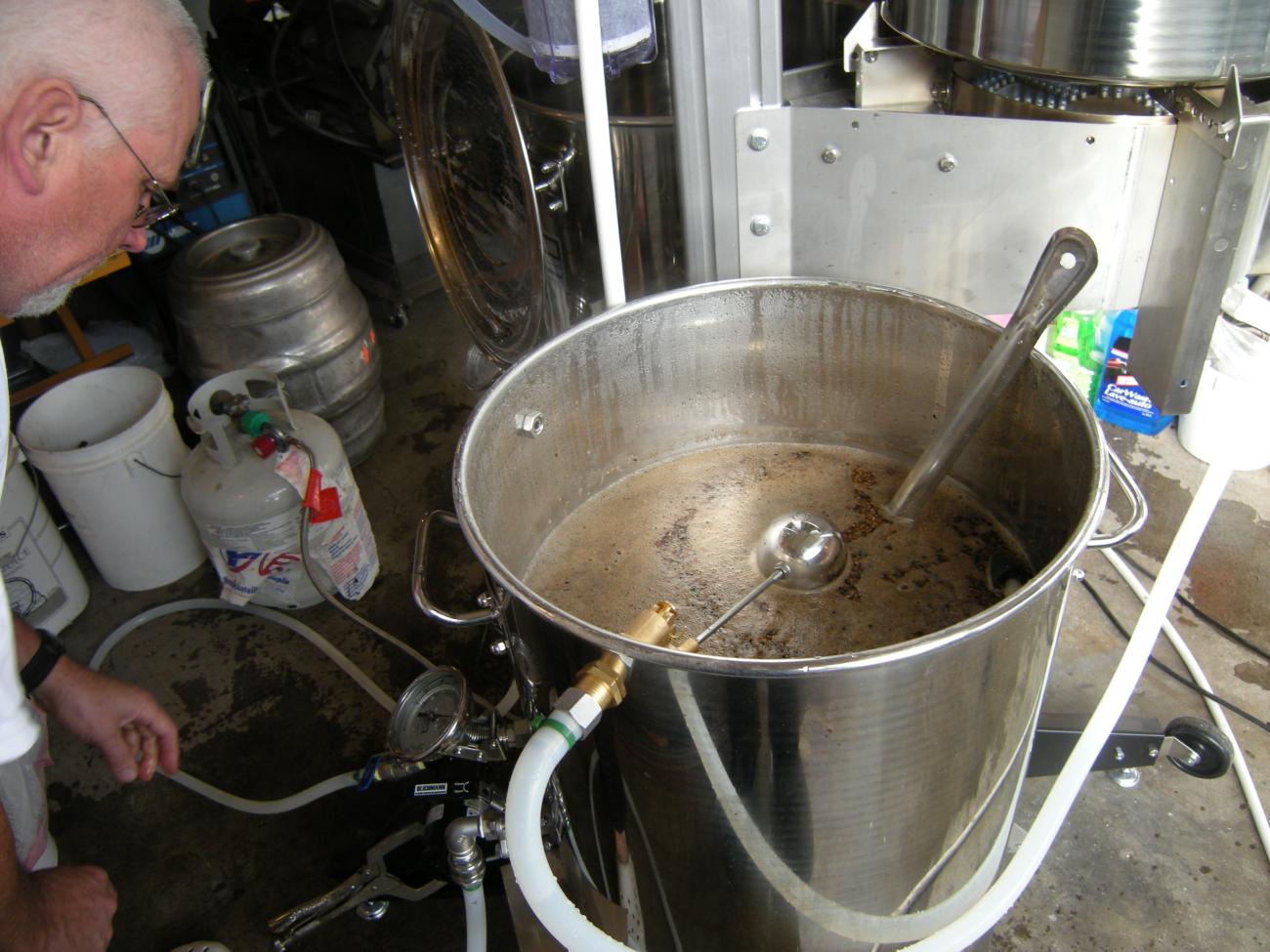

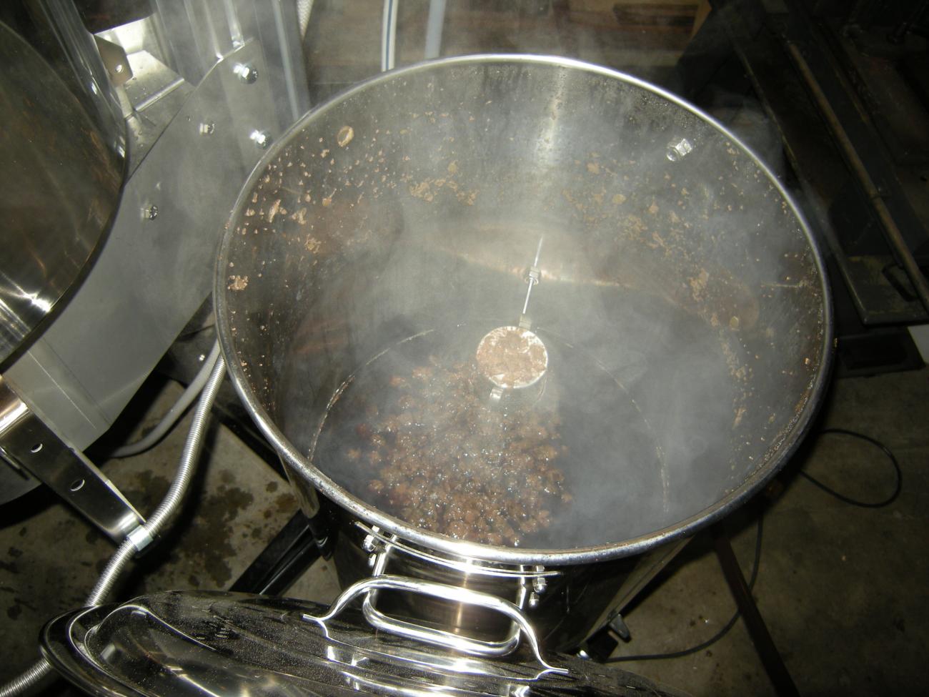

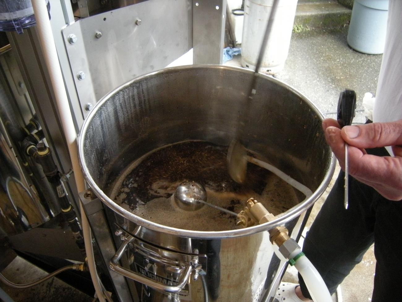

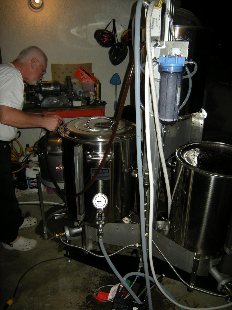

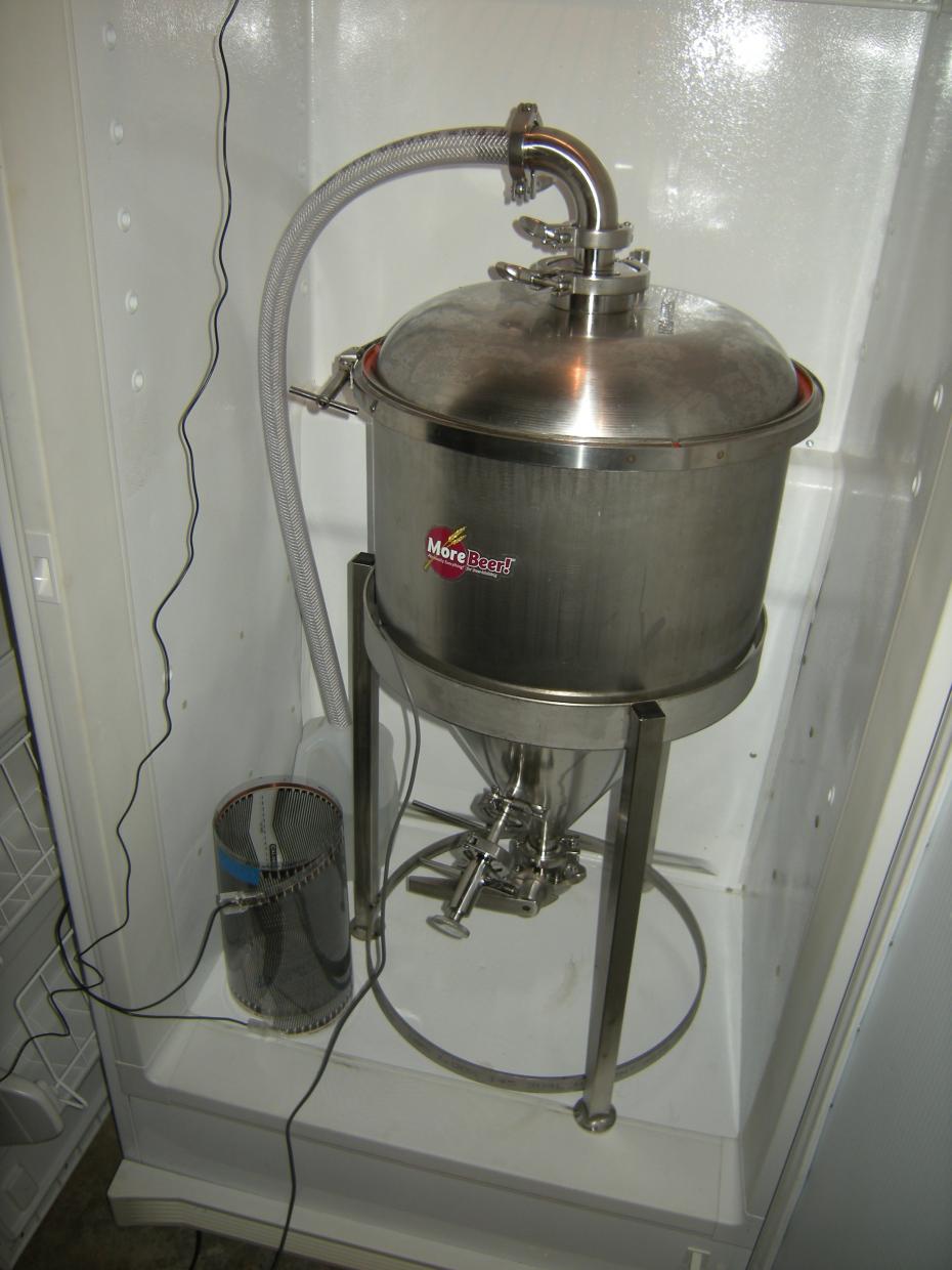

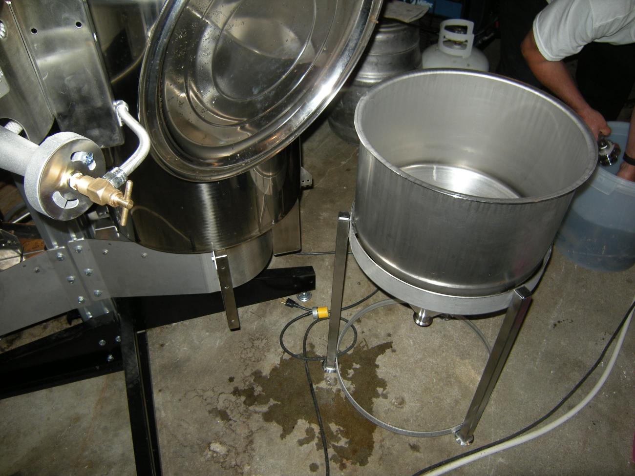

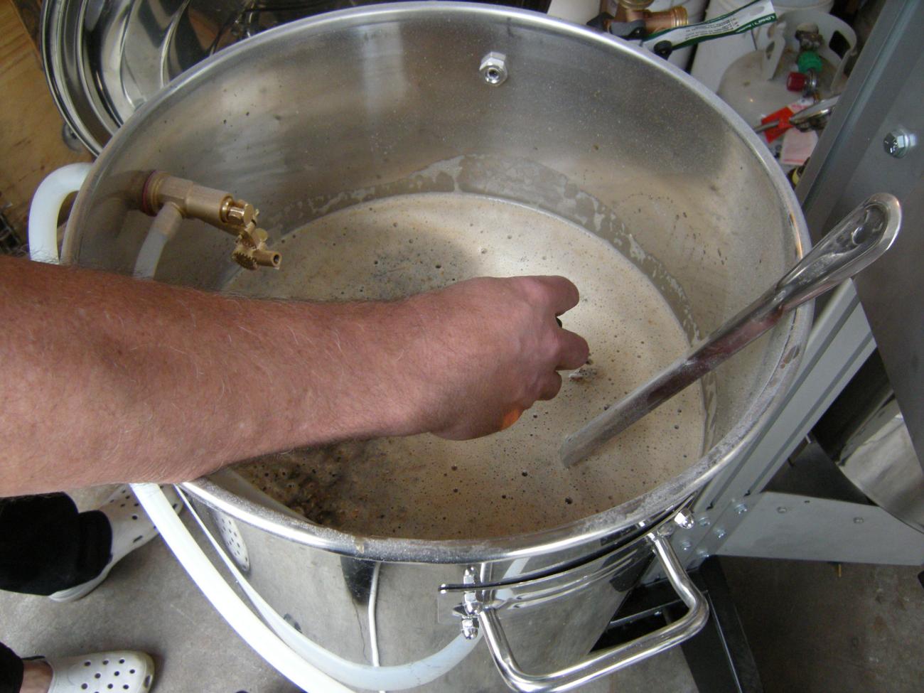

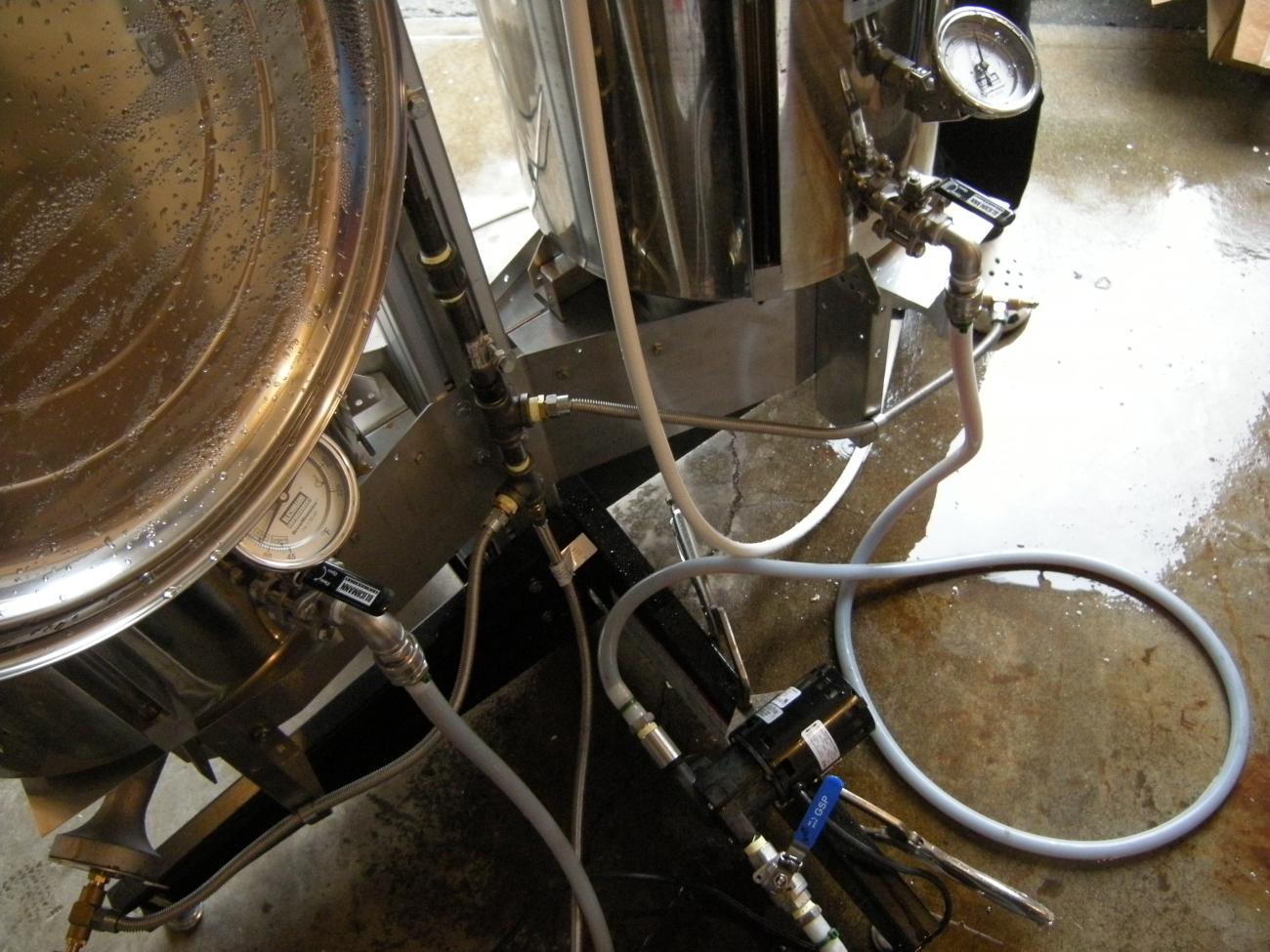

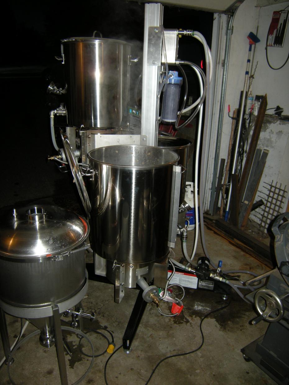

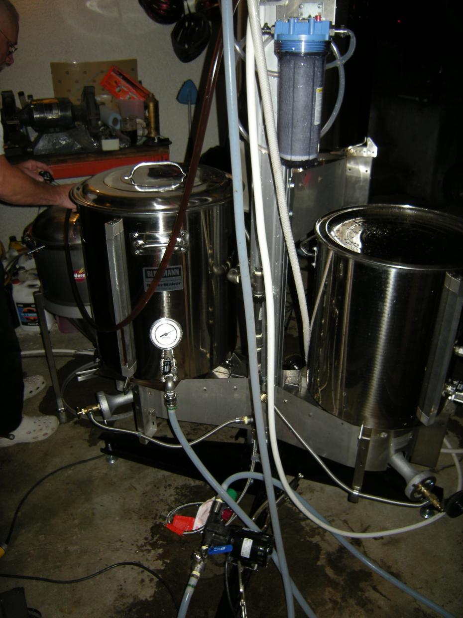

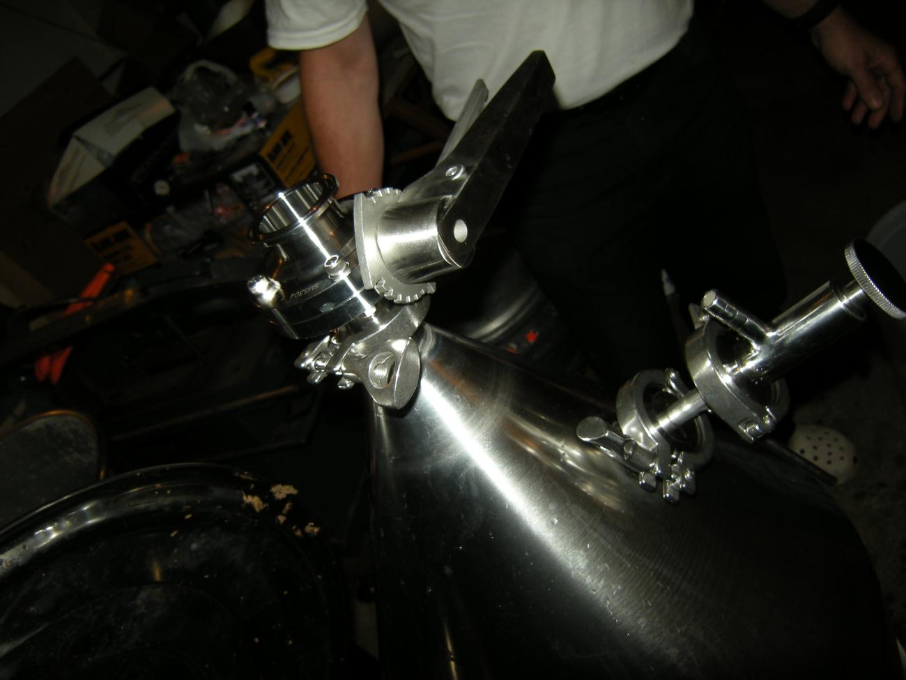

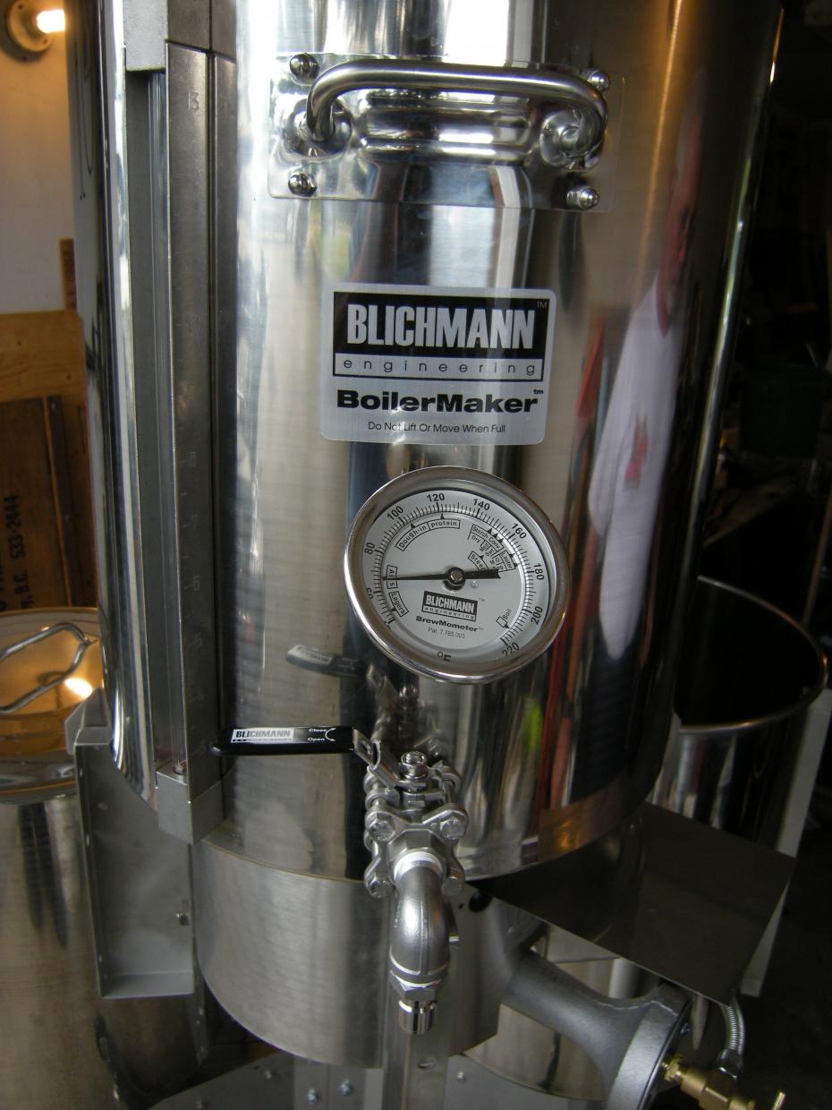

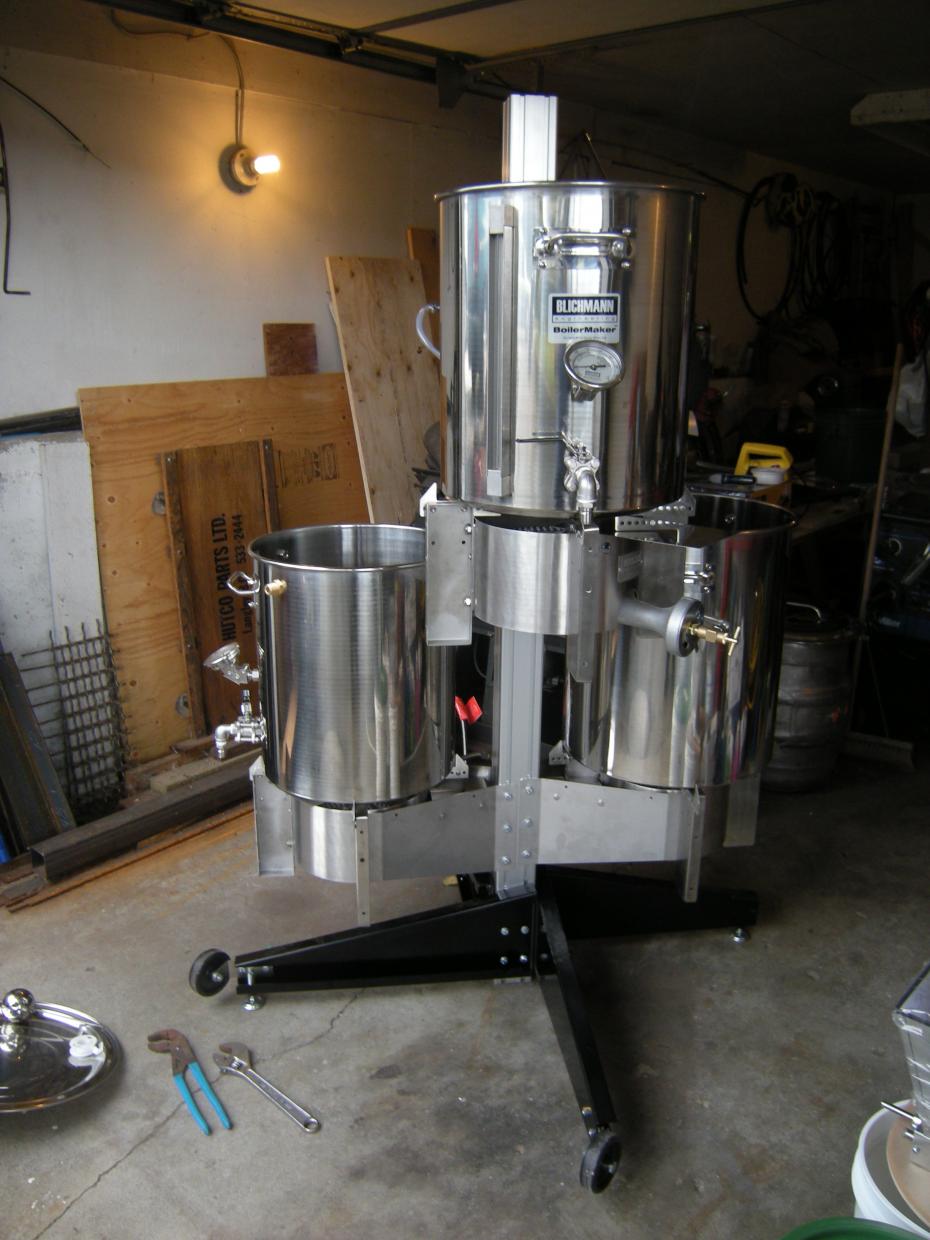

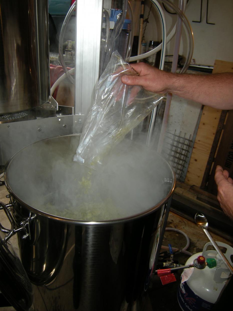

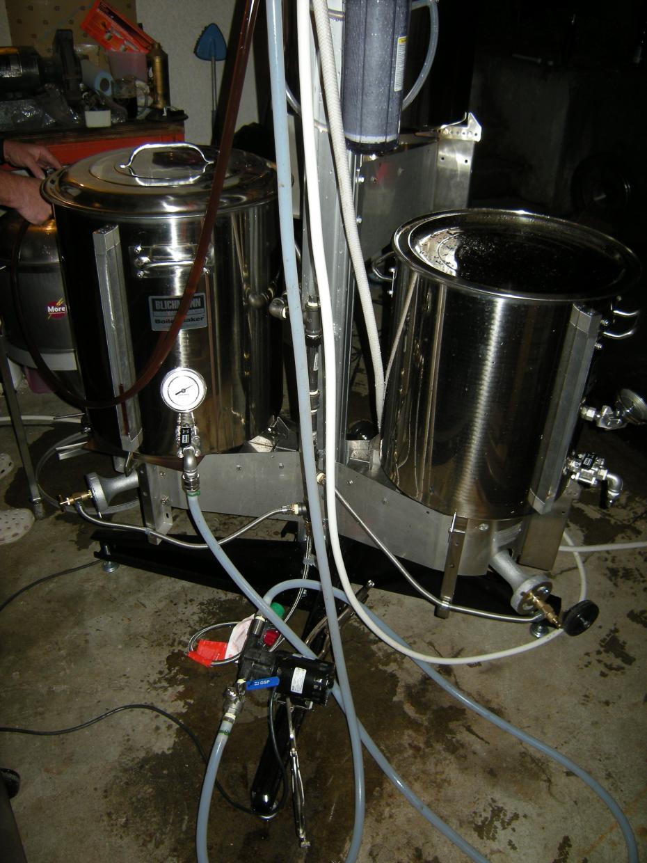

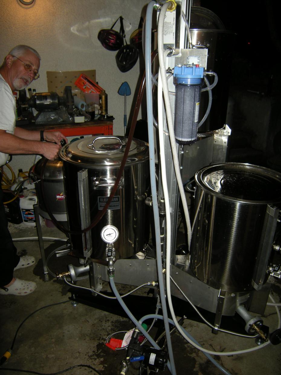

Busy Beavers
Yesterday was the big day, Raymond and I finally got around to brewing our first batch of Nut Brown Ale. Took us a while being that it was our first time around. Everthing seemed to go well. Couple of weeks till tasts testing.

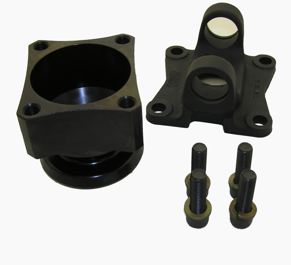

DSS Comes Through Again
Sending off one of the stock yokes back to DSS for a sample to make a billet yoke. Pumpkin should be one of the first on the block to have one. Sure it will go good with this winters diff build. Pictured is the billet yoke from DSS for the GTO. A big Thanks to DSS.

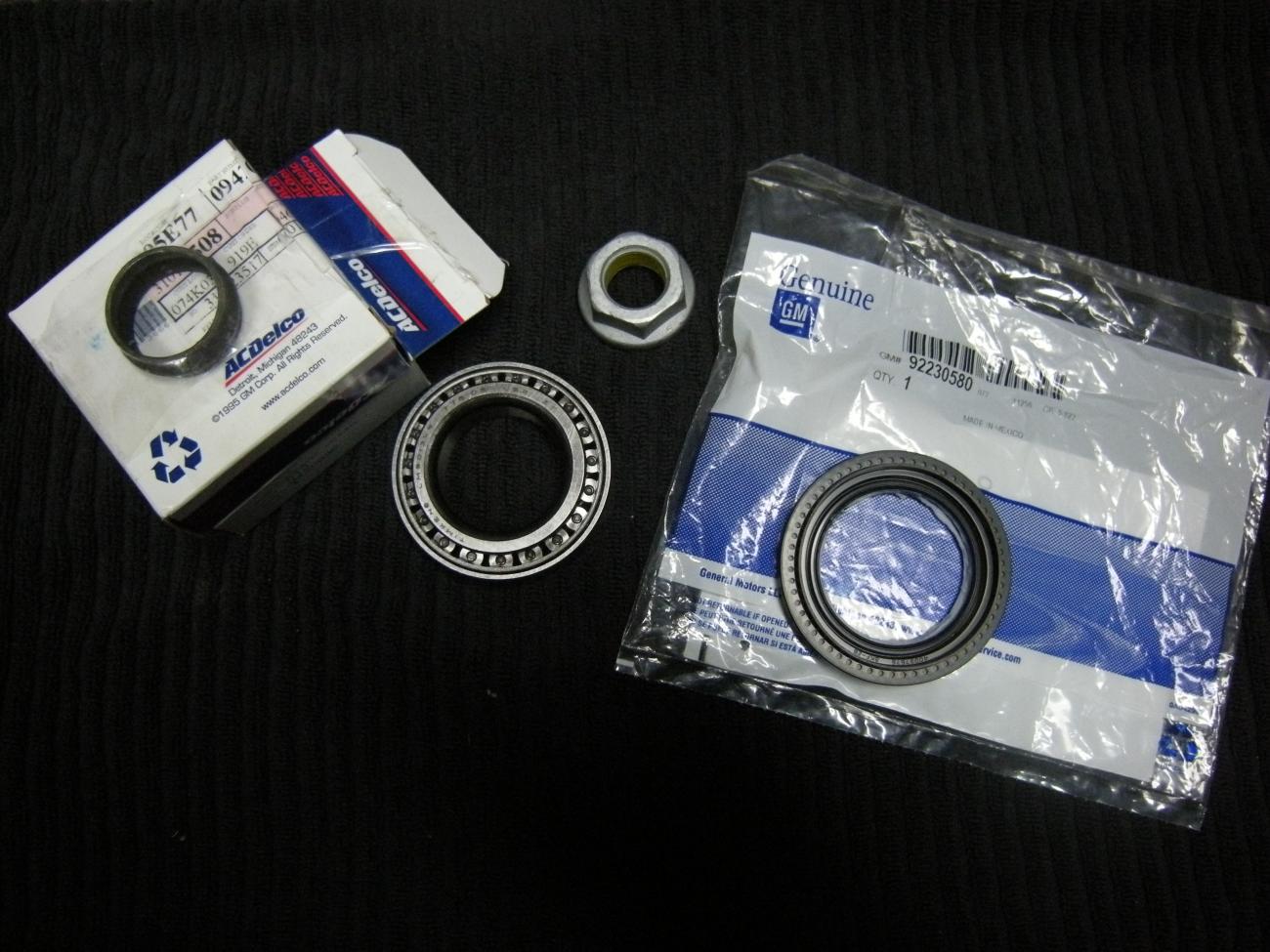

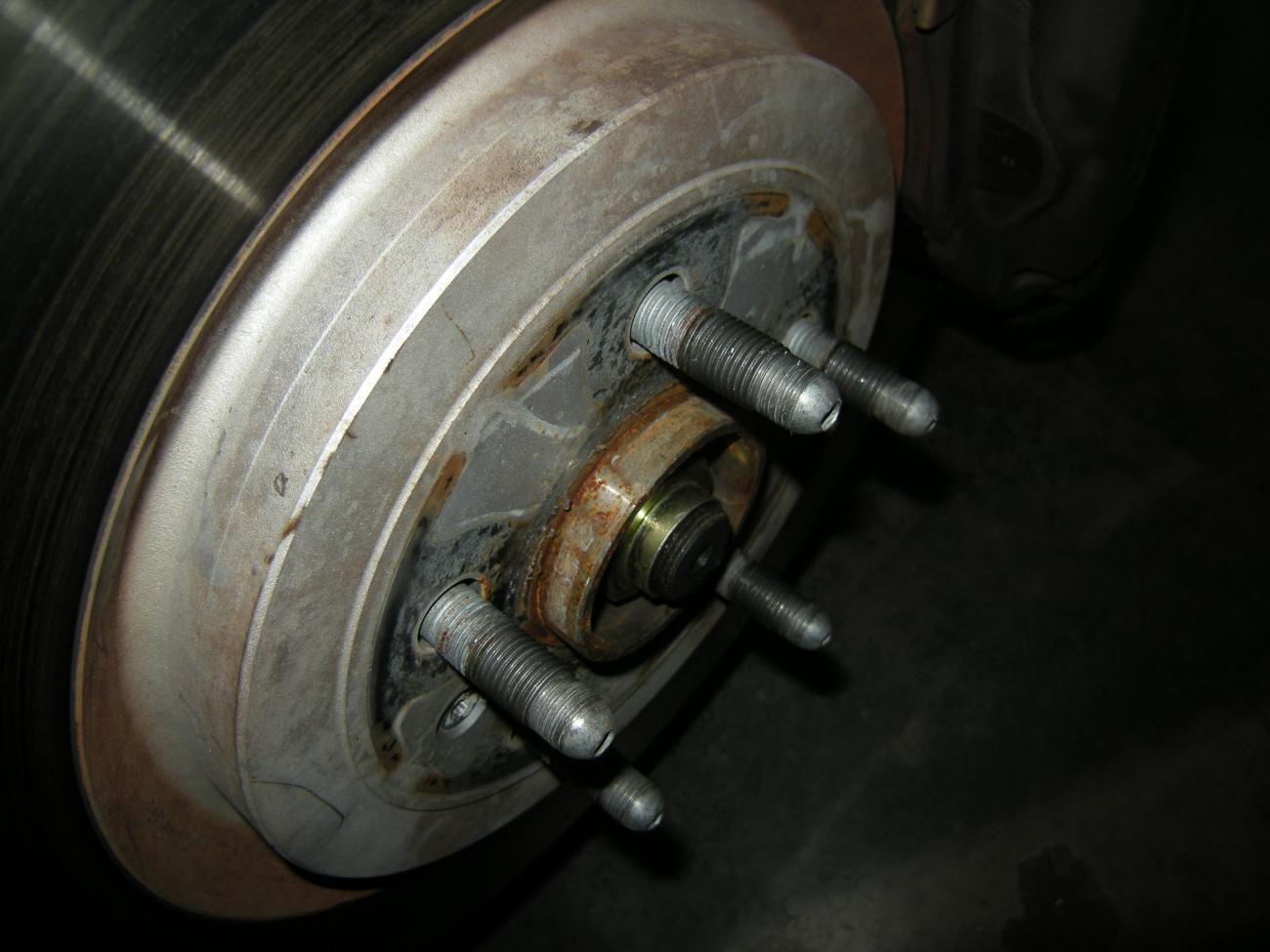

More parts trickled in today for the diff build. Carrier bearings, axel seals, crush slieve and pinion nut.

B -
The parts are cool, but heck man, you are taking home brew to a whole other level. That is some serious beer making equipment.
Go Nut Brown Ale !!!

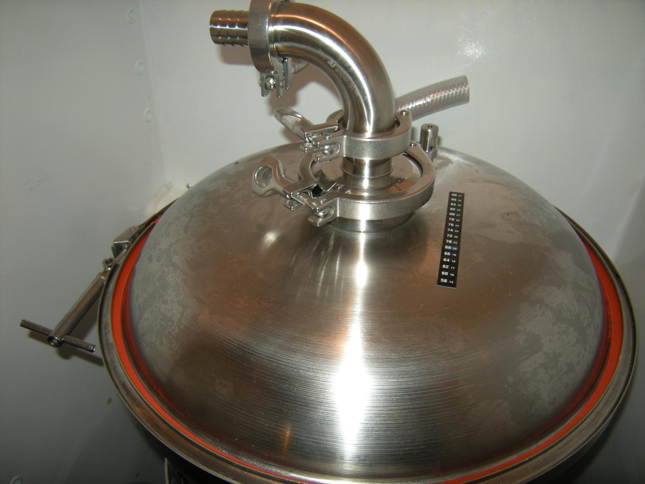

Yeah Bud it's real high end brewing equipment for sure. Were both counting the days to our first test drive, last nights fermentation check was EH OK. Twelve day's and counting now.
