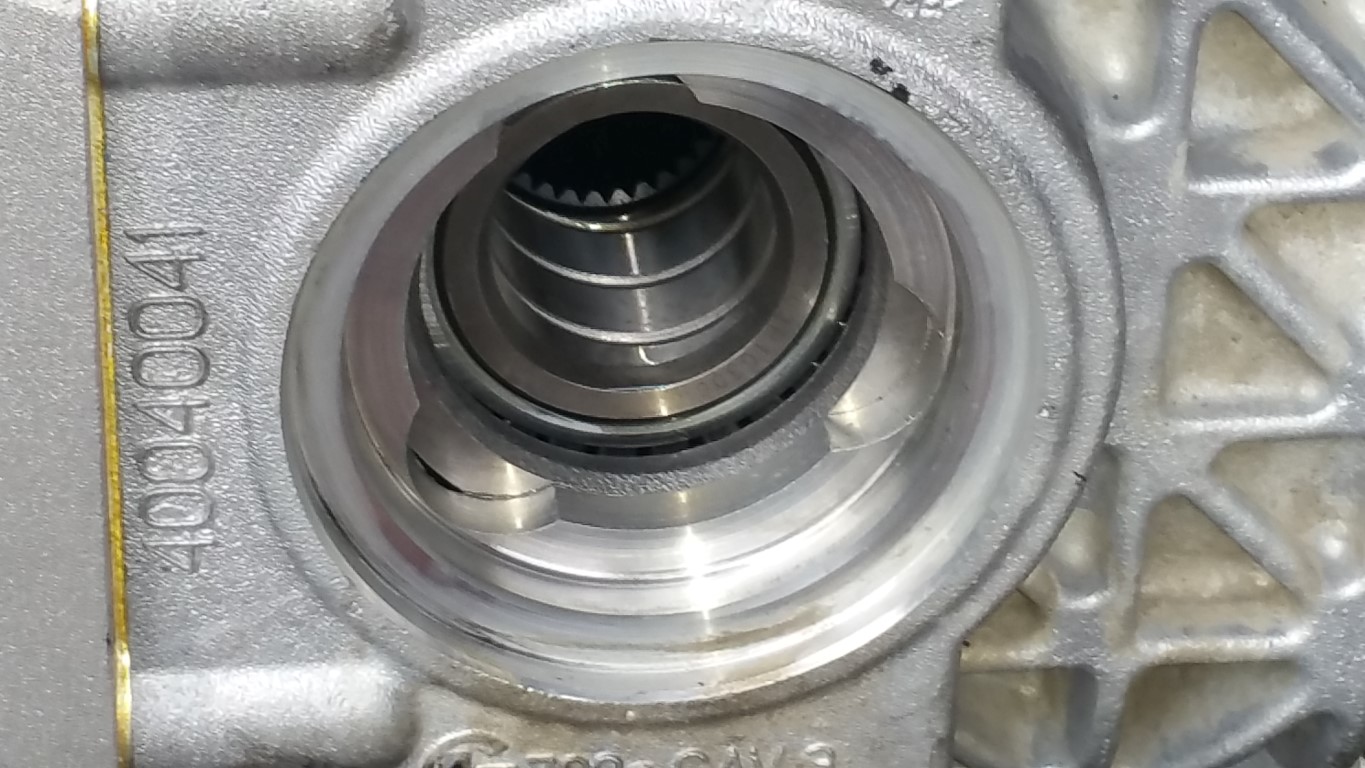

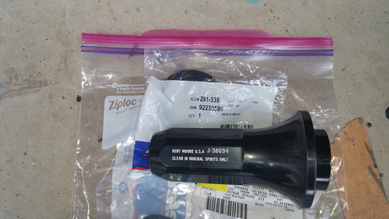

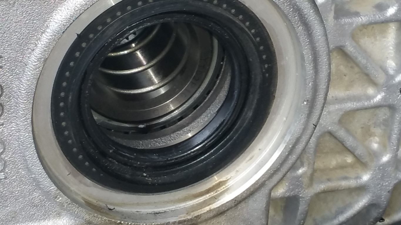

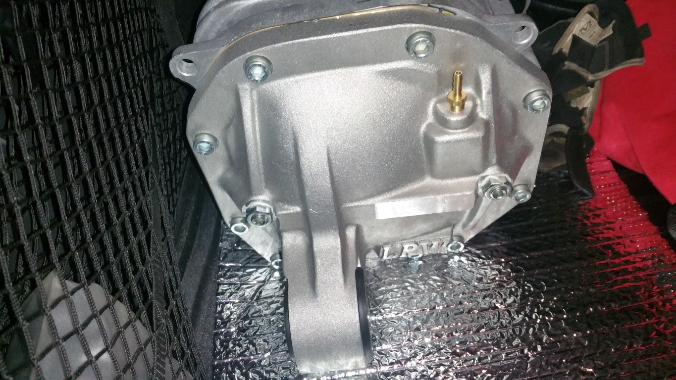

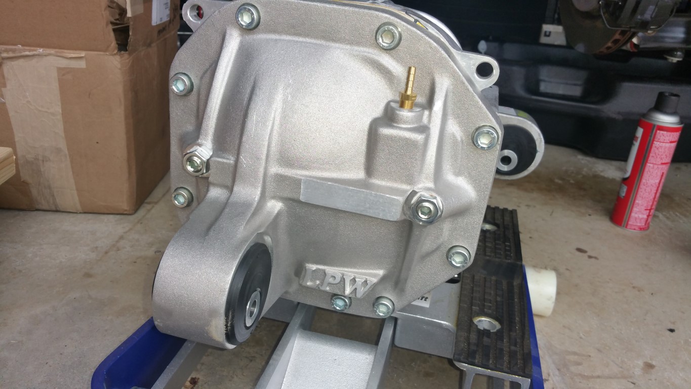

Hendrix Offset Diff Bushing Install
Diff install day! Get everything ready, bolts cleaned for the axles, axle hubs cleaned, threads chased, new axles seals, hubs popped in place nicely, ready for install!:

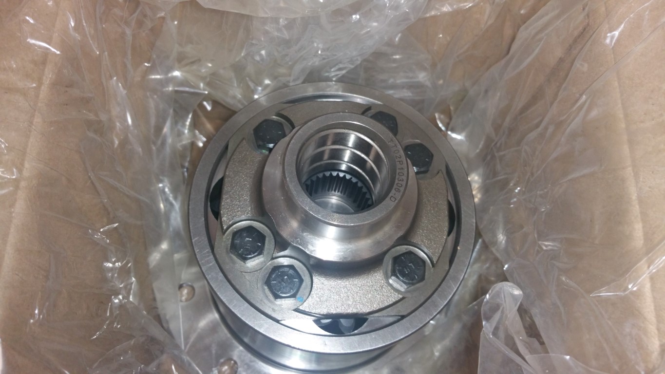

Unboxing Eaton:
After GPI did their magic:
Hendrix:
LPW:

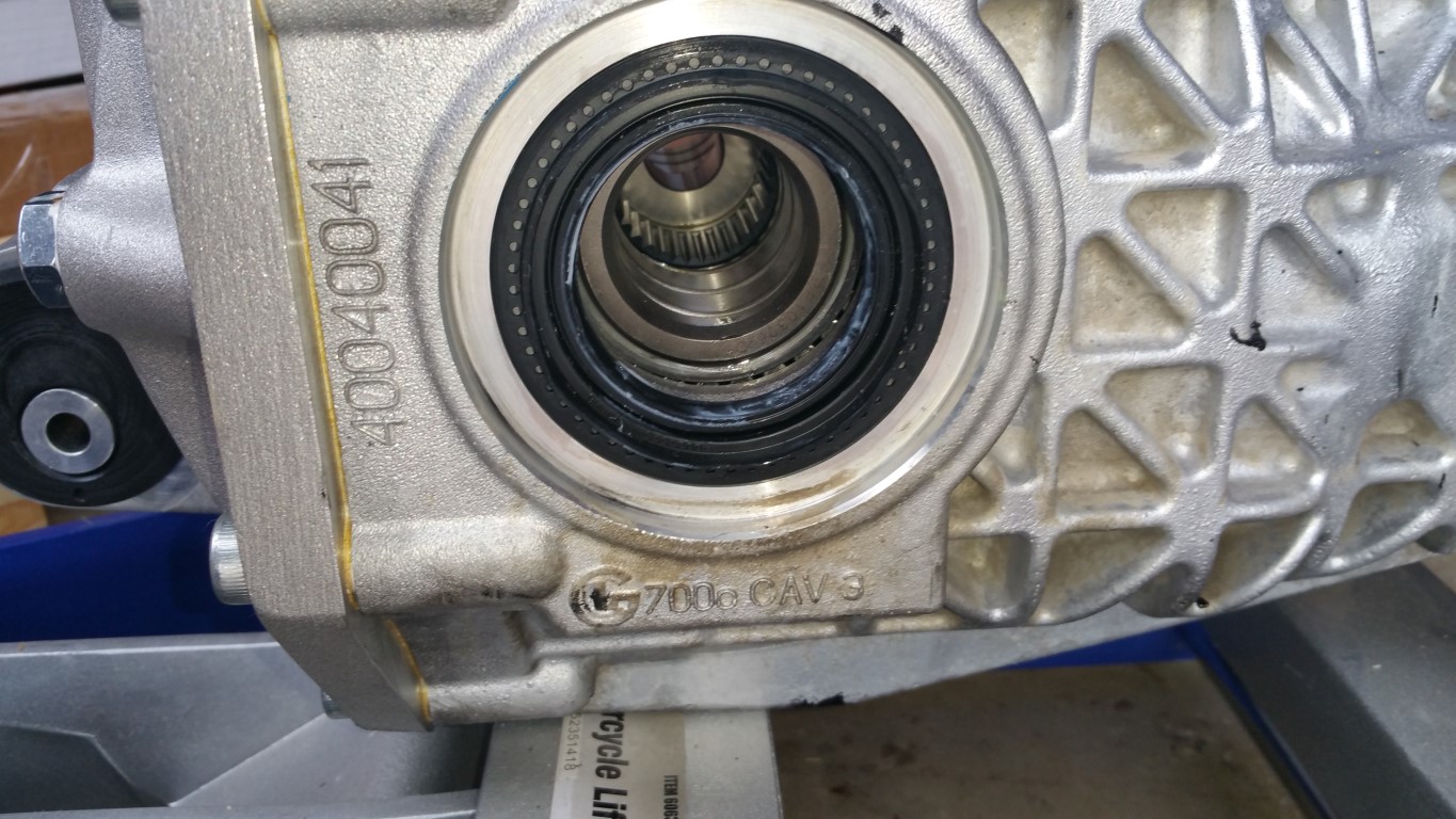

New Axle Seals and seal tool:
Old seal and its removal:
Installed:

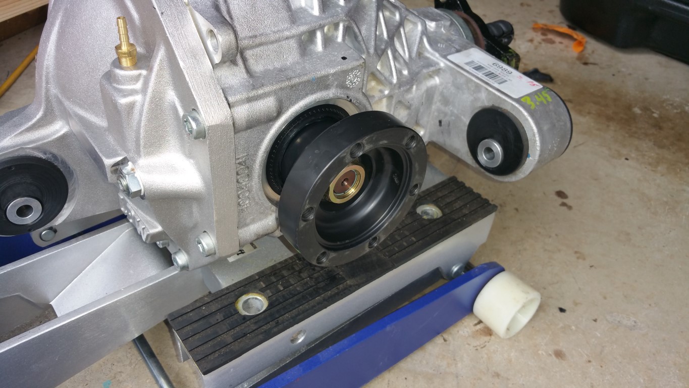

Axle Hubs installed popped them in, could not pull them out:

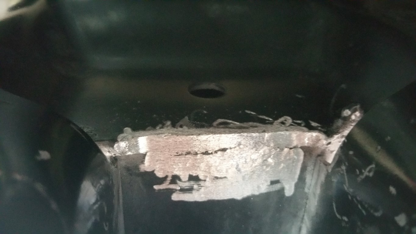

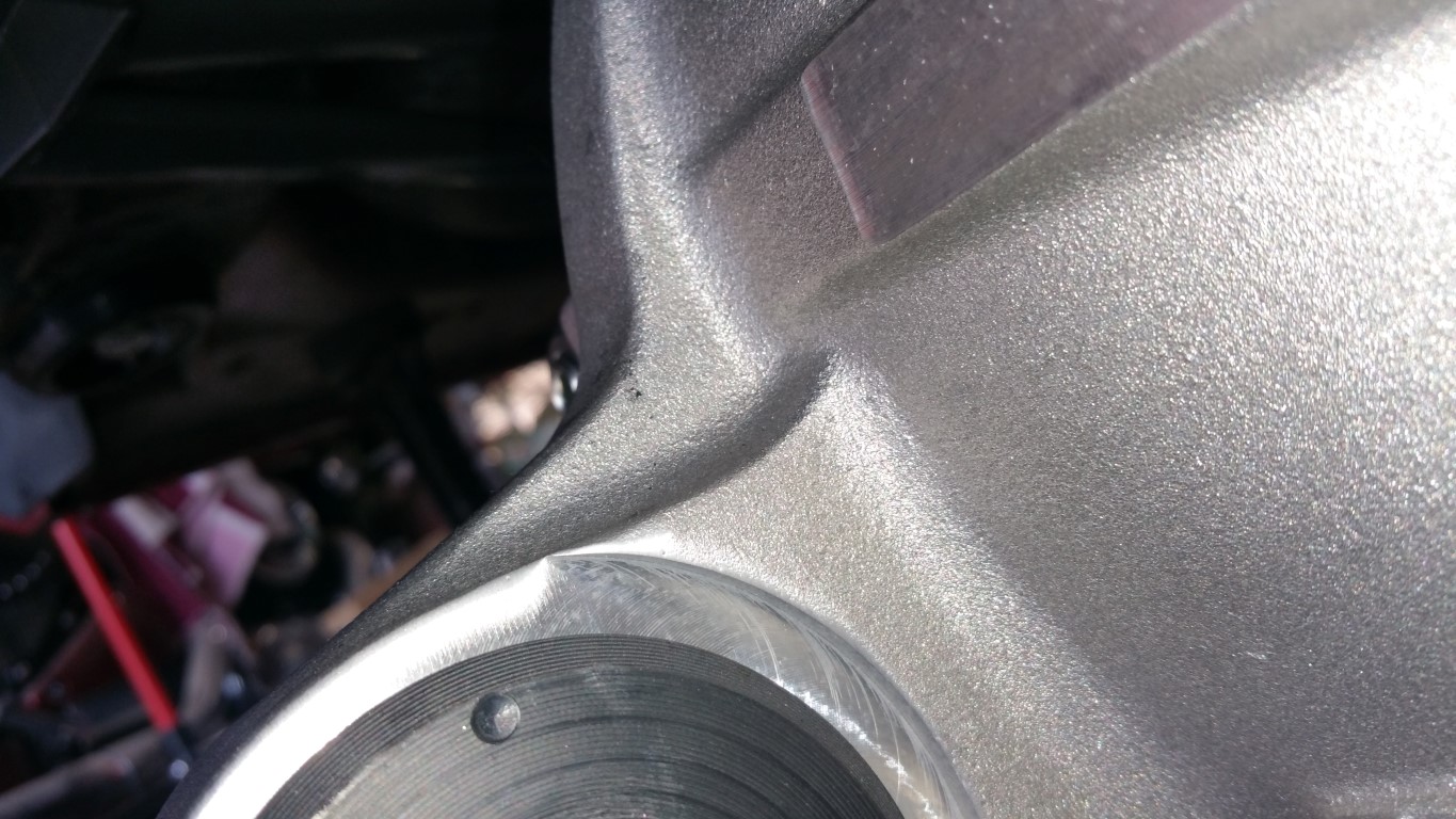

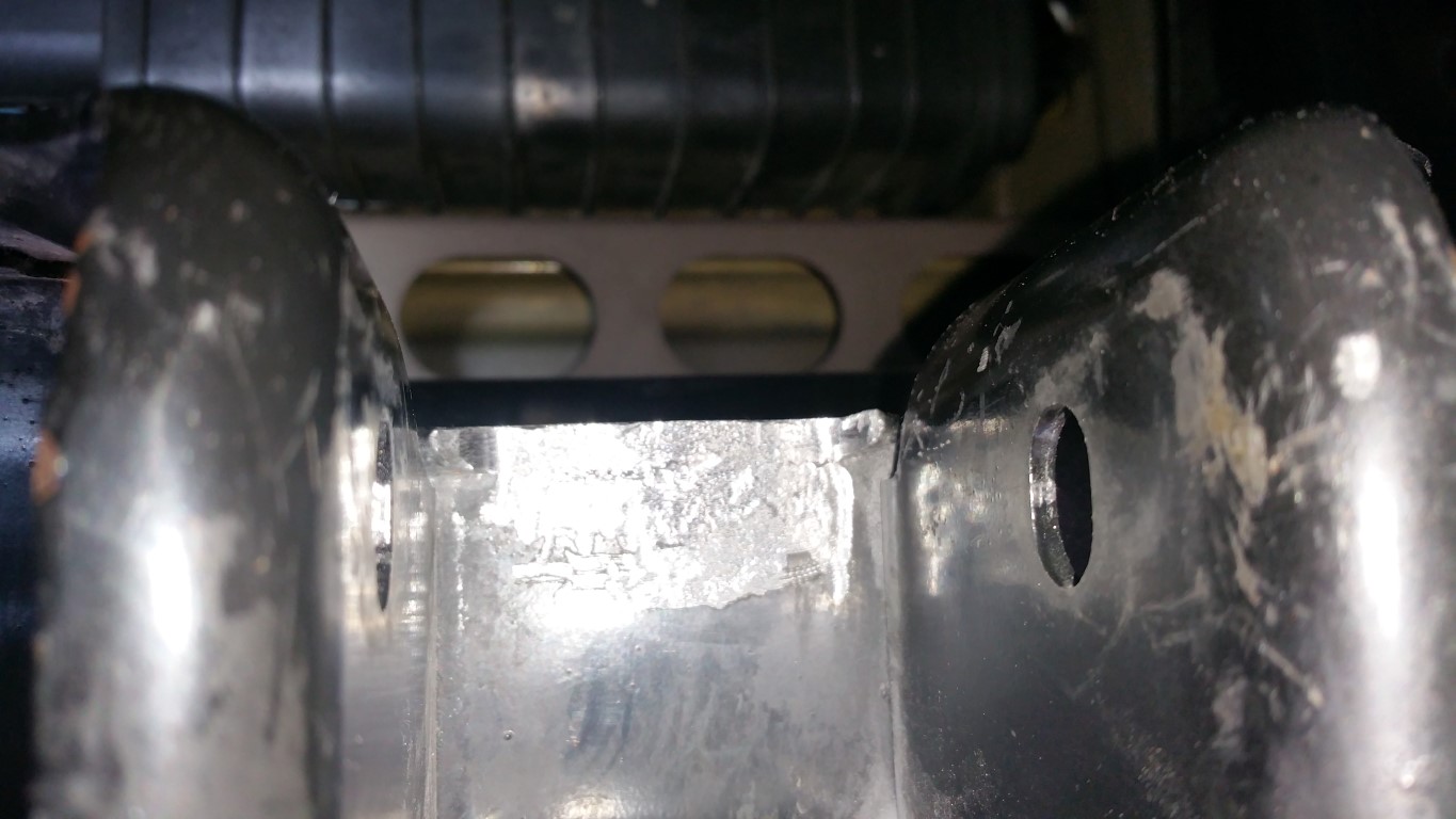

Ready to install. Everything was going smoothly, axles aligned, diff was going up straight, ready to line up the holes -- light bang -- what the heck?
Tried to line up the rear diff bushing, bang. Got the light took a look -- what do I see?
SLAG from poor welds! -- A LOT OF IT:
Its hitting here:
Right @ the curve. UGH, it figures ;o)
I'll need to get the little grinder/dremel and grind those off, clean them, PAINT them and, retest the fit. I'm going to grind a little on the curved area just to make sure.

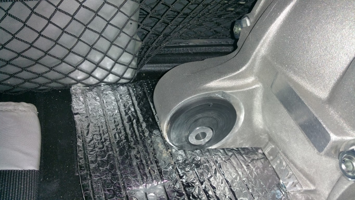

Humm... I may be doing something no one else has...
Hendrix offset bushings and LPW cover.. Seeing some clearance issues. I'll need to contact Hendrix about that and LPW about grinding for clearance...
Fun!
-Don
747 RWHP 794 RWTQ

How about this: Called LPW to leave a message, and someone actually answered - on a Saturday @ 4 EST! Amazing.
I did find out they recently changed the 'arc' on the rear cover. Now sports a 1/4 moon curve vs 45° for the G8 installs of our diffs. I don't think it's an issue UNLESS you are using the Hendrix bushings;o)
They asked me to mark and measure how much I have to remove, so I'm going for flat and 45°. Glad this is NOT the pained version.
Before I do that, gonna remove the SLAG from the cradle...
-Don

Hendrix Offset Diff Bushing Install Continued

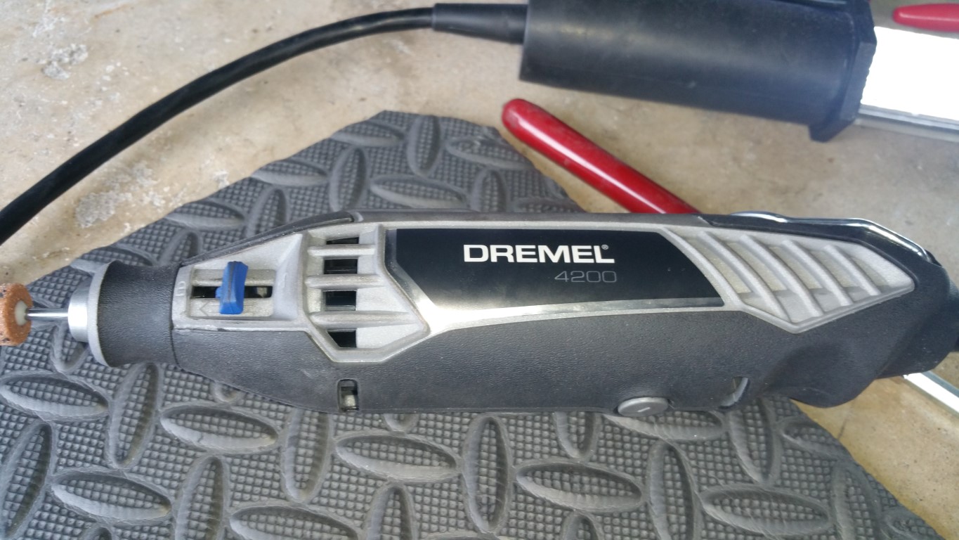

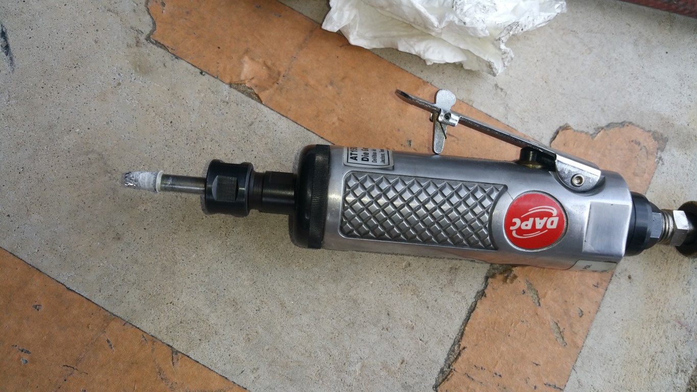

OK, using my air grinder and the Dremel, I was able to clean this up:
Tools:

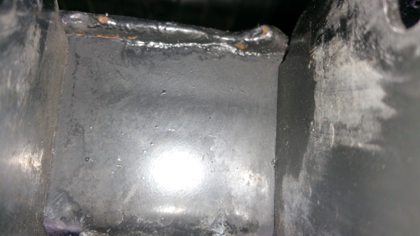

Yep, it ground it to nothing -- took off 3/8" of SLAG:
Area cleaned up...

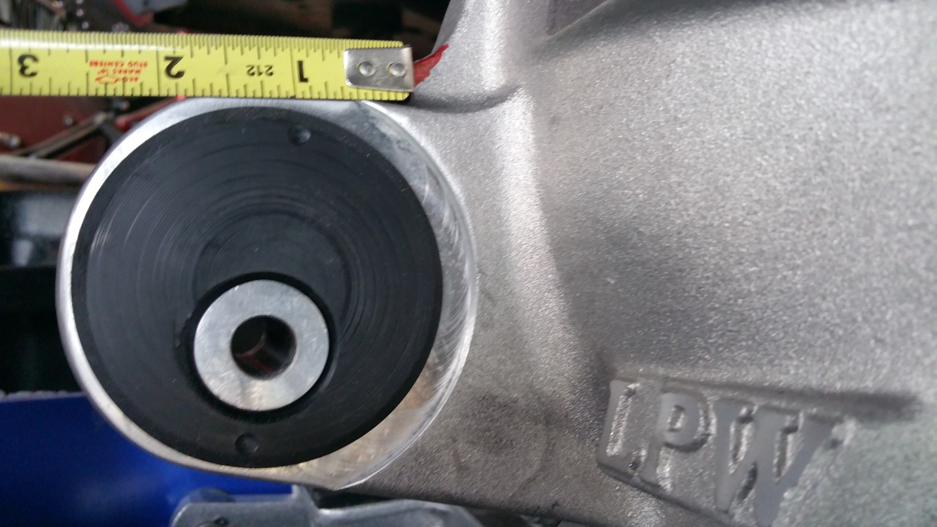

I measured from the center bolt hole on the cradle to where the 'edge' interference was -- its 3/4", so, I'll grind about 1" length on the cover to allow clearance.
Now, the rear bushing area on the original is 3 1/8" tall and its flat. The LPW is 3 1/14" tall before the taper and then rises to 4" (remember it '1/4' moons it ;o)
So, I'll grind it 45° so it tapers around an 1" out. Here, in red, is what I need to grind off to make sure I have clearance:
Here is the first Gen cover -- notice it is angled and not 'rounded'? That I believe is the issue...
Now the current version:
Now, need to get some primer and black paint for the cradle!
