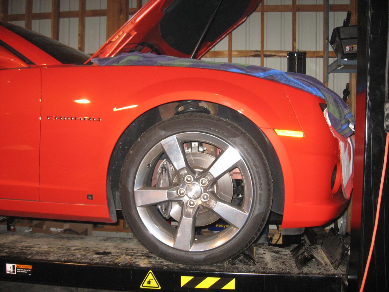

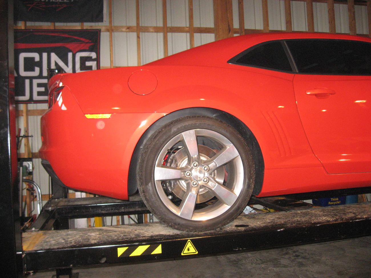

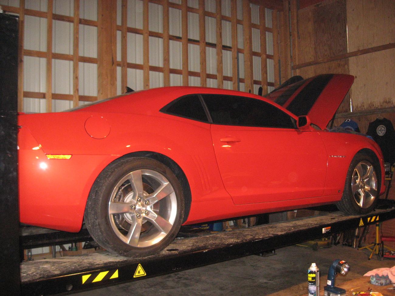

Day #3 button up and get Pumpkin off the hoist. The front end next.

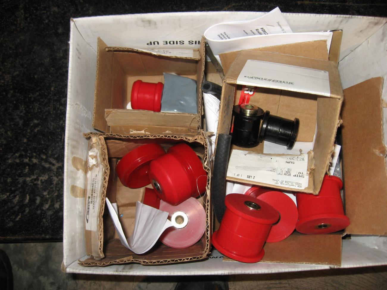

Posts: 11,310
The box of BMR stuff left is getting smaller. Must were winning.

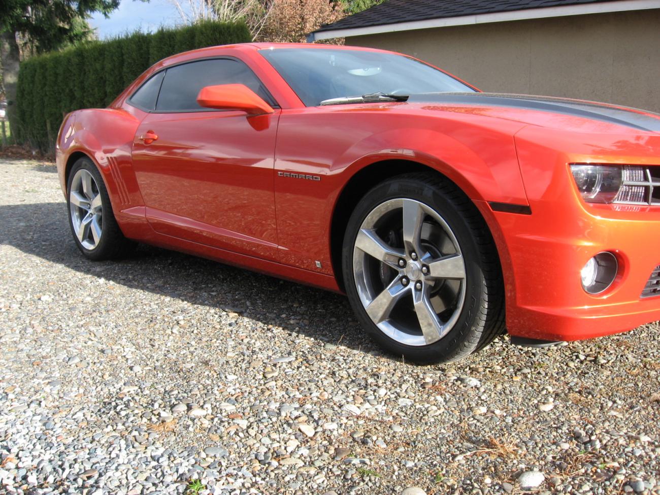

LOOK Speedster no snow.
Ha, that's funny. It was cold enough here the last few nights (29 and 30 degrees - WAY below normal) that we could almost of had snow. But we did get frost.
Anyway, Pumpkin is looking low and mean. Nice job on the bushings and suspension. By the looks of it you definitely won and BMR is now going for a ride Canadian Style !!!

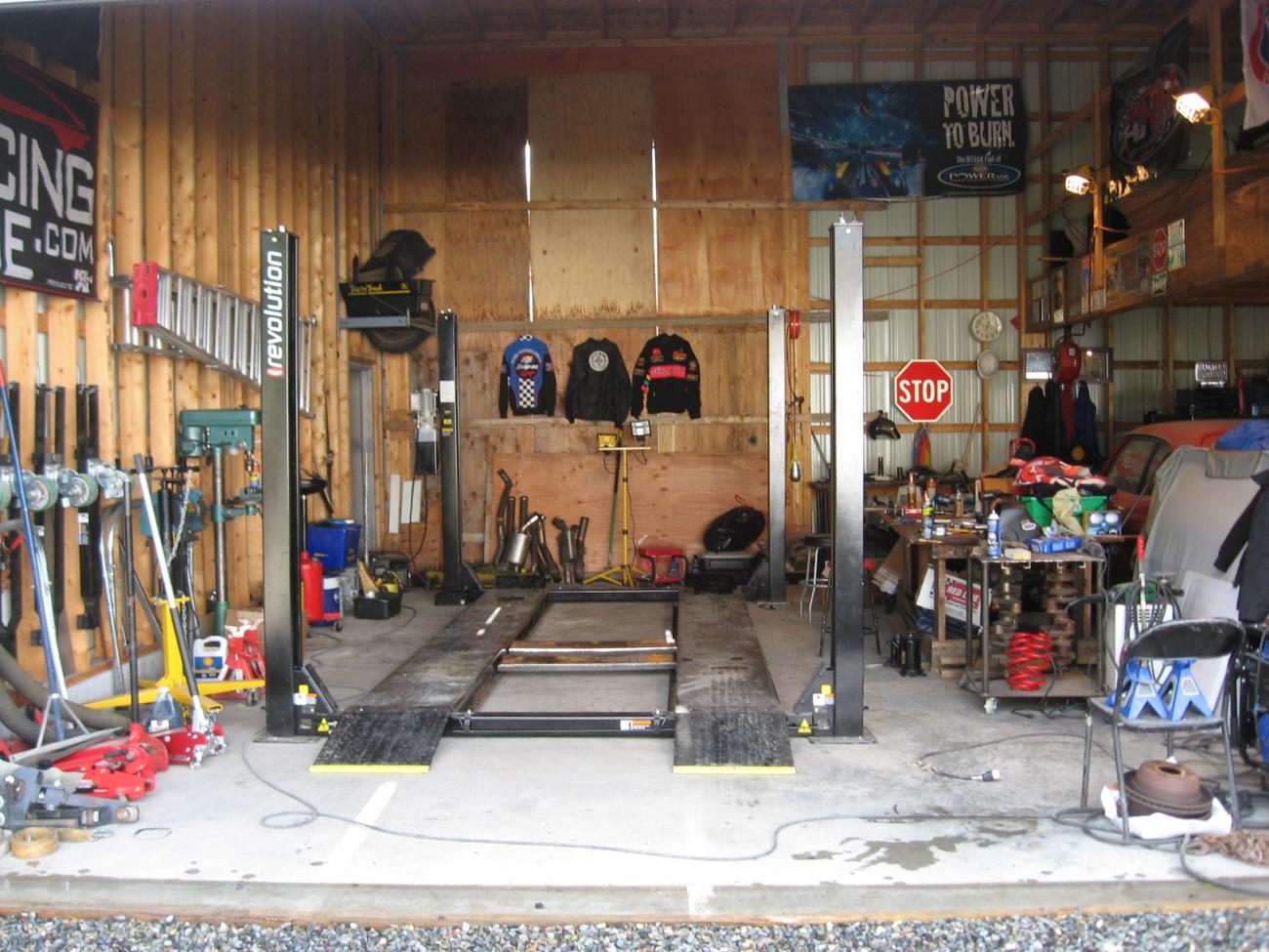

THX Bud! Still got a ways to go, but were getting there. Have to look in to the two post, four post issue. Apparently difficult to change front sway bar on a four post. Might have to do all but sway bar and move to a two post for sway bar.

It set the rear wheels up in the fenders alittle should be good when the front is done and leveled.When i texted you last night i was doing the front sway bar and it is a bit more work on the four post and you have to undo the motor mounts and lift the motor a couple of inches. Can't rotate the bar enought because it jams into cooler line under the harmonic balancer.

Can't wait to get the front down an 1". Looks like we have to put Pumpkin on 4 jack stands on the 4 post to do it though.
