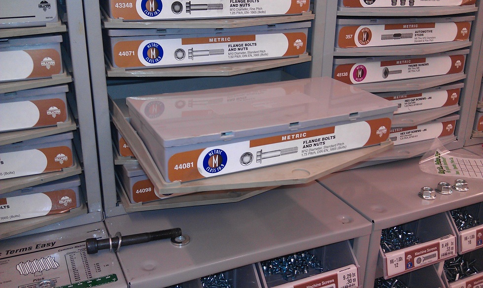

FYI info to share: 12.9 Hardness Rear Diff mounting bolts with same size neck
Originally Posted by hypurone
I recently read a thread concerning rear gear noises in which you posted that the diff mounting bolts were replaced with some ones (12.9 hardness) that were smooth bore the entire length eliminating the slop of the "necked down" OE ones.
Can you provide me with the info on where they were purchased/part numbers etc?
Would really appreciate it.
I purchased them at Ace Hardware for somewhere around $7 each I think. I don't have any part #s - but if you can't locate the bolt, I can stop by and get it off the bin. (I will try to get for everybody else's benefit and change post....) Then maybe they could be ordered on their website? They recently expanded the hardware section to about double. They may have had these already... most of expansion was polished stainless bolts, chrome and black chrome, etc. I tried to get actual Flange bolts shown in the picture of the box, but they didn't stock the length needed. Next to the box is the Allen head black 12.9 bolt with 90mm length (black 12.9 is the same type used in the high end CV shafts). They had 80mm lengths also, but would be too short for the rear bushing. Stock bolts are 85mm. Since I couldn't find a long enough flange bolts, I added a 10.9 hardeness washer on the bolt side to distribute the pressure like the flange bolt. I ended up using the OEM crimp style nuts instead of adding lock washers. The crimp style works great and can't hurt a 12.9 bolt, since they're 10.9 hardness.
Black 12.9 hardness Allen Head Bolt specs are: Metric M12 diameter, standard 1.75 pitch, 90 mm length.

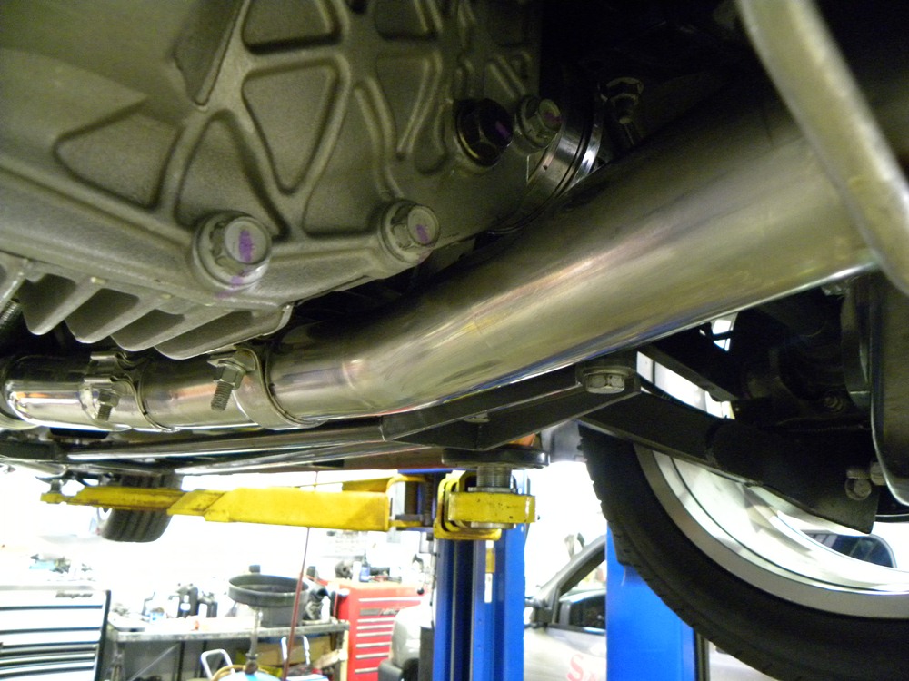

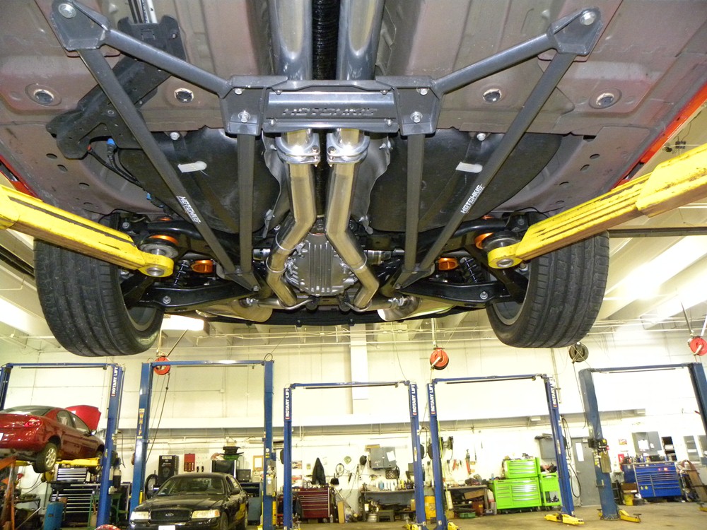

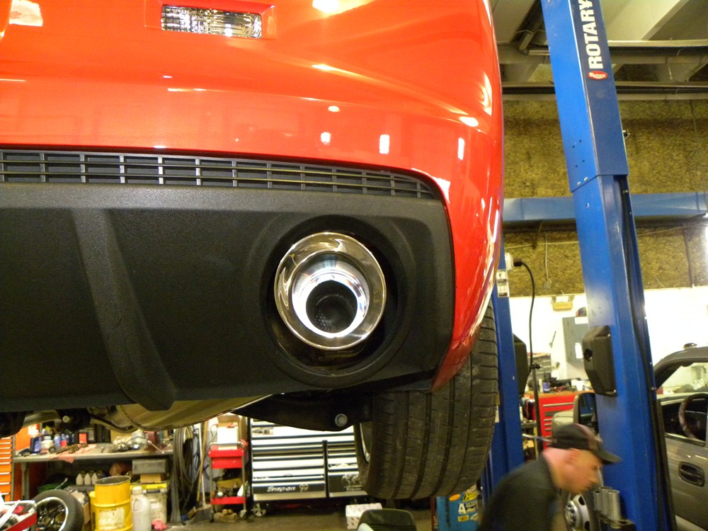

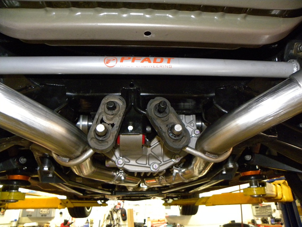

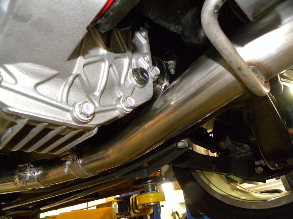

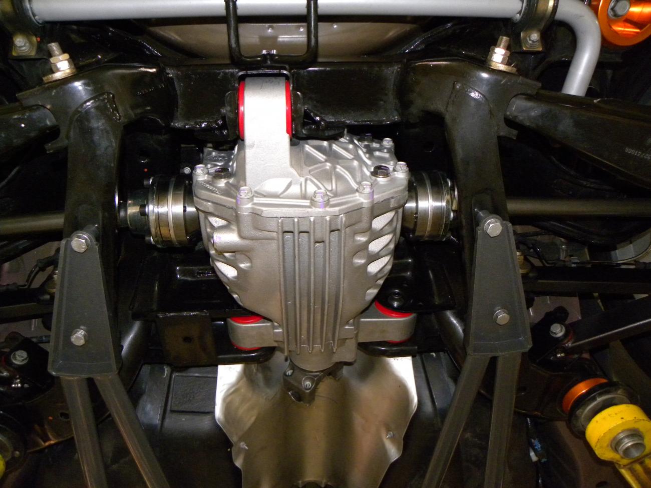

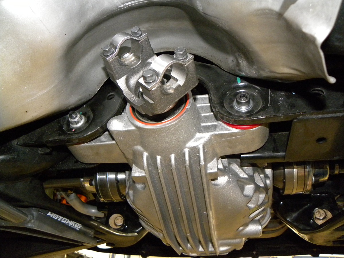

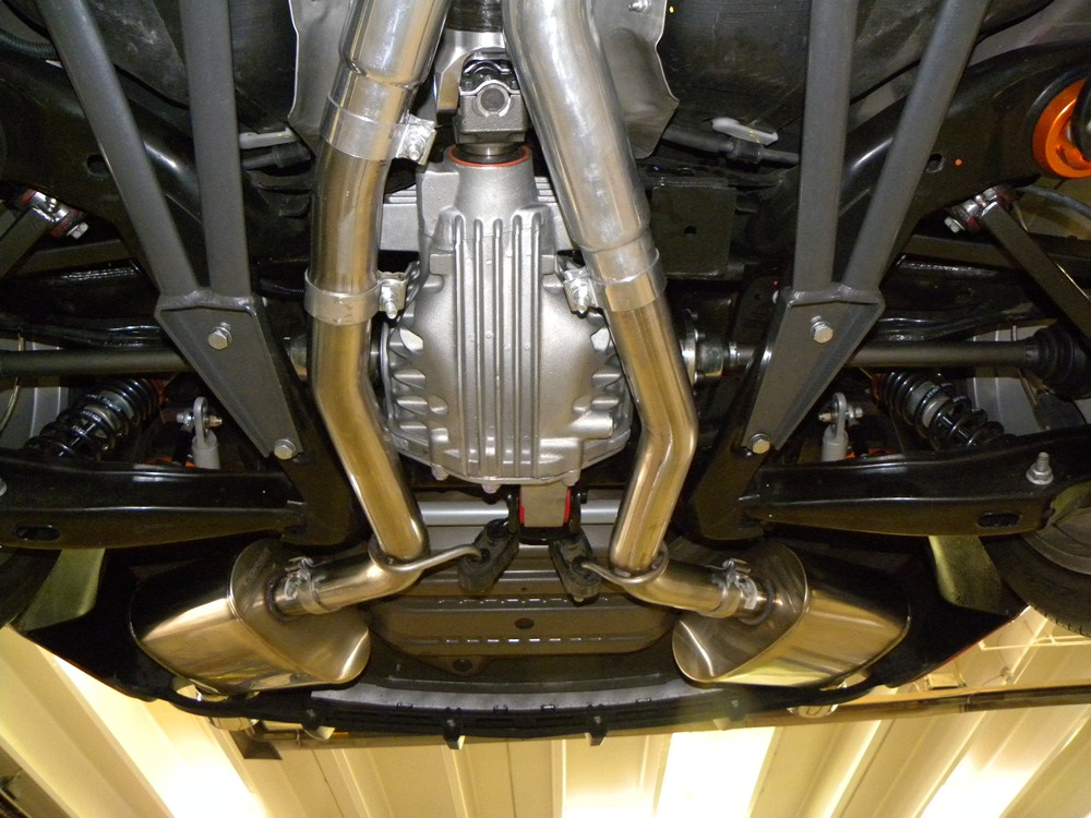

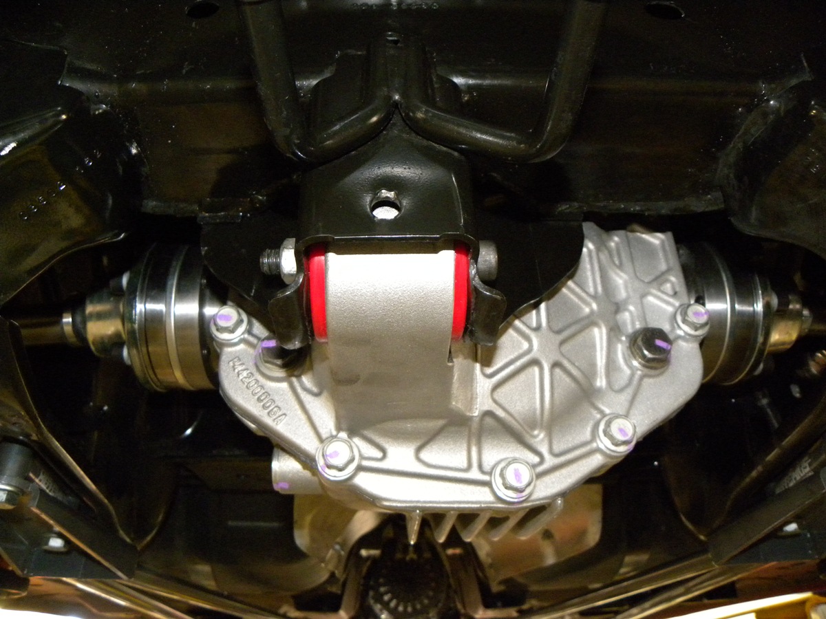

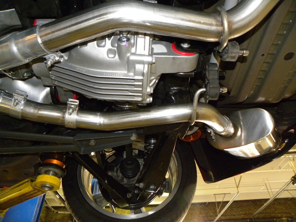

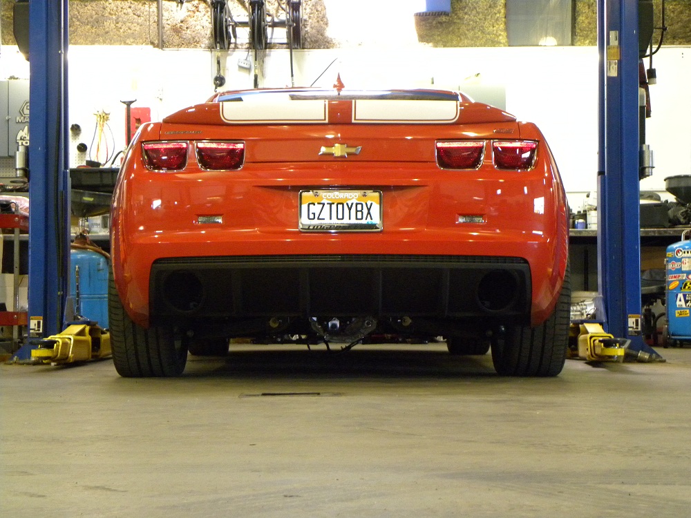

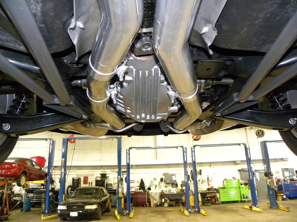

Lingenfelter 9.5" installed with Ceramic ARH 2" LT primarys and 3" mids
So here's a bunch of pics for reference showing clearances of exhaust around the Lingenfelter 241mm (9.5") rear differential.
First 3 are before mods from Sterling, Colorado car summer show. I did modify the exhaust slighty on the passenger side, just as it passes the diff cover. Torched and hammered in slightly, plus used longer GM exhaust hangers. The part # is 15092802 and is used on many Chevy trucks and SUVs. The ARH mids are 3" and the Corsa axle back is 2 1/2".
LPE Brotherhood
Old 11-17-2011, 01:12 AM   #89
jasycz28
J.Sick
jasycz28's Avatar
Drives: 2010 Camaro SS
Location: Ardmore, OK
Posts: 965
How did you get the Welds to fit with the coil overs? Did you have to raise the car up in the rear?
"J.Sick"
2010 Camaro 2SS
jasycz28 is offline   Reply With Quote
Old 11-17-2011, 02:02 AM   #90
Blue70SS
Blue70SS's Avatar
Location: Denver
Posts: 2,126
Heated up the contact point on lower control arms with MAPP gas and pounded the #@!T out of them until it cleared, plus Coilovers as high as possible in the rear. Repainted control arm area with Black rustoleum. I tested it out with "tape tateltale" strips on 4 places of the wheel edge at Bandimere Speedway.... finally was able to launch sucessfully on M&H drag radial 325's with 15 PSI, Pfadt coilovers adjusted to zero on fronts, and 5 on the rears. Plus opened up the oval holes on the bottom of the control arms to make coilover adjustments easier and half moon grinds on top side of OEM gussets. I'll have to dig up some pictures and post up.
LPE Brotherhood

Hey Blue70SS thanks for posting these photos up. Do you know by chance if the LPE diff is the same size in terms of height vs the OEM? Do you know if the LPE diff has room above it if you were to raise it 1/2 to 3/4? I am thinking if the diff went up with solid offset bushings it may eliminate the exhaust clearance issues. Report back for us here if you can stick your hand on top of the diff while its mounted in the cradle.
55Designs is offline   Reply With Quote
Old 11-17-2011, 08:45 PM   #92
Blue70SS
Blue70SS's Avatar
Location: Denver
Posts: 2,126
There is room above it to fit my fingers, but the case just above the 2 front bushings would definitely hit the rear cradle. Also FYI, I was just told you wouldn't want to raise the diff, as it would change the pinion angle.
LPE Brotherhood

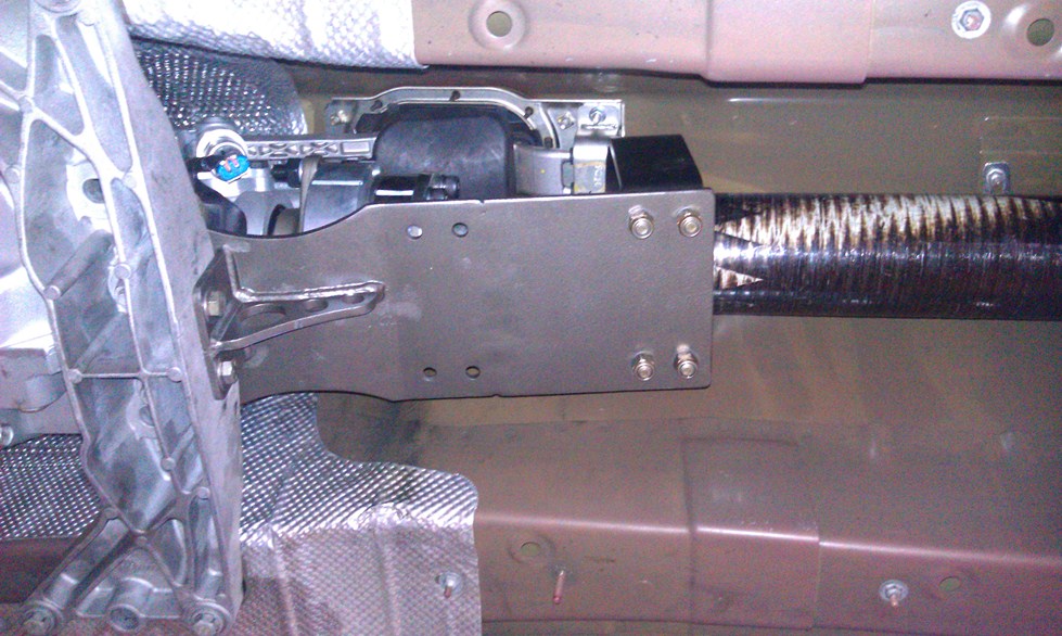

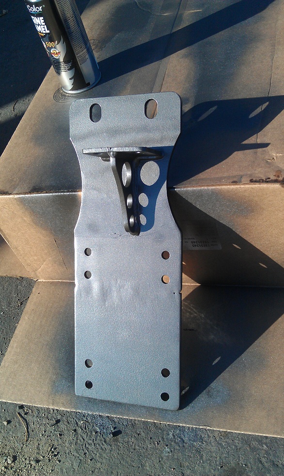

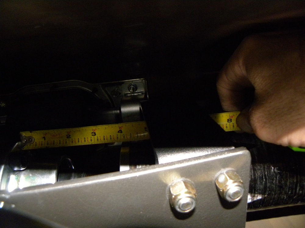

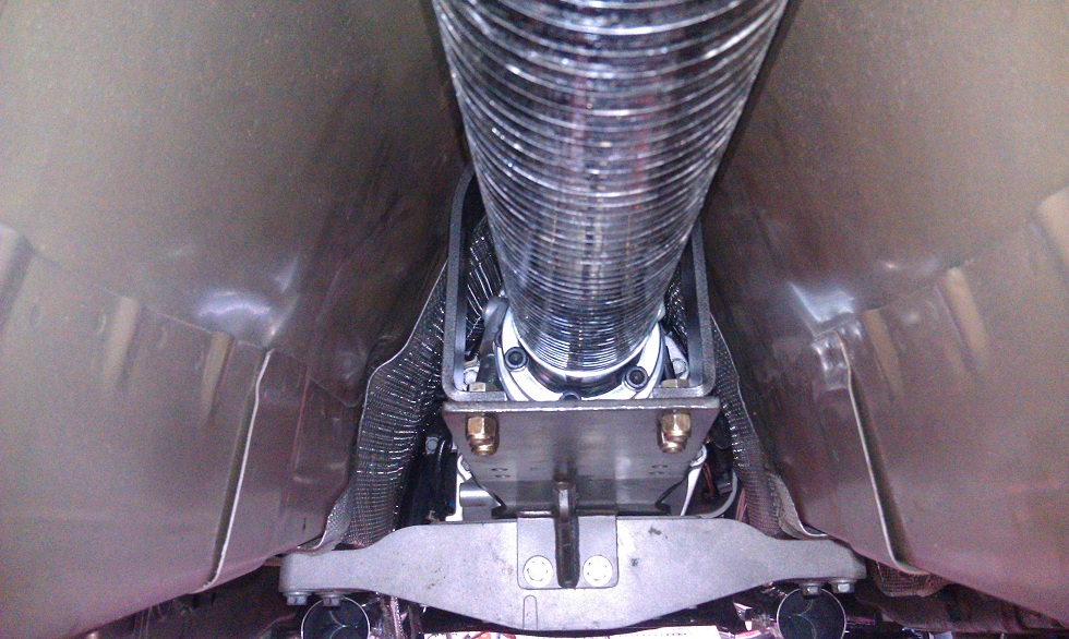

BMR Driveshaft Loop Modification by Brian at Laramie GMAC:
We extended the plate 5 1/2" inches, then added a 2" by 8" welded plate on the back for extra strength. Extending the plate 6" would be better for those without the Pfadt engine mounts - otherwise the loop might be able to touch the rear portion of the shifter mount. (because the Pfadt mounts won't flex as much as the OEM engine mounts) The goal was obviously to make it legal, but also keep it covering the insertion area of the billet end piece of the Carbon Fiber driveshaft. EDIT, either way - extending it 6" is the best for everyone with the drive shafts that utilize the front CV.
This mod is needed for any of the 1-piece driveshafts, since the front CV joint pushes the shaft further back in the tunnel.
LPE Brotherhood
Also, just noticed if the diff was raised you could also run into clearance problems with the inside CVs and the cradle.
LPE Brotherhood
