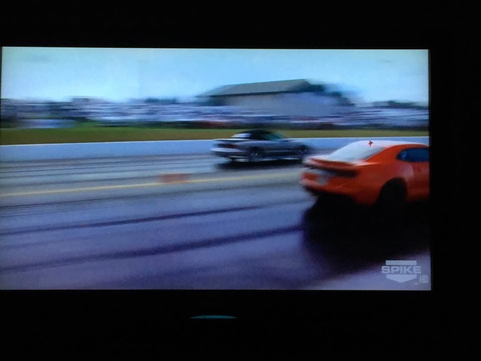

Our car was on Spike TV's Powernation Detroit Muscle this morning from their LS Fest coverage.
Keep in mind, it was bracket racing.

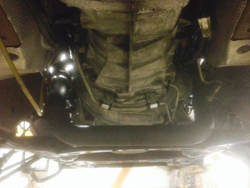

Well, I'm kicking myself for selling most of my performance stuff. Since I decided to keep the car a bit longer, I just can't leave it alone. I have to have some of my power back. I didn't want to mess up my 3.91 rear diff or axles, so I purchased some parts to do a ZL1 rear diff swap. The diff and axles came from a salvage yard. After two failed attempts to get a ZL1 driveshaft, I bought a new one from GM. I also bought new axle seals, driveshaft bolts, and plugs to plug off the oil cooler on the rear diff. When the ZL1 diff showed up, they left it attached to the rear cradle. I decided to take advantage of that since the ZL1 cradle has stiffer bushings. The sway bar was still attached too, so I ordered FE4 control arms and end links to take full advantage of what they sent.
Old diff.
New ZL1 diff.
Passenger side ZL1 axle vs stock axle.
I picked up the ZL1 trans flange from a member here on the forum. I already had the trans out for some clutch stuff, so I swapped it while it was out of the car.
I also installed the billet support bearing in the slave cylinder from Monster. Here's a couple of pics showing the stock plastic piece next to the new billet piece. I have a buddy that had the plastic piece fail, so I thought this would be some good insurance.
ZL1 diff in.
BTW, contrary to popular belief, you don't have to change the hubs to work with the ZL1 axles. I used my stock SS hubs.
ZL1 driveshaft installed.

As for power, I'm going cheap this time. I decided to give the On3 Performance single turbo kit a shot. I did upgrade to the 76mm ball bearing turbo and 4" intercooler.
The air filter seen here is the wrong one. There's not enough room for it to fit. On3 did however send me the right one when I brought it to their attention.
The first thing I noticed is how nice the kit actually looks. The welds are a work of art.
I took most of the piping to Nitroplate to have them coated to help with the temps.
More to come soon!
