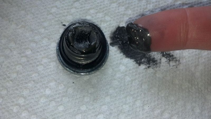

Originally Posted by billbathgate View Post
Hey bud nice post just wanted to ask a couple questions .did u use lock tight or Teflon tape on the drain and fill plugs and how much exactly should u pour in ..I think I'm a go with the royal purple stuff ...who do you know if it's not to much or to little
I appreciate the help....
Do not use lock time or teflon tape on the plugs. They have o-rings to seal and you need to torque the plug to the correct spec to prevent a leak caused by over-tightening and tearing the o-ring. Here's a picture of how mine looked on it's first change. That black stuff is the metal that attached to the magnetic plug after 2000 miles.

Just changed my differential fluid for the first time last week at 70,000 miles. The metal on the drain and fill plug magnets did not look any worse than the pics of those that people are changing at under 10,000 miles.
